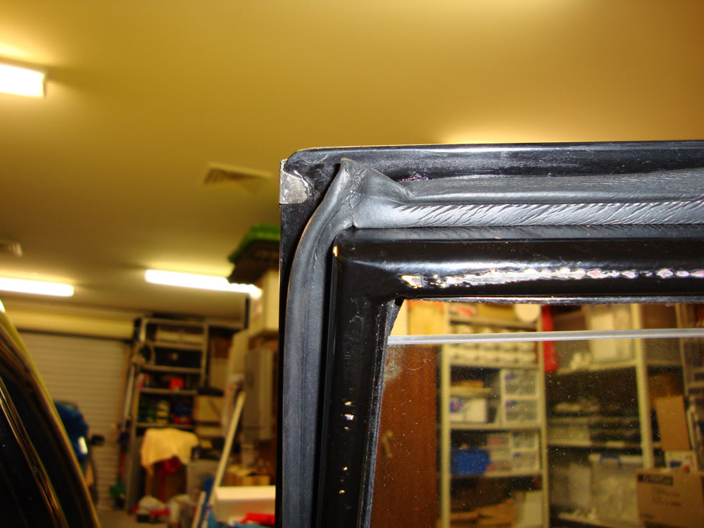

Now to fill everyone in,
I purchased these seals from Rares back in Sep/ Oct last year. I didn't get a chance to fit them until Mar 2010. Whilst I was happy with the rubbers, they have not stood up well being on the car for the last two months..
The following pictures will show you a little of what I mean. One thing that is hard to photograph is that the actual profile has distorted greatly along the top area of the door.
I was happy with the product initially, but now I am just plain dissappointed that they are not as good as I thought... :Headbang2:
If you have brought these in the past few months and fitted them, can you please tell us if you are having the same problems..

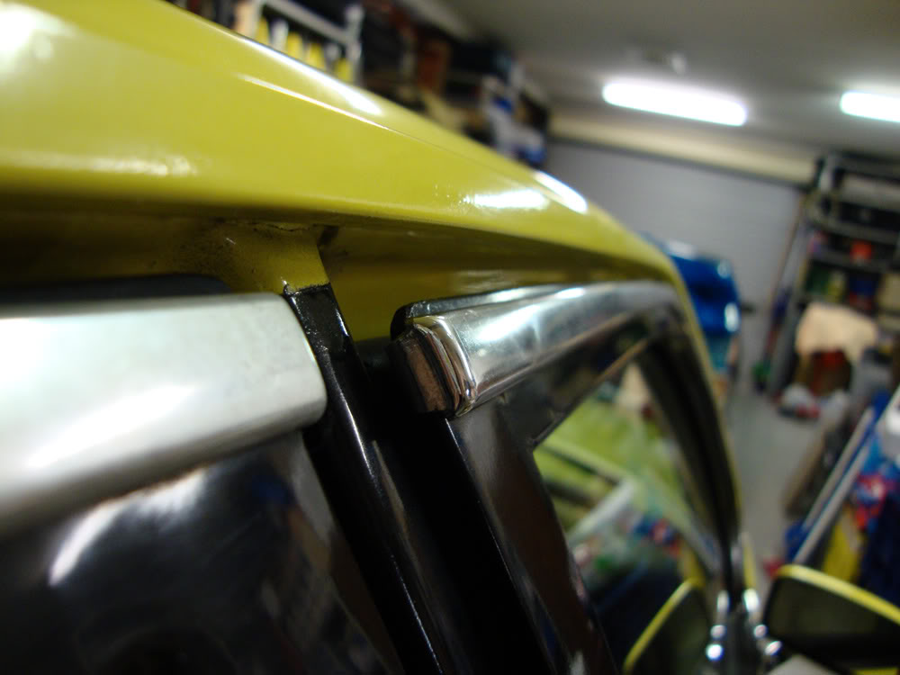

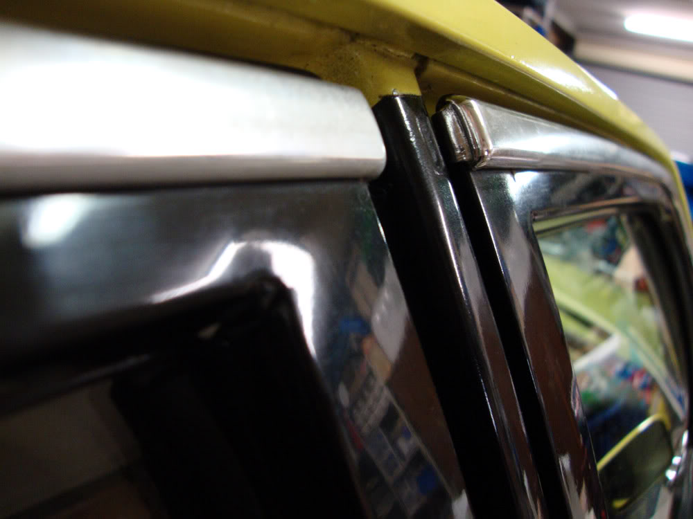

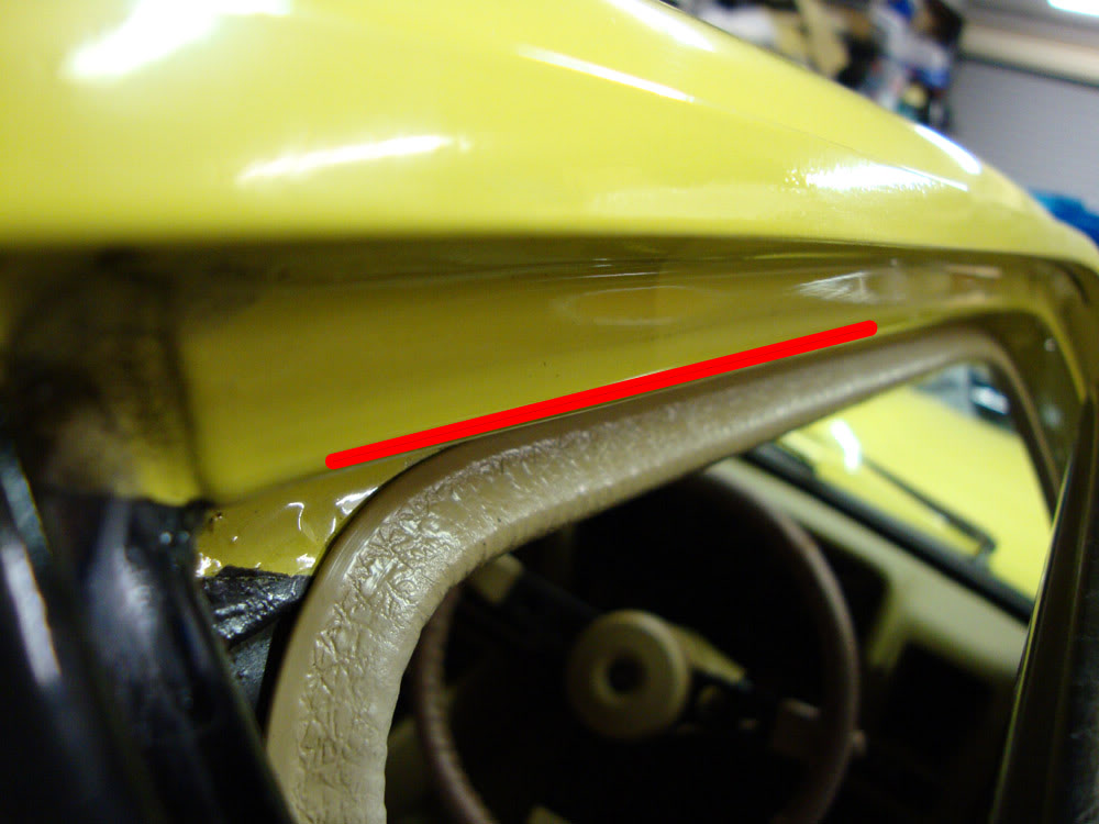

Hi All
for those that have been following this thread, I had the pleasure of meeting up with Lance Corby today. Lance made the flight from Melbourne to Newcastle to see what the problems were with the door rubbers on the old Sunbird. See the pictures above.
Now, to get on with the latest..
The first picture above shows what has happened to the Rubber on the Passenger Side Rear Door..
After looking at it, both Lance and myself could not see why this had happened. Lance replaced the rubber with a new one (manufactured this year) and it seems to have fixed the problem.
The second picture above shows what has happened to the Rubber on the Drivers Side Front Door..
After some examinations, we found that this Door had approx. 10mm - 15mm play in it due to the upper hinge. This was not noticable until we checked it for vertical movement.

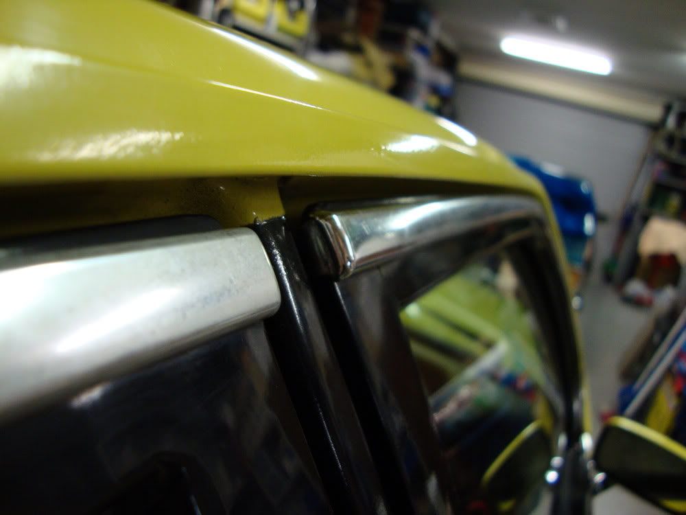

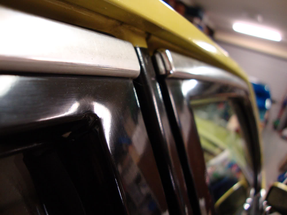

If you have a look at the following two pictures you will see the difference from when the door is in the position and on the first click of the striker bolt (picture 1), and where it sits once fully closed (Picture 2)..
Partially Closed..
Fully Closed
So how does that effect the rubber seal?? What is happening is that when partially closed, the seal was sitting lower than where it should have been in the door opening and when the door was fully closed, it was compressing the the seal under the door opening rail (re red line) nd not above and on the front face of the area.

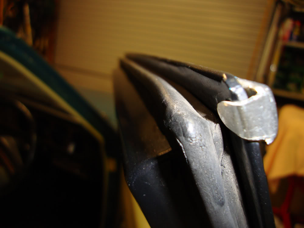

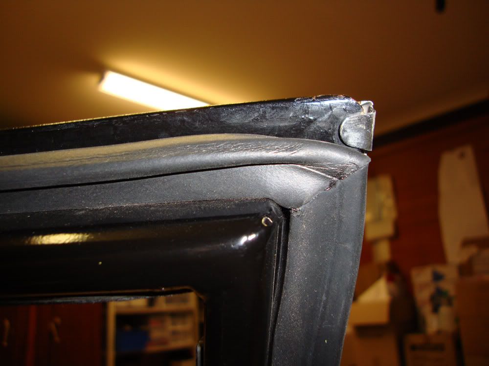

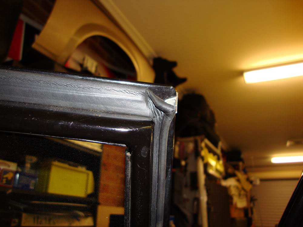

The third picture above shows what has happened to the Rubber on the Drivers Side Rear Door..
After some examinations, we found that this Door had problems in the fact that the front corner of the door glass channel was sitting too far in. See below..
Once we had worked out that this needed adjustment, we adjusted it and the problem with the door seal dissappeared...
As you can see, there were a number of different factors for why there were problems with the seals fitted to my car. It certainly opened my eyes to some of the problems that were occurring.
What I am happy with now is that the rubbers do fit well (albeit I need to fix a door hinge) and hopefully I won't be worrying about these for a long time..
To anyone else that is having problems a few things that might be causing them are:
Old versions of the seal,
Door Hinge Sag, and
Door alignment, both vertical and horizontal.
I hope that this helps a few people out and we can put the issues with the door seals behind us..
