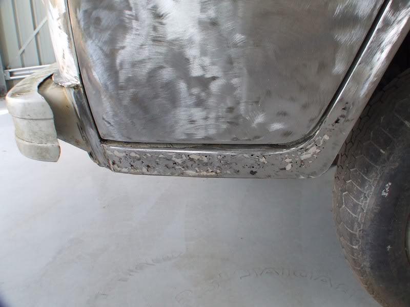

Here's the new quarter skin tacked on.
And now it's fully welded and rust converted.
The shell is nearly totally rust free now. About time : )

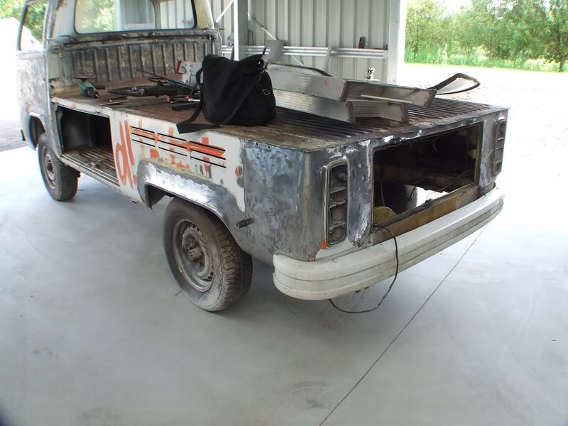

I've also started another couple of projects. One of them is a single cab kombi ute that's getting the fully smooth treatment and a 253 V8 up its bum, and the other one is the purple one tonner that's been in the background of some of these pics. I'll post a thread on the tonner as the owner doesn't live near me and it's a good way for him to see the progress and for you guys to poke fun at me hahaha.
Here's the sexy kombi before I started on it.
Let the paint removal begin. What a pain. The paint just melts in the sanding disc, so takes a while to get off.
I'm making brand new rear quarters for both sides, mainly because of rust and to get rid of the vents and big door on the left hand side. I'll be using the original wheel arches though.
So much fun.
