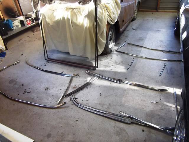

Got a guy coming to put in the screens some time this week so spent some time picking out the best pieces I have (I have enough trim for two cars) and polishing them up.

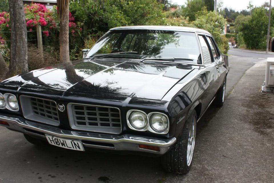

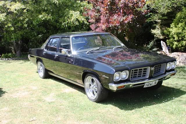

Car is back on the road and all legal tegal (but not without some problems along the way). Took it for a burn down the road and round the corner to see some mates. Will do a proper photo update tomorrow but here is a quick pick the missis took.

Love the plates too!
congrats on getting it all done and regoed, its come a LONG way since you began.

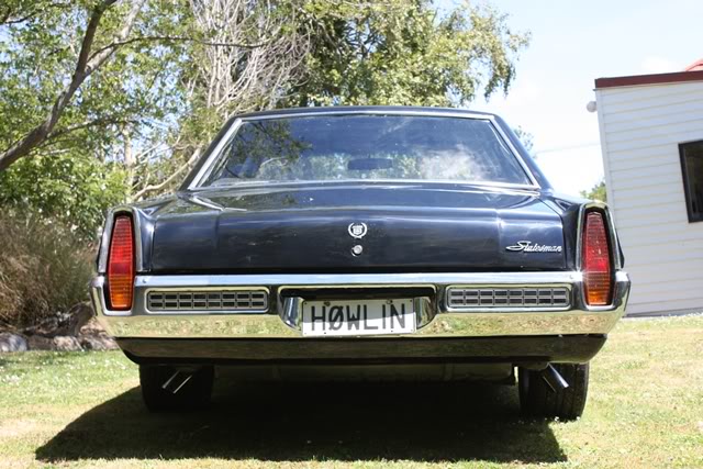

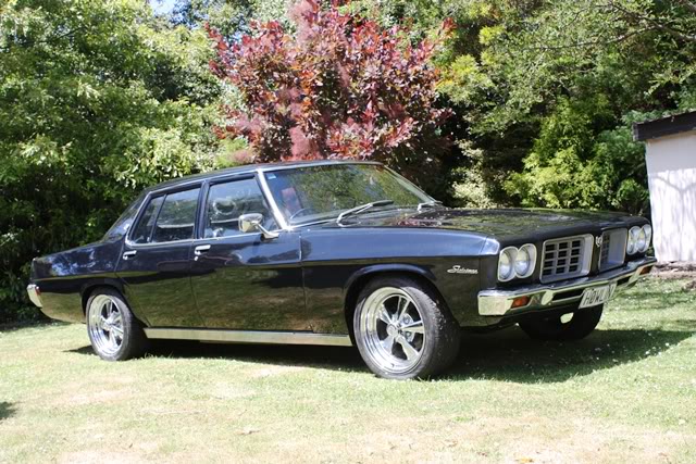

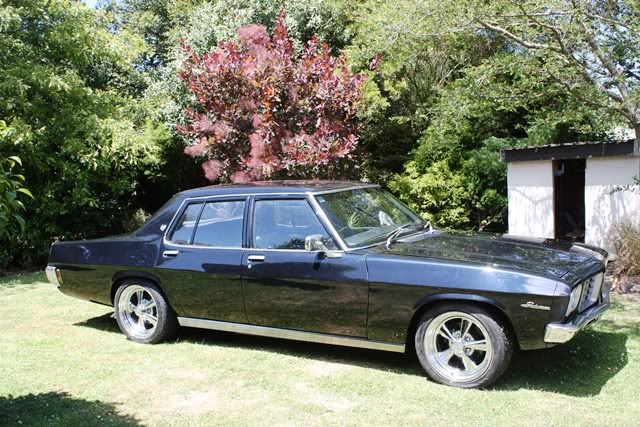

Posted 25 January 2012 - 02:02 PM
Last friday morning had some guys come round to fit the screens (I had purchased a new screen), had it done, chucked the chrome on, gave it a quick wash and headed down to get a warrent. Passed its warrant with flying colours (not a thing wrong with it), by this stage I was getting real excited. Went to head up the road to pay for the rego, then puff, engine died and there was some nasty electrical smoke from under the dash. Borrowed some tools from a garage nearby to whip the column down to see that the ignition switch was fried, not only the the coil feed wire was fried as well. The least I can say I was heartbroken. Luckily for me some guys from the paint shop were going past and were able to two me the couple hundred metres to the auto sparky (all of this is within 1k of my house). He is a pretty good guy and was able to sort it by tues. Traced the problem to some wires shorting out on the metal cover of the dizzy module which is also likely to have caused the alarm to fry itself when it was at the paint booth.
Never mind, alls well that ends well. I have it on the road, been tearing (though not literally) up the pavement in it for the last 24 hrs and doing the rounds to show it to all of those who have been involved.

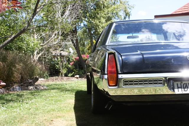

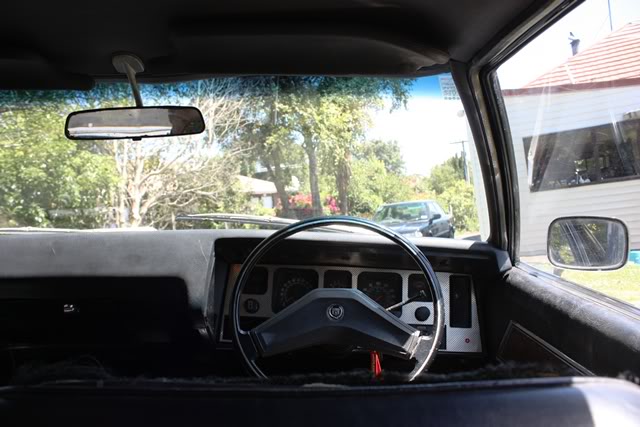

Enought talk, here's some pickies....
