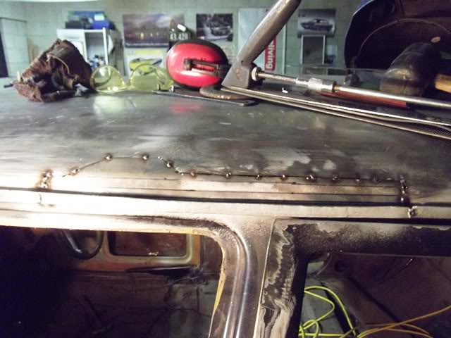

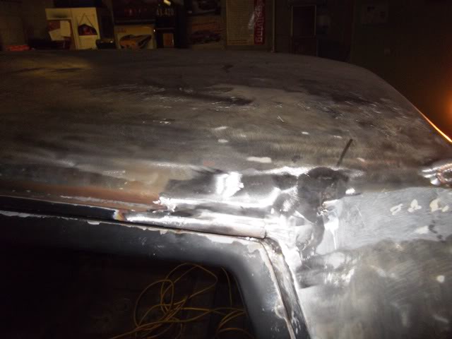

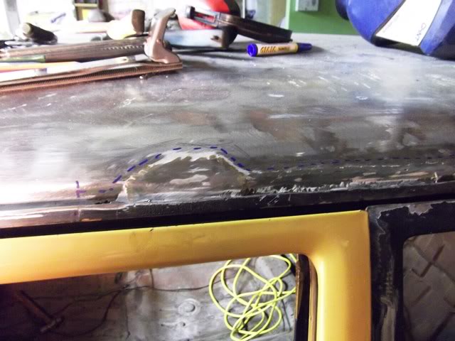

I finished the weld on the roof with the panel file and you can barely tell its there, job well done
Come on, this isnt good workmanship

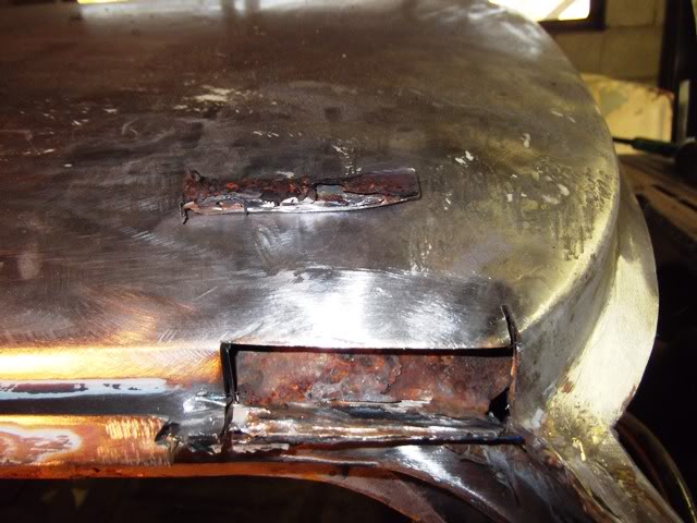

Another section
Also welded in a new section on the drivers door where the mirror mounts and am in the process of drilling for new studs for the sill chome, this has required a bit of tweaking of the front guards.

I kept saying to myself, "I'm not going to cut into the roof, I'm not going to cut into the roof, I'm not going to cut into the roof"
Looks like I did, don't know if there is any area in an HQ which usually rusts which I havent fixed...

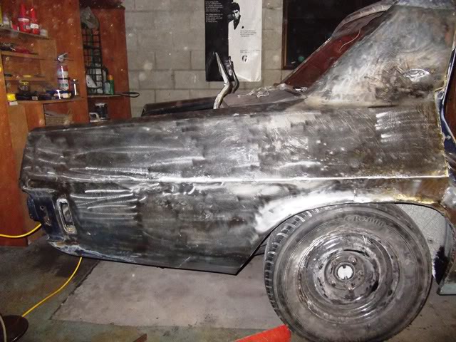

Well it now looks like this
Took me AGES to get the panel back straight, not only were there all those little dents in it (BB gun I think) it was oil canned and stretched to hell.

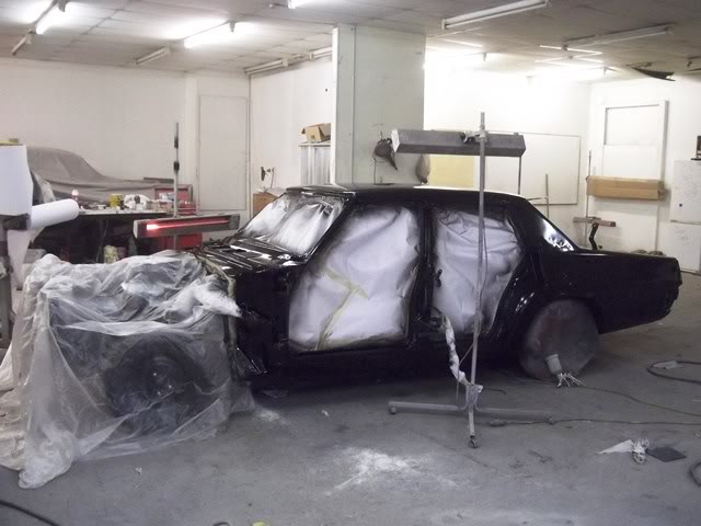

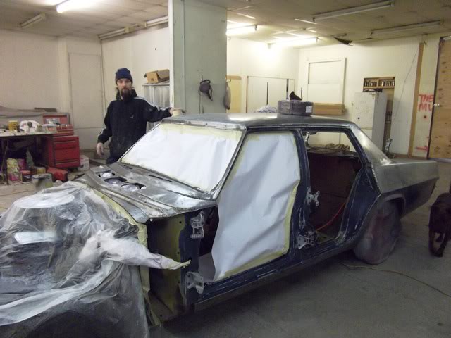

Friday night, mate of mine came round and we trailered it over to the painters, they're ford and mopar guys so there were plenty of ribbing about an HQ turning up on a trailer, good blokes though.

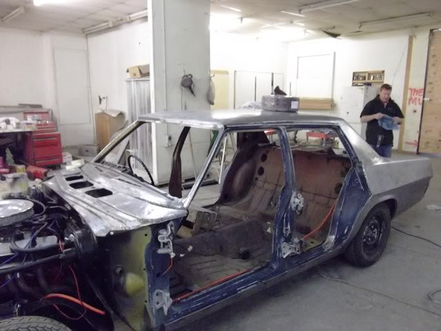

This morning my dad and I went round, just to scuff up all of the door jams (there's the old fella in the photo)
and the painter went over the steel with the DA to key it up.

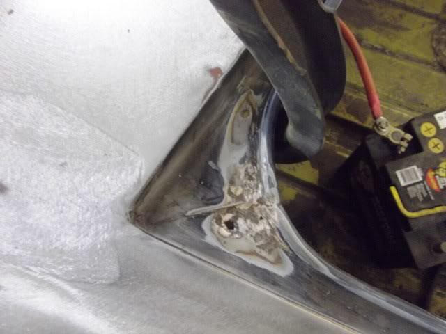

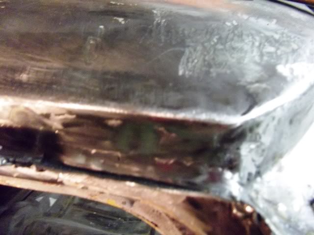

After going over we found one spot where I really should have had a bit more of a dig. This was the back corner of the boot (which looked fine), after scuffing up with the paper the paint just flaked off to reveal bog. Dug at it with a screw driver to reveal holes, I was pretty pissed with myself at this point (it can be fixed though), its the same on the other side.

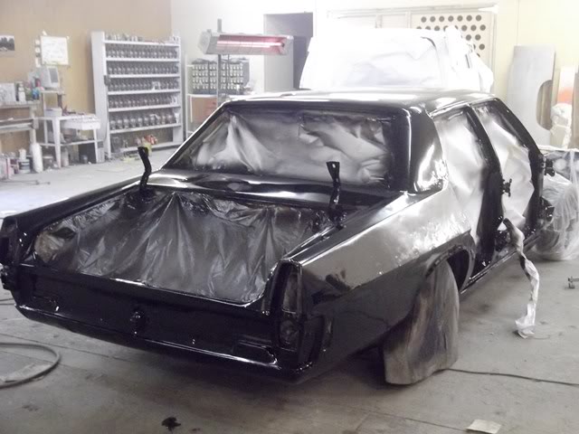

But it got over it, and some paint got sprayed (I got out of the workshop at this point)

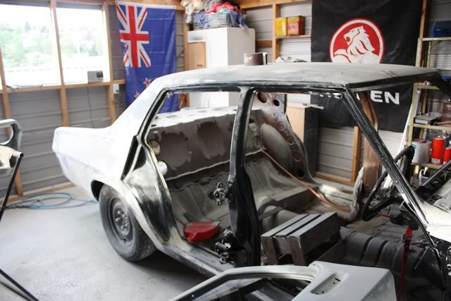

Came up nice, one of the other benefits with using black epoxy is that it shows up all of the rough spots really well, makes finding where I need to fill alot easier.

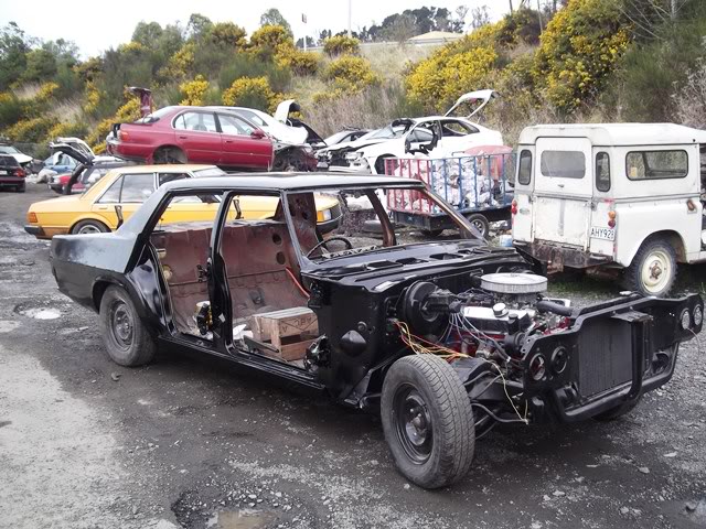

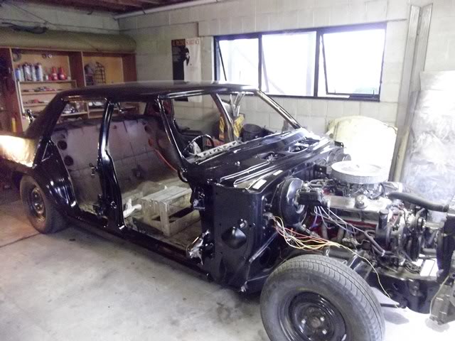

Got to drive it out into the sun
And then made it home

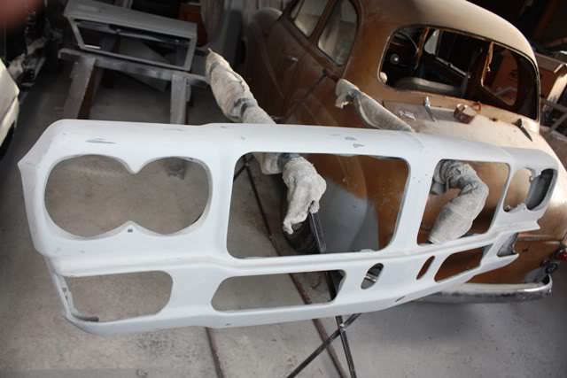

Posted 05 November 2011 - 04:45 PM

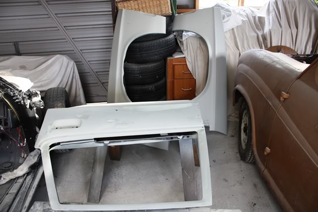

Haven't taken many photo since I've been more concerned on getting the damn thing done. All of the hanging panels are in high-fill and hopefully taking the shell down next weekend to get sprayed.
This weekends job is to finish rubbing down the panels.
