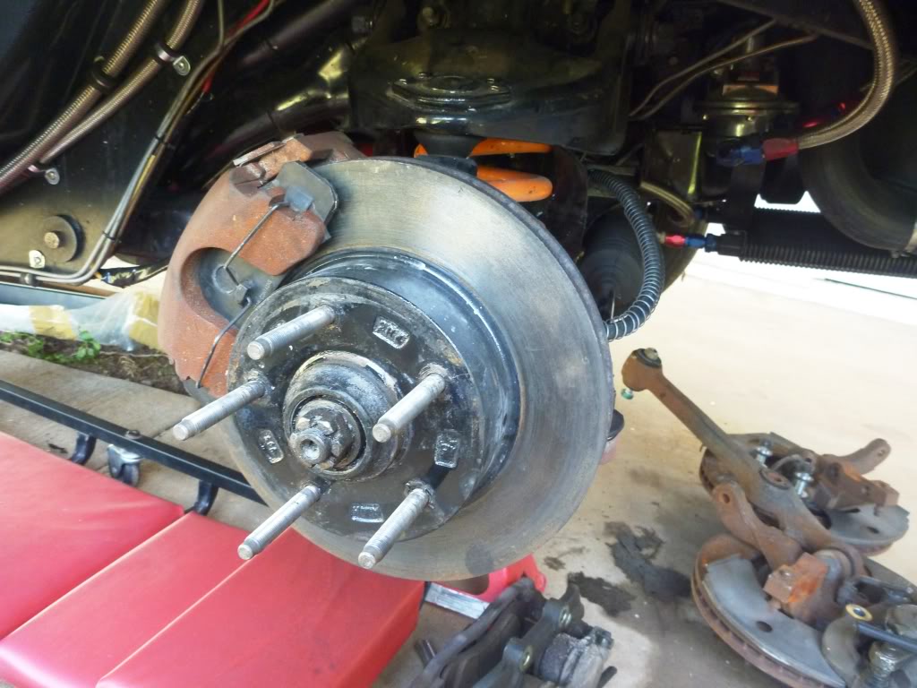

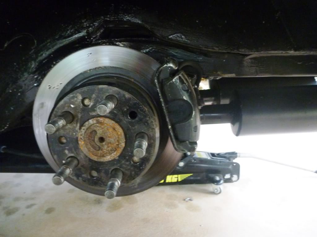

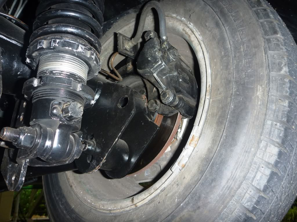

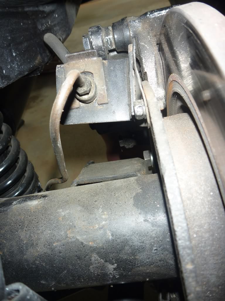

Posted 26 July 2010 - 02:51 AM
A few pics of the current setup
Front
Back
#7 _ls1lj_

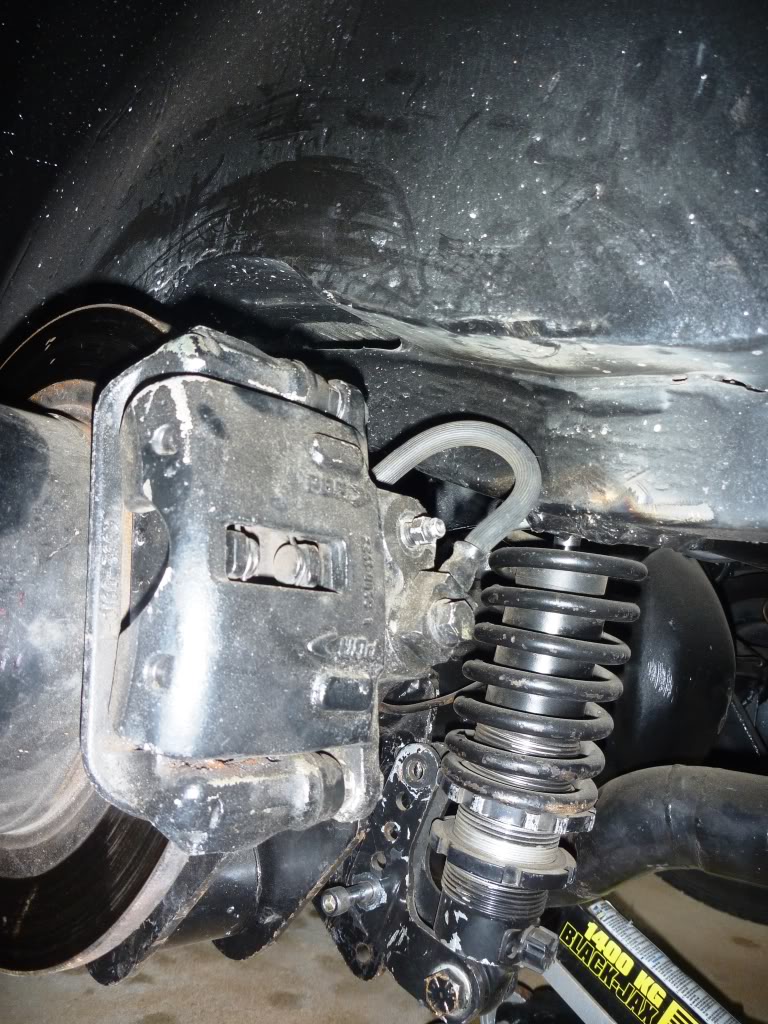

Antelope, I had planned to replace the rears to match the new fronts so that the hydraulic piston area ratio was kept, so the back anchors did't lock first ie. a matched pair if that makes sence
The rear discs came with the diff, I took the number stamped on the side into repco and independant but they couldn't tell me what they were off. I suspect they are bombodore ones, can anyone confirm? Callipers are marked as PBR with K241-06SC1 and K332-091C1 cast into the body.

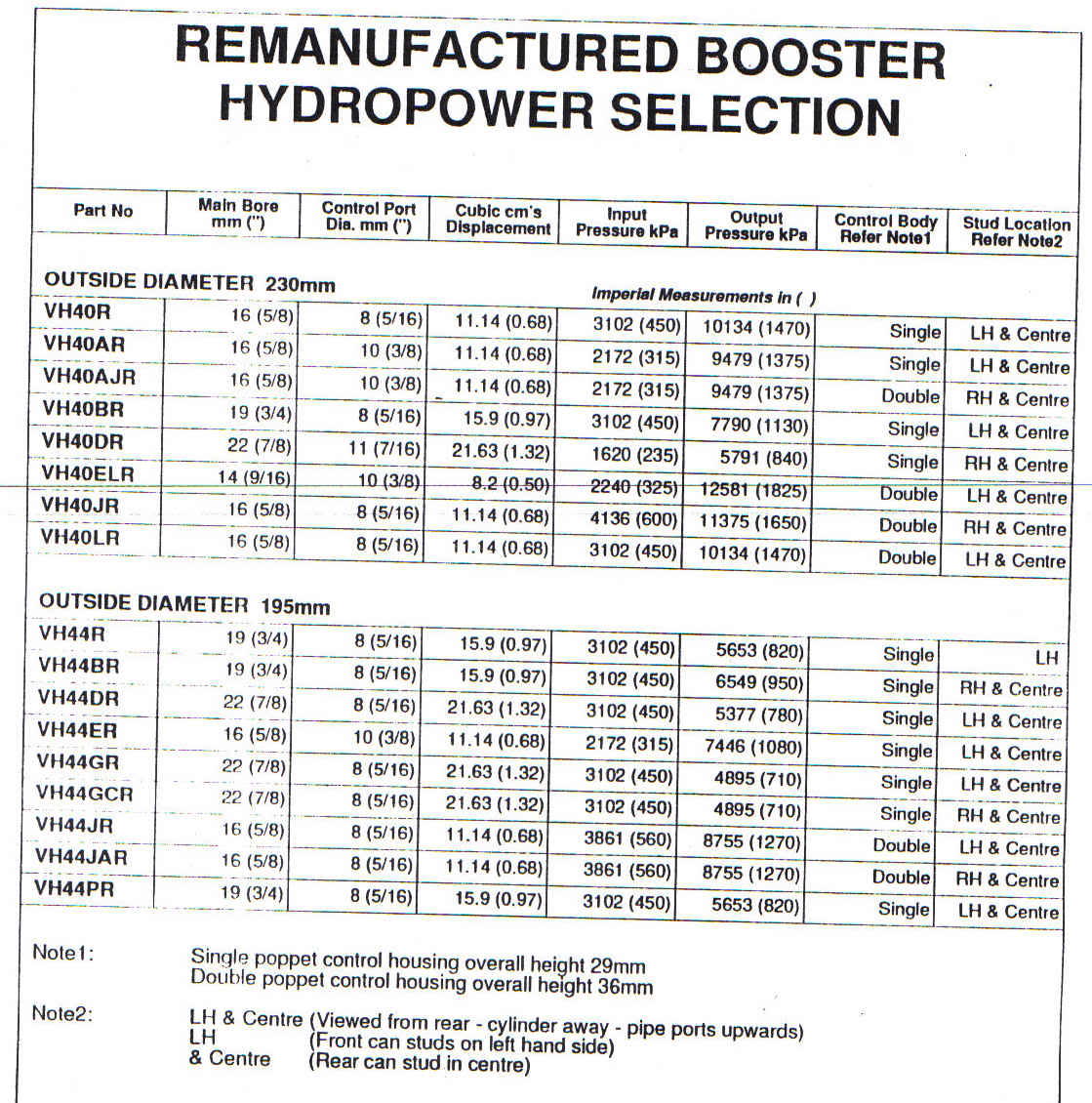

While we are on part numbers i have a couple of brake boosters that I want to run remotely Marked PBR 260550. Can anyone tell me what they were originally installed in and what size they are?

#8 LJ RB30
LJ RB30
  • 1,058 posts
  • Name:Trevor
  • Joined: 12-March 09
Posted 26 July 2010 - 11:50 AM
Hi LS1 LJ
I currently have VL calipers front & rear on my LJ, VN V6 slotted/ cross drilled disc's on the front , stock commo on rear, stock LJ master/booster. This worked really good on the road/strip with EBC greenstuff pads on the front & unknown on the rear (too long ago!!) It was only when i went to a tuning day at Wanneroo that i realised the brake bias wasn't good under circuit conditions. I have 296mm VT front brakes & hub adaptors to fit but as you said i too have read that the VT calipers can flex so i'm now fitting R33 4 spots. I adapted the VT master cylinder to the LJ booster as fitting the VT booster requires it to be offset to clear my intake, don't know how well it will work as the VT booster has a higher ratio but will try it before i fit the VT booster. Pads will be QFM A1RM all round. Can't wait to see how it goes or should that be STOPS!!!
Your rears look like commo but not 100%. I am leaving the VL rear calipers (38mm) on with the 4 spots, VT's are 40.5mm.
What handbrake set up are you using? Can't see it in the pic's

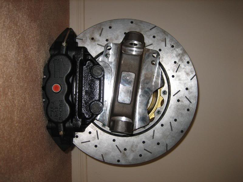

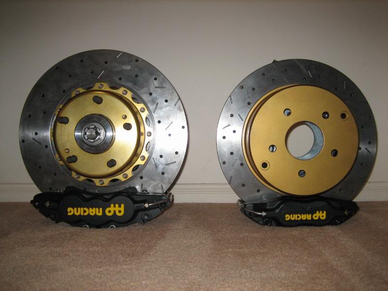

This is my setup which I will be fitting in the near future.
Not a cheap upgrade but have a look at the thousands of dollars people will spend on engine mods without thought... but yet when it comes to the braking performance brakes are one of the most overlooked items fitted to street modified cars (in my opinion anyway!)
Commodore rear
They are PBR Hydropwers... that number is a casting number only and they could be anything depending on their internal bore size and the size of the diaphragm
Refer this chart

As for rears... take a look at antelopes pics... they are almost identical to what would use
What he's got there appear to be DBA5046 (28mm) or maybe 5048 (32mm) rotors for front and CP5700 style 6 piston calipers calipers with a fabricated hub to mount the disc to the stub
The rears are VT HSV 315mm vented rears with a custom backing plate for handbrake
Looks like it might be a CP5147 series caliper
I'm guessing numbers here but I'm sure antelope will correct me

Pretty close Datto!
Front discs are DBA5046B, 330mm x 28mm. (I purchased the discs from you Neil!)
Front calipers are CP5570.
Rear discs are HSV DBA4049, 315mm x 18mm.
Rear calipers are CP7607
Backing plate is a custom Banksia park brake setup (as used in VT Commodore). It accepts the Torana park brake cable with no mods, direct fitment.
Stub axles are 2" drop stub with VT hub adaptors to accept the front discs. Stub axles also have been drilled to accept Commodore caliper mounting.
