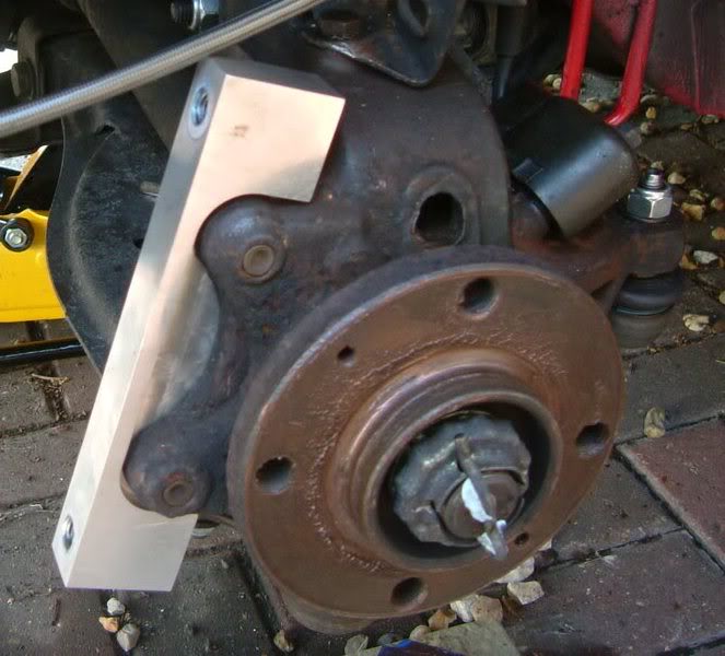

#57 dattoman
Posted 10 November 2010 - 05:23 PM
Make your own brackets
Radially mounted calipers make life so much easier
There isn't one that you can buy that will even be close.
They are just a piece of angle looking... sometime steel (10mm thick)
Or 6061T6 alloy
The trick is making it clear all the bits... control arms... steering... stubs
Heres some on a Torana already..... he made his own brackets - alloy blocks (330mm rotor)

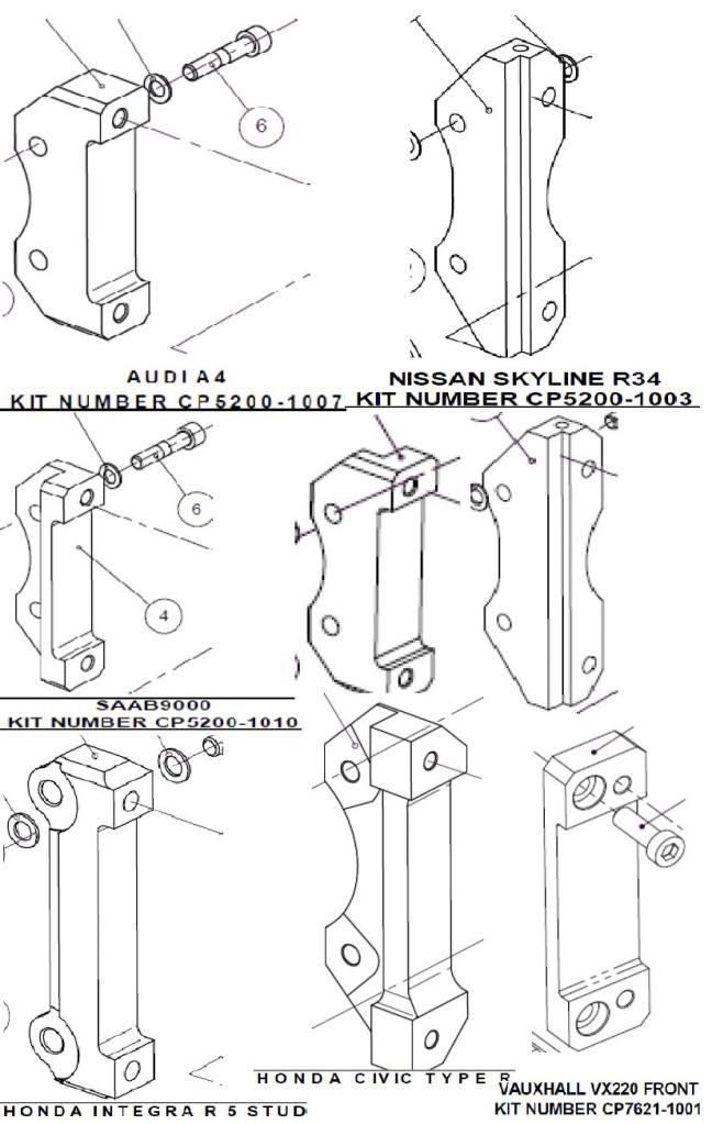

Yeah had a bit of a surf around the net last night and after seeing a few brackets they don't look that hard. Just waiting for the conversion hubs and discs to rock up, then i might try and knock up a bracket out of wood using the router.
Some examples of AP Kit Brackets
...And example bracket
Datto, checked out the 6160-6T Alloy looks like the go, 310 Mpa Tensile and 280 Mpa Yeild Strength. Also not that expensive even in Darwin as a metre length of 2 inch solid stock is around $70. smaller stock is available but then minimum buy is 4-6m.
My preference would be to use high tensile bolts with nyloc nuts, but if there is no room is it ok to drill and tap directly into the alloy? I have seen this done before but would be less confident with this setup.
Any chance anyone knows what alloy the actual callipers are made out of?
Also do you have to worry about surface hardening or embrittlement issues when you work the alloy with grinder/die grinder? Amy isues with surface contamination similar to using a mild steel electric brush to clean up stainless?

You can drill and tap straight into the 6061
If your not 100% confident you can put a steel thread insert into it aswell
Just keep it clean and it should all be fine..... you shouldn't need to do much grinder clean up anyway
I use caphead screws for fastening...nice 12.9 grade I think they are

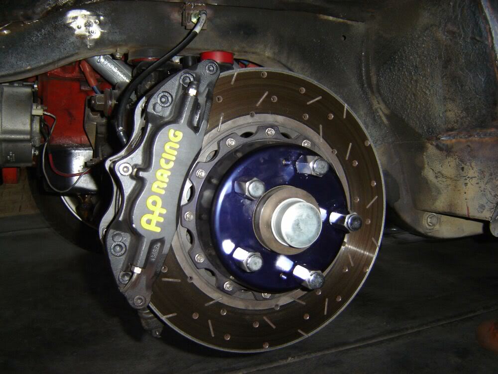

However you can use various Commodore rotors depending on what size disc you want... 300 or 330mm are the most common... 28mm thick
As for rears... take a look at antelopes pics... they are almost identical to what would use
What he's got there appear to be DBA5046 (28mm) or maybe 5048 (32mm) rotors for front and CP5700 style 6 piston calipers calipers with a fabricated hub to mount the disc to the stub
The rears are VT HSV 315mm vented rears with a custom backing plate for handbrake
Looks like it might be a CP5147 series caliper
I'm guessing numbers here but I'm sure antelope will correct me
Pretty close Datto!
Front discs are DBA5046B, 330mm x 28mm. (I purchased the discs from you Neil!)
Front calipers are CP5570.
Rear discs are HSV DBA4049, 315mm x 18mm.
Rear calipers are CP7607
Backing plate is a custom Banksia park brake setup (as used in VT Commodore). It accepts the Torana park brake cable with no mods, direct fitment.
Stub axles are 2" drop stub with VT hub adaptors to accept the front discs. Stub axles also have been drilled to accept Commodore caliper mounting.

Posted 18 November 2010 - 02:42 PM
Is there an aluminium hub alternative? I know Willwood make aluminium ones for some GM cars. I wonder if anyone makes aluminium hubs for Vauxal Monza?
Im a little behind the ball on this stuff, but what are VT hub adapters??
Is this what you guys are talking about? (In the web page) I think the VB-VP discs fit LJ/LH/HQ stubs there fore these hubs (In the web page) should fit and are modified to suit VT upgrades. Is this correct or have i got the bull by the balls here?
http://holmart.com.a...ne/prod1627.htm
If it was that easy... everyone would do it
Pretty close Datto!
Bart
I brought similar hubs to the ones you linked, the ones i brought are made out of a better grade of steel K1045 for $350 a pair includes wheel bearings off evilbay = mr spares
http://cgi.ebay.com....e=STRK:MEWNX:IT
antelopes are 2inch drop stubs which change the ride height and have the conversion hub also.
