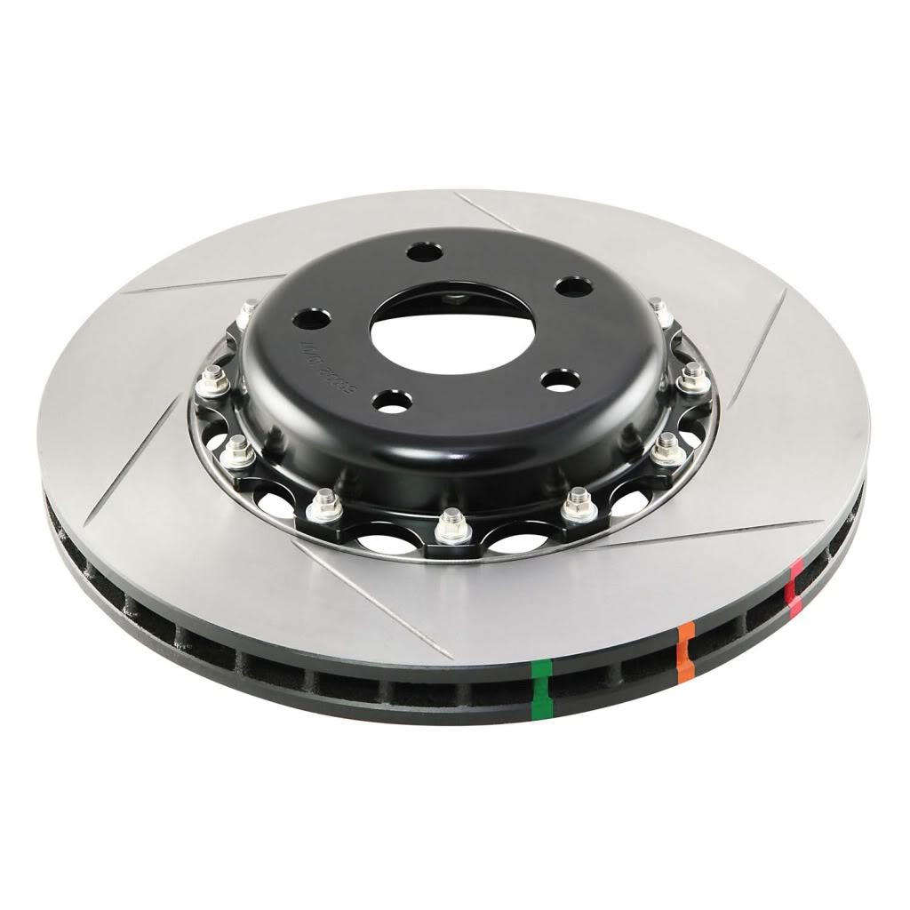

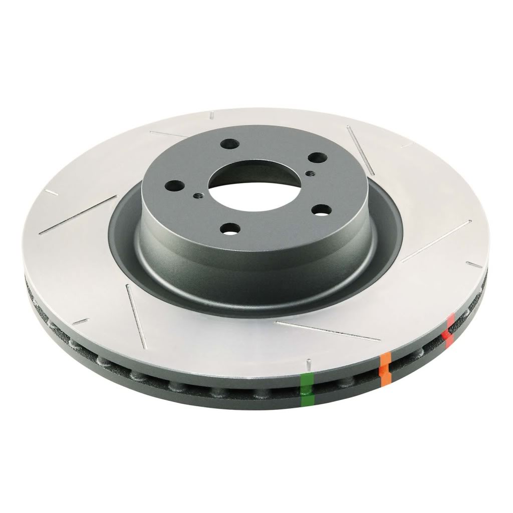

Looks like the 5200's will be the go on the front with the DBA5040BLKSR\L’s as they are 1.75Kg lighter each side than the 4000 series. Are the Ferodo FRP216 in the DS2500 series the right pad for this calliper?
5200 Calliper
DBA5040BLKSR

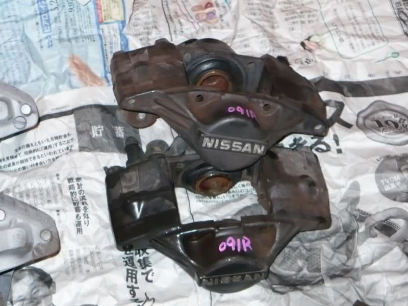

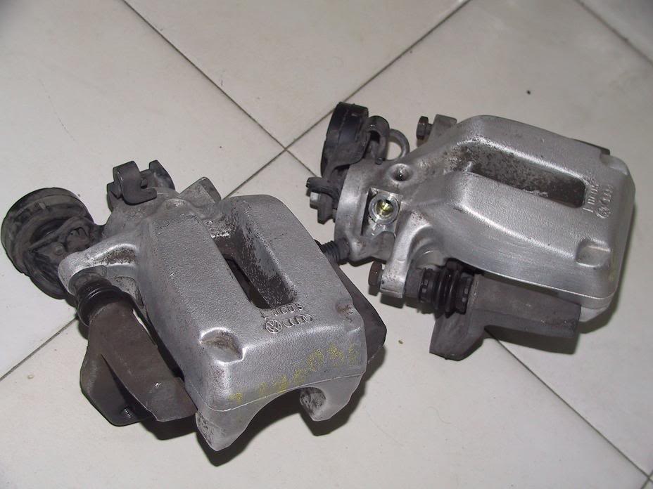

Do all of the Nissan R32 Alloy callipers look like the pic below? What do the Steel ones look like?
Are the R32 GTS-T Rear Calliper the same even though they came out on the 280 dia disc as I want to install on a 296?
Single piston for reference:

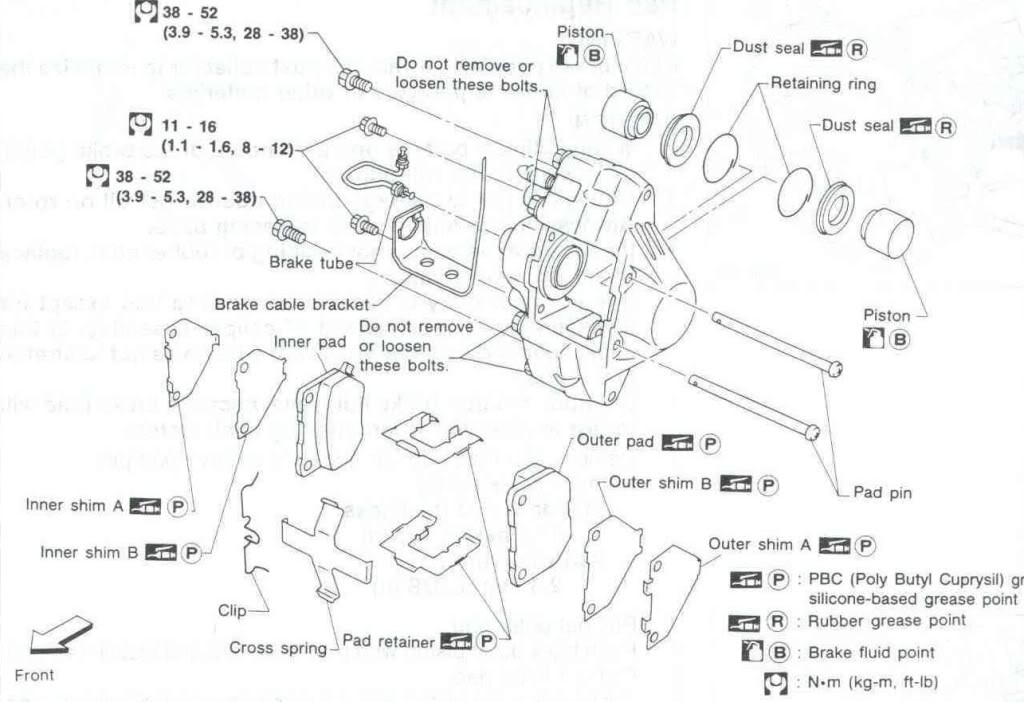

Exploded View of R32 Calliper:
Is the Rear calliper rebuild kit number: 44120-Z32001 the right one? Do I also need 2 off the cross spring 41090-Z32003, or the Pad retainers/shim kit 44080-Z32001
A good list of front Nissan callipers and specs for reference if anyone is interested, couldn’t find a similar list for the rear callipers unfortunately
R32 T : 280mm x 26mm (single pot sumitomo caliper)<BR itxtvisited="1">R32 GTS-T (early) : 280mm x 26mm (single pot sumitomo caliper)<BR itxtvisited="1">R32 GTS-T type m : 280mm x 30mm (4 pot sumitomo caliper)<BR itxtvisited="1">R32 GTR : 296mm x 32mm (4 pot sumitomo caliper)<BR itxtvisited="1">R32 GTR VSPEC : 324mm x 30mm (4 pot brembo caliper)<BR itxtvisited="1">R33 GTS-25 : 280mm x 26mm (single pot sumitomo caliper)<BR itxtvisited="1">R33 GTS-4 : 280mm x 26mm (single pot sumitomo caliper)<BR itxtvisited="1">R33 GTS-25T : 296mm x 30mm (4 pot sumitomo caliper)<BR itxtvisited="1">R33 GTR : 324mm x 32mm (4 pot brembo caliper)<BR itxtvisited="1">R33 GTR VSPEC : 324mm x 30mm (4 pot brembo caliper)<BR itxtvisited="1">R34 GT : 296mm x 30mm (4 pot sumitomo caliper)<BR itxtvisited="1">R34 GTT : 310mm x 30mm (4 pot sumitomo caliper)<BR itxtvisited="1">R34 GTR : 324mm x 32mm (4 pot brembo caliper)<BR itxtvisited="1">Z33 NA : 324mm x 32mm (4 pot brembo caliper)<BR itxtvisited="1">Z32 NA : 280mm x 26mm (4 pot sumitomo caliper)<BR itxtvisited="1">Z32 TT : 280mm x 30mm (4 pot ali sumitomo caliper)<BR itxtvisited="1">S14, S15 : 280mm x 30mm (4 pot sumitomo caliper)

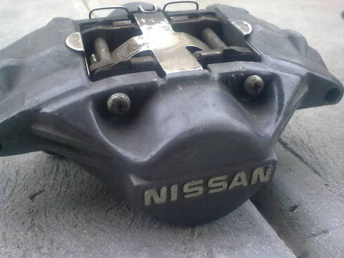

On the Rear I will probably be using the R32 GTS-T alloy 2 pots (depending on awnser re size of sisc) with the DBA4020SL. I checked in the Ferodo catalogue and there are no pads listed for the rear brakes for either the 300Z/R32 Skyline so is there a pad that is similar that can be used? If not what brand and pad would you recommend?
DBA4020SL
Hopefully the pics work this time?????

All the 2 pot rears are alloy
Buy calipers that are complete and have pads still in them

Just brought these R32 GTS-T callipers for $110 off evilbay
http://cgi.ebay.com....em=290492154313
Also placed an order with Competition Friction for the callipers and pads. Ordered the discs from my local Repco and K1045 Vt conversion hubs also off evilbay for 350. Hopefully I will have most of the shiny bits when I get back.Posted Image Posted Image Posted Image Posted Image Posted Image

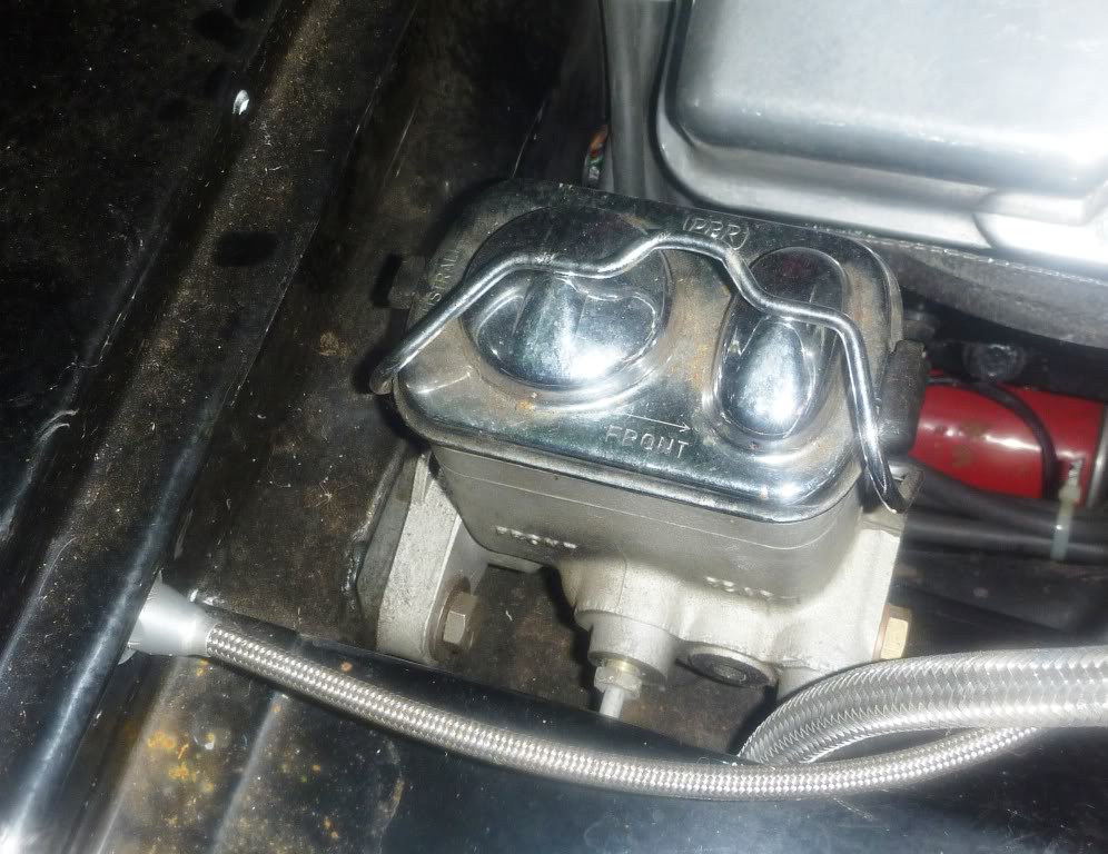

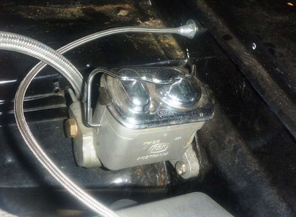

I think I have the LJ/HQ (larger chamber at the rear) style master cylinder bolted direct to the firewall. However the ports point towards the gard(drivers side) unlike most Holden Master cylinders??? Is there an easy way to confirm what I have got? Would I have the 20/25mm bore and will I now need a 1 1/4” bore? I haven’t checked if the little diaphragm for the rear drum brakes has been removed yet. The pedal always felt very spongy and had excessive travel even after bleeding a whole bottle of brake fluid through the brakes. Got twin remote brake boosters mounted in the boot. I posted up some casting numbers earlier and Datto indicated they were PBR Hydropowers but unsure of the size.
Master Cylinder

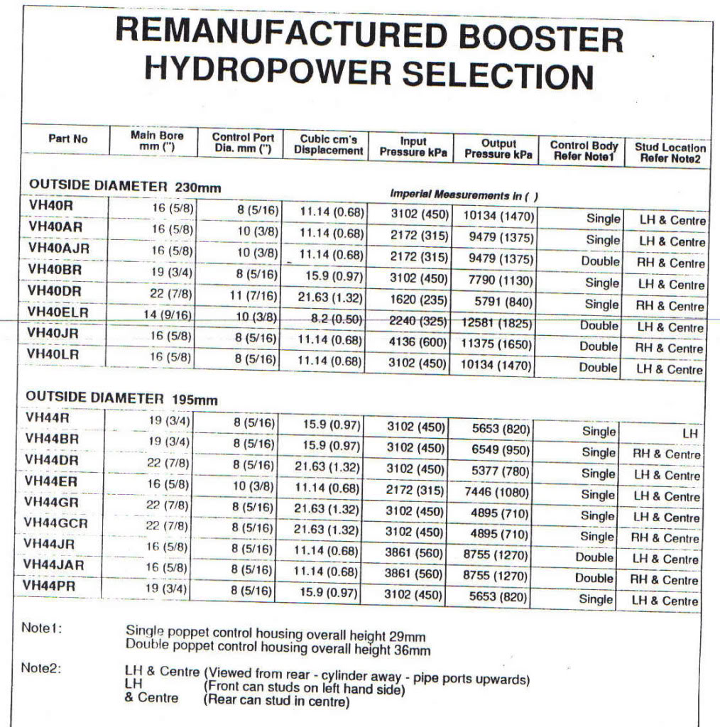

Brake boosters
Datto’s Hydropower Chart
Pros and cons of adjustable brake bias vs pedal box and balance bar:
I understand that a pedal box with balance bar allows real time adjustment or brake bias and is a far superior set up. This allows you to adjust the balance as the handling characteristics of the car change. Ie as tyres wear unevenly, but mainly due to weight difference of fuel. This however seems over the top for my application. Expensive, complicated and I’m a lazy frOcker so once I set it I probably wouldn’t adjust it again.

Your system is comfusing and has been done because of the V8 fitment and no room in the bay
That master is off an XA-B
Thats why the outlets are on the opposite side to normal Holden masters
If you fitted a balance bar and twin cyls you could happily delete those boosters out of the system too
The Falcom master is difficult to adjust and get the preload set correctly... its also not really suited to disc rear
The bottom piston barely moved when at full stroke.... might be OK for a Commodore piston size but .... I don't like them... might work with the nissan caliper ok
Its 1" .... as almost all Holdens and Fords were
With opposing piston calipers you actually require less pressure and volume to make them work... they are just better more efficient calipers
So no you won't need to go bigger
Infact with a balance bar and twin vyls you would go down to 5/8" front and 3/4" rear
More pressure = more stop
Fitting an adjustable valve with your system would require it to be fitted after the booster unit between it and the rear wheels
