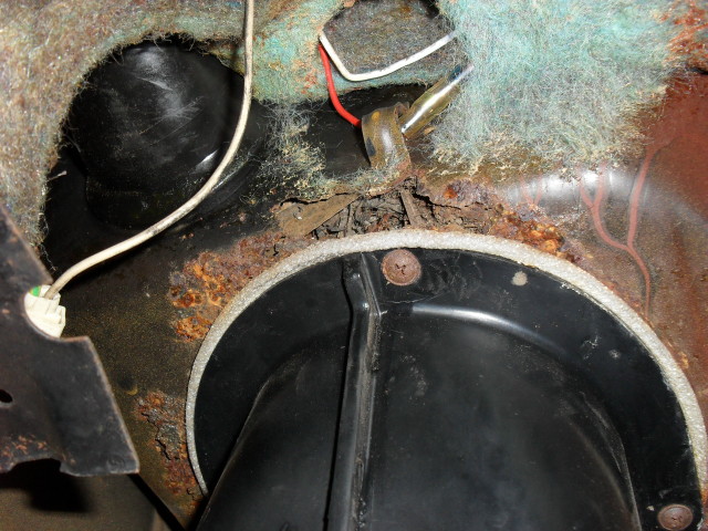

I scored a UC roller that was freakishly rust free, and have taken someof its best bits for my SL/R resto.
My plenum chamber is somewhat holy.... as shown:
So I butchered the MINT plenum from the UC....
005a.JPG 118.97K
5 downloadsI will do that repair soon.
