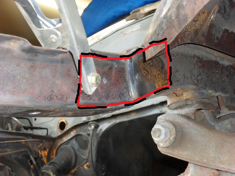

#53
_nial8r_
Posted 17 January 2011 - 02:47 PM
Red lines being the plate ( on the inside ) and the black lines the stitch welds
now to wait and see how it should be done, when Matt pulls his finger out

90 degree angles are the worst enemy of stress-points. Make sure you have a nice gentle radius on each corner.

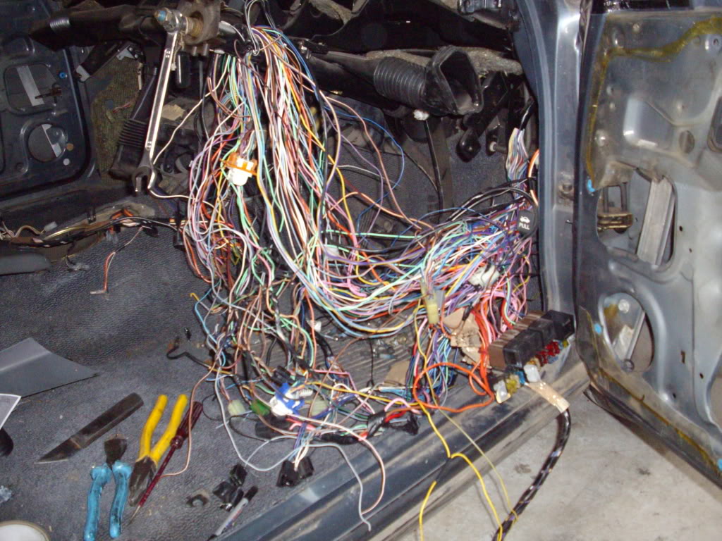

5 downloadsI've also started to strip the interior from my SL/R. All the dash and stuff is pretty straight forward.....
SDC12404.jpg 150.29K
3 downloadsHowever..... when it comes to wiring and auto-electrics, I panic and think OMFG what have I done. I guess i will worry more about this in years to come when I'm trying to refit it!!
SDC12403.jpg 157.35K
2 downloadsAs always.. more to come. Bought some parts from a guy up north and I have to make a road trip to pick them up next weekend
