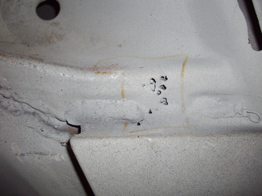

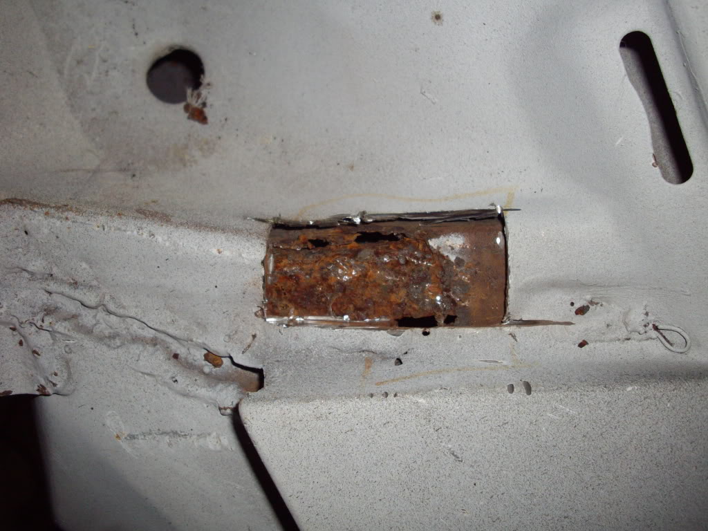

Posted 06 July 2011 - 07:20 PM
here ya go Anton it might make ya feel a bit better knowing i just come across this
i forgot that i had these few pins hole to sort out being the last of my repairs so i did the cut and found this
is stopped there as i have to make the cut a lot bigger as it not only goes in to the plenium but in to the cab aswell :surrenderwave: a few pin holes on top and a nightmare underneth :Headbang2: :Headbang2: :Headbang2: :Headbang2: :Headbang2: :Headbang2:
