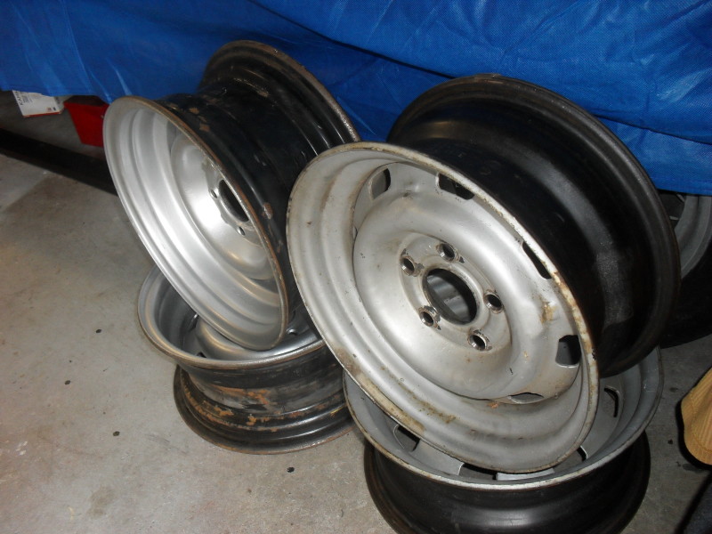

The car came with Hotwires, which I had always planned to keep and use. Upon close inspection, the fronts were a different style to the rears, and one of the fronts was out of round
I had 2 pretty decent stocko 13" steelies already, which would be OK on the front of an original resto, and 2 reverse center 13" x 6" popped up on eBay, which I thought would be perfect for the rears, so I snapped them up.
Here you can see the offset difference:
Then..... the most immaculate set of SL/R hubcaps popped up on eBay with a B-I-N price I thought was half their worth, so I snapped them up to finish the whole stocko look I am after. Apparently these were removed from a genuine black SL/R 5000 after 1 year, in 1978, and kept in a shed in country NSW until I bought them. I was VERY pleased with these.....
