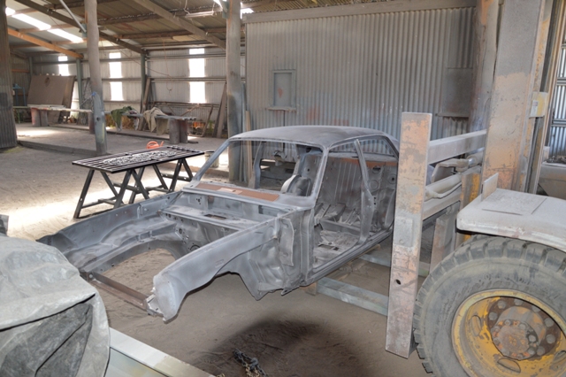

#252 _Hamster_
_Hamster_
Posted 28 December 2012 - 03:45 PM
mmm some dickhead forgot the camera.......
However:

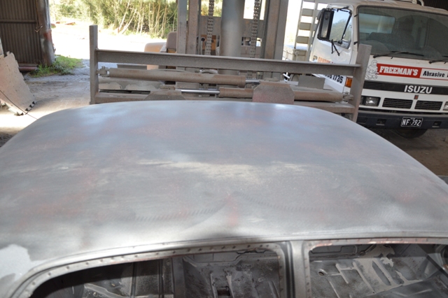

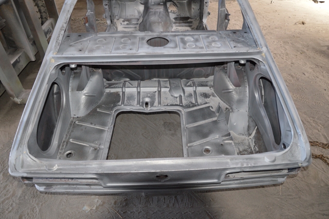

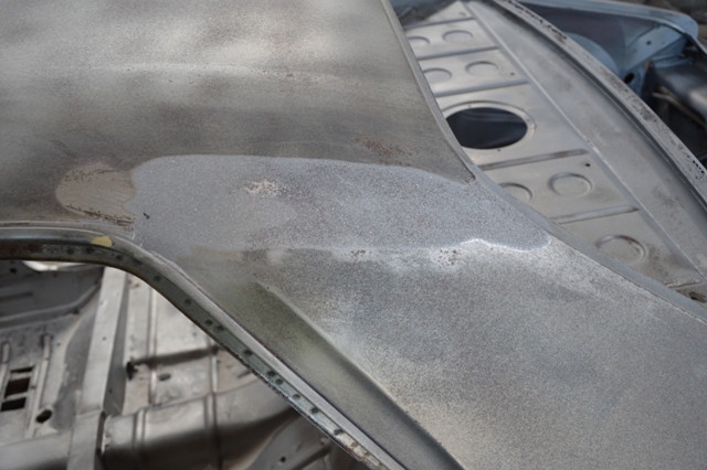

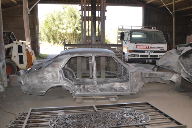

Roof is fine, still need to blast the underside of it but doesn't look like it will be an issue.
Rear panels: small section about 100mm long right hand side beaver panel. The place were i found the shitload of bog didn't have any rust its just dented.
Windows are all rusty some spots not so big and some spots longer than your finger(huge hole)
front isnt to bad were the rust was under the guards it didn't blow through any holes but it still rusty so to speak.
Underside of the car is fine.
Wheel well in the boot needs replacing i already new that.
Sills are only stuffed near the ends (front end). And a bit under the front doors (driver and passanger side)
i think thats it?
so not to bad considering, bit disapointed in the rear beaver section though but its all good.
He put a small dent in the sill with the forklift but he said he would pay for that.
Going back in the next couple of days to finish up and clean all the sand out/etch prime it and go from there. I will hopefuly remember the camera when that happens

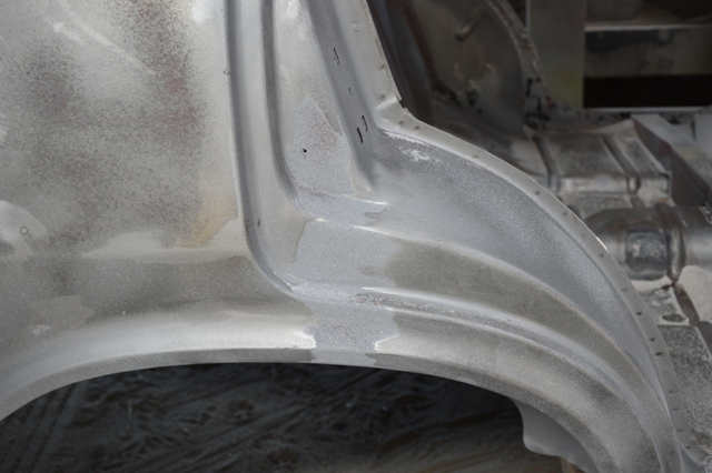

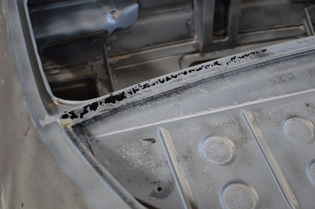

#253 _Hamster_
_Hamster_
Posted 29 December 2012 - 03:35 PM

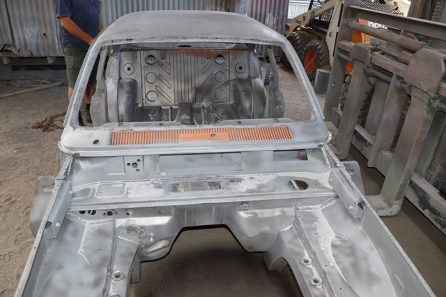

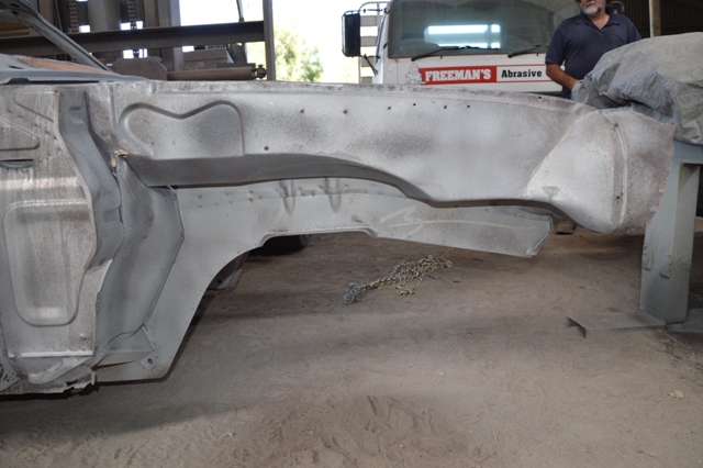

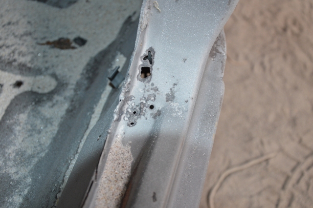

got pics today instead.

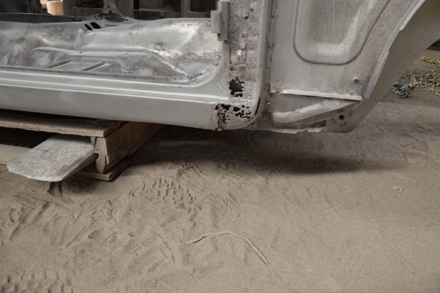

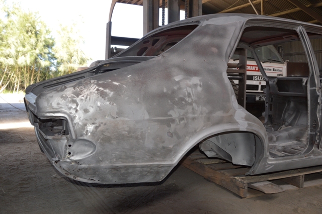

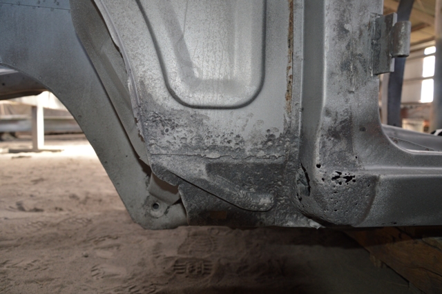

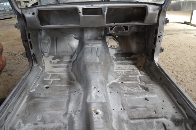

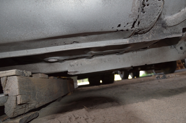

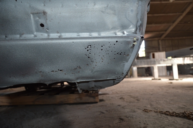

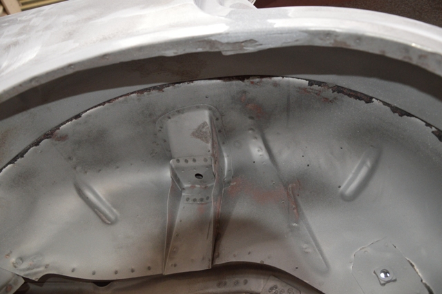

This is the panel i found all the bog in that time. Needs to be fixed but no rust so obviously had an accident somewhere in its life.
Boots good
wheel well in boot baaaad
The rear section i was talking about, not much in the over all scheme of things

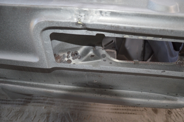

Bit of rust in right tail light
Worst bit around the windows (rear)
Right hand sill
Right hand sill, there is a dent there im assuming whoever had the car before put the jack in the wrong spot or something
Left hand side, the bit just in front of the sill (no idea on name) Has blown through a few holes nothing major. And the sill is same as the other side basicly

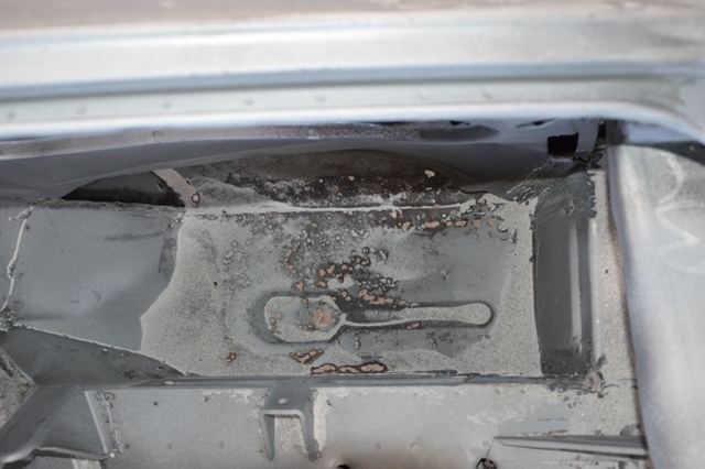

Lead wiping?

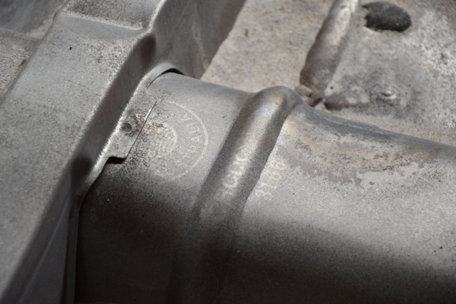

Logo thing i was trying to explain in shoutbox yesturday
floors are good
More lead wiping?
The grills a bit hard to paint apparently so we left that bit out.

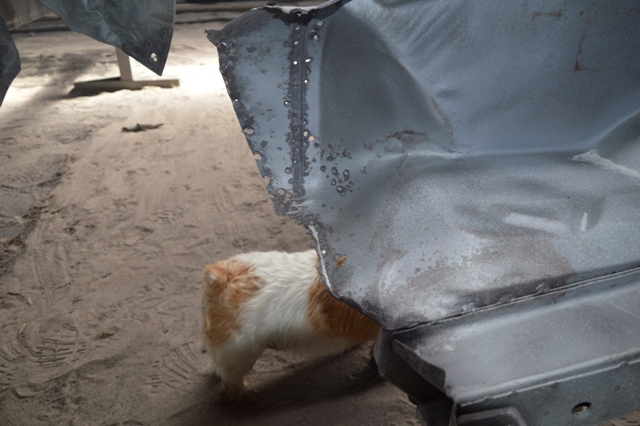

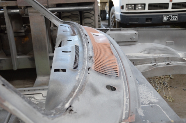

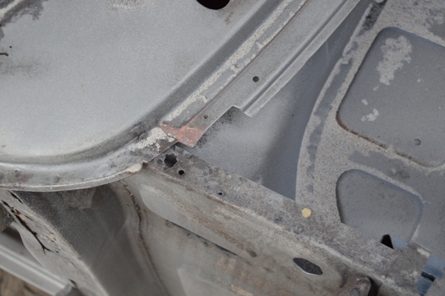

Bit of rust in were the rad support goes (and a fat jack russel)
All wheel arches and things are fine
Roofs good
Bit of rust drivers side door.
Bit of rust thar (front, just after that grill)
Front window isnt to bad compared to the back
Number 3?

What is that emblem thing
I dont know, sandblaster said he found on on a eh i think it was not long ago similar spot. Very hard to read and you have to be in the right light for it. Just says Australia in the logo and croc or crog (something) under it
so im asuming it would be on most holdens?
maybe not?
i have no idea to be honest.
(numbers under logo were 8166 from memory)
like the 3 under the front guard there is 27 written between the left side floor pans aswell

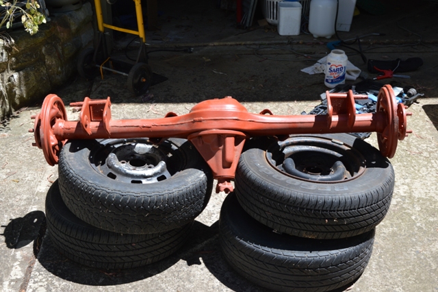

#270 _Hamster_
_Hamster_
Posted 04 January 2013 - 12:05 PM
best chess player in the land!
o_O

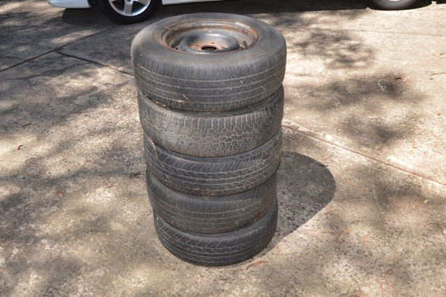

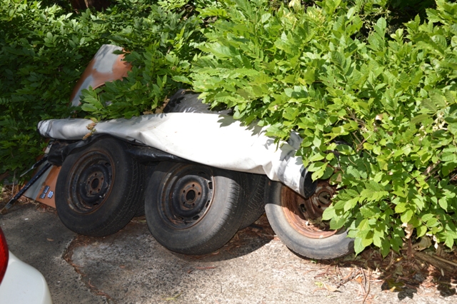

so the fun began today....didn't last long because its fricken hot but anyways.

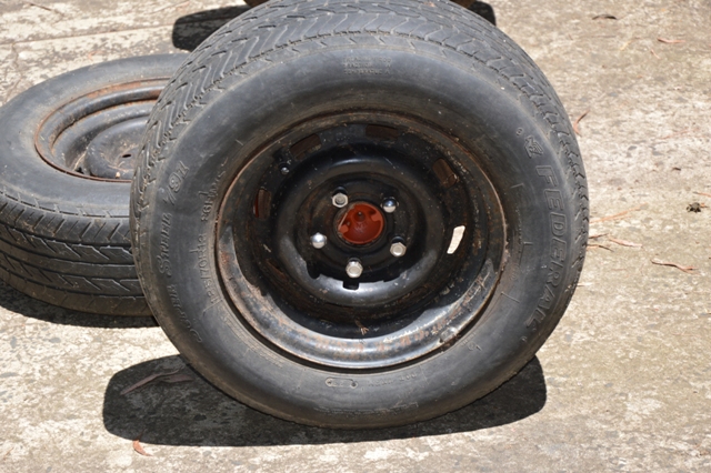

Found the tires
and.....thats about it
pumped all the tires up they dont appear to have any leaks....ill check em again tomorrow.

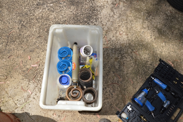

Found the springs and shocks etc.
Listened to the retro radio

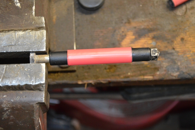

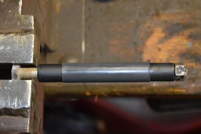

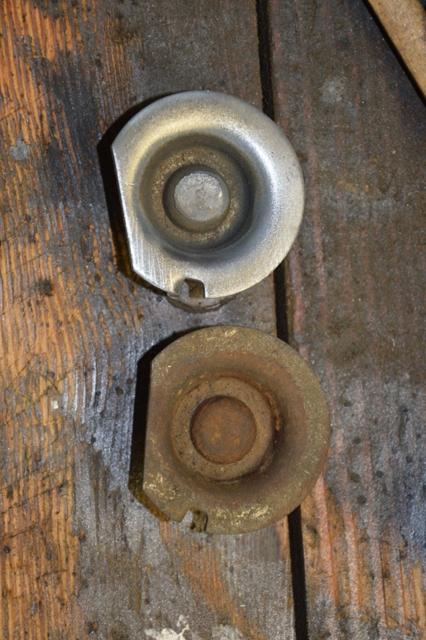

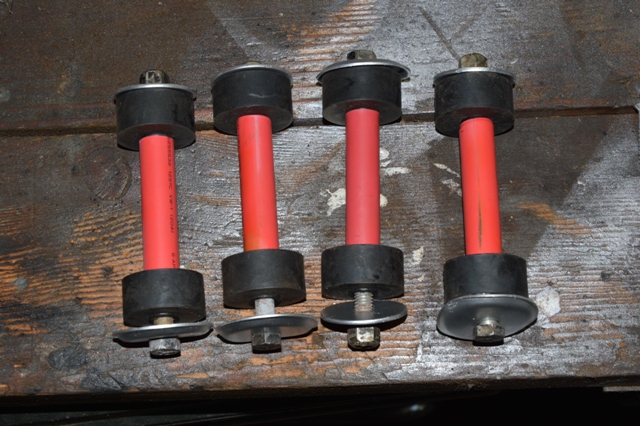

mmm need new rubber sleaves, new one we did with heat shrink (i think it was 2 layers)
But dad did a half assed job (yea we will blame him)
ready for paint (forgot to get pics of that)
More goodies (all the control arms)

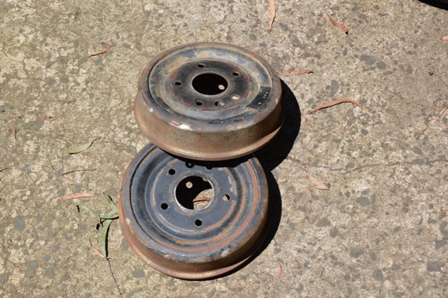

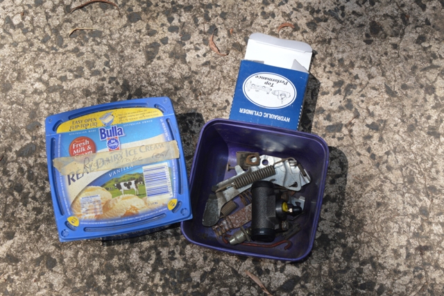

mmm might get new drum brake assembly what you mecalls it (can you buy them?)
Forgot to get those sandblastered

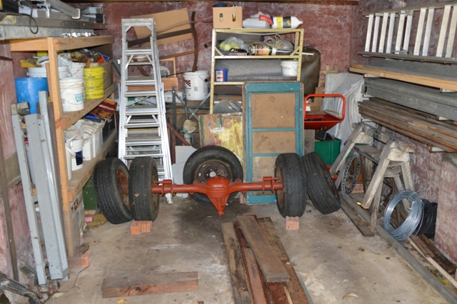

Found the diff
Wheels be on
And put it all were my brothers car goes because im such a nice guy.
Front end is all together just needs to wheels, im gonna put the rear brakes back together after i see if i can buy all new bits
Thinking of putting the steering wheel on aswell to make it easier to move around im not sure yet.
And don't know if i should buy new bolts/nuts for control arms and were the front end bolts onto the car itself.

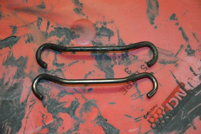

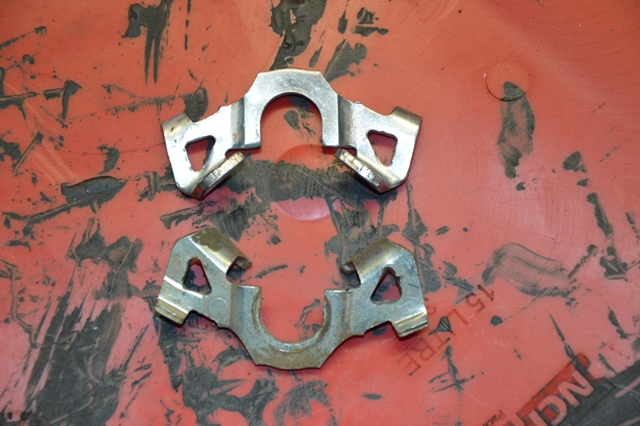

#271 _Hamster_
_Hamster_
Posted 04 January 2013 - 02:05 PM

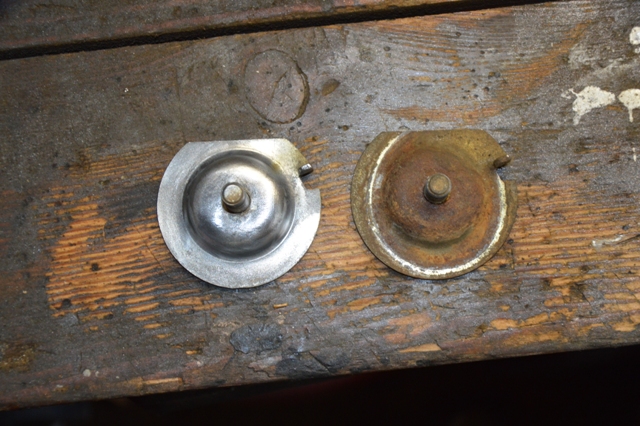

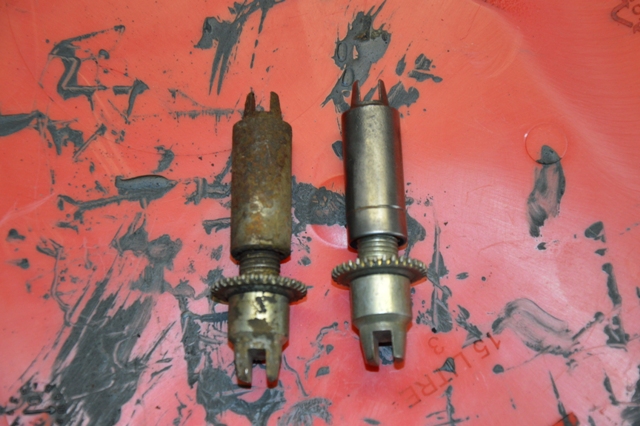

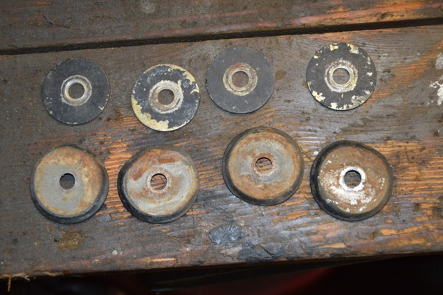

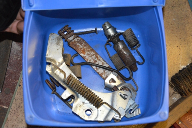

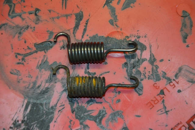

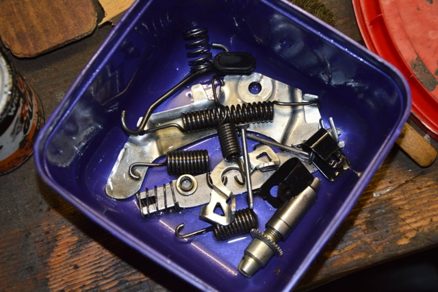

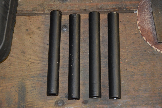

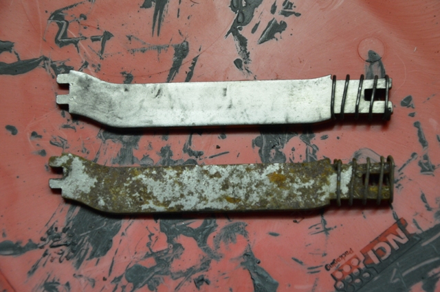

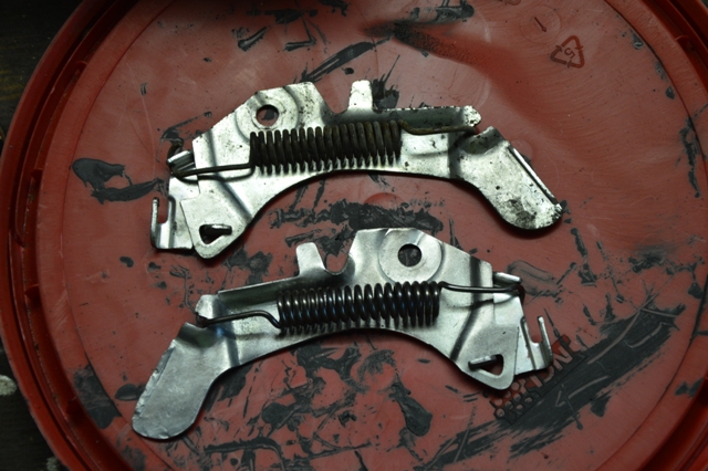

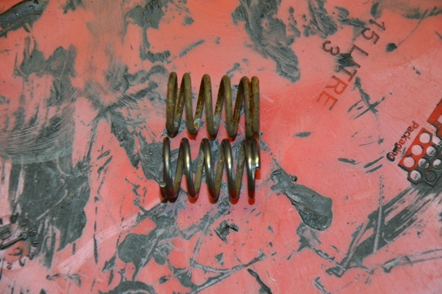

ok i cleaned up the things for the drum brakes (no idea what to call them)
Came up ok. Not sure if i should paint them or fish oil them or what....most of it wasn't painted to begin with.
(i did a comparison of the part from the other side)

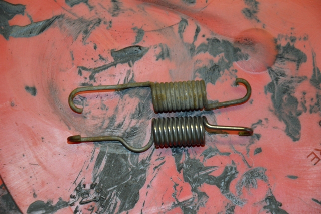

I pulled the spring off this, i would recomend not doing it because it was a prick to get back on.
These are the bits i forgot to take a photo of before, do another coat tomorrow.
Clean bits
Not so clean bits
Thats the crap i used to paint the tubing.....not sure if its the right stuff or not but anyways it'll do.
Edited by Hamo, 04 January 2013 - 02:06 PM.
#272 _Hamster_
_Hamster_
Posted 05 January 2013 - 01:08 PM

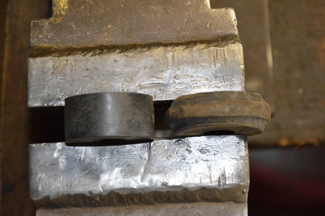

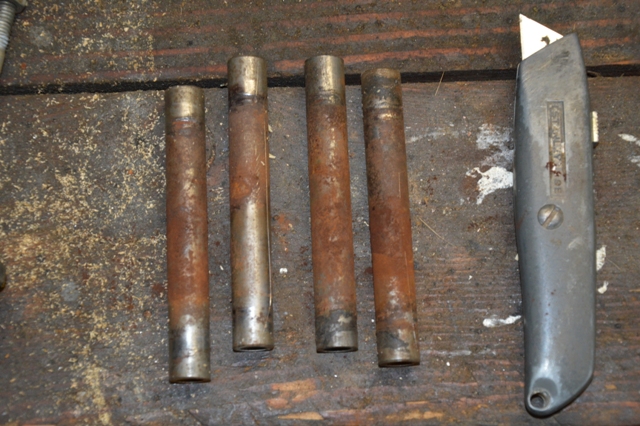

Ripped the shed down and found the heat shrink finaly!
I was originaly using the hair dryer but it sucked and didn't do much so i used the gas torch.
Just the 2 layers

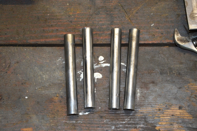

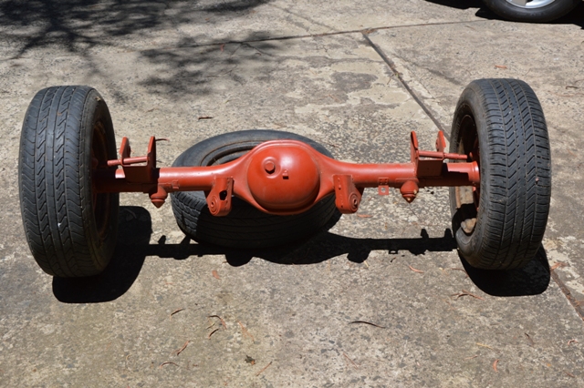

Time to clean these up
Old rubbers vs new rubbers
Rear spring thing
Hard to get in the little divit but
Got it all out in the end
Finished front end
Just did 1 coat on them....prob gonna get scratched and everything pls they will be redone with the engine bay i would assume

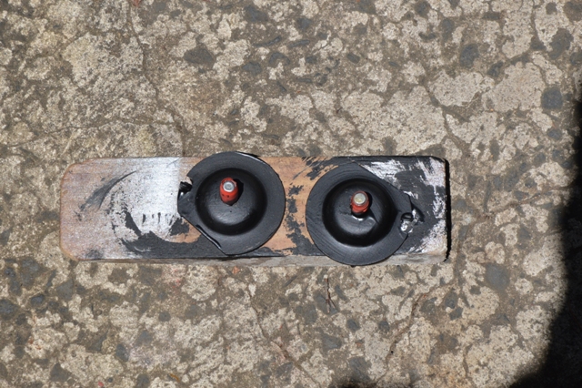

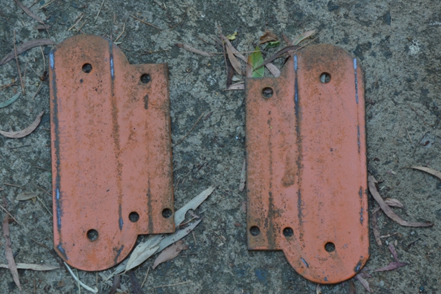

Painted them with the left over rust stuff......horrible paint job i need to go to supercheap and by one of those spray guns me thinks.

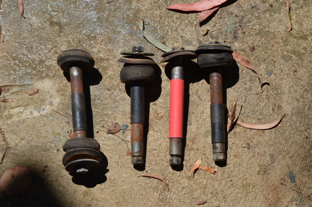

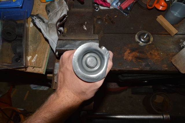

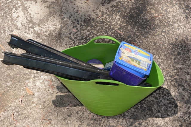

And i have no idea what these are for?

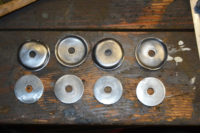

#273 _Agent 34_
_Agent 34_
Posted 05 January 2013 - 06:27 PM
they are off a K Mac rear sway bar as i have the same set up. the bolt holes on the " round section of the plate" bolt to the trailing arms as you can see the in print of the rolled section of the arms.
the other part is where the sway bar bolts to, it's one " U " bolt and the other end just a bolt.
where is the rest of the bar.
they are still in operation in sydney. BUT some guys have had problems with the quality of the finish. I just got mine powder coated.
they still sell rubbers for these items as well.
both front and back.
three cents.

#274 _Hamster_
_Hamster_
Posted 05 January 2013 - 07:03 PM
We did a quick blast and painted in on thursday....etch primer i think it was longest part was cleaning up all the sand lol.
Im possibly going their tomorrow to put the whole front end back together (and rear) so ill get pics of it then.
We just did a really light coat but its all what the panel beater wanted for when its his go so yea.
And thanks, im gonna need a swaybar soon so ill look into the different brands....shame about k macs quality.
thanks
