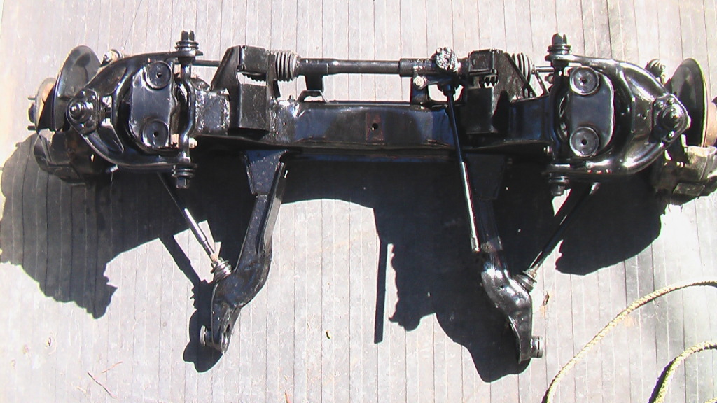

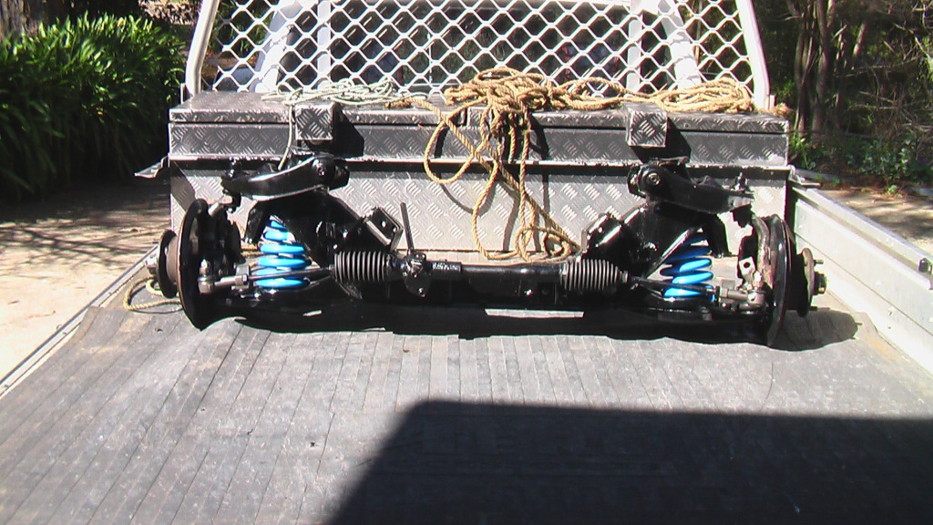

Mr ray shelby finished front end.
Rebuilt rack had to modify the front end with a few things bent out of place, put it all together and painted it for me.
550 dolla.
Not to bad, pick it up tomorrow post picks then.

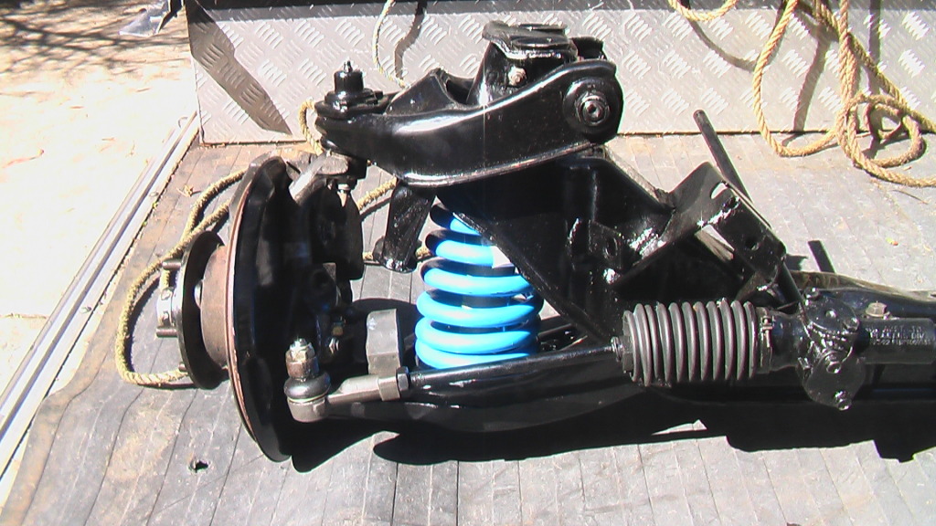

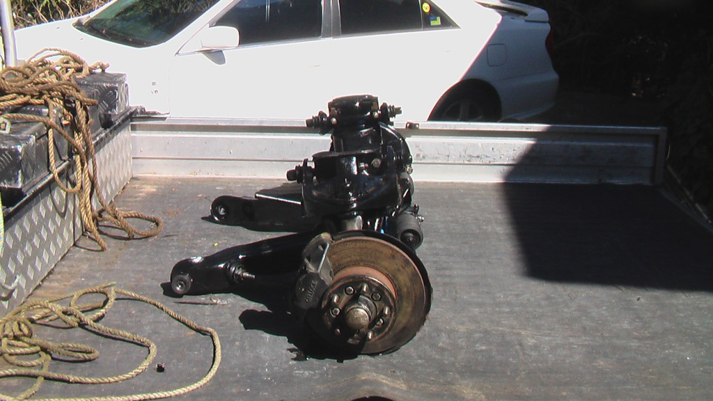

Anyways picked it up, he kept the old shocks for his morris minor (he has about 100 of the things no idea which one)
Should shiny up the brakes. Or get new ones.
Reco'd steering rack.
Put it all together.
Straightend lower control arm things (near the balljoint) apparently most of them bend out of shape which effects the camber or something (to busy coughing/blowing nose at the time to fully follow it.
Bit of paint
Springs wouldn't fit in upper tower, made them fit (ground some off the spring)

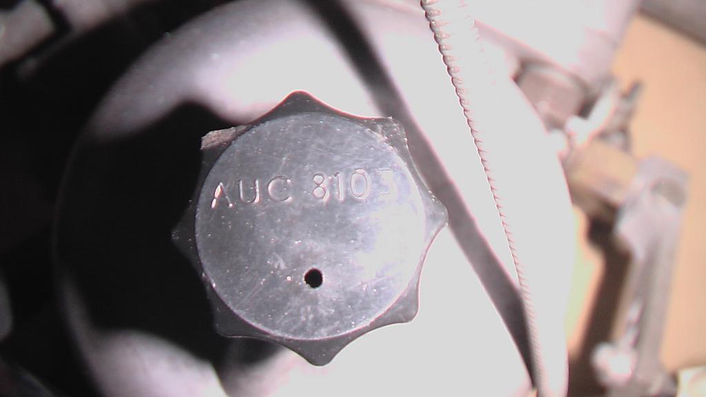

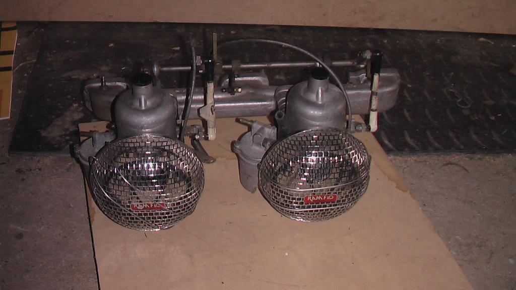

Got my twin su's back. Wondering if anyone knows any info on them numbers i found were AUC 8103 (top of bowl)
And : Aud 9203 (on the side bowl thing)
Get more pics of them if i need more. Not sure if im gonna sell them yet but im getting tripple somethings (sus/stroms/webers)

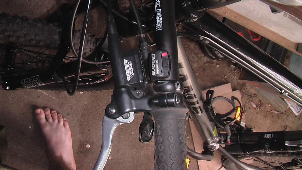

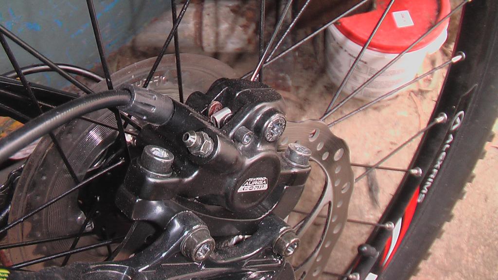

In other news started riding bike again to try get fit and i needed to service the brakes.
But being hydrolic brakes i don't think i will attemtp it myself. Prob same as a car though with bleeding etc but....yea no idea.
Note my japenese safety shoes.
#219 RIM-010
Posted 26 October 2012 - 02:12 PM
What could possibly go wrong with the bike brakes? Get in and have a go bro, you're not going to learn anything by letting someone else do it!

Posted 26 October 2012 - 07:55 PM
you bleed em backwards, you usually have to buy a kit

The number you have shown is for the individual part #. You need to measure the throttle butterfly eg. 1 1/2", 1 3/4" etc.
Oh ok....Never would of known that lol
Bike is worth quite a bit of money i think it was a few k when i bought it so i would rather know what im doing properly or get someone else to do it.
Prob a dumb question, but how does one do that?

Remove a carb from the manifold & measure the throttle butterfly with a tape or ruler.
