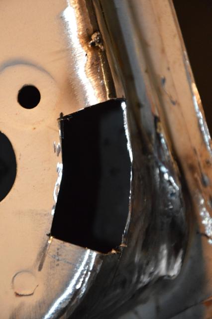

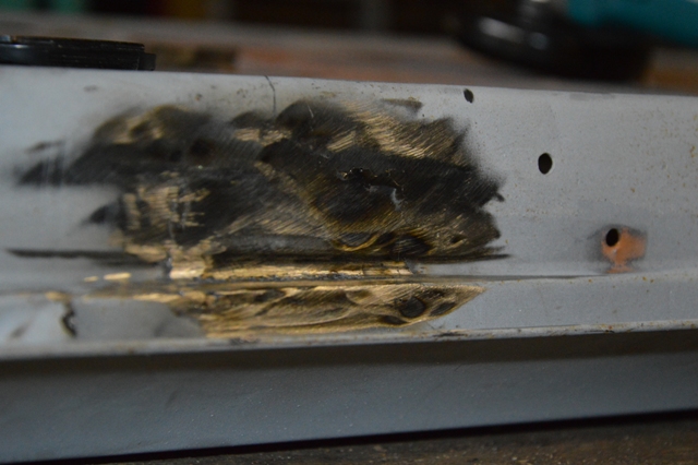

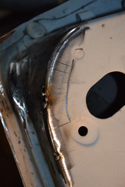

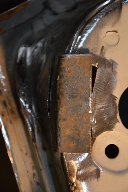

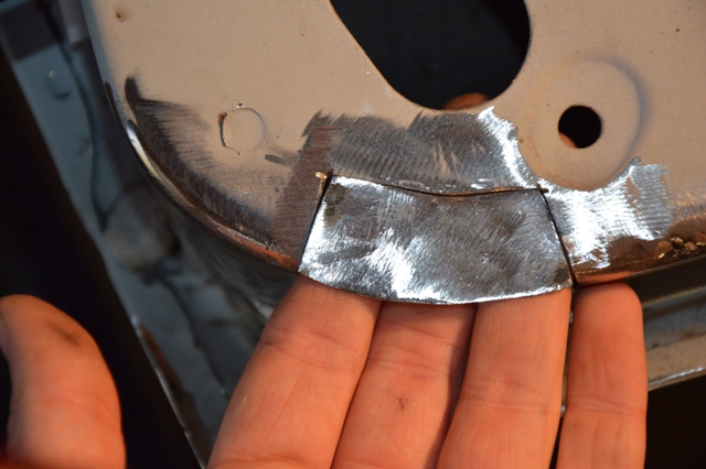

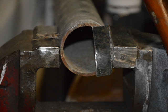

So marked it out, there is that overlaped bit in there someone so to be safe i went in a bit more. I did it 20mm from about 5 different spots and join the dots thinking it would be easier in the long run.
You can see how the bit right up the top is thinner some how.....
Not the right angle but that bit is 2mm of steel the center is about 1.5mm ish give or take 1/4 of a mm

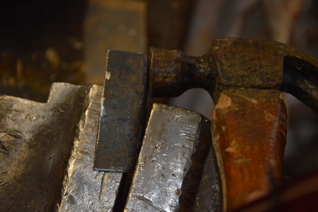

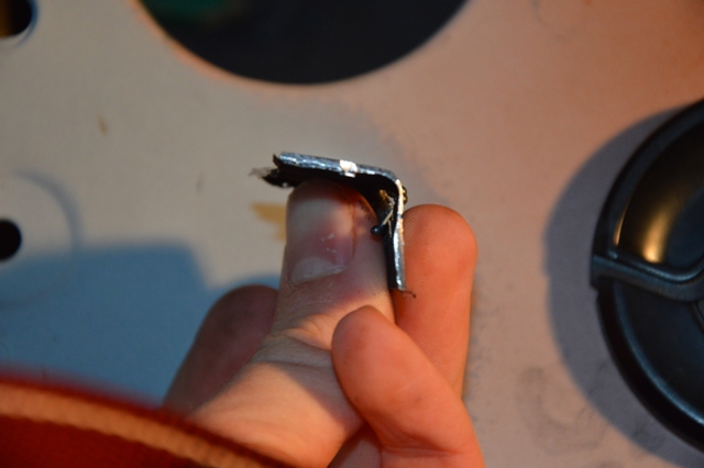

so i bend the 90 degree angle in it thinking it would then be eaier to bend the smaller bend thing bend up in the bend thingo.
After trying with a couple of pairs of plyers and getting one of the sides bent and the other one more or less flat. I went ape with theorys.
So i tried doing this, as you can see tis only bending the one edge.
The bottom is good, rest isnt.
THEN i tried doing this, also didnt work.
so i put it in the vice and smashed the shit out of it and gave up for the day! :D
so question time.
Can i do 2 sections and join them on the bend with weld or is that a no go cause it would be structuraly not so good?
Im assuming you would do this is one of those 2 wheel thina majigas, would be it worth making a rough fail version of one of them if question 1 is a no go.
Also i dunno y but some of the images have flipped themselves over so.......yea photobuckets playing tricks on me.
Edited by Hamster, 29 August 2013 - 04:19 PM.
#462 _toranatime_
_toranatime_
Posted 29 August 2013 - 06:27 PM
for curves like that a shrinker/ stretcher is the go, but it can be done by hammering a lip to stretch where you want it, which will put a curve in it. joining thwo pieces together is plenty strong enough, you just need to be careful with the grinder. It looks like you have ground through the full thickness of the material and most of the weld. when fitting up a join like that try aim for an outside corner joint.
keep at it
#463 sibhs
sibhs
  • 2,724 posts
  • Name:Martin
  • Car:LJ Coupe S
  • Joined: 27-July 12
Posted 29 August 2013 - 07:27 PM
Just cut a line in the straight edge so it will bend then weld the cut. May have to cut a v shape. Hope you know what I mean. Very easy fix.
#464 _Liam_
_Liam_
Posted 29 August 2013 - 07:46 PM
If you don't have a shrinker/stretcher, make it out of two pieces.  Forgive the bluntness, you are wasting your time trying to shrink/stretch something like that with hammer/dollies.

Dad found a local panel beater that ive never seen or heard of in my life. Sent him an email i think he was gonna look at the car next week. I told him if i have my door done ill get him to look at it see what he thinks and i might be able to do a few of the easier things to save a bit of coin.
possibly get some of the door done this arvo. Tomorrow im apparently helping the neighbours move (only found out about this like.....yesturday which is handy, but he is irish so....free beer?) And apparently on sunday im going to woolongong to look at a new jack rusell which i only found out about yesturday as well. Kind of a pain in the arse i was hoping to get some bog and finish up most of the door. SO depending on when the guy looks at my car i may have most of it done.
And yea joining the 2 bits seems to be a GOOD IDEA lol.

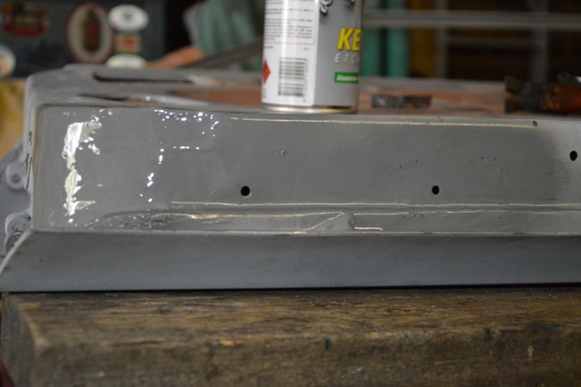

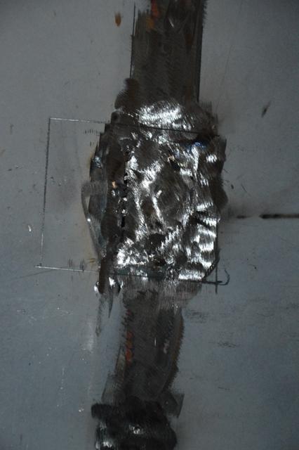

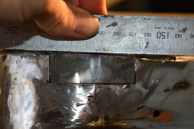

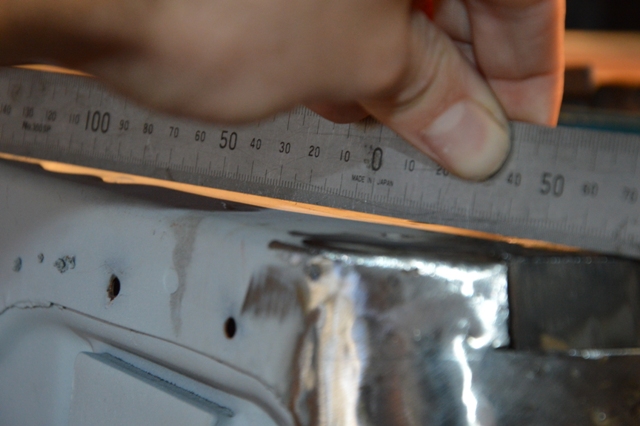

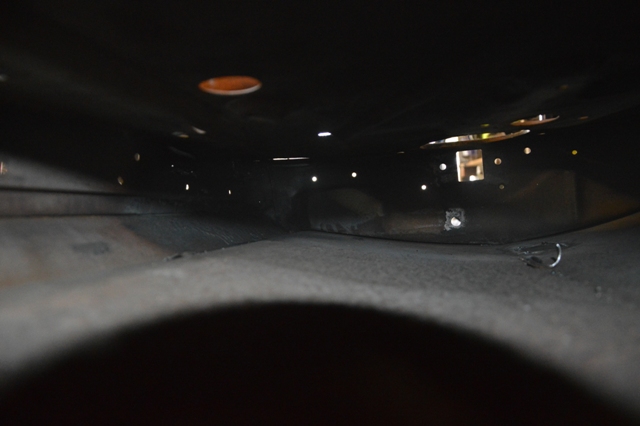

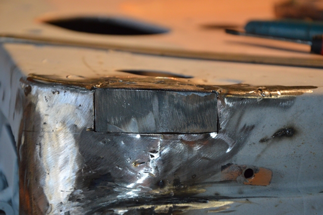

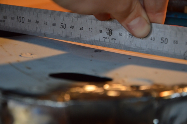

Tiny bit to long, i can't hold both bits to line them up. So ill weld this one in and grind it back.
Other bit to go in, kinda looks like a small ridge in the middle.
Ruler says kinda not a small ridge in middle ;/
so i went to check the other way and measured away from my new spot to check the whole door.
WTF
Kinds looks similar?

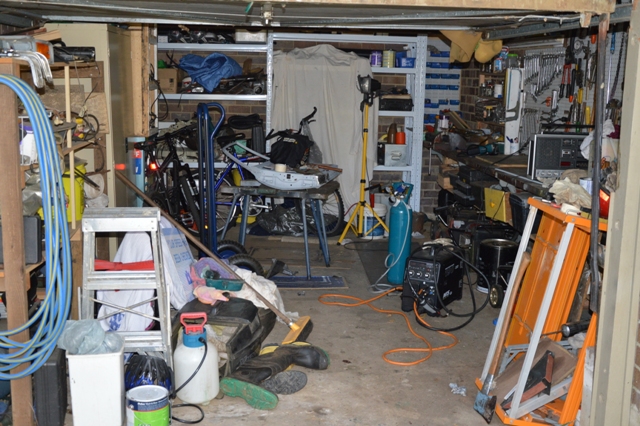

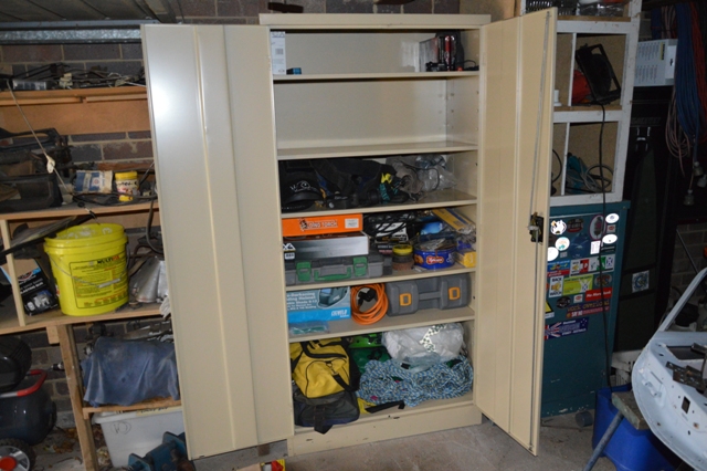

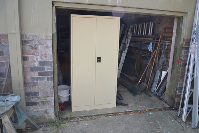

So helped irish man over the road move house the other day, scored 100 bucks and a cabinet.
Will replace the wooden one and the locker.
(as you can see its a messy garage)

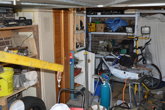

managed to man handle it in there, getting the others out was a pain, i left everything in it so i wasn't double handling but with the roof frOcking low it was an ass of a job.
It wasn't me officer honest.

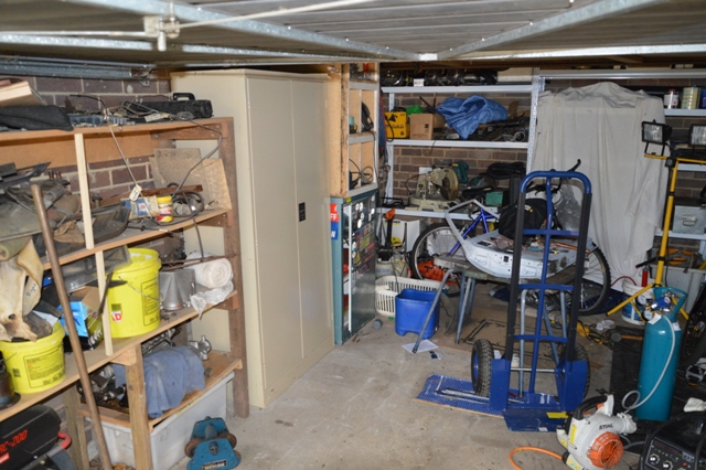

so much more room for activities
there was a bench under there from memory.

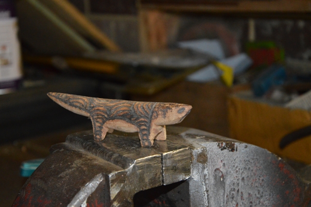

My new pal......................................................Thin lizzy.......so we will call him phil lynott
so.....well frOck its not really much better is it?
https://cache.gmh-to...zps06db98aa.jpg
Junk goes here and we have no room for torana again.
FAR OUT

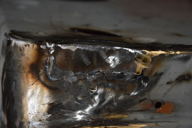

Posted 06 September 2013 - 12:23 PM

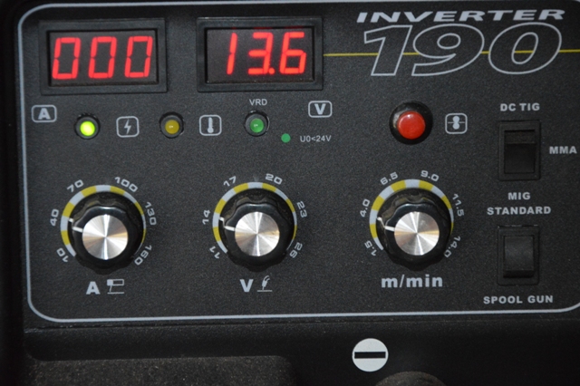

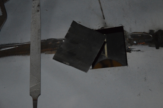

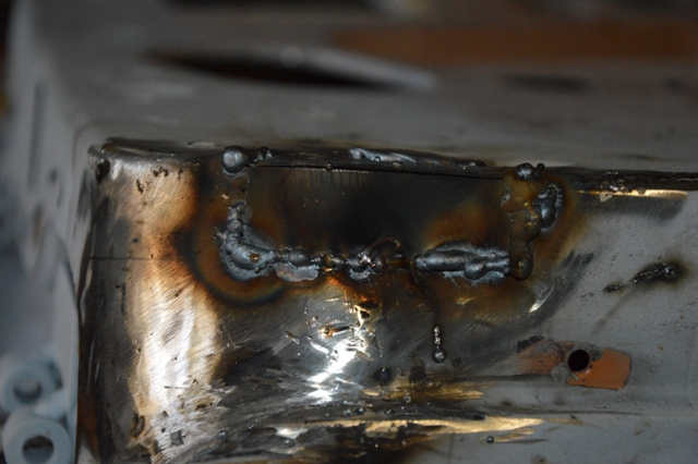

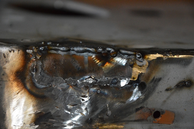

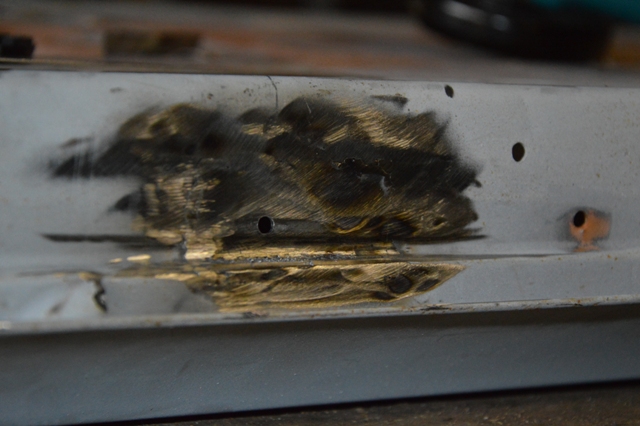

Daaaaaad can you adjust the welder for me.

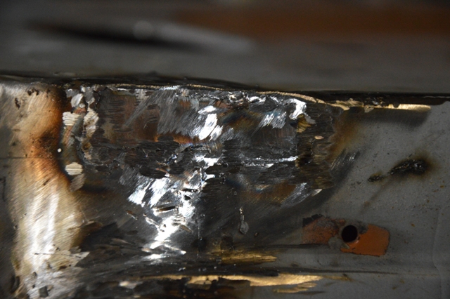

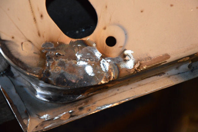

Neck minit massive hole (fricken boiler makers). He filled it up so its ok. (sorta)
Actualy appears to be working better to what i had it set at.....I think. It's "cracking" more often aswell.
Bird shit welding 101
Forgot to cover up my million dolla bike, no damage done thankfully.

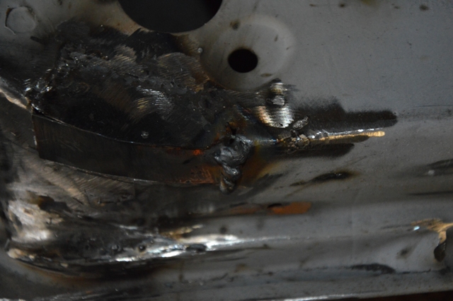

Learning learning....Didn't grind down to the metal to much, Ground back the lip level with the other.
Welded up the lip
Some more grinding. There is a slight bump/ridge up the top, i managed to bang most of it out, there is still a bit there but.....It's inside the door and something will cover it up. So it will be fine (im guessing) The curve/bend is straight so in theory the door should shut ok.
Previous job (prob my best patch on the whole door so far)
Needed the hole for the door rubber so i put that back in.
Paints a different colour......oh well.
Tried painting the inside......I have no idea if i got it or not ;/
Redo this one cause its rubbish
Cut some metal with the tin snips and prob do that over the weekend when im bored.

#473 N/A-PWR
Posted 06 September 2013 - 12:53 PM
Hamo,
with Tig welding, have the tip doing a circular motion in your right hand travelling towards your left hand with the left hand holding the Tig wire in the heat till you see it drip onto the metal and the circular motion blends all together, hope that helps. Dave I
hmm, he did not do any circular motions hey, oh well any way will do
Edited by TORYPOWER, 06 September 2013 - 12:59 PM.
#474 _toranatime_
_toranatime_
Posted 06 September 2013 - 08:57 PM
you don't so much want to drip the filler onto the base metal but more 'feed' it directly into the puddle, adding the same amount of rod every time.
The rough settings I would use for a start:
-2% lanthanated or thoriated tungsten 1.6mm or even a 1mm
-6 or 7 gas cup using 7lpm of straight argon
-Around 40 amps
- er70s-2 filler wire

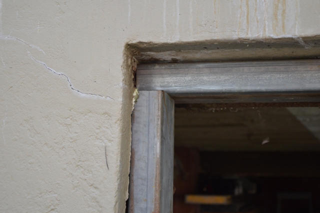

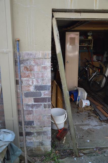

I managed to get dad to agree with putting a new door on the other garage (no idea if mum has agreed to it but its to late now)

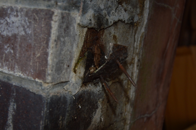

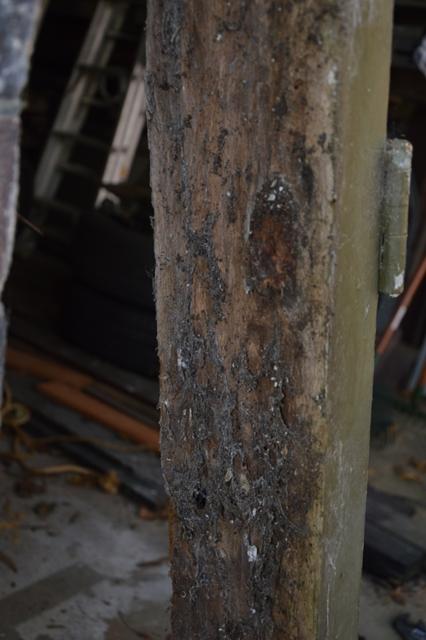

Removing the old rotted frame.
Prob the better looking piece
......Only thing holding it on the wall lol.
Couple of mates
Cleaned out the dirt, rotten timber, pins etc.
(i know it doesnt line up, its soo you see how it fits)
And its a bit narrower than the other one which suits me fine.
Gonna weld tabs to the side and bolt it to the wall, there is a big steel beem holding the roof up, take the center bit to that in.....8 spots or so. and we should be sweet. Metal is a bit how ya going cause its been sitting out in the weather for a few years, i suggested to dad i can grind it back and paint it but he doesn't seem to worry about it so i won't.
Doors........................I'll leave that up to them, whether its in iron or wood or w/e.
But yea once doors are on and i can lock it up half th shit in the other shed can go in there or i can work in this shed and have a shit load more room its not even funny.
