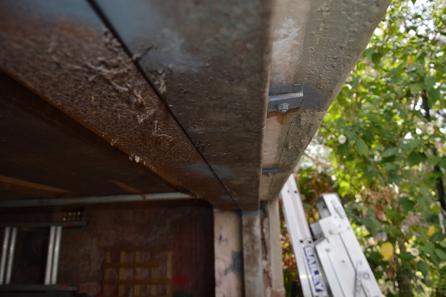

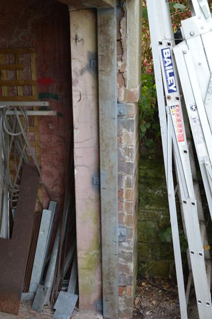

Did the frame around the door, its all bolted/welded ill get picks possibly tomorrow.

5 bolt up the side.
2 up the top and taked to the beem.
Just gotta figure out what door they want. and render the bit that looks shockers from there the wood used to come too.

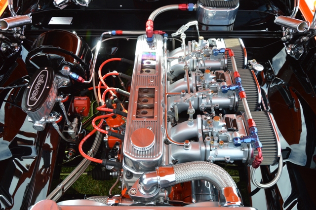

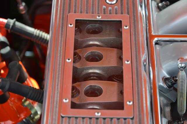

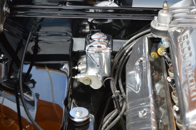

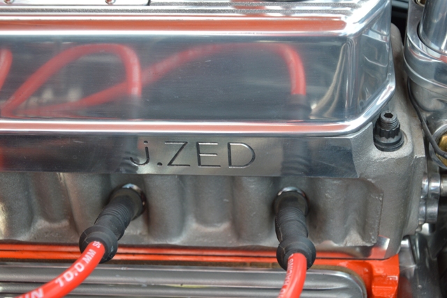

Prob one of my fav engine bays. I like those manifolds being seperate than the full one all linked together. Kinda looks better IMO.
Tappet cover was pretty awesome.
Not sure if brand or what, didnt see anyone hanging around it to look like the owner but ow well.

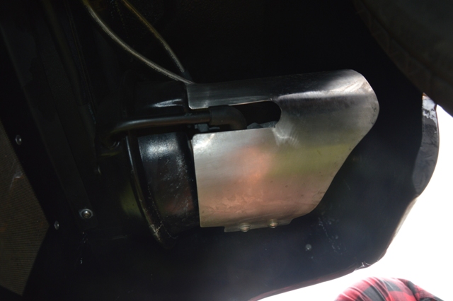

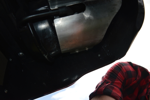

I was also toying with the idea of hiding the break booster somewhere but i didn't know where.
(that is off another car, we won't mention what type of car on a holden forum) It is like that soo the pips can just go straight into the body rather then hang out in the engine bay.
My fail attempts of getting a pic. The booster is hidden infront of the front wheel inside the guard. The bracket holding it there is bolted in the same spot as the bumper bar i think he said.
So thats a possibly idea for the booster eventualy. Still toying with the idea of ditching the heater box and all that crap too and getting something to hide under the dash.
Annnd because the rare spares one i  got was pretty much a piece of junk to put it lightly, i got this from the usualy boys at muscle car parts.

love thoses heads. yeh mate. j zed is the brand. not cheap either

Yea website isnt working for me at the momment so ill have to check later.
Do you know if that manifolds from them aswell?

Yeah that's a jzed & the manifolds are for that head only you'll see it all on their website..not cheap lol.
The master cylinder is ford xb(?) got that on my lc...if you have rear discs you'll need two remote boosters,ask datto.

Yeah JZED heads are the sh!t Hamo.....I'd love to have one.

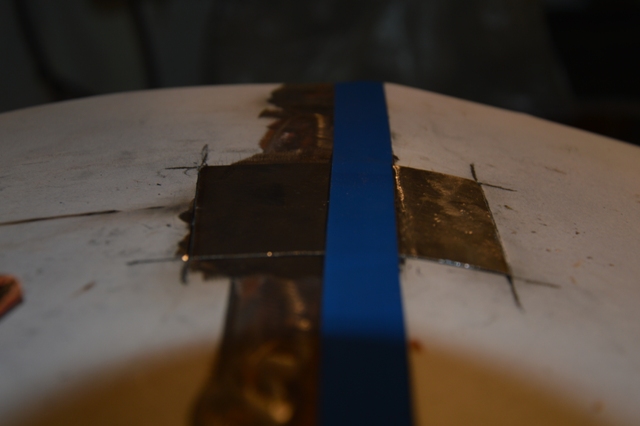

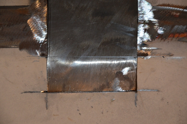

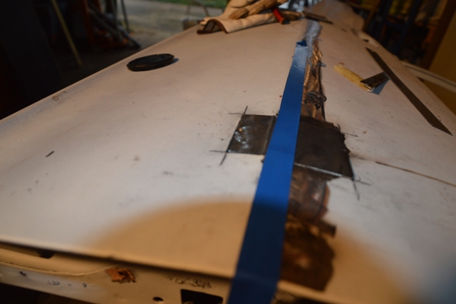

But did a bit on the door.

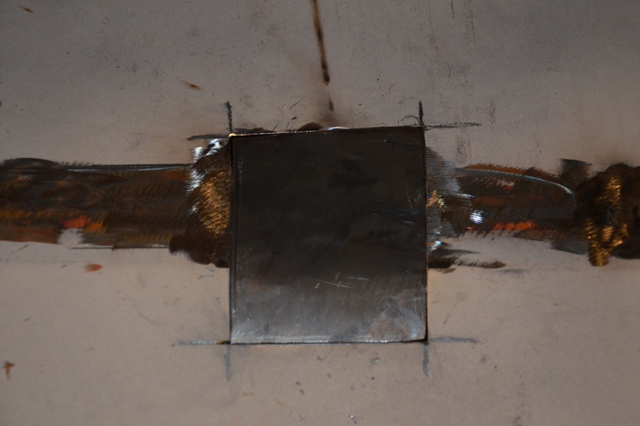

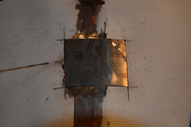

So made the piece fit.
Just needs to be bent and a few more tiny bits grinded back.

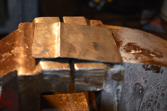

First bend attempt kinda failed
No idea how i did that, kinda cool if the whole door had a lip like that.
Electrical taps underated.
Not to bad you can still see a faint bit of where i did that big lipd bit that ill prob have to bang out before i weld it in.
Just a few tiny wieny more bends to make.

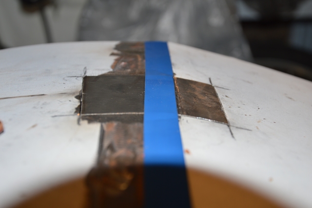

More junk yay.

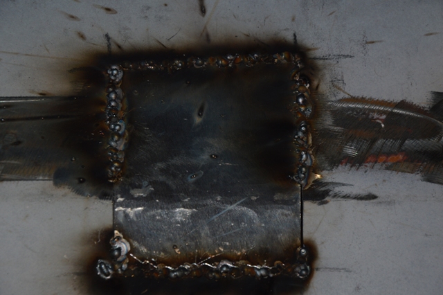

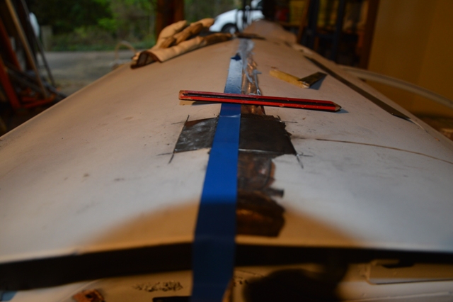

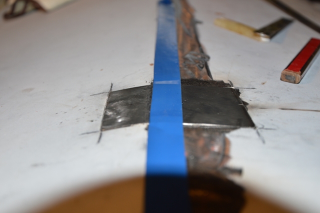

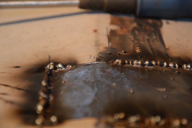

poped it in with my terrible welding skills
My little bend ended up being half the thickness of the metal out. So i dunno if i should redo it or is that ok to skim over with bog?
not too bad.

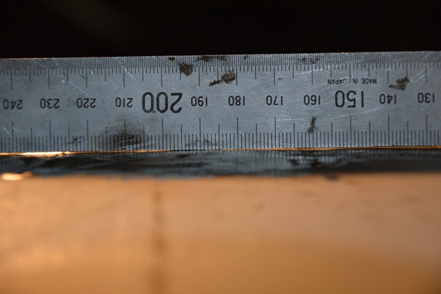

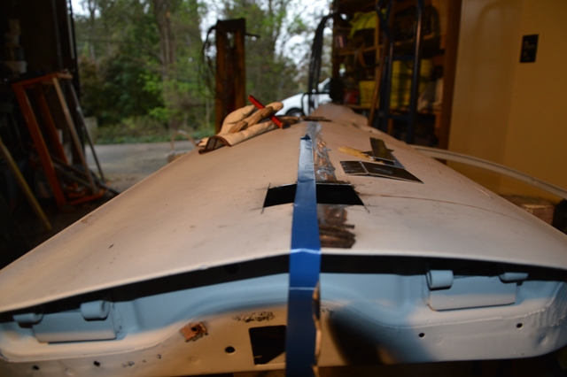

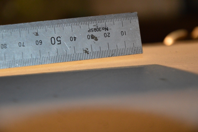

So i put my trusty rule on the end of the door (end towards the engine bay) and the other end of the ruler sticks up this high in the air?
Whole door is like that so does the door tapper or is it just a really #@$^%& up door?
