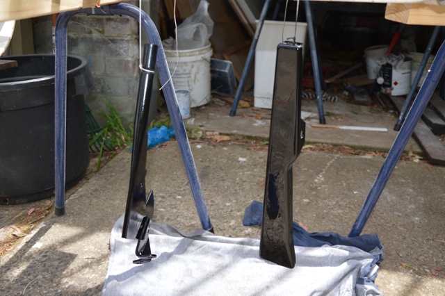

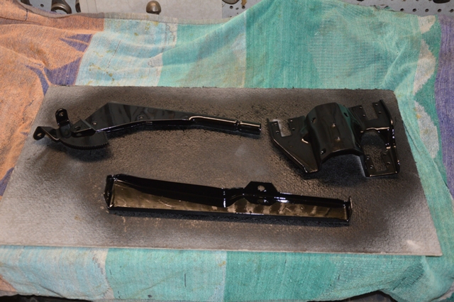

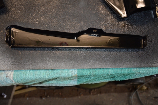

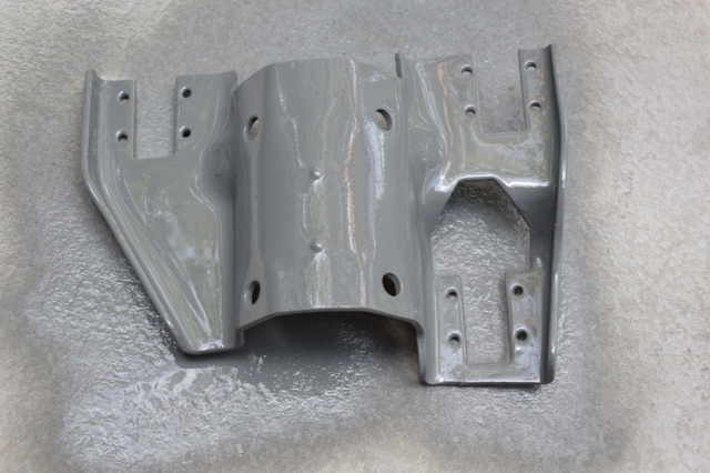

anyways dad bought me some paint which was just the same stuff i used before.....which seemed to work so yea.

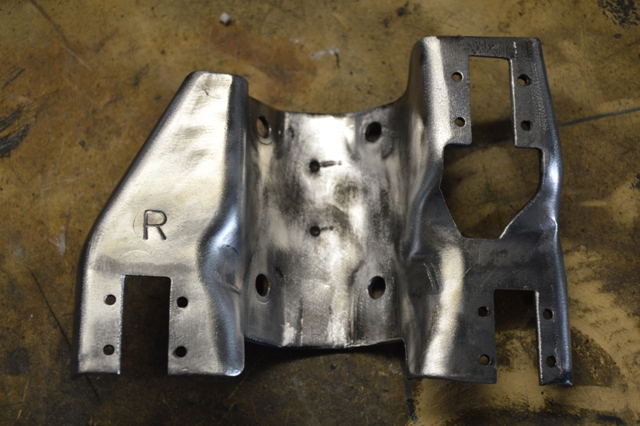

So i sanded back these terrible things to clean them up a bit.
And realised once again i suck ass with paint and i put to much on and it has run lines down it sooooooooooooooooooooooooooooo ill have to do that again. (i saw everyone else hang there bits for painting so i thought i would try that too)
Then in rage i pulled a bit off the steering collum and attacked  that.

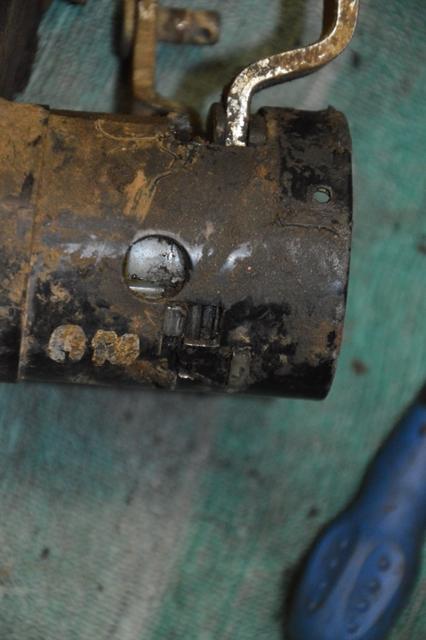

I'm assuming thats glue.....I got rid of it ill reglue it and if it wasn't glue.....i have no clue wtf its for.
still had to do a few bits by hand as usual.
to much paint again i guess......bonus is it has no run lines though. (then when i did the other side it had run lines sooo.....spewin)

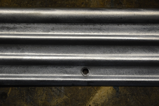

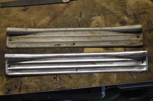

then i attacked the kick panels.... I dunno what they are suposed to look like original if anyone has a pic?
Bit more work on em and they wont be to bad
#578 _Quagmire_
Posted 01 November 2013 - 01:32 PM
many light coats hamo...

dont worry too much if it looks terrible when u put paint on ,give it time to settle and you will be surprised,if ya got cardboard box
hang it in that, away from the dust for a couple of days

Make sure if they are hanging you don't go too heavy as gravity will create runs. Apart from that you would be surprised the finish you can get. I hit a fuel pump cap with aerosol and it came up like 2k glass. Nowhere near as tough just goes to show how smooth and clean the surface has to be

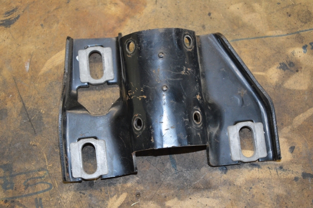

#585 S pack
Posted 01 November 2013 - 10:29 PM
Hamo

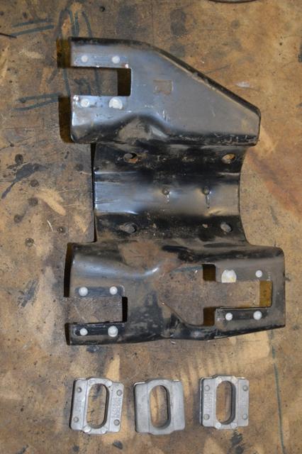

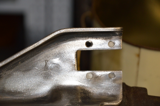

Plastic injection to hold the breakaway capsules in place on the column mounting bracket.
I reckon a hot melt glue gun would replicate that nicely. May need to heat everything up so the hot glue doesn't cool too quickly when it hits cold metal.

Yea i was just gonna dab a bit of glue on them, they came off pretty easy so it wasn't doing much. Unless someone had it off before im not sure.

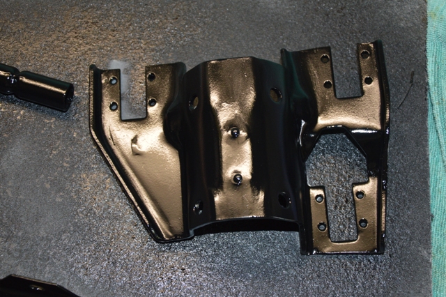

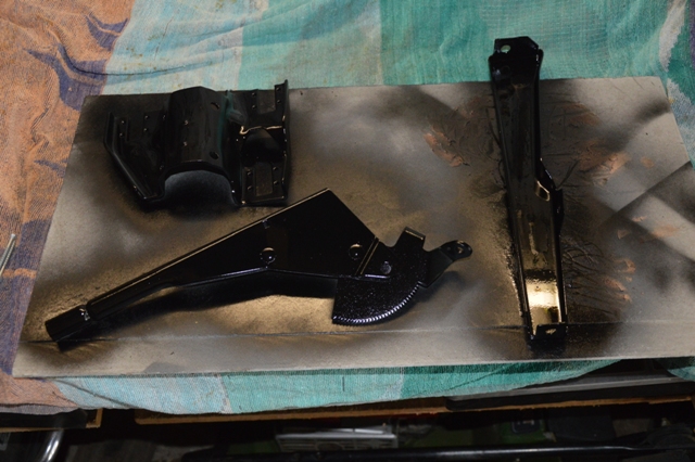

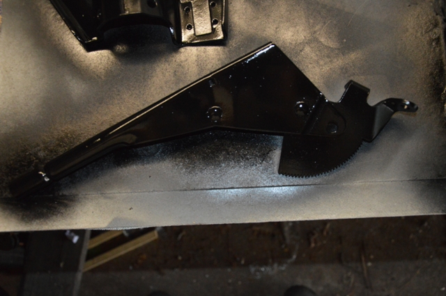

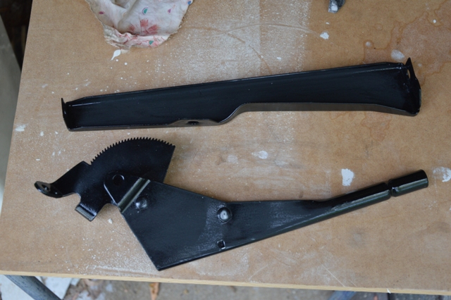

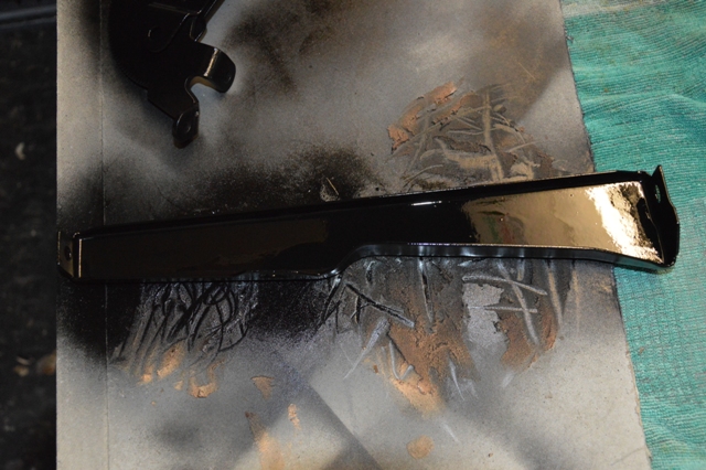

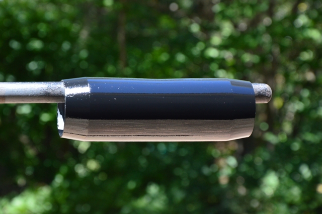

Sanded it all back this morning and painted it. I did it LIGHTLY FOR ONCE lol i did it so i could still just see the undercoat. Then waited a bit and put a bit more on (did that three times) ill prob do another coat tomorrow or something i can still see some small run marks so ill lightly sand it back and it should get rid of them.
(the one with the run marks)

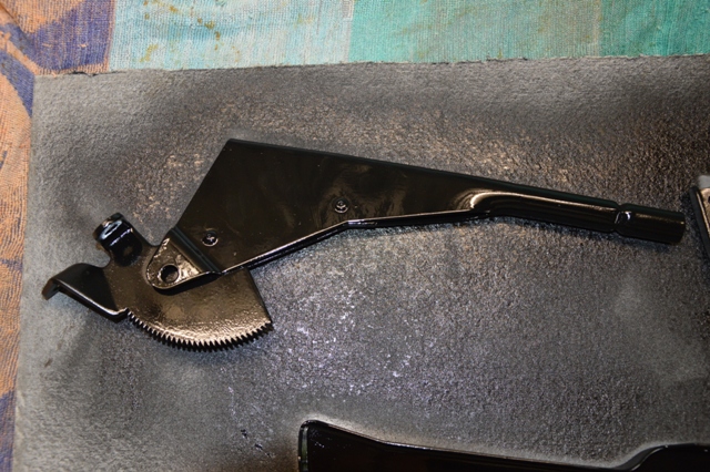

Posted 07 November 2013 - 10:17 AM

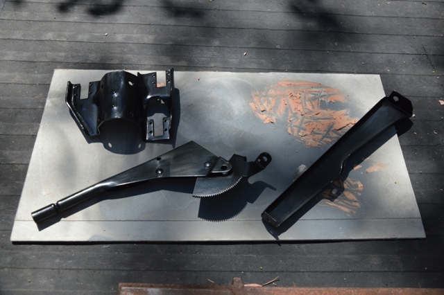

didn't pick up welder cause we went pretty early so dad can pick it up tomorrow on the way home in the ambulance  :stirpot:
ment to be 30 degrees today so i got the painting done as early as i could
It isnt perfect but i can live with it. With dad getting shoulder done......kitchen may take a while he has done the first coat in the cuboards and what not. So i might be able to do the 2nd and what ever else so i can HAVE A GARAGE lol

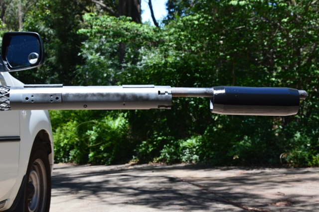

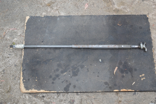

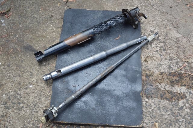

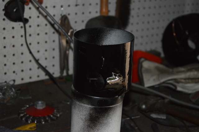

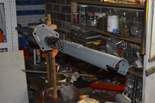

So i attacked this
Bering seems ok......

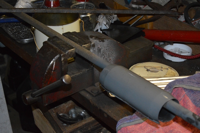

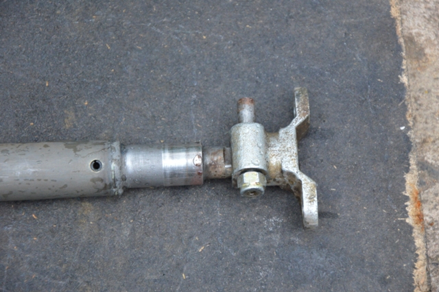

Shaft

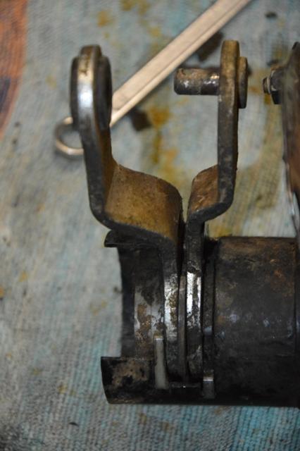

This pin was that tight i almost gave up getting the stupid thing off i ended up heating it up and it came out, i thought i was gonna break the vice

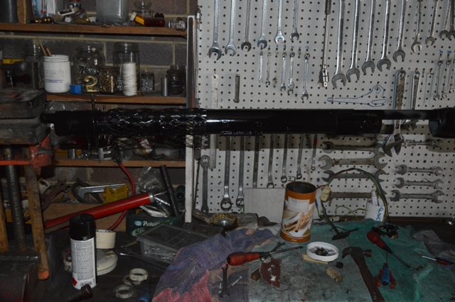

then i did a wee bit of painting
and because i thought ahead i could put it in the closed garage!
got it in there just in time too, felt a few spots of rain.

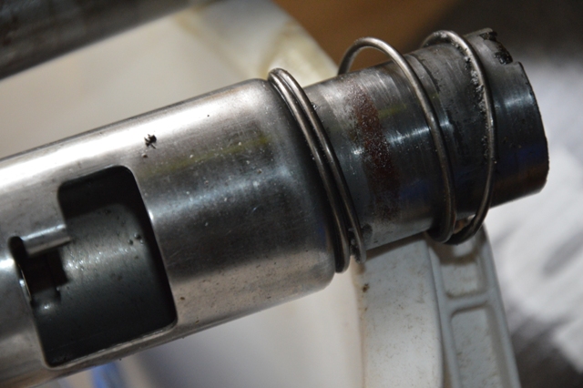

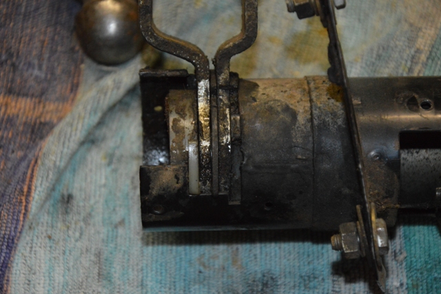

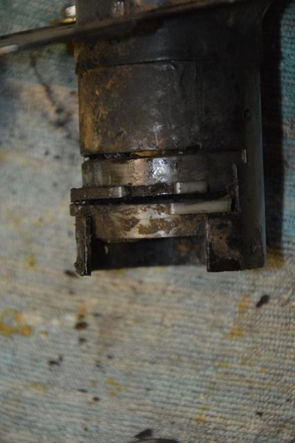

Annnnd how do i get this end off so the tube can come out?
I tried tapping that plastic bit across but it wouldn't move and stuff so i have no idea?
thanks

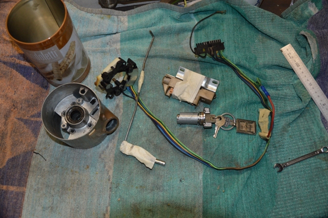

Not very happy anymore and i was doing so WELL!

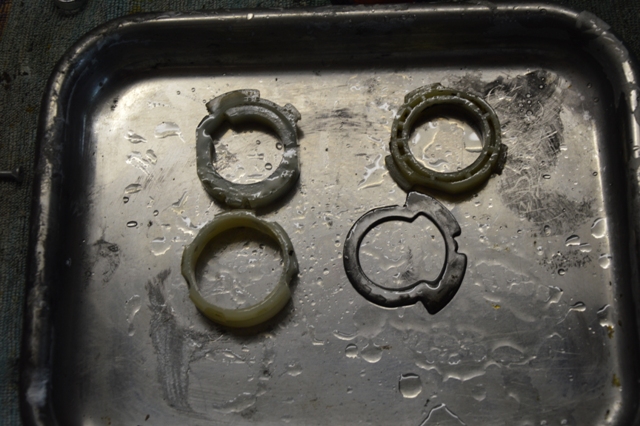

So i figured out this mumbo jumbo (im pretty sure they could of found of a better way to do it)
So basicly there is a tabe on the botton........thing we will call it. You lift that tab and you can turn the buttom thing right around. Then you wiggle the two leavers and everything pops out (literaly) so i go that all sorted. (gonna be an ass getting it back it at a guess)
all in pieces
(thats just so i know what order everythings in)
(order of plastic things)
all cleaned up (whole thing was really dirty for some reason, nut just grease but dirt)

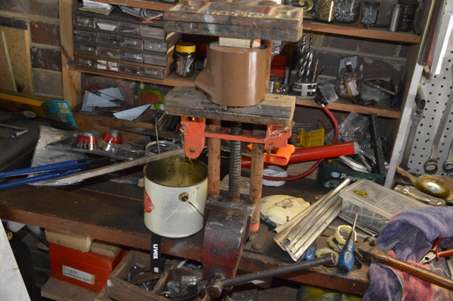

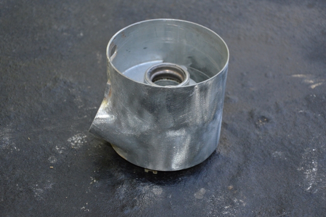

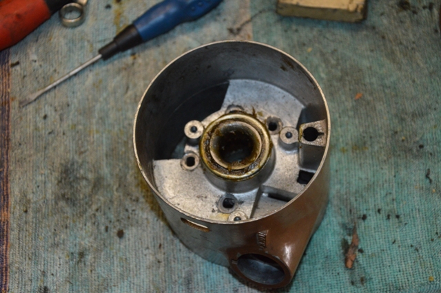

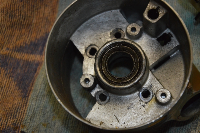

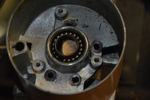

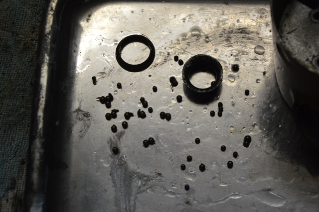

Then that mofo bearing in the top of the collum. Oh ill just pop that out cause it would be safer so i dont get paint or anything in it and frOck it. Nek minit
frOcking stupid thing
then i tried putting it back together
made up a make shift press
and after literaly an hour.........................
I ended up with this and it still isnt closed properly. you can move the bearing and balls come out the top and basicly its #@$^%& so what a great day!

Hamo, I admire your courage to pull everything apart. Not every ball bearing has to be restored. If the bearing was working fine I'd just grease it and put some tape over it before painting. If you get stuck just put it aside and ask the forum for advice. Great thread by the way, I'm feeling your highs and lows. Marty
#591 _Hamster_
_Hamster_
Posted 09 November 2013 - 03:00 PM
Yea hindsight is a wonderful thing ;[ 65 bucks for a new one ._. nearly better off buying a new collum lol
I honestly thought it would just pop out. Like a normal bearing would......i guess not.

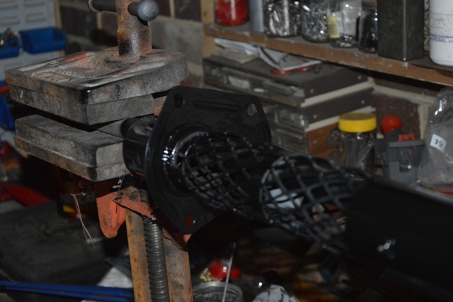

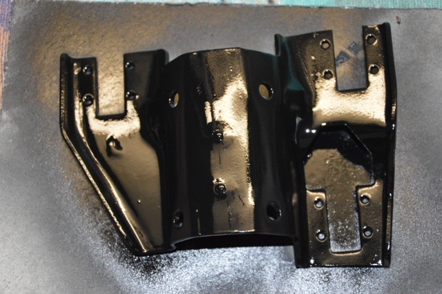

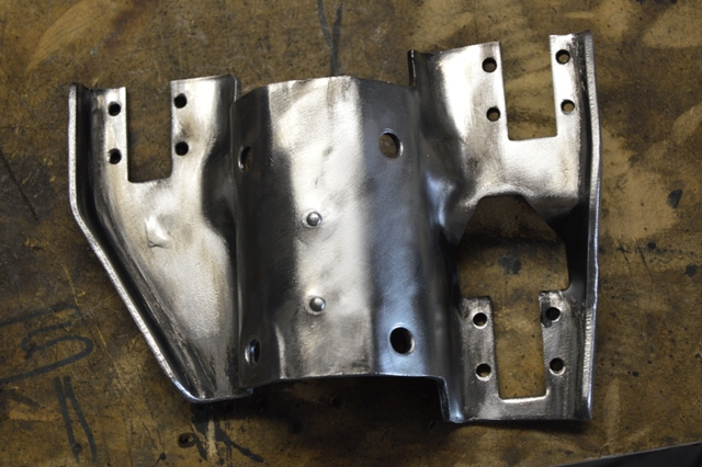

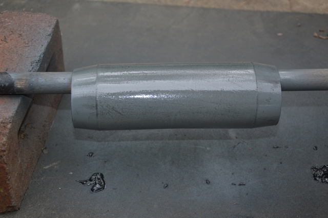

seen as the bearing isn't an issue now....i striped this back..
Painted this (figured i would leave the grate bit cause the paint was pretty good and its covered anyways.
Highlight of the day was to see this wayyyyyyyy better than all my other paint jobs.

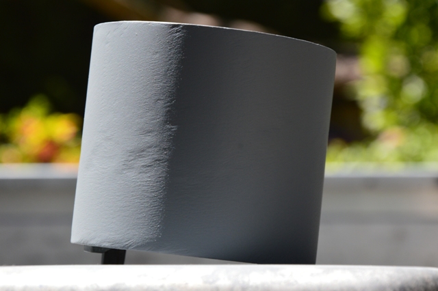

soo power was out all day cause council was fixing something .... so all i could do it paint a few bits and thats it really.
This seems to have a big groove in it for some reason but anyways.

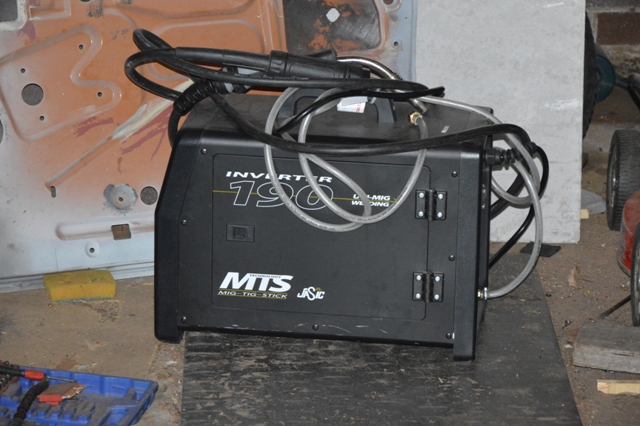

Nice inverter. What are the speakers for?

stero system my uncle had.
Mum and dad were gonna sell it now he passed away but i said ill have it. The speakers he has now are B&W 808s which are massive and won't fit anywhere in the house (let alone my room) so i gotta get new ones. And with literaly everything including the headphones over $1000 (each/individualy))headphones where $1500) i wanted to buy a proper pair otherwise it would be pointless. And im not paying for them he was getting a new amp and a few other things and already paid 12k for it all so mum and dad as far as i know are sorting something out for me and ill just keep all his old stuff until i want/need to upgrade it.
But i don't want to see it sold, im into music and all that so i can keep it to remember him i guess you would say. Some may say its expensive and stupid but without a hobbie/interest life would be shitty.

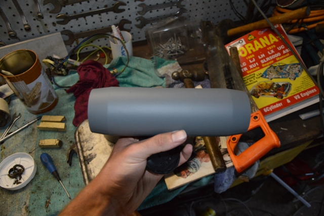

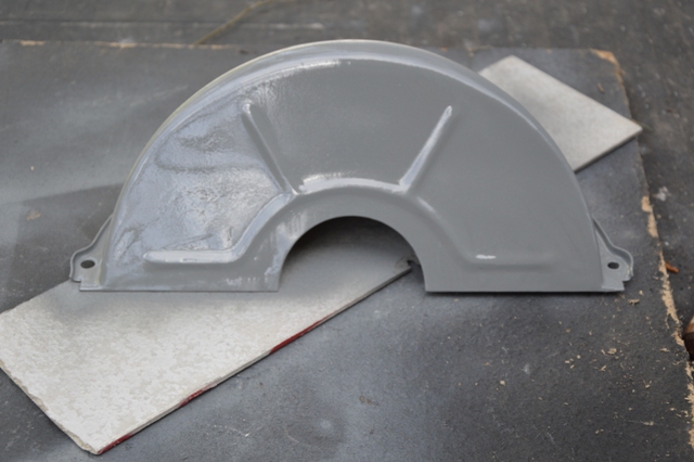

With that cover
(that cover^) would it be ok to do that with caliper paint? its a high temp paint and i have some left thats all (might not be enough for 2 coats im not sure)
Edited by Hamster, 15 November 2013 - 11:00 AM.

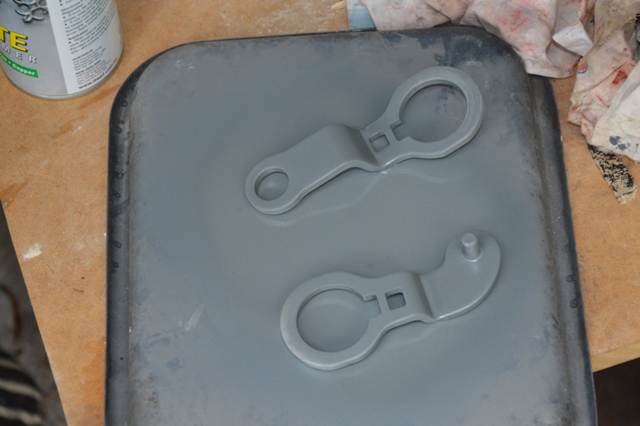

yea the was sfa left in the can so i lightly did the collum to just use it up.

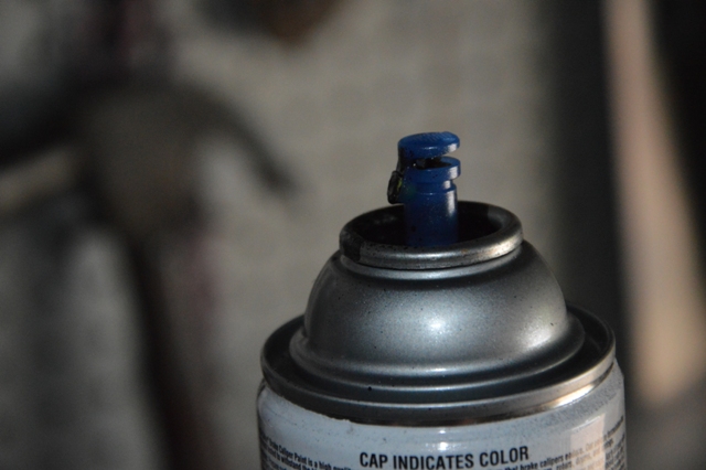

fyi this can is so much easier to use that that other crappy shit, comes out a lot smoother.
https://cache.gmh-to...zps28596684.jpg
used the last of the prime on these. They weren't painted before but.....yea it aint gonna hurt it.
