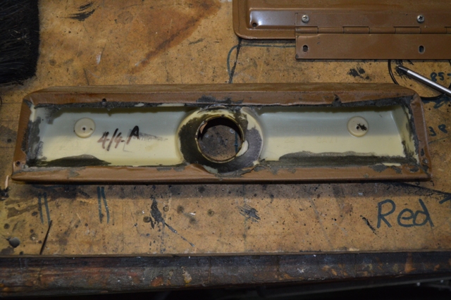

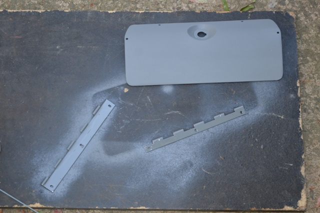

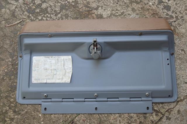

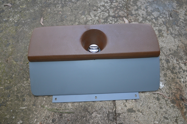

So i was like bored. So i went to the shed and went lewking for things to do.
Hey look a glove box!
Not sure if its gonna be black or same colour as the car but ill strip it and undercoat it.

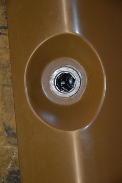

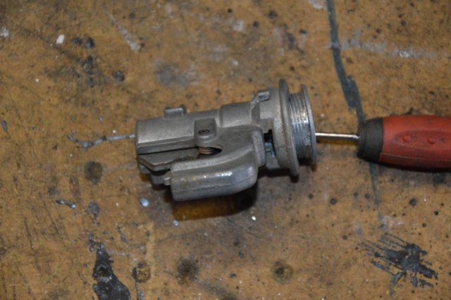

This was the biggest pain. After 20min trying to figure it out myself, i found a video on google.
But i didn't watch all the video and i had no idea how this bit came off....
Turns out it just screws in so i used my finger as a hex bit (got nothing else for it)

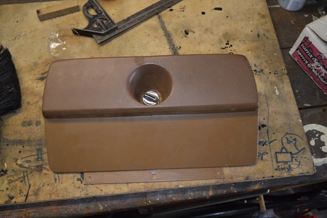

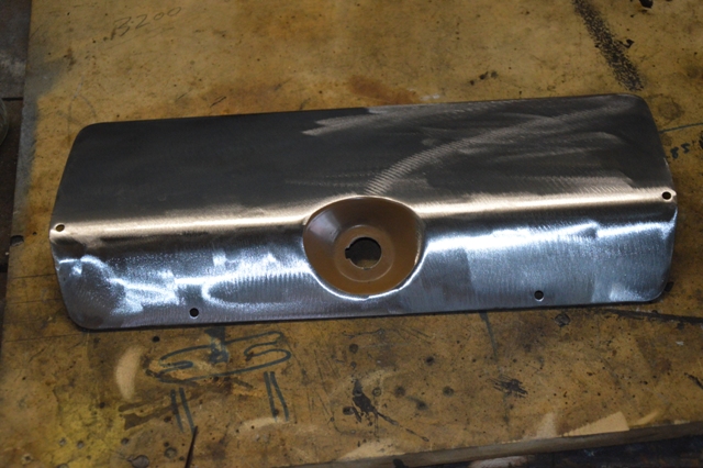

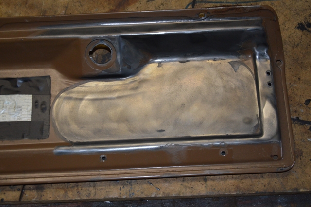

Stripping time!, i planed on keeping this on there to have atleast something original on the car....
I used the wire buff cause it was easier to shove into the little corners and everything than the flapo disk.

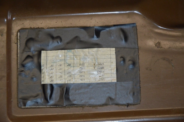

Then i got the shits going around this so i peeled it of really carefully and ill stick it back on later.
Flap disced the front.
Wire wheel couldn't quite get it all out D: Back to doing it by hand lol

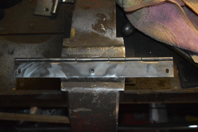

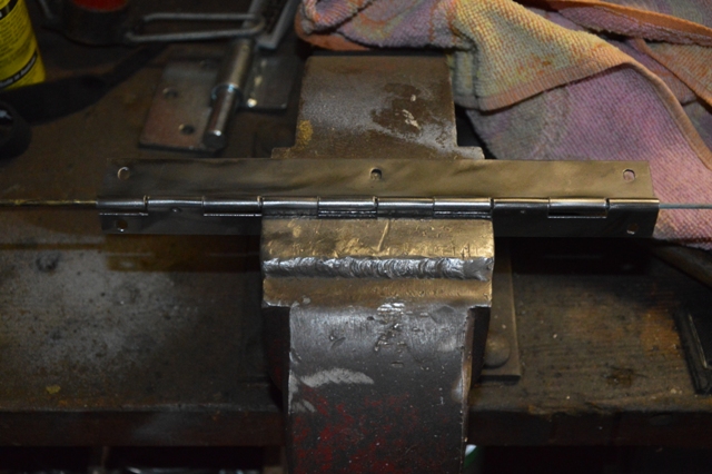

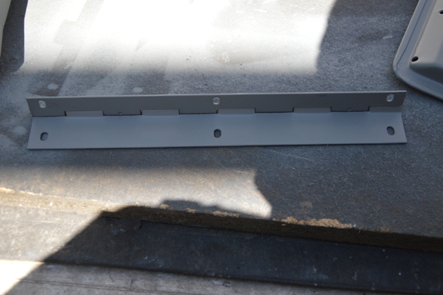

Hindge just went in the vice..

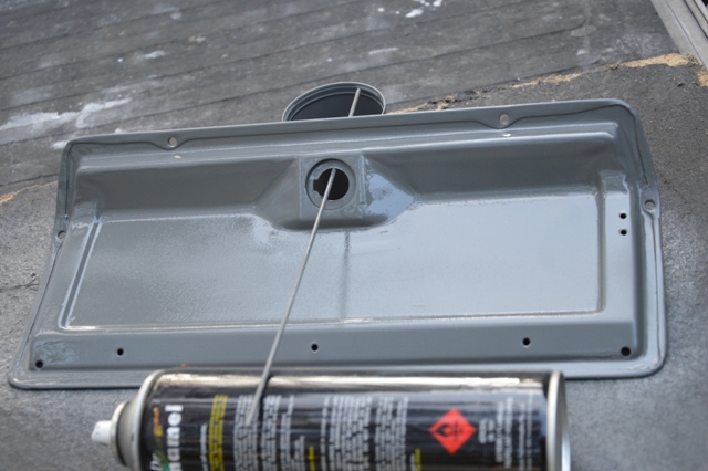

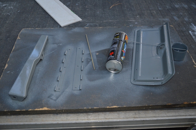

Then to paint i pulled it apart. Protip a small welding rod with all the shit shaved off it works awesomely.
painted. (half painted)
So then i had nothing else to do so lewking lewking lewking....

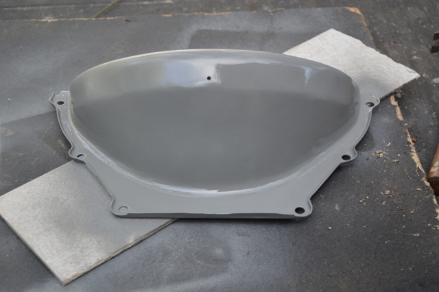

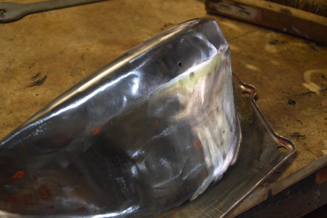

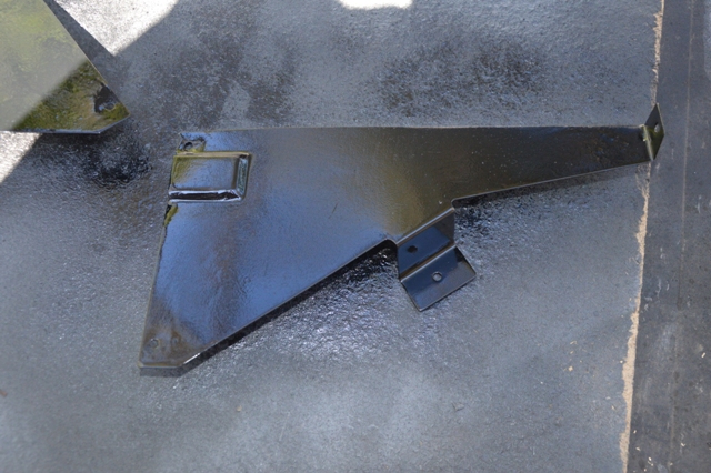

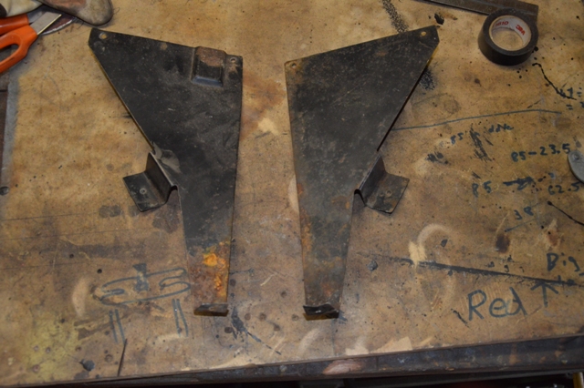

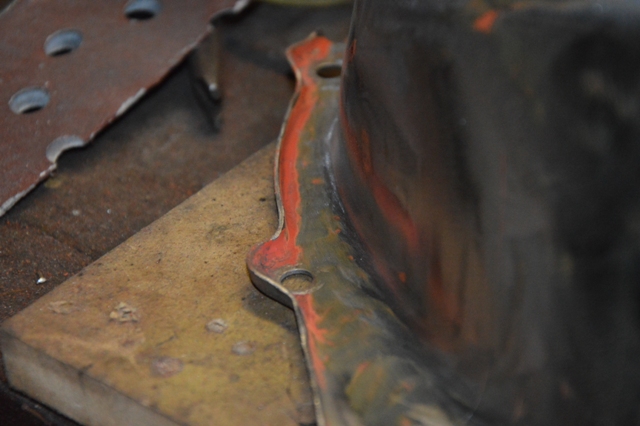

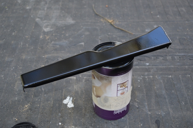

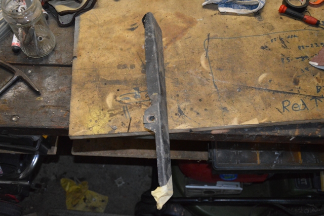

I think this is.......from the front that holds that tiny nose piece under the grill on? If it isnt i have no idea what the hell it is.
So i stripped that back and half painted it too. And before i painted everything i gave it a wipe with turps and the bit i did with the wheel i lightly sanded.

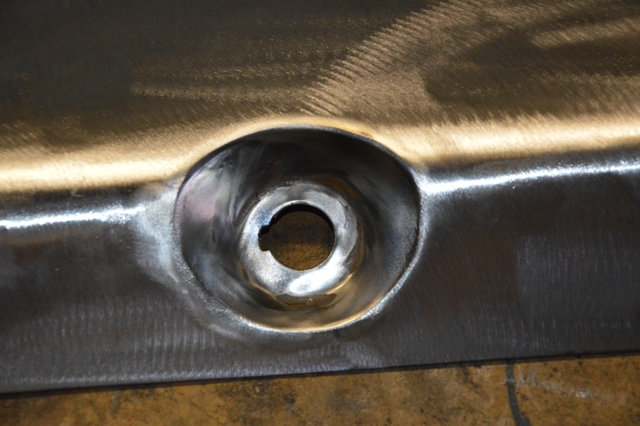

#527 _Hamster_
_Hamster_
Posted 02 October 2013 - 05:14 PM
annnnd all done.
Shiny, now i gotta decide what colour. Assuming that is the bit near the grill ill paint it black.

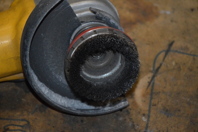

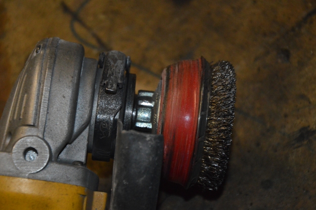

Yeah but is it the wire twist one? I wanted to use one to sand back my floor pan but im not sure if it will be too harsh.
#534 _Hamster_
_Hamster_
Posted 03 October 2013 - 02:29 PM
Forgot to get pics until i read that.
I found it wasn't to harsh. I had a small rusty spot i had to hit up with the flap disk because it woudn't cut into it so to speak.
You see those other ones that are out the side which always have bits of metal flying off and stabbing into you. I only had a couple bits stuck in my shirt when i was done. It's also dense....You really need to shove it in to small corners to get the paint off.
But yea all i would say is you need a pretty good grinder to turn it otherwise it may take quite a while, but didn't damage the panels like the flap disc would if i tried shoving that into the lips/corners.
Also note: this ones worn down a lot, its suposed to have little plastic tabs around the outside.
(i also think you can get bigger ones, but honestly i wouldn't go much bigger than this and this grinder has a lot of balls. (its a 5 inch aswel)

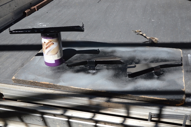

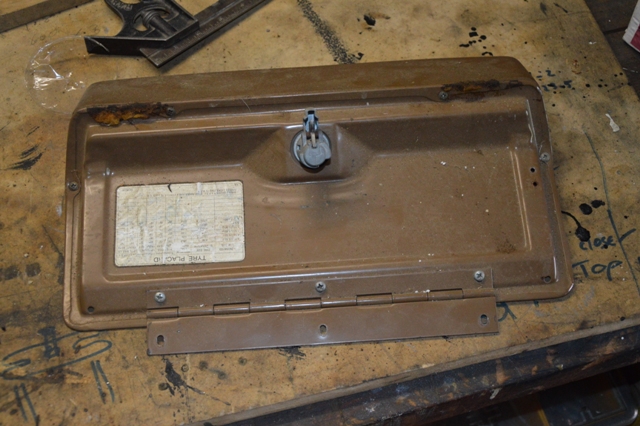

So dispite what everyone might say i put the glovebox back together.
Yea i know its not fully painted but 1 i dunno what colour, 2 i dont got no paint and 3 if i put it back in the shed bits will be lost forever (cause its a frOcking mess) SO i put it all back together and in theory i can't lose little screws etc.
(has just enough stick to stay there for the time being) (the sticker that is.......)

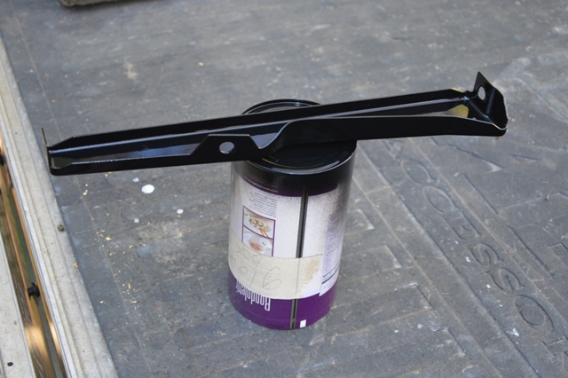

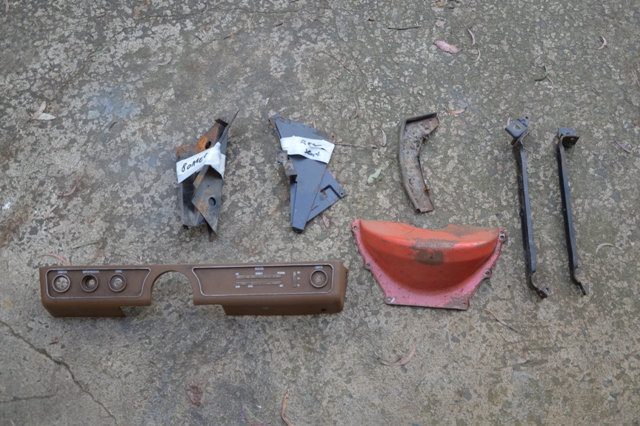

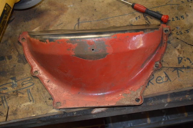

So found this, figured i would paint the front bit with it and see how it goes, just says lighting sand the primer so i did that yadda yadda.
So while that was drying i found all these bits i can clean up and paint.....no frOcking idea what the 2 bits on the end are?

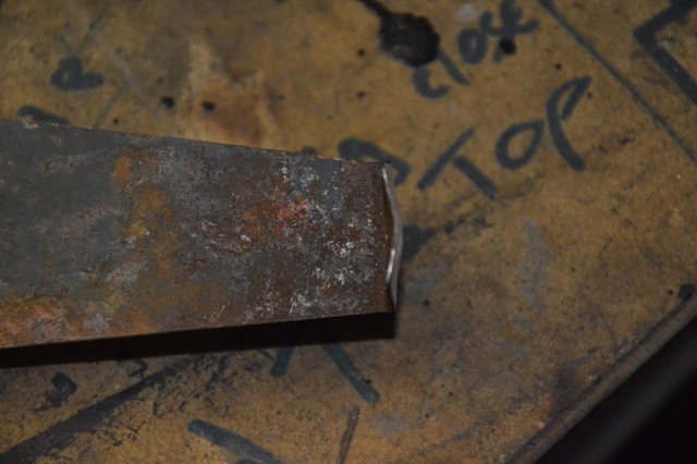

At a guess they were off the ford kb lazer but i won't throw them out until im 100% sure.........so if anyone has any ideas that would be good.

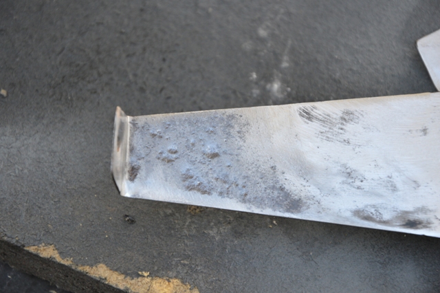

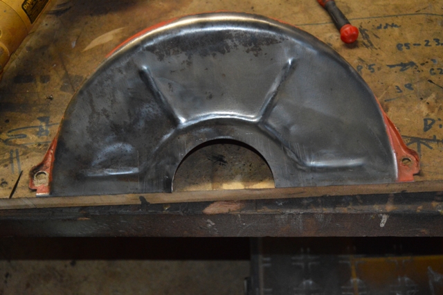

Shiny, paint came off pretty easy, used the buffer again for this bit but its a bit rusty so i used the flap disk to clean it all up properly.
Annnnnd had to do this bit by hand.....yay?
Not very staight....but it came off a working car so i won't touch it.
Shiny

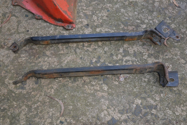

Bits that hold the rear seat in place.
woah oh oh sweet child o mineeeeeeeeeeeeee
Back to the car....All the little tabs were bent so i just put them in the vice and that worked.
This bit was rusty but....like its a bit that holds the rear seat in place. If it was the car body itself i would get it fixed but.....I can easily replace it if it stuffs up so i not really worried about it.
(and i forgot to get pics of it painted, paint jobs rough cause i was using every last drop in the bottom of the can....again its hidden i couldn't care)
As for the lower dash....dunno what im gonna do there. I can't do all those little letters i thought they were etched/scribed in but they arn't so.............yea iduno.

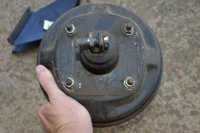

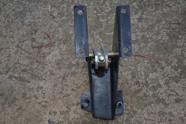

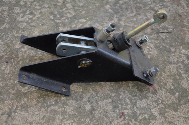

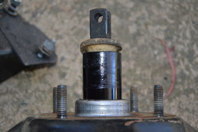

then i went lewking again.

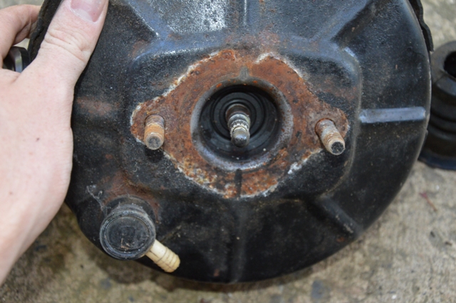

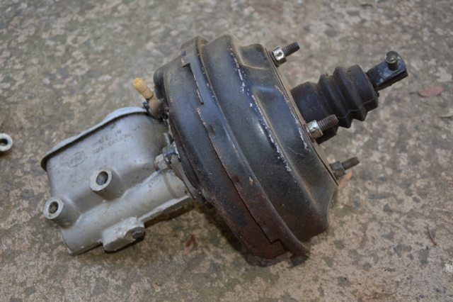

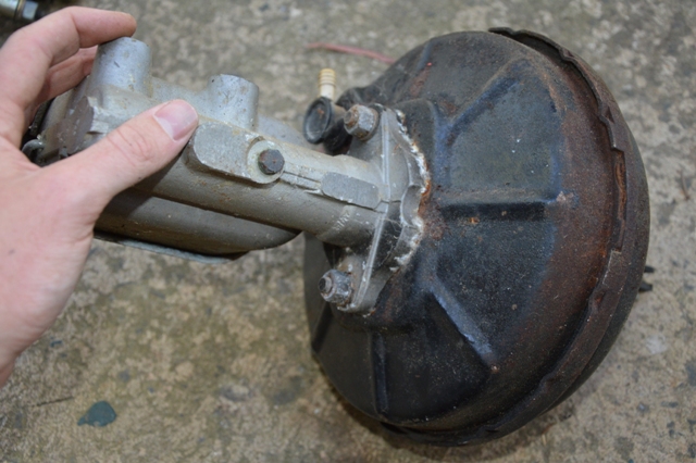

So the bracket isnt to bad, the bottom of the booster is all rusty so im thinking because it looks like a huge pain in the ass ill rob get those 2 bits sandblastered and ill muster up a few more bits and pieces for him to do aswell, then maybe get him to undercoat it in that red shit the diff is done in or normal primer? dunno.
so i went on a quest to pull it apart

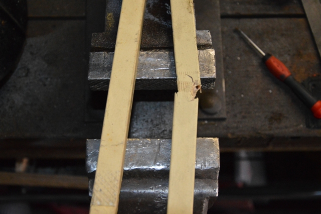

got it all off, and figured the middle section twisted apart. So i put it in the vice with 2 small bits of wood to protect the thred on the bolts and got the crowbar (already tried with the hamer and things) and yanked the absolute shit out of it. That didn't work so then i heated it up a LITTLE not knowing whats inside.
And the 2 bits of wood holding the bolts in the vice broke.....so save to say it aint comming apart without the proper tool (providing there is one)
Then i came back inside to look at photos from yesturday and die pretty much.
#546 orangeLJ
Posted 09 October 2013 - 02:38 PM
wait, you are trying to pull the booster apart?
dont do that.
#547 _Hamster_
_Hamster_
Posted 09 October 2013 - 03:19 PM
yea.......i wont now lol.
I was gonna pull it all apart then just get the two ends blastered.
Also i have no idea if it needs to be reco'd or anything.
