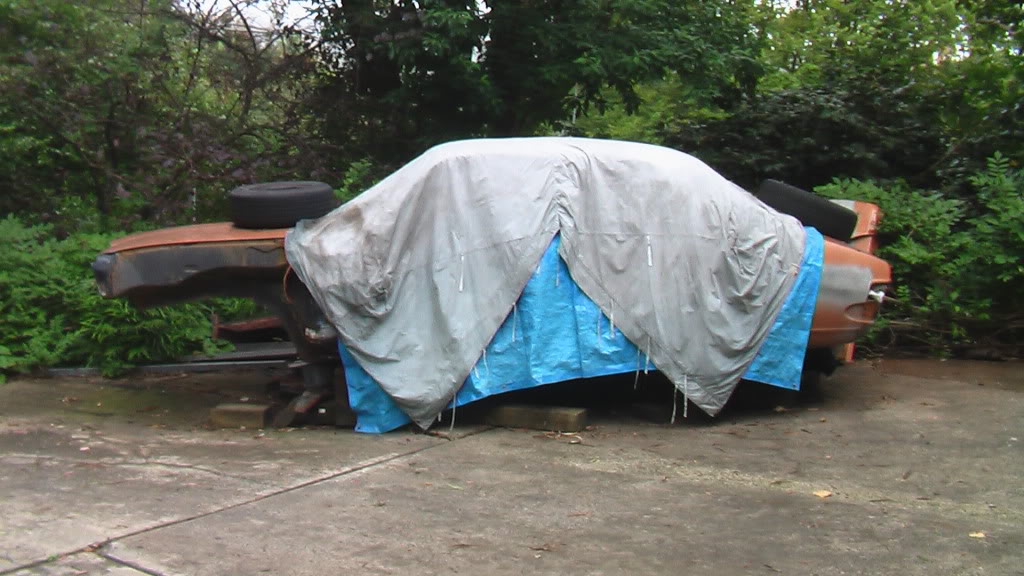

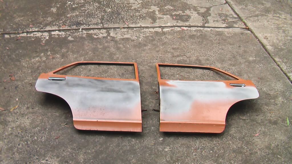

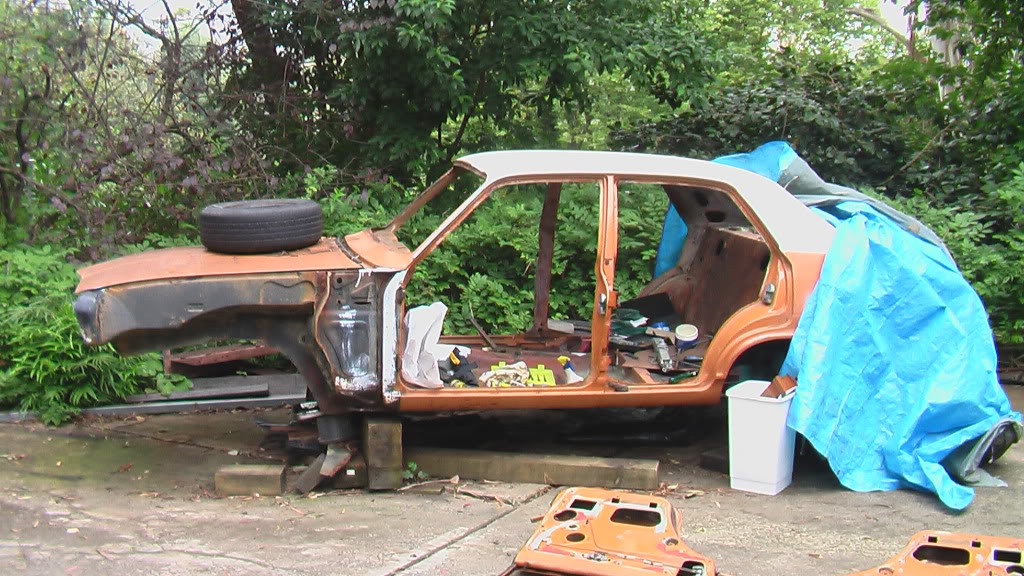

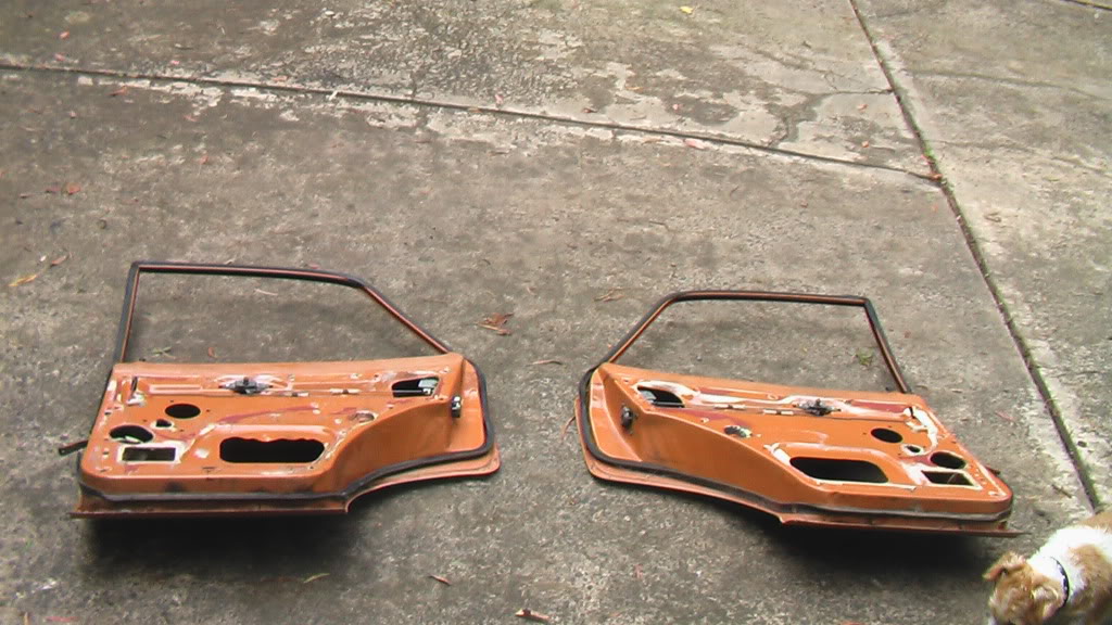

Got really bored and wanted to do something on my car, not much i can do with no welder and a bit of misty rain. so i took the rear doors off.
Cars basicly....nothing now. And seen as i still have nowher to put everything...
The doors are inside the car for now.
Covered back up for the incomming rain.

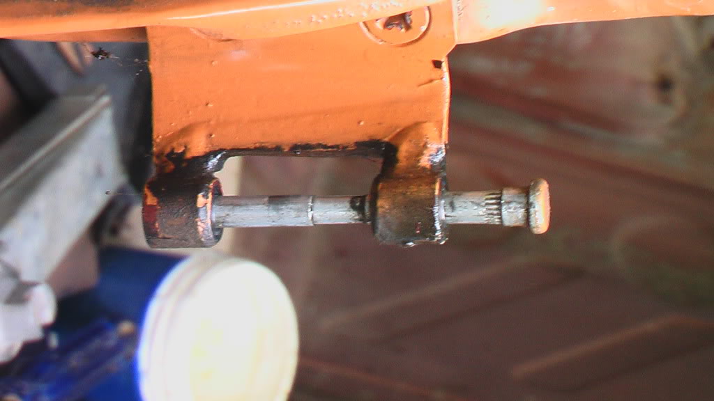

I might need to get new grease nipples for the tie rod ends, one of them is #@$^%& and the grease comes out underneath rather than filling up the bit its meant to.
Do you guys think it is worth getting non grease ones?
the other ones are a bit rusty now sitting out in the weather for a bit so if people think non grease is the way to go ill just get a full set of new ones. no big deal.

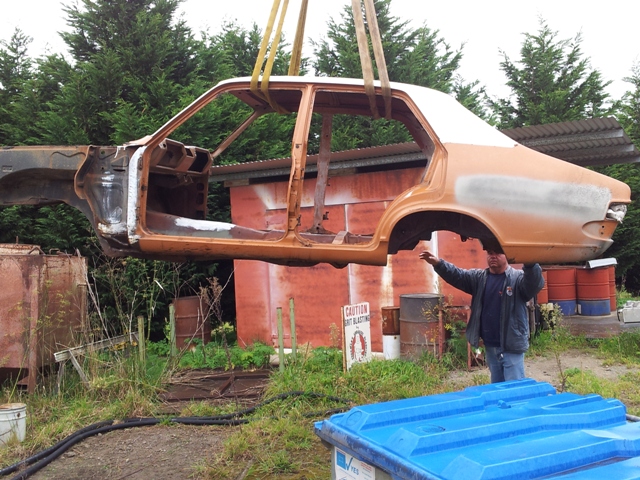

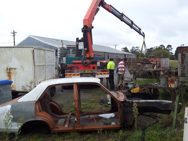

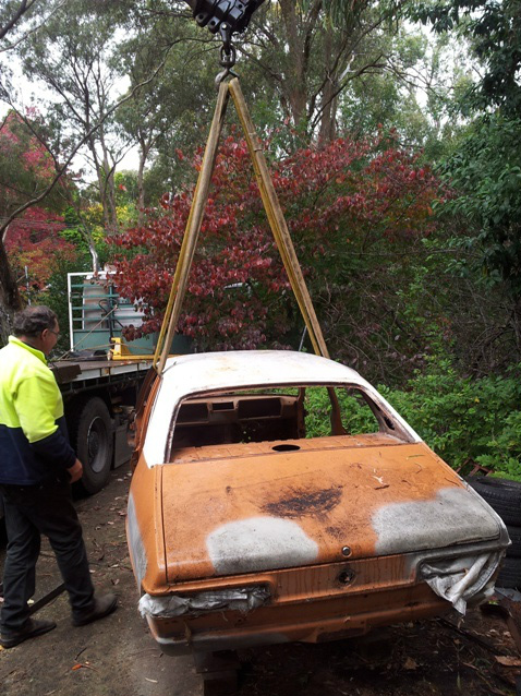

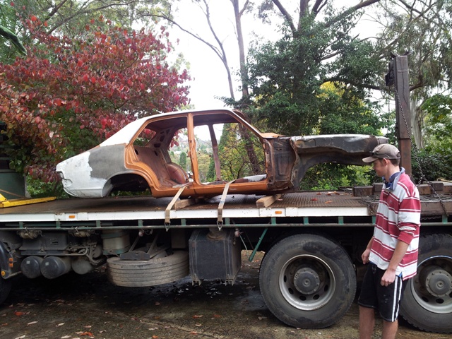

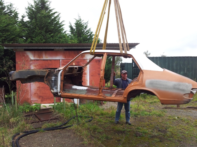

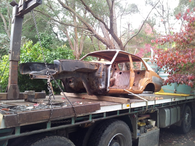

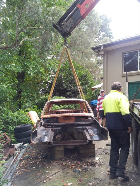

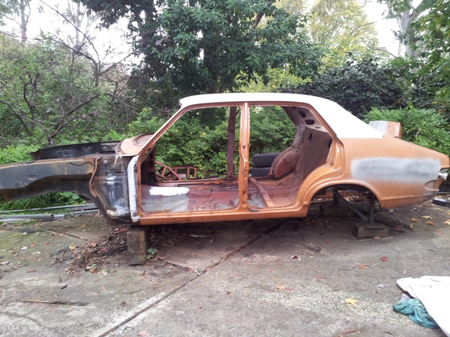

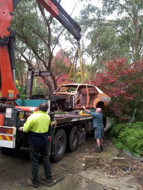

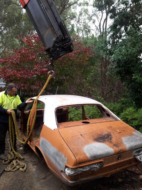

Sand blaster has cleared away the bulk of the jeep and is ready for my car.
Have about 7500 and owed a bit more, Parents might give me a bit of money if i run a little bit short.
SO HOPEFULLY it will be at the panel beaters within a month or two.

Booked into panel beaters, they currently have 3 in the shop (corvett, ford cobra and a rod of some discription) and 1 more in the waiting list xy ford or soemthing then mines in. Soo a few months which will give me time to sandblast it and get some of the bulk panel work done.
