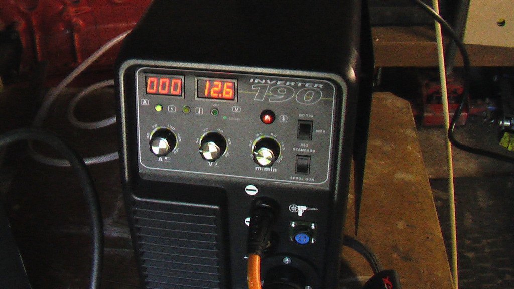

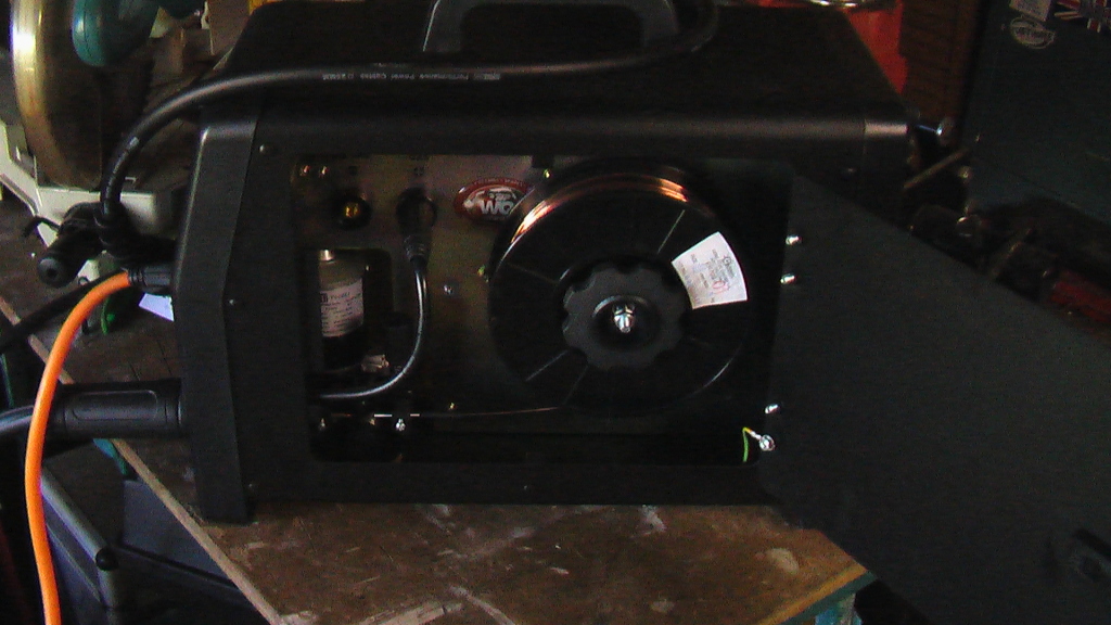

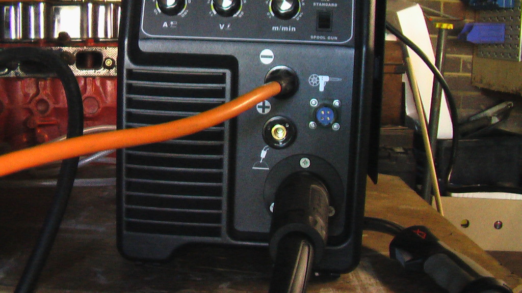

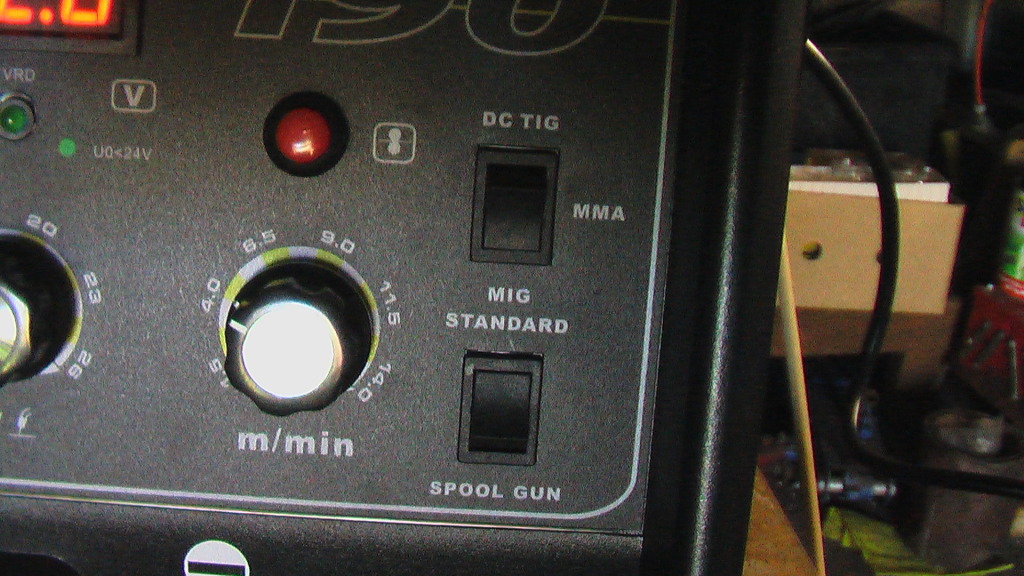

It was either unimig or cebora. Unimig had the better deal at the time and we didn't here of anyone saying they are shithouse. HOWEVER everyone said dont get CIG lol.

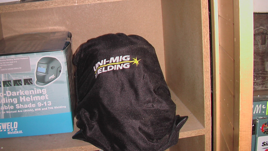

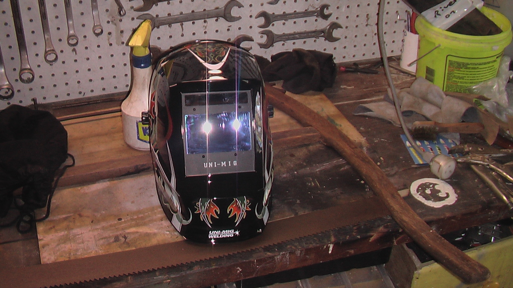

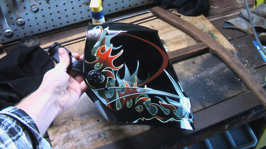

Fancy free helmet comes with fancy carry case.

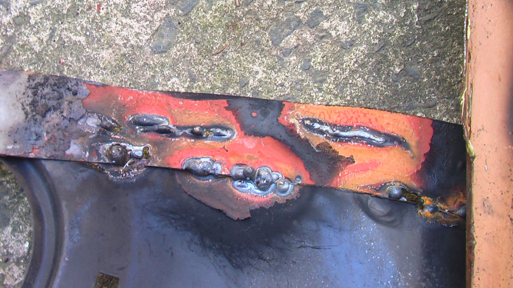

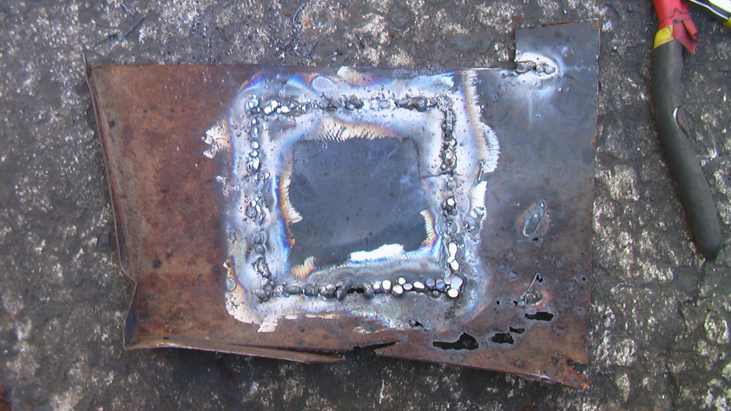

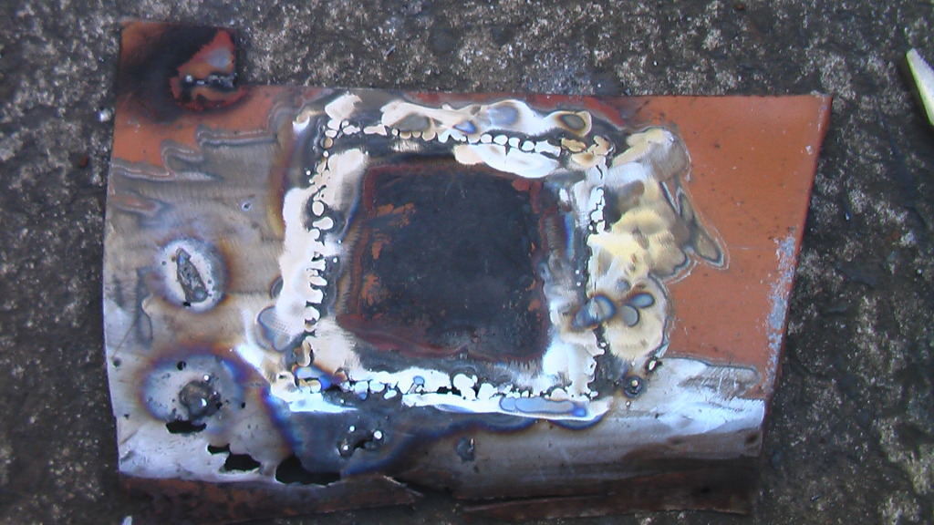

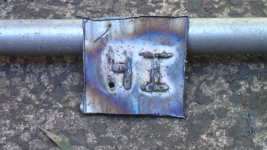

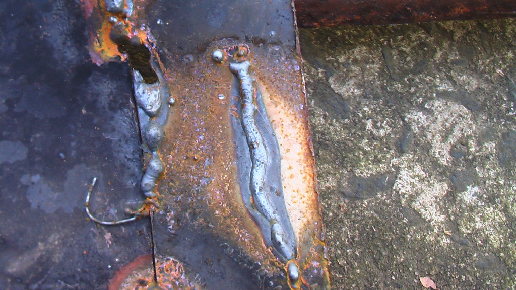

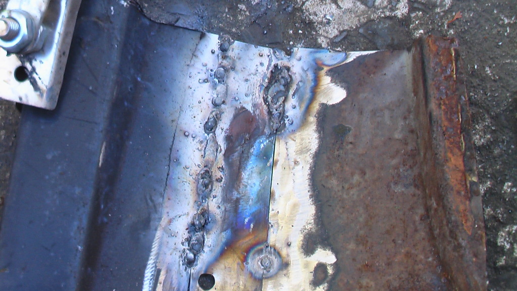

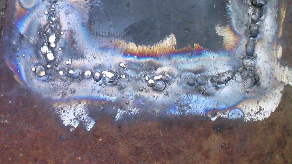

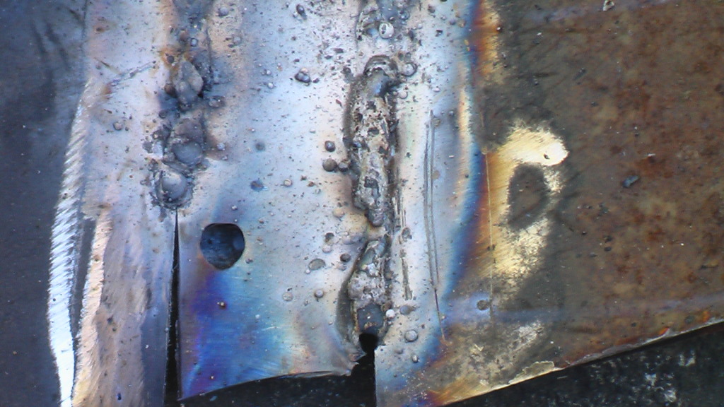

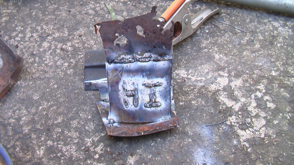

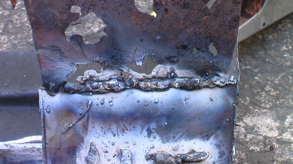

and now for the horrible welding attemps.

As for Cigwelds. I have one and have done my entire car with it. Only thing I can fault it on is it doesn't do overhead on higher amp settings. But I'm not a welders arsehole. I was recommended a Cigweld by my best mate who entered a welding competition (his workplace put him up for it) where he ranked 2nd best in Australia, 1st in QLD. Not just your at home/backyard fabricator. End of rant.

Looks like you are trying to weld through rust and old pain, not great for good clean welds.
Obviously you know that the blow throughs are from having it turned up too high, some of the "dab dab dab" looking welds could be your wire speed too (too slow for the speed you are moving)
Slow and steady is best, if you are welding on a bench with an under shelf, try putting a foot up on it and rest your elbow on your knee to stabilise your hand/s.
I'm generally a two handed welder for tricky stuff, one handed when Im tacking things up, but it depends on how heavy your lead/gun are

I agree I have a Cig200 and it hasn't missed a beat,I used it for my resto,built a trailer and done a number of different jobs big and small.As for Cigwelds. I have one and have done my entire car with it. Only thing I can fault it on is it doesn't do overhead on higher amp settings. But I'm not a welders arsehole. I was recommended a Cigweld by my best mate who entered a welding competition (his workplace put him up for it) where he ranked 2nd best in Australia, 1st in QLD. Not just your at home/backyard fabricator. End of rant.
Anyone that says that they are shit may not be using them right.
I'm no eggy in welding and learned myself,but I found if you have good connection,a clean area,a steady hand and good wire speed you can't go won't.
Just my 2 cents.

I did it a few weeks ago so the rusts just from it sitting in the rain after the attempts.
Liam i am only going off what 99% of people told me, if you have a cigwelder that works fine thats great but everyone told me to stay away from them so we just took their advice.
And i usualy use 1 hand unless im upside down under my car or in some other awkward possition.

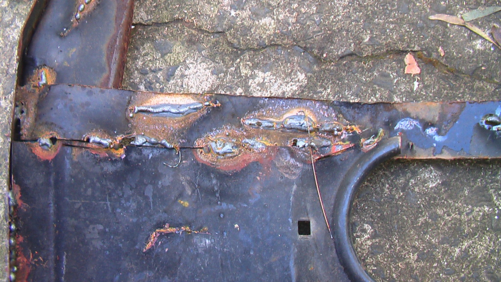

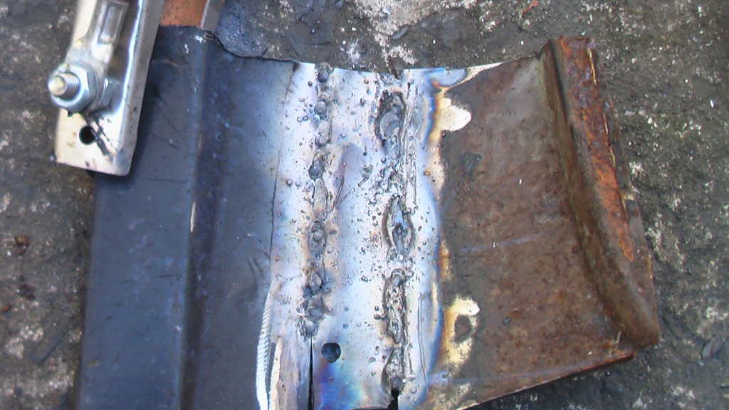

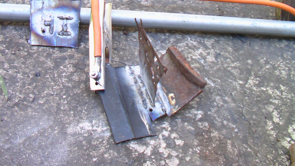

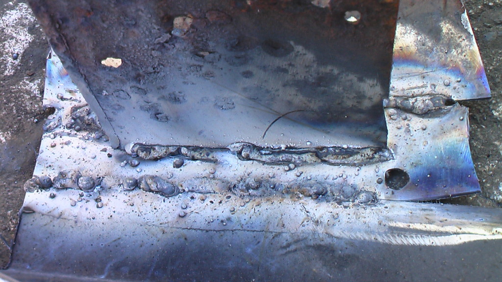

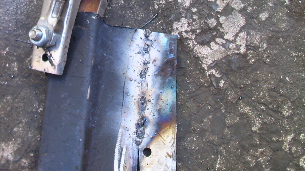

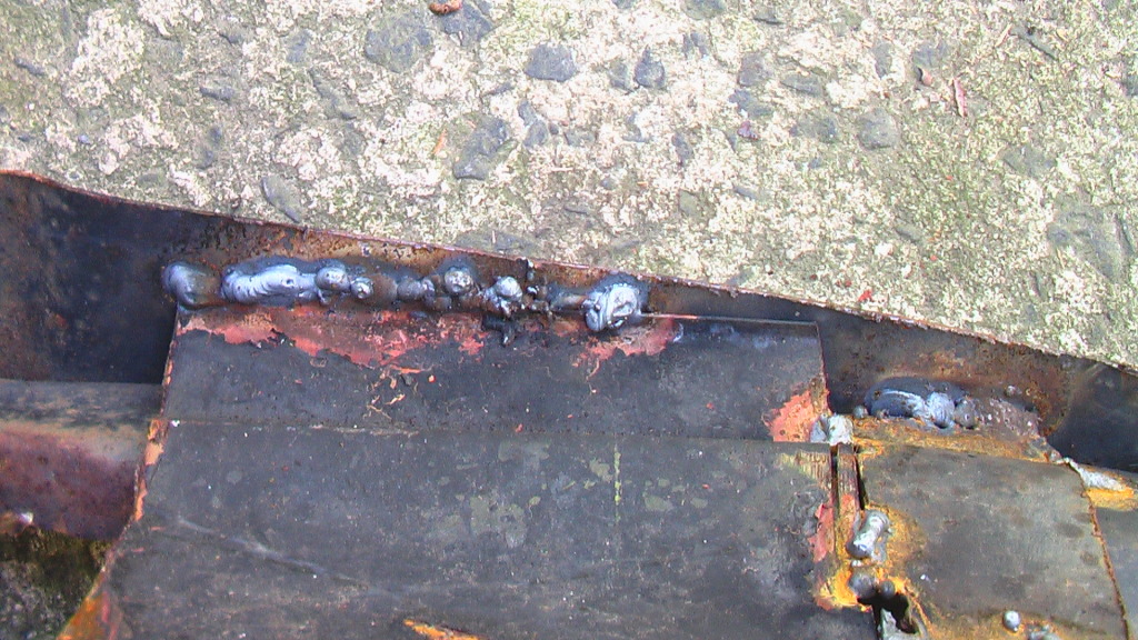

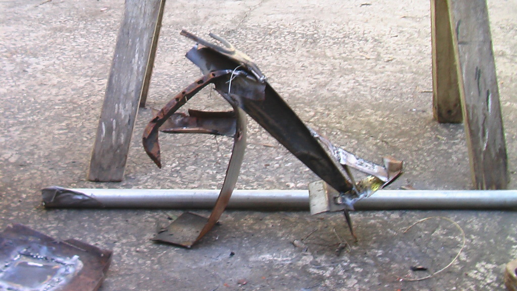

there was a huge gap down the bottum bit here because i just found a piece that roughly fit so filling in a gap 3mm or more wide was silly lol
And then i went ape shit

My mig (I forget the make) only goes down to .8 wire which is a touch heavy for car stuff and is gasless but I think that with patience and the spatter guard it's working pretty well. Just little by little is best.
One tip I did get was that you only weld panel steel till it starts to go red then let it cool right off before going again. I think that must be easier with thinner wire but it has helped me with my panel work. Far fewer holes blown out lately. It does take me way longer than it used too, much less grinding to tidy it up though.

just wondering the last couple of pictures was that with gas? i would highly recommend a tafe course in fabrication and welding, i'm doing a cert one to make it easier to get an apprenticship at the end of this year. it's a lot of fun.
#166
Posted 08 May 2012 - 04:30 PM
That last series of shots look like you were welding with the gas off (spatter everywhere)

Figured i would try and save the gas until i got better and started on the car itself.

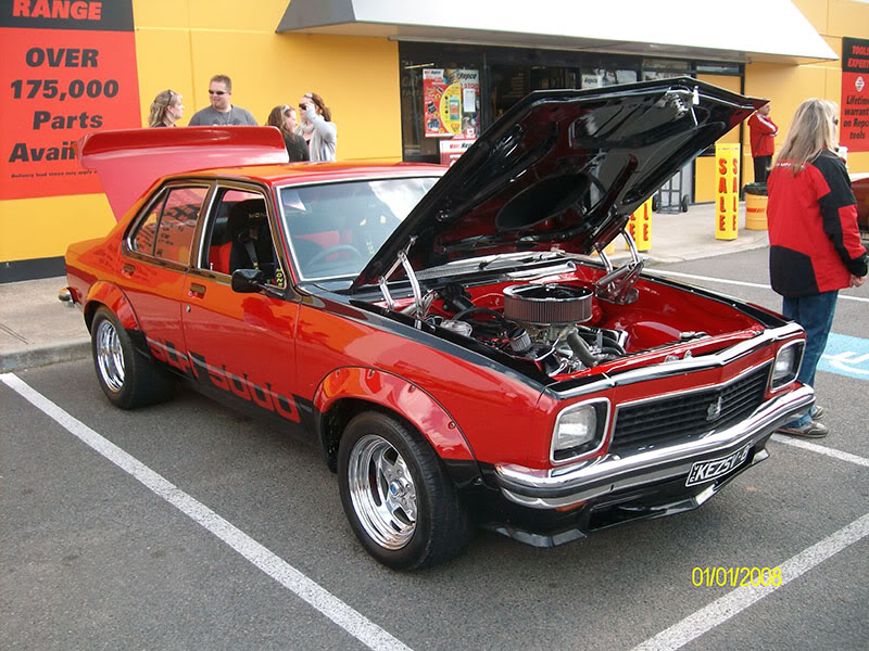

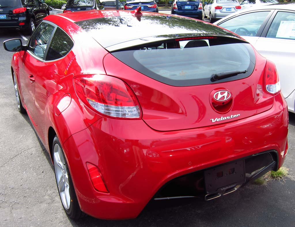

Sorry to put a pic of a Hyundai in your thread but maybe this colour would be suitable? Not sure of the name or code but being on a currently available new car would mean you could just go down to a dealer and get the code.
Or the colour of this bad boy? Not sure if it belongs to a forum member but I've seen it around in melbourne.
Edited by mick74lh, 06 June 2012 - 11:24 PM.

Colour isn't to bad actualy. Another one to go on the list lol.
