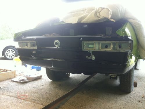

OK BRO's it's update # 102 - the little torrie threw a brake shoe !
dave - yep it's about right and i need to send this to them tomorrow
update
sorted the rares yellow plastic handbrake issues
sorted the brake booster - this was human error as you need a spacer behind the bracket  to put the booster on a different angle
put all the wiper arms and also wiper motor back
did the right hand side rear brake
found a new use for boogie boards
it's an old shitty grill not the right one, but could not help myself
1 more mill

Grant, your fuel filler pipe is incorrect. The flange on the pipe sits behind the rear panel, inside the boot, not on the outside.
Love that wiper motor, so sexxxxxeeeeee.
Dave.
Edited by S pack, 17 June 2013 - 05:25 PM.
Dave.
And there is a foam type gasket as well that go's between the filler pipe and panel.
Looking good mate.

See below. The gasket is critical, otherwise water will sit permanently behind the boot catch area (and cause a rust hole like the one I had).
Bazza

got the gasket but it's behind the filler - was wondering what was going on here as the screws were not working and also the tank connection rubber seemed to be short - will fix

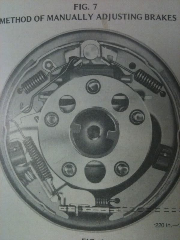

Yourself adjusting mechanism on your backing plate,to adjust your brakes isn't right either,and missing a few bits.
Regards John.
#564 hanra
Posted 20 June 2013 - 04:29 AM
Well spotted, however ita an old photo. Just wanted to show the brake shoes.

Here's a later photo, sorry for the hijack Grant.
As per the book

ERRR now I'm missing the things as John has said and also Brad has shown.
when i pulled the brakes  off the old 4 door,  parts these were not there ?
I assume that they can operate without them ?
Edited by Agent 34, 20 June 2013 - 06:20 PM.

Yes they can operatate with out these mate,there only a automatic brake adjusters grant,that photo that you have put up is the os rear.I still have this set up in mine,god knows why did put them back in.
Your car would have had them too,but someone hasn't put them back into yours,my gtr had them, as the same as the xu-1.
Regarsd John.
#569 hanra
Posted 20 June 2013 - 07:25 PM
They only adjust the brakes ones the car is moving in reverse and brakes depressed if I am correct? I'm usually not though!!! Hahaha.

Correct Brad, the self adjusters only work when the brakes are applied whilst the vehicle is traveling in reverse.
If the self adjusters are removed you have to adjust the brakes manually at regular intervals.

Yes handbrake only,when reversing,don't do it many times will over adjust and won't move forward at all,i have always adjusted them manually.
Regards John.
#573 S pack
Posted 20 June 2013 - 07:45 PM
Hi Brad,
Regards John.
Drum brake self adjusters have nothing to do with the hand brake John. They work when the brake pedal is depressed and the self adjusters cannot or should not over adjust the brakes to the point they are locked. Generally three brake applications in reverse is enough.
#574 frash da bucket
frash da bucket
  • 1,890 posts
  • Joined: 23-April 07
Posted 20 June 2013 - 07:50 PM
It only works of the handbrake and not depressing the brake pedal,by pulling up the handbrake when reversing it adjusts them up.
Regards John.
#575 S pack
Posted 20 June 2013 - 08:13 PM
Regards John.
How then do the self adjusters work on front drum brakes?????
