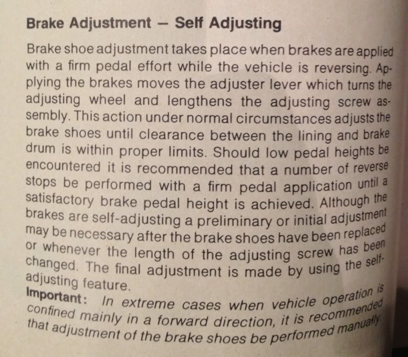

#578 S pack
Posted 21 June 2013 - 12:39 AM
^^^ Thanks Brad, you saved me the effort.
Dave.

Hi Grant,
Keep in mind that without the self adjusters you might get knocked at RWC time.
Brian

Posted 22 June 2013 - 08:03 AM
Hi Dave,
You seem to be a expert in the mechanic's.
In my field of mechanics of 30 years or more,my field was,brakes,steering and suspension,and you believe what a book says to you.In theory the book is saying you use your depress foot pedal while reversing backwards.
On torana rear brakes its a little different,the handbrake leaver on the inside facing the backing plate,conects to the brake shoe,which on the other side is the automatic self adjuster,which works of the reaction arm, to the self adjuster,when appling the handbrake while going reversing backwards does adjust the brakes up.
Regards John.
#582 S pack
Posted 22 June 2013 - 08:35 AM
I see your point John, theoretically, either method will work for adjusting the rear brakes, however there is no need to use the handbrake as depressing the brake pedal performs the same operation with the benefit of the front brakes applying also.
God knows that when driving at speed in reverse you need every bit of braking effort you can get.
