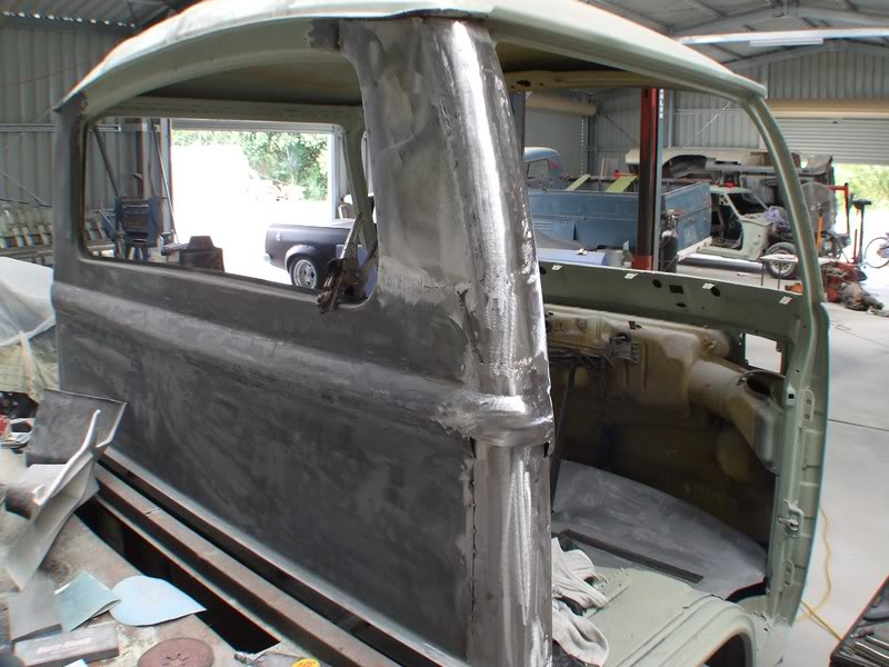

Well I did a little bit more today, but I've been spending most of my time on the 55 kombi.

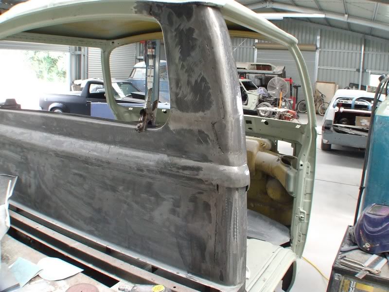

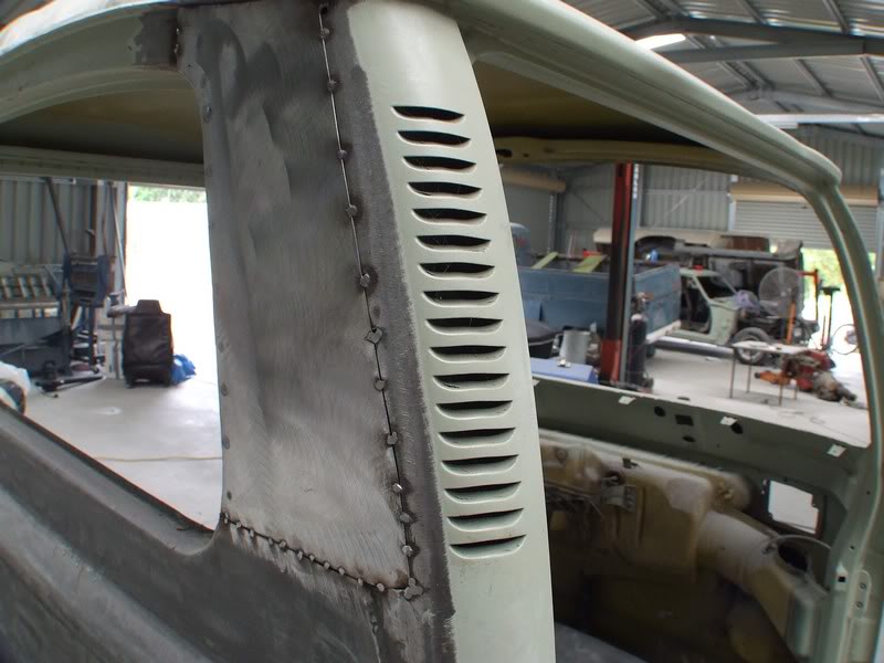

First thing I did today was remove the vents from the drivers side rear pillar, as they're only on this side and I like things symmetrical.

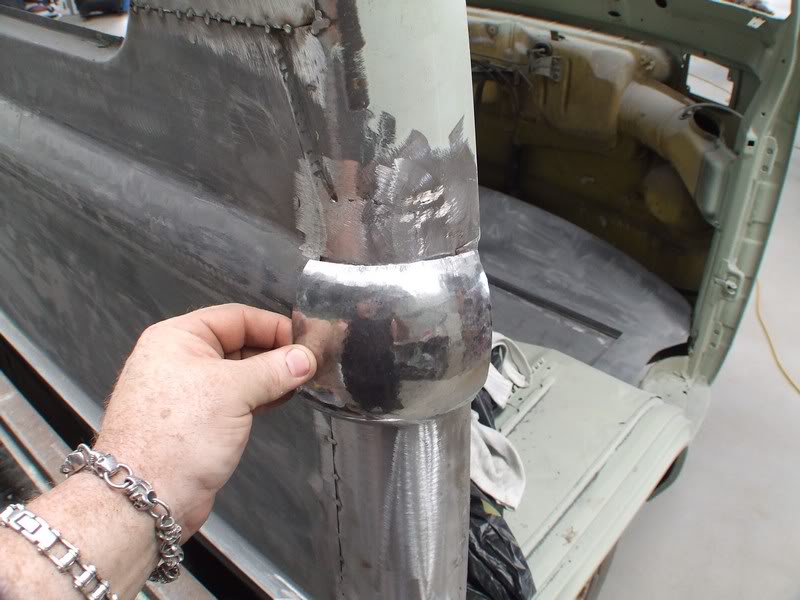

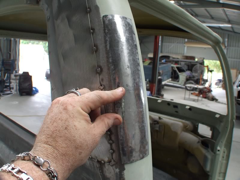

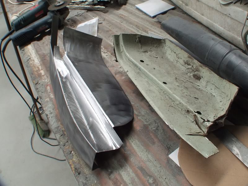

Next bit was to start on the corner of the swage line. I'll do it in two pieces like I did on the other side.
I'm not sure when I'll get back to this so I coated it in some more rust converter for now.
That's all I had time for today apart from the 55 kombi and he doesn't want it posted until it's finished, so now you get a break from my mindless rants : )

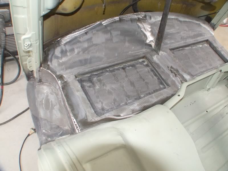

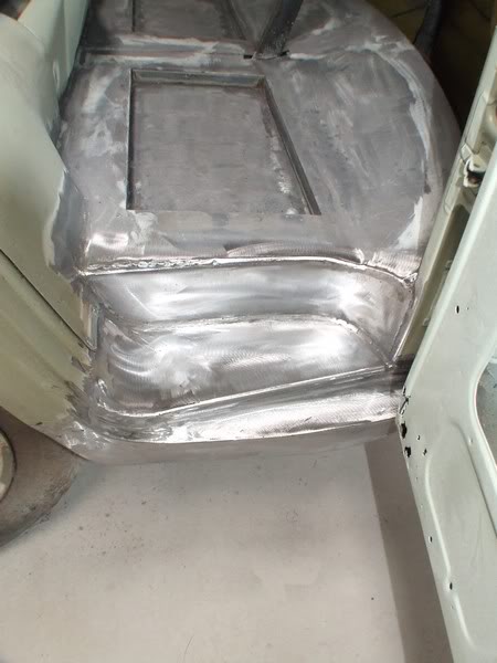

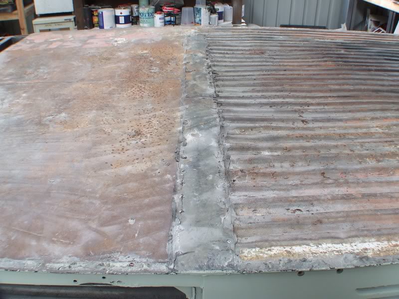

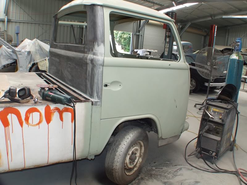

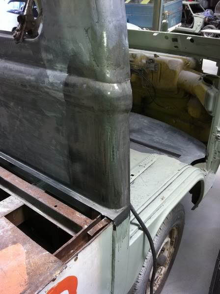

I finished the corner of the cab.
I also finished the passengers side step and fully welded the floor in. It was only tacked in before.
I then made the step for the drivers side.
With the door back on you can see how good it looks with the new rear wall and the thick swage continuing all the way around the cab.
That's all for now : )

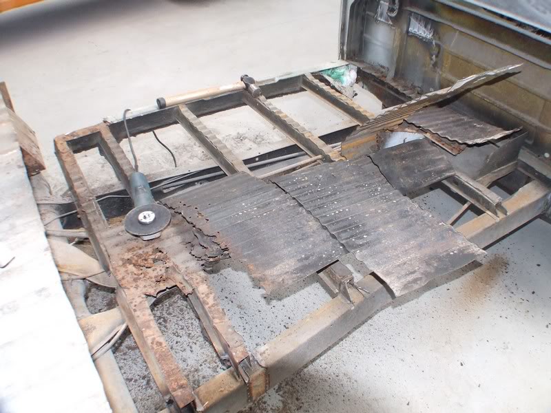

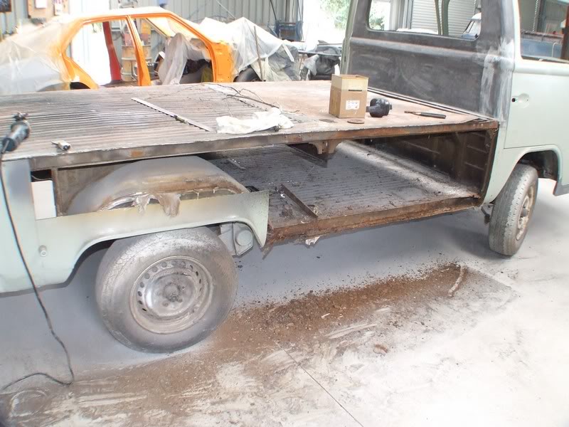

Well today was a pig of a day, but it was fun at the same time.
I'm still coughing up rust and dirt. You'll see why soon : )
It's been a really good workbench this old beastie, but today I had to clean it up so I could chop it up hehehe.

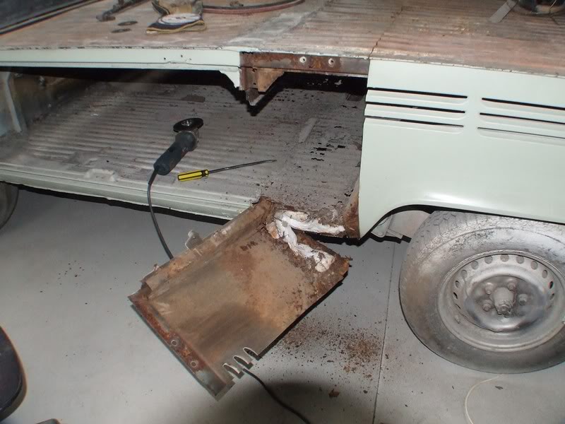

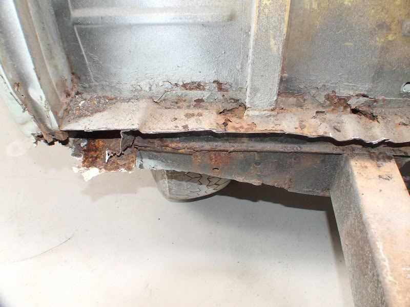

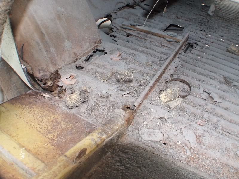

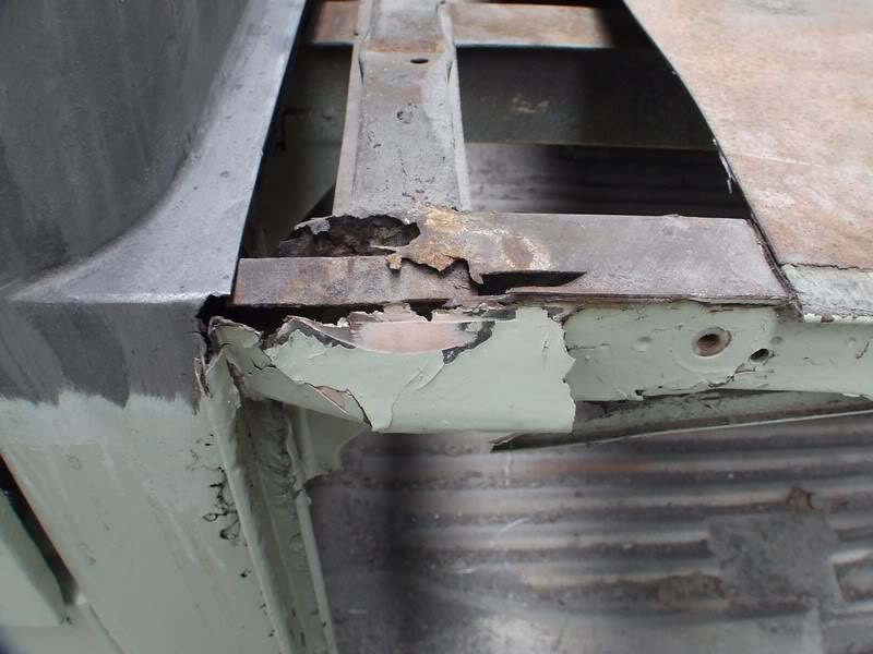

There are some really good quality repairs on this car. Here's a couple.
Bog that rust : )
Let the games begin!!!!!!
A few corn cobs in there. Not really sure why???

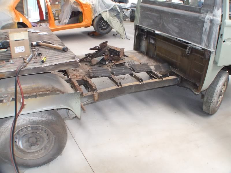

I'm going to remake the entire rear quarters from scratch, but I'd like to retain the original wheel arch. The sills will be 3 inches deeper too, so the rear end will look a bit chunkier and make the car look lower. Having said that, it'll be getting dumped in the weeds too : )

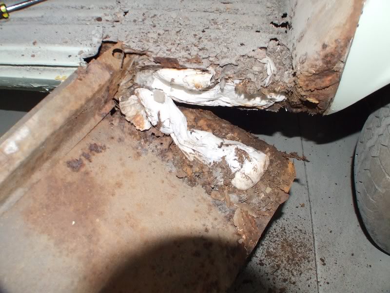

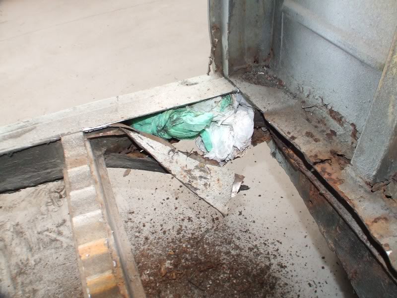

I started chopping a bit out of the passengers side, and found another of those really good quality repairs.
In case you're wondering, that white stuff is plastic bags. hahaha. I cracked up when I saw that : )

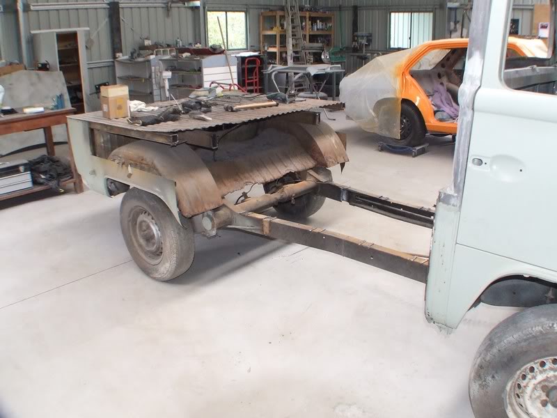

Getting there now.

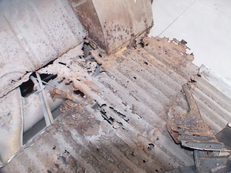

Here's just a small look at why I'm cutting this thing down to nothing.
More plastic bags in the front of the left hand sill. It still makes me laugh : )
Nearly there : )
How good does this look? hahahaha!!!

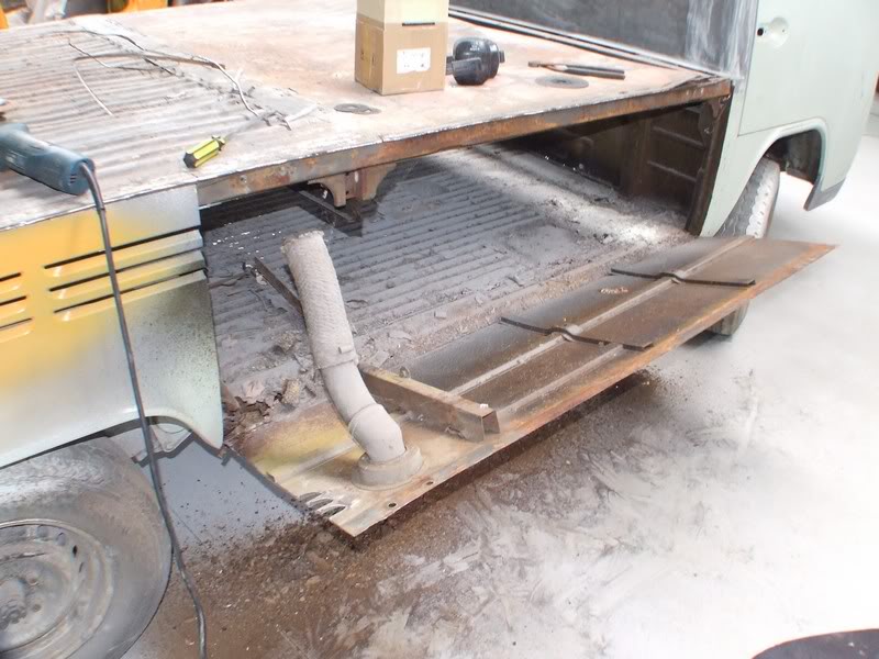

I'd rather build the whole rear end from scratch than bother to try and fix what was there. Plus I can design a nice cavity in between the chassis rails for the radiator.
I still have to remove the top rails and tray floor on that rear section, but I ran out of day. It took quite a while to get it to this stage. Even though it has a full chassis, it's all welded together. No bolts. I must have gone through about 15 cutting discs. I used the oxy to cut some of it but I need to bite the bullet and get a plasma cutter. I have an SIP one here, but can't find anyone who supplies the tips for it anymore.
I also need to replace the outriggers under the rear of the cab as well. Now the middle part of the car is gone I have good access to fix these bits now.
So next time I'll get the rest of the tray cut off, then I can start building the new bits!!!!
