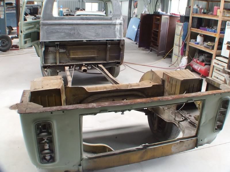

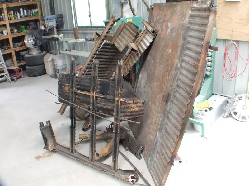

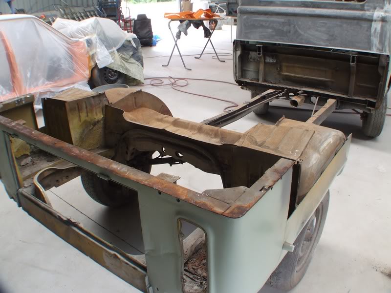

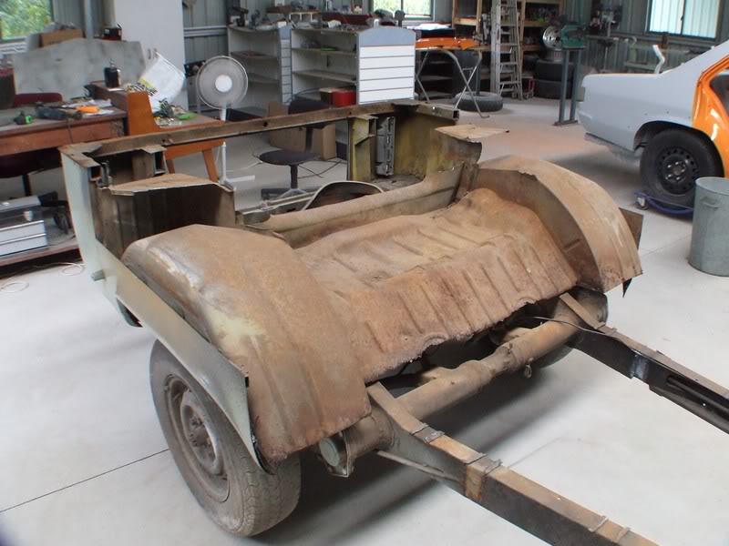

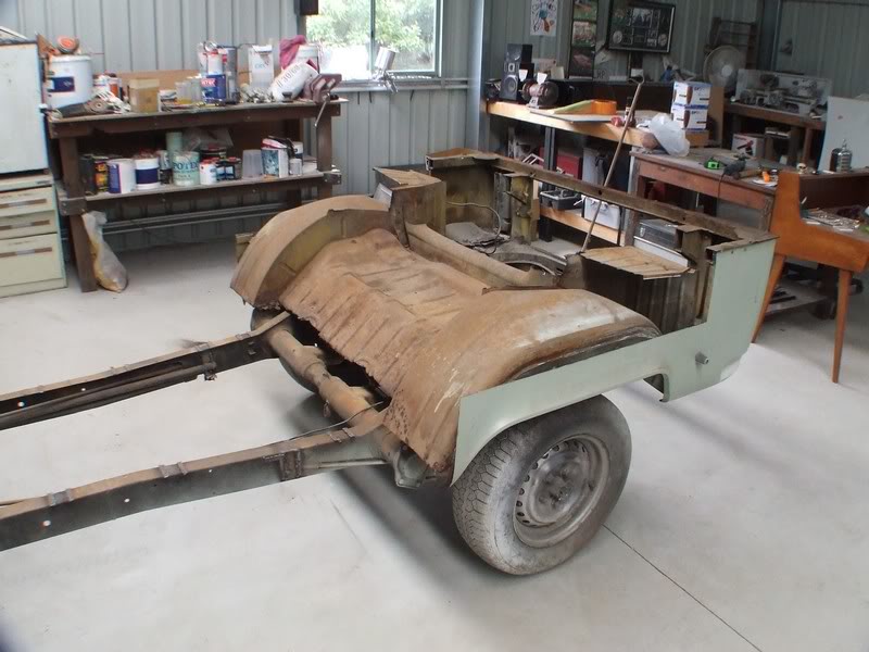

Well I did a bit more chopping today.
Here's a nice pile of crap : )

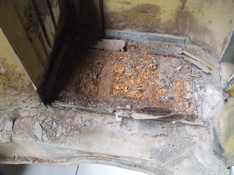

Even the bits that are left need some rust repairs.
The battery tray is a common rust spot for kombis so no surprises here. A lot of the engine bay will be removed as I don't need all the tin work that the air cooled motor needed.
Today I also bought all the steel to rebuild the rear end.
I bought two 8 metre lengths of 75x50 RHS with 2mm wall, three 8 metre lengths of 25x50 RHS with 2mm wall and four 1200x2400 sheets of 1.6mm zinc sheeting. Not cheap!
I had the steel mob cut the lengths in half for me. Easier to transport.
I might have to bite the bullet soon and get a plasma cutter, as it will be worth it's weight in gold on these rusty beasts : )

#62 _dirtbag_
_dirtbag_
Posted 06 April 2011 - 12:32 AM
Yeah, it's the suspension mods that are the main problem, not the engine position itself. The whole rear suspension and diff arrangement would need to be removed and replaced, and Qld rego doesn't like that. Not on a post 1948 car anyway.
If you can find a set up that you can mount without modifying the actual suspension then it should breeze through. ie; maybe a HQ tonner diff and leaf springs and make up mounts to keep everything in exactly the same position it would be in under the HQ - c'mon you know you want to :-)

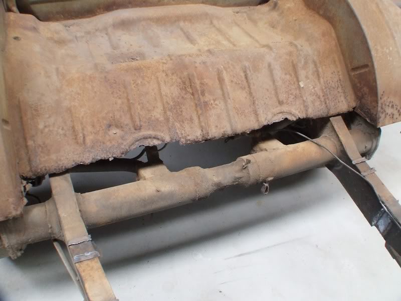

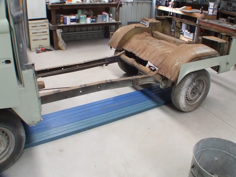

The problem with that, is to fit the rear end from a tonner, with live axle and leaf springs i'd have to cut all the kombi suspension out.
The kombi uses torsion bar IRS with the torsion bars running across the car, leaving no room for a tail shaft.
The big tube thingy is the housing for the torsion bars. You can also see coming off the tube are the inner mounts for the trailing arms. This is the stuff that isn't allowed to be removed.
At the end of the day it's going to be an awesome car, no matter where the motor is : )
