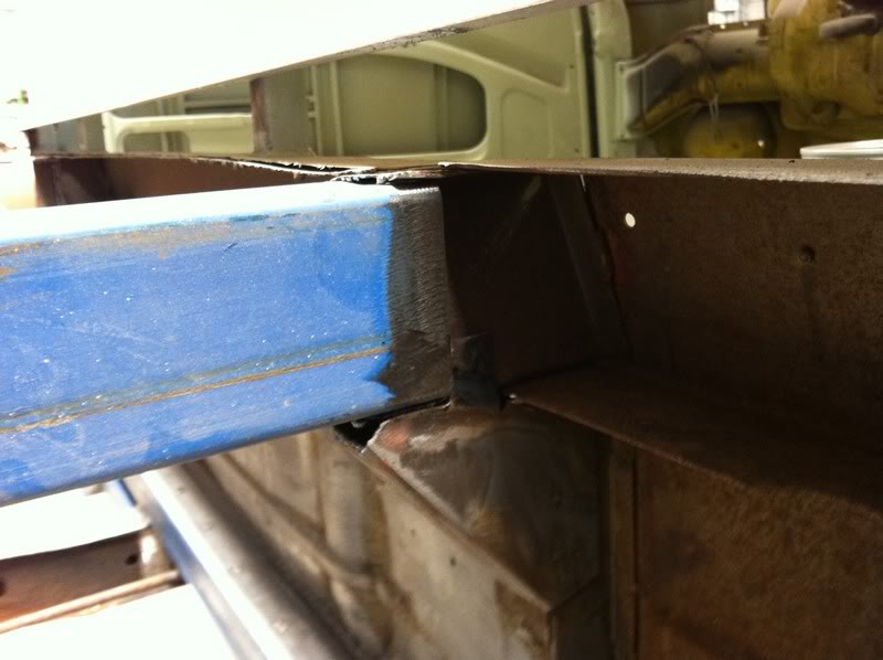

OK, seriously, the chassis is actually a box, it's just that the inner wall isn't in line with the edge of the rail. Having said that, there is also another set of rails to go in that I've removed. The normally run along the underside of the tray, but with everything on this car being so knackered, I just removed the lot. I'll replace them with some more of the thick wall 50x75 RHS.
You can see where the old rail was in this next pic. You can also see that the chassis is a box section in this pic too.

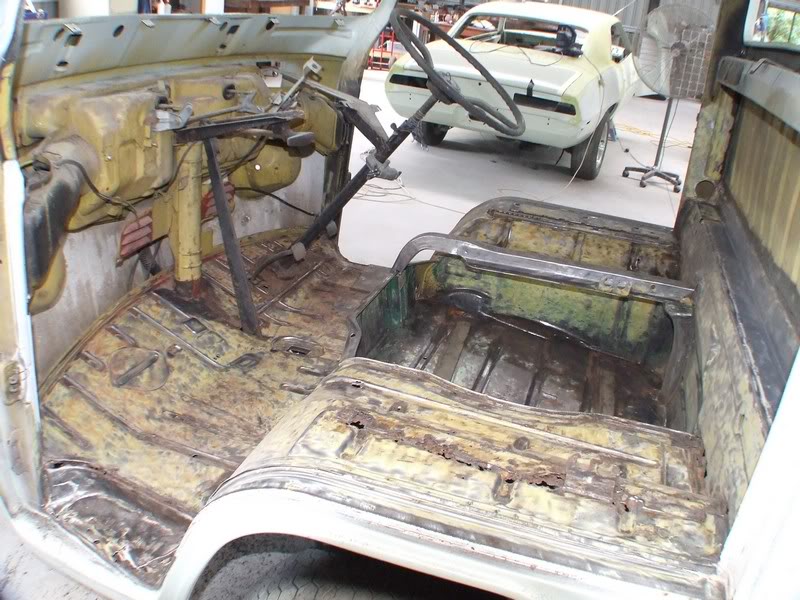

Hi Stinga. That muffler looking thing is part of the heater tube system. It used to run from the engine bay to the cabin, and use the hot engine bay air as a heater, seeing as there's no water : )
This next pic shows it coming up the front of the floor and into the vent system that lives behind the dash. All of it is gone now hehehe.

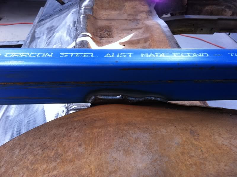

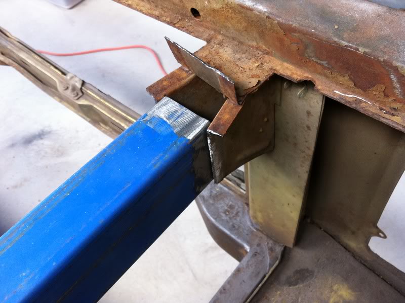

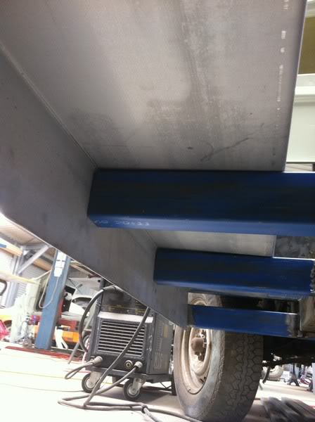

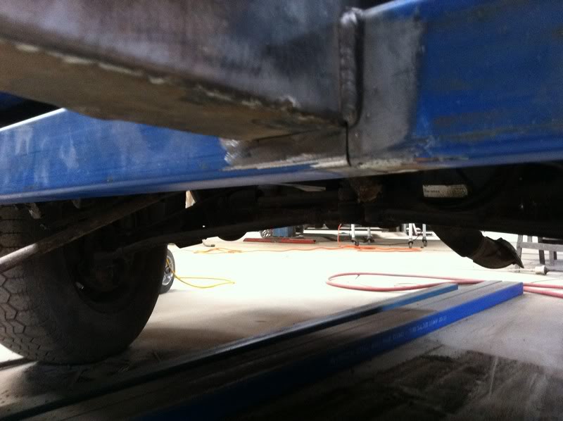

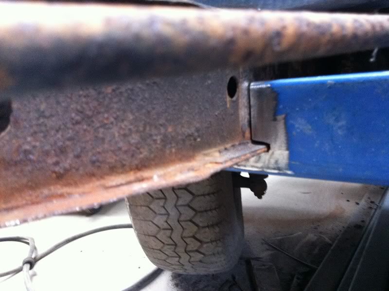

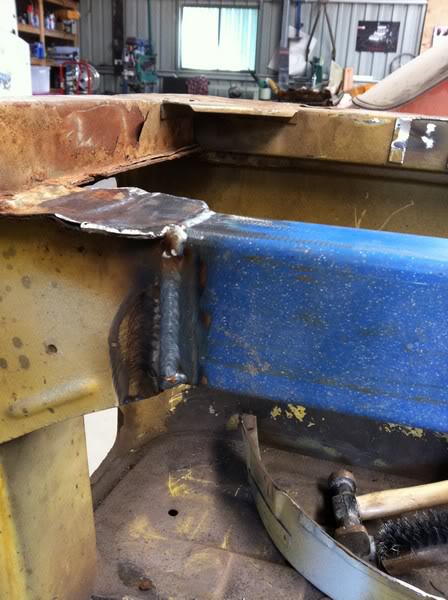

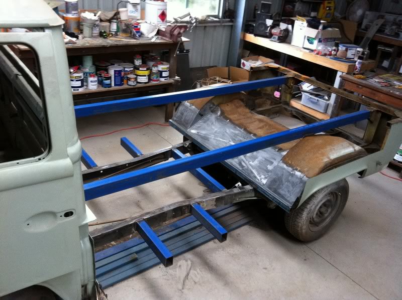

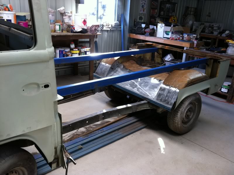

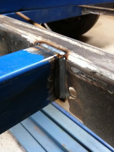

Well today I couldn't help myself. I wasn't going to do any more on the ute this week but all this talk of the top rails made me want to fit them. So I did : )
I cut a recess into the existing front rails for the new piece to slot in to. It will make for a longer join weld, meaning it will be stronger.
The new rails I'm fitting are slightly wider than the originals, so I spread the existing rear rails so the new piece could go inside.
Then I welded them in.
I also joined the tops of the wheel tubs into the new rails to help tie it all together.
It still looks like a throw away heap, but it's feeling really solid now. Can't wait to do more!

Haha no duu duu I was going to make a thread today on whats the Strongest way to weld 2 RHS sections together.... Either as a T or straight on end to end..
More on topic, looks great now... much more solid

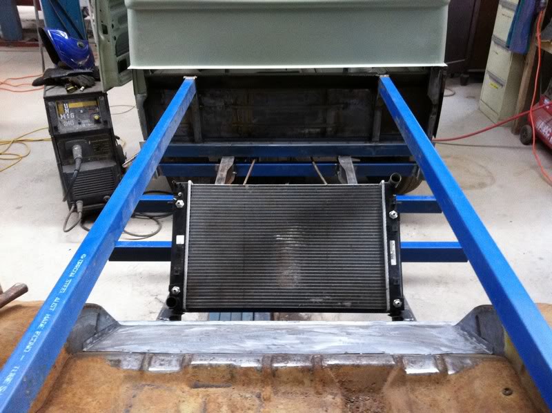

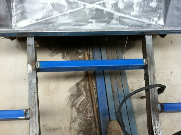

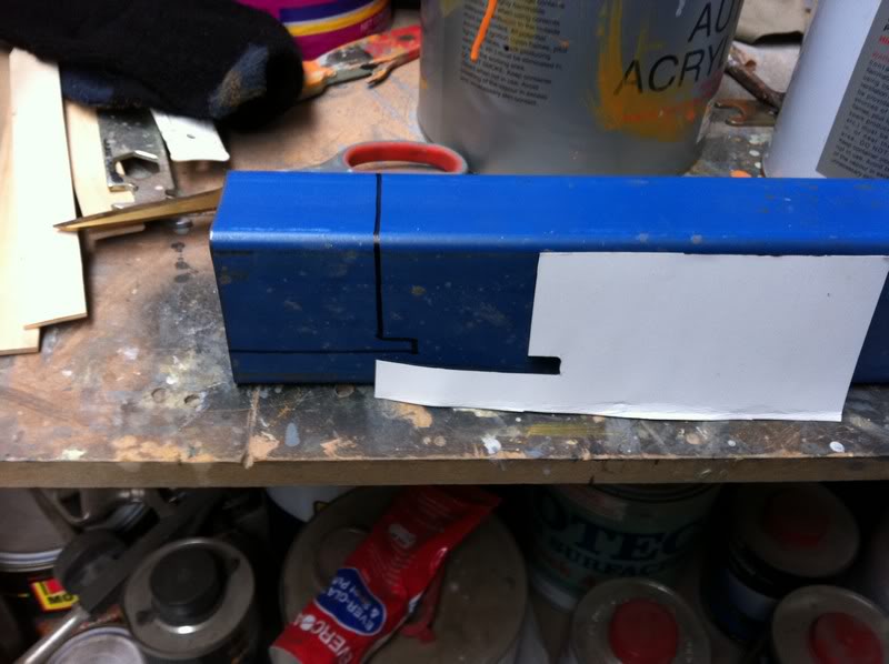

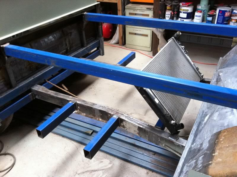

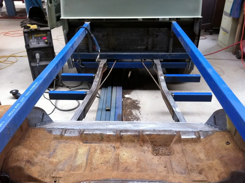

I did a bit more on the old beast today.

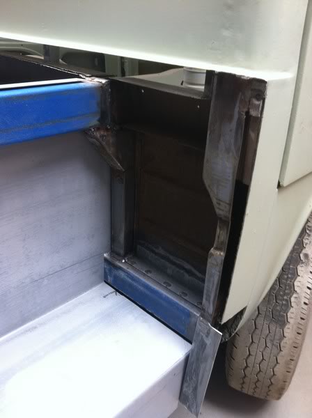

First job was to put the centre section in the front crossmember.
I want it to wrap around the chassis so Imade a cardboard template and marked it onto the RHS.
It fits great. Holds itself in nicely even before being welded.
I then made and welded on the outriggers. The originals were just folded top hat sections, but I'm happier using the RHS for these. You can also see the centre part of the front crossmember in these next pics. Just so you know : )
I try to get the welds as good as possible when doing structural work. I think they turned out OK for a dirtbag.
After than I made the rear crossmember. Again, the original was just folded 1mm, so this will be a lot stronger.

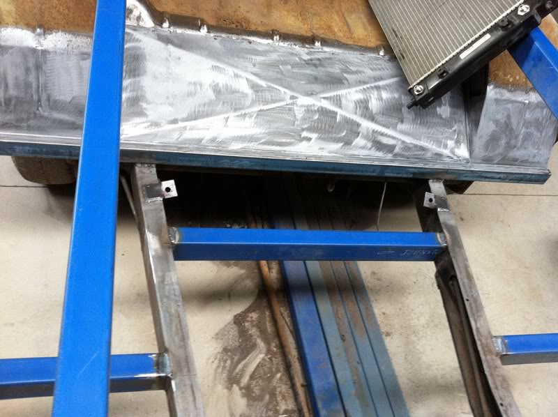

I then made up some lower radiator mounts. They're just 50x3mm flat bar, but will do the job here no worries as I've made a gusset to go underneath. I'll bore the mounting holes out properly when I get the rubbers for the radiator to sit in.
The radiator is from an LS1 powered commodore. This is a cheapie second hand one I bought to use as a mock up. I ran out of day so haven't made any top mounts yet.
It's hopefully not too far away from being sheeted in now. Can't wait to get to that bit!

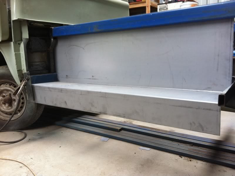

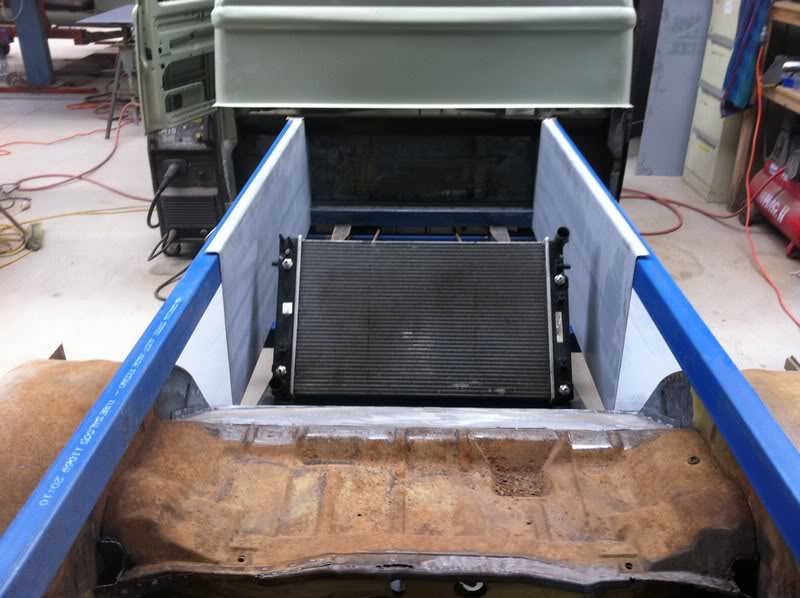

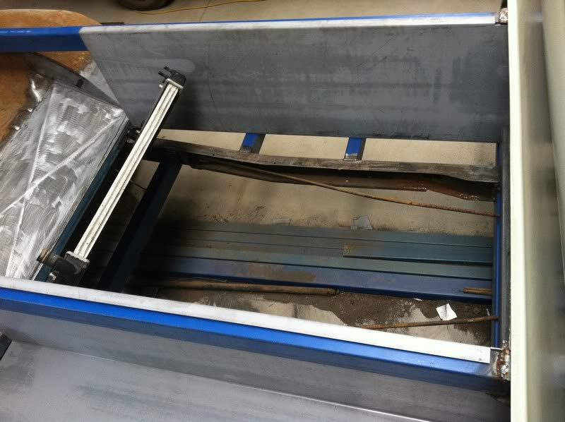

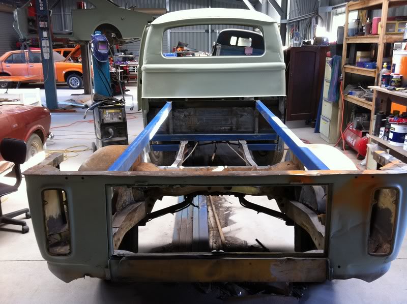

I did a little bit more today.
I started making the chamber for the radiator.
Each side is also the new inner sill. It seemed better to do each side in one piece, even though it was a bit of a pain.
I used 1.6mm zinc, so it's strong enough to not need any swages. Plus there is more framework to go in yet.
This new inner sill is 3 inches lower than the originals. Should give the sides a fatter look.
Lots of welding to get done in here. I'll fully weld around where the ends of the RHS meets the inner sill, and plug weld the rest of it from above.
Here's the other side made and sitting in place. You can see there is heaps of contact areas between the frame and new sheetmetal so I can weld the living daylights out of it. This thing will be SOLID!
There will be no floor in the centre, for obvious reasons : )
The areas created on each side of this chamber will be used too. Not sure whether both sides will have fuel or gas tanks, or one side fuel or gas and the other side just for general storage. The timber tray will have trap doors in it to gain access to the radiator chamber, the side pockets and the engine bay. Should work well.
