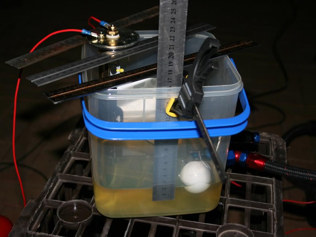

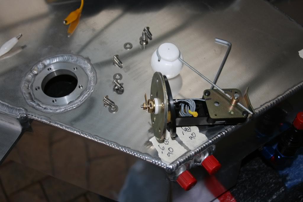

Posted 17 September 2011 - 10:15 AM
I got a new fuel sender in the mail today as well.... I am using a tube style one now (like fuel cells use) but it doesn't seem to work all that great with the drop tank and stock gauge on the dash.
I found a universal style swinging sending unit (like the stock design uses) so going to give that one a go...I think I can mount it in the same hole I had the other sending unit (on the top of my drop tank) so will just see how it goes. Will get the pulley on tomorrow too and snap a pic B)

Posted 17 September 2011 - 01:50 PM
VDO 220.003 10-180Ω will work with the factory gauges F 10Ω E 184Ω. You just have to mount the float on the opposite side of the pivot so when it is at the top it is 10Ω and at the bottom it is 180Ω. It will mount from the top.
It is easier to calibrate in a bucket.

I think I gave the wrong sender number, I originally had the factory gauge but then changed to the aftermarket VDO. I think the sender for the factory gauges is 220.004 5-90Ω. Same design just different ohmn range.

That looks like a nice setup as well...VDO stuff is not as common here it seems though. I went with a universal one in as so much as it is adjustable for all different tank depths but still was the correct resistance for the factory gauge. I'm snap some pictures tomorrow to show just what style it is, bit late tonight to muck around in the shed.
And I made an acess hole in the boot floor so it's easy to get to the sending unit in the drop tank too!

And the fuel sending unit...
It is a universal length one.. Comes with a chart to set the depth and length of the float arm as well. A picture of how it came, and after I set it up for the correct depth. It fit right in as well!
