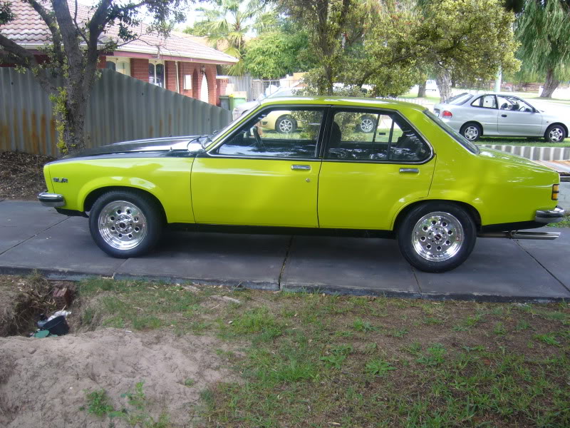

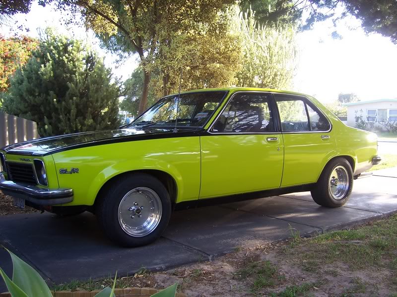

Posted 12 August 2011 - 06:20 PM
FYI.
First two are of 195/60/15 on 8 inch rim. Third pic is same size rim with 235/60/15.

The pictures are a bit deceptive - there is quite a visual difference in the way the tyres sit on the varying rim widths.
Take your pick.

I wasn't actually second guessing you before - some brands of tyres are a lot wider than others in the same size - but looking at your first few pics those don't look like 8" wide wheels...?

8 inch bead to bead, nearly 9 inches from lip to lip. Rims also vary a fair bit in how much extra meat sits outside the bead which obviously affects the way the tyre will look on a particular rim. The various 15 x 10 hotwires are a good example of this.

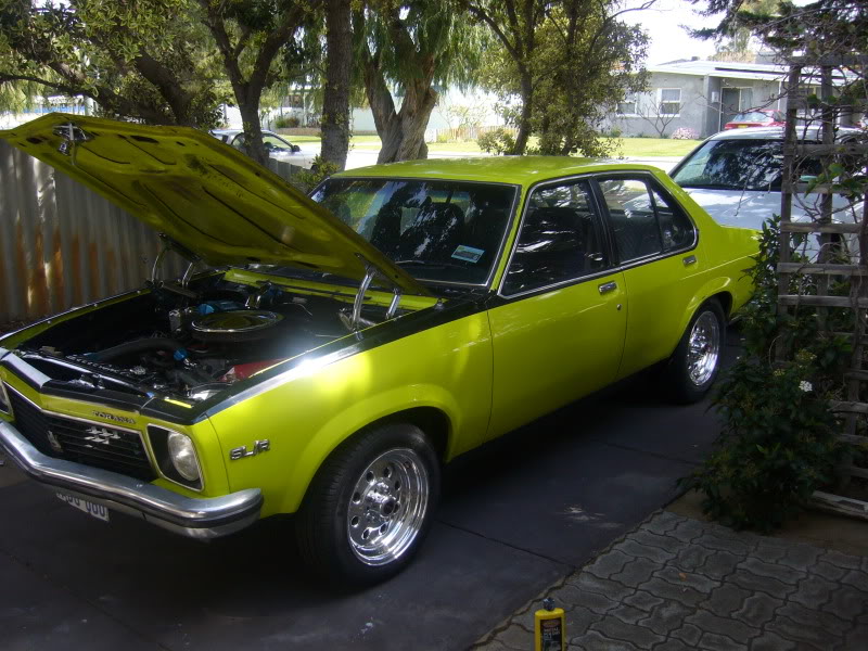

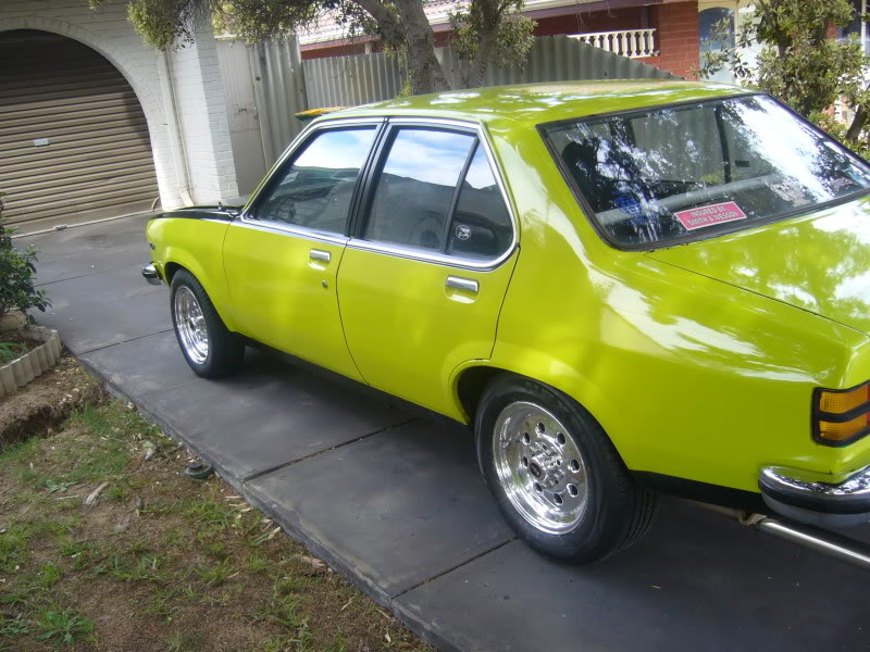

Posted 02 October 2011 - 05:58 PM
Well,Wheels/brakes/tyres all fitted up at last= just need the front guards rolled more and to fix the odd steering problem.
I was alost positive I wouldnt fit 8" rims on the rear but after fitting the 15 x 7" with 5.5 B/S 225/60 tyre it looks like I might have just got an 8" on there but would need 5.5" B/S again for it to fit on MY car might even change the rears later down the track?. Theres just bugger all dish on the rears now but will do for now,still pretty happy with it!
BEFORE
AFTER
Edited by 76S.L.R, 02 October 2011 - 06:07 PM.
