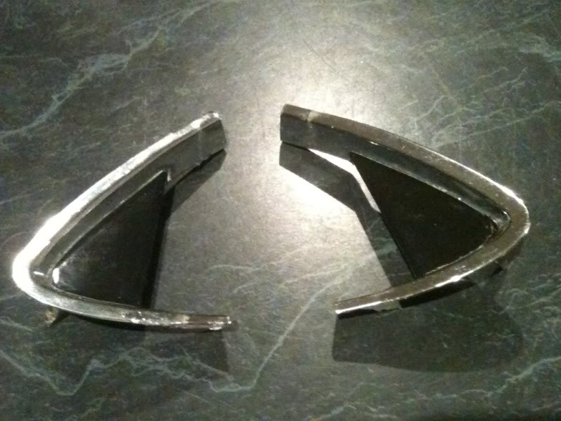

LH SL/SLR Stainless window moulding corner mouldng re-painted.

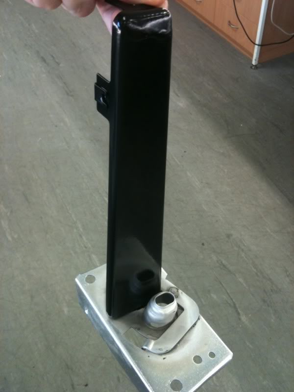

Also pulling down my shifter...

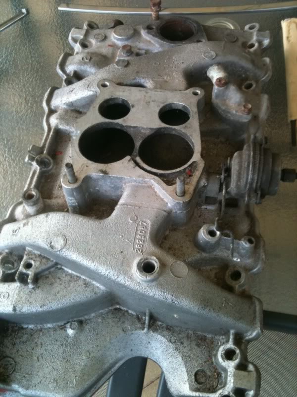

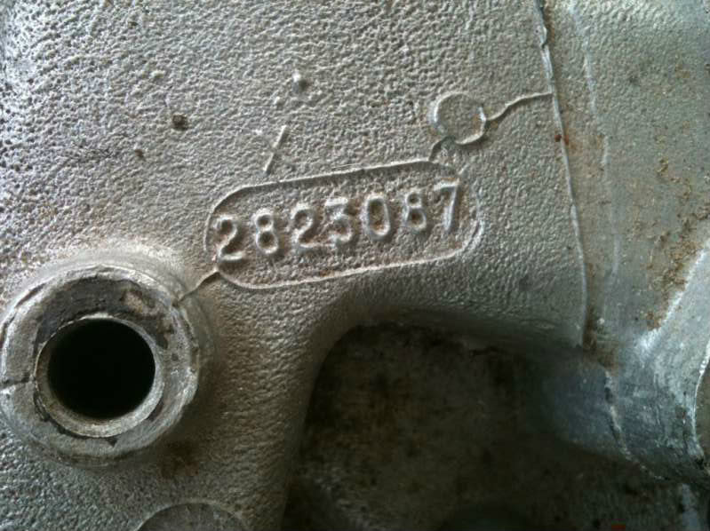

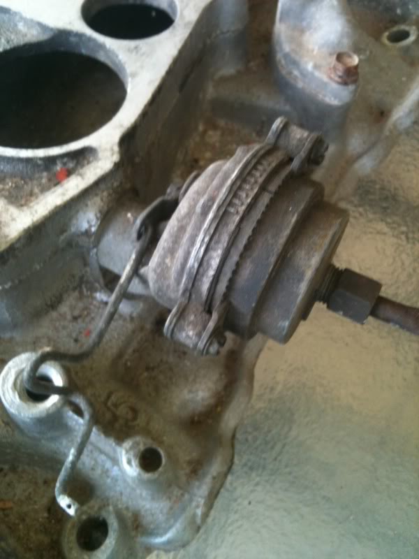

Can anyone identify what motor this manifold is from?
Weird...
#328 308 Sunbird
308 Sunbird
  • 976 posts
  • Name:Stuart
  • Joined: 20-November 10
Posted 21 December 2011 - 08:29 AM
Brad, thats the correct pre-pollution 308 manifold suitable for your car with the
auto choke spring in that housing-heated by the exhaust manifold.
#329 hanra
Posted 21 December 2011 - 10:01 AM
Thanks for the vote of confidence Stuart. Ill have to figure out a way to get the auto choke to work with my extractors....

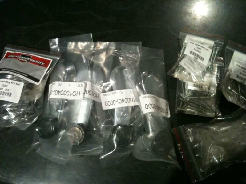

A few more little presents turned up today from Kingswood Country... I wish I had morrrreeeee money.....
#331 308 Sunbird
308 Sunbird
  • 976 posts
  • Name:Stuart
Posted 22 December 2011 - 08:33 AM
Whatchya get? I cant work it out.
#332 hanra
Posted 22 December 2011 - 10:08 AM
Hahahaha just some dumb stuff but it will keep me busy over xmas! Mainly just a heap of trim rivets and clips, new window winders, seat belt decals.. nothing flash...

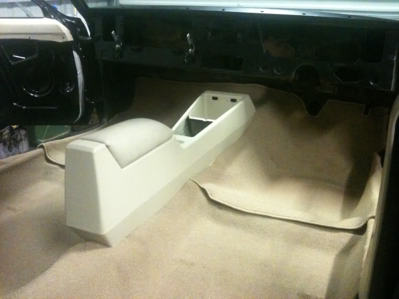

Quick dummy fit up of the console.
#334 _Viper_
_Viper_
Posted 22 December 2011 - 11:23 PM
How did you find the fit of the carpet? What brand is it?

Clint, the carpet is from Knox and so is the underlay. Im pretty happy with the fit actually. I had read comments over the years that moulded carpets were never much chop.... (Ive always started from scratch) but I think the fitment is pretty good actually!

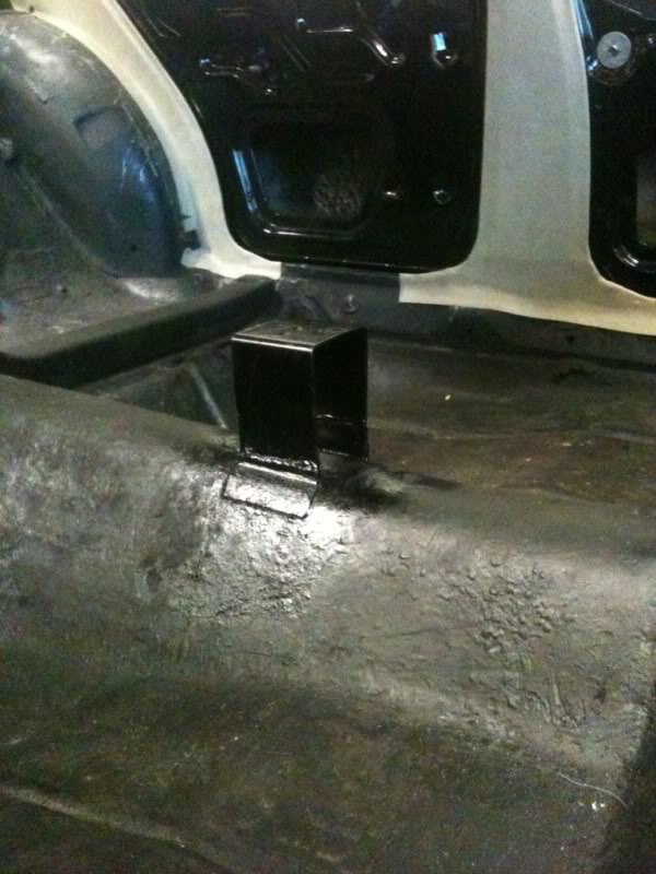

#338 _1ARC_
_1ARC_
Posted 23 December 2011 - 03:17 PM

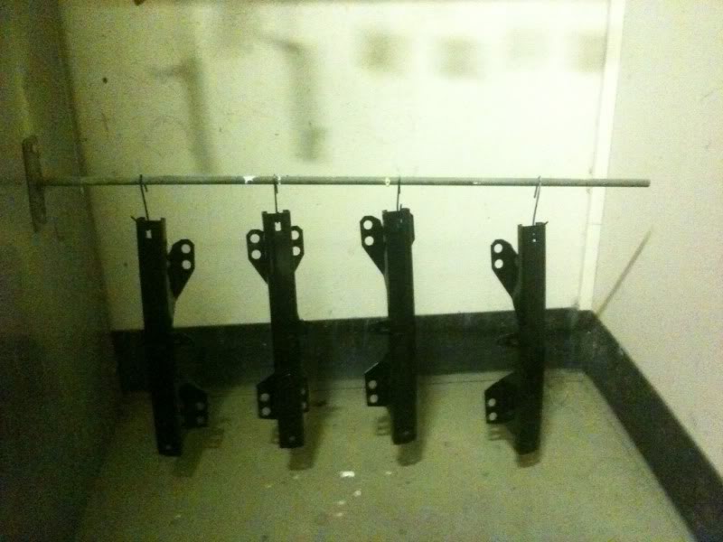

Great job brings back memories. Mate if I can give one advice, that is, unless you know already, seat brackets need to be bolted to metal portion of floor.
If you have the original carpet you will see what I mean. The carpet has cuts and cut outs for this very reason.
The reason for this is so that the seat is secured, metal on metal. You should apply a small amount of chalking compound to ensure that no water comes up from the bolt thread. If you bolt the seat bracket on the carpet, there is a chance that the carpet will squash down and the seat will no longer be secured. Could be an issue in an accident.
I believe that in some states it could be an issue is going over the pits.
Keep up the great work
#339 hanra
Posted 23 December 2011 - 04:13 PM
Ahhhhhhh, thank you very much for the tip!!!!! I did notice that the carpet has obvious places for where the seat brackets go. Ill make a small incision and allow the bracket to slip through and be metal on metal!

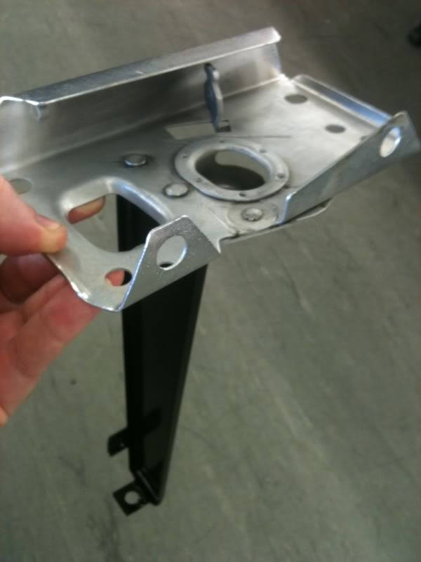

#340 hanra
Posted 24 December 2011 - 05:25 PM

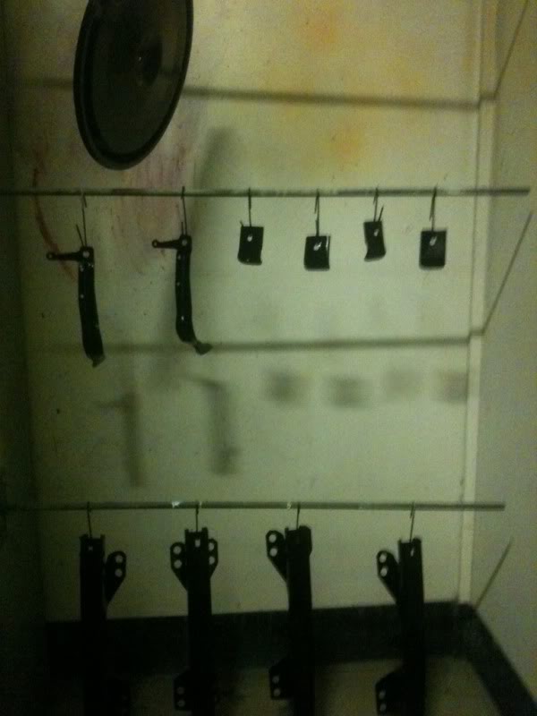

Speaking of seat runners and mounts. All 2 pac'd up.
