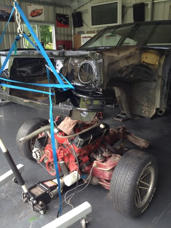

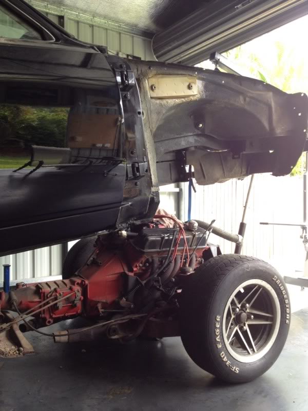

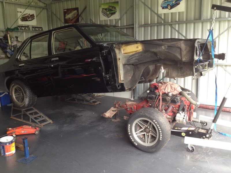

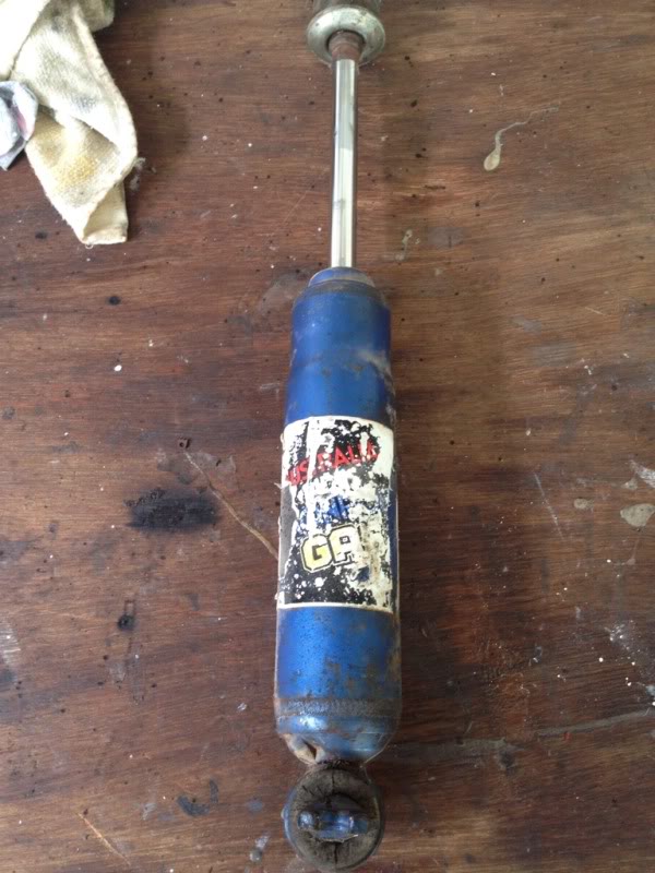

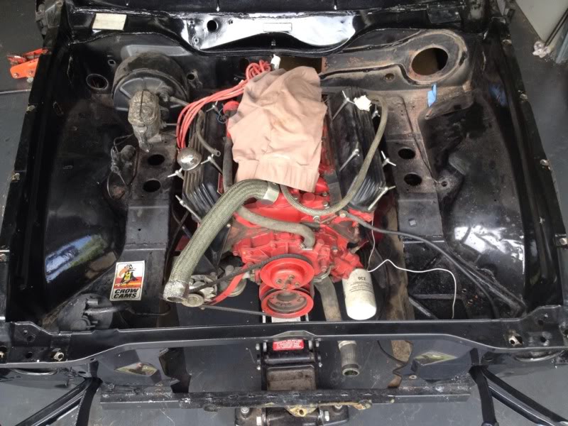

Popped the shocks n springs out last night whilst the K-Frame was still in the car.
Not sure how old these are? Monroe Gas I think?
Slipped the K-Frame and donk out this arv... Had an issue with the outrigger bolts..... They were fitted with the head of the bolt toward the centre of the car, so as the would come out they fouled on the extractors preventing them coming out... pulled the extractors off the the head but still couldnt remove them from the car..... and the bolts still fouled.... Finally got em out with some dicking around. Pretty sure the head of the bolt should be toward the outside of the car and nut is fitted on the inner part?

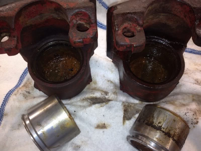

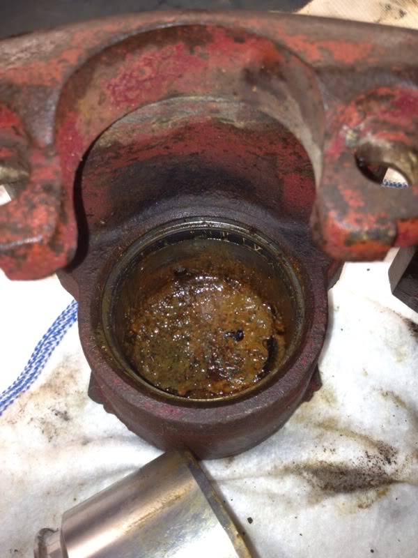

But have stripped my calipers down... the pistons were seized badly.. not sure if the calipers/pistons can be resurrected or not...

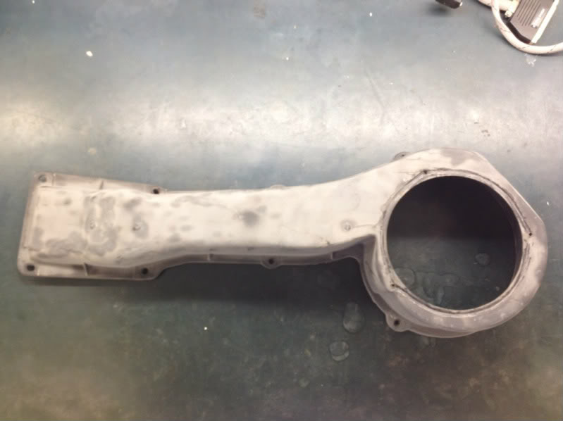

Scored an undamaged heater box, hit it with the soda blaster to get all the crapy layers of old paint off.. white/black/orange...

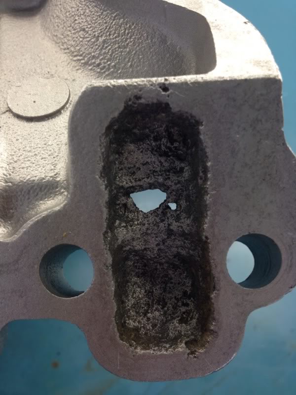

Gave my inlet manifold a blast also to clean it up. Noticed a lot of corrosion around a water port blank off... Bit of a blast and I went straight through... nice little hole... Ill have to get that fixed up...

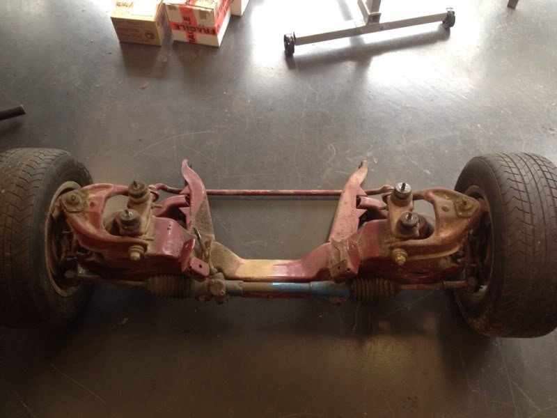

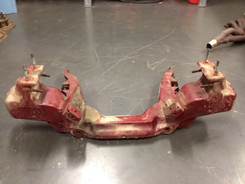

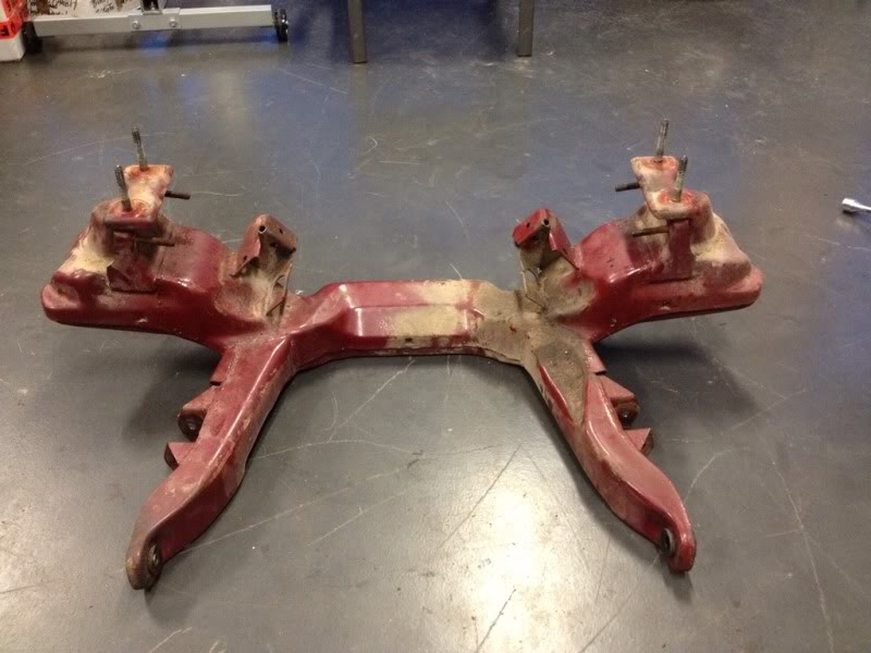

Pulled the K-Frame down today also, going to be a big job stripping all the powder coat of everything, blasting then 2 pac'ing...

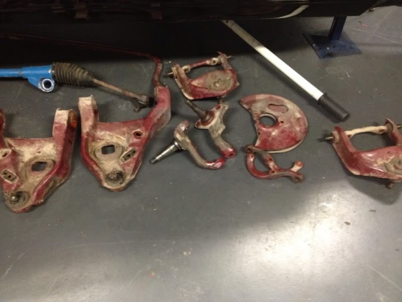

Got all the bushes pressed out and lower balljoints out using the press at work. Man those lower balljoints are in there tiiiiiight!!!!
I am so sick and tired of stripping off this friggen maroon powder coat... dead set...

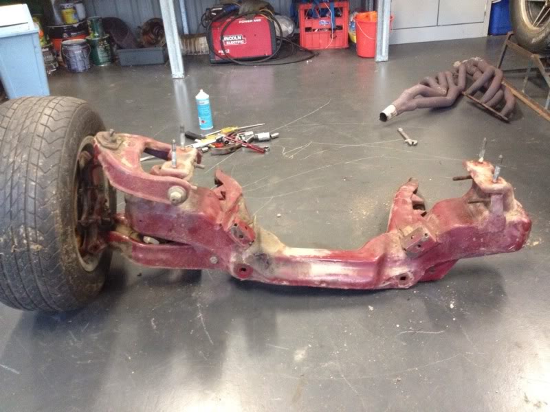

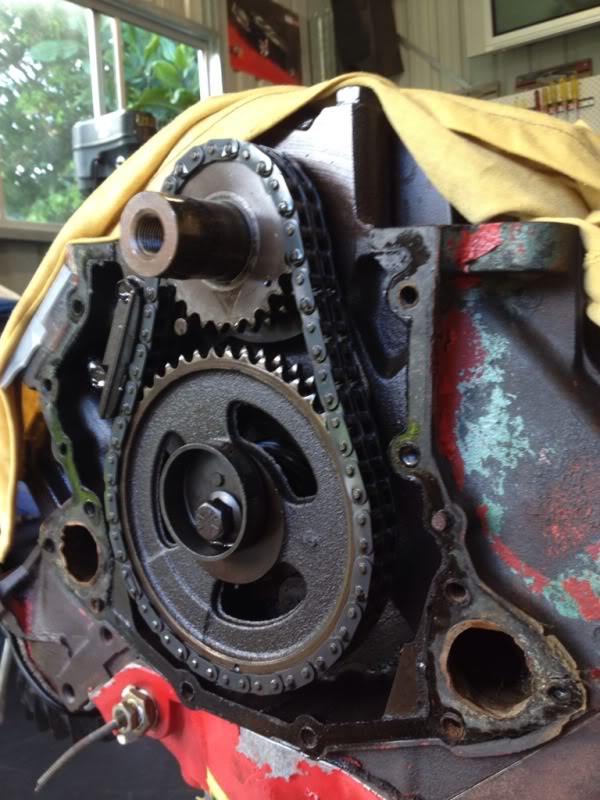

All the k-frame is in bits, most of it painted. Had to get the k-frame blasted cause it's to big for our stripper tank.
Pulled a few bits off the donk to get cleaned up.
We're dual row timing chains standard??
Edited by hanra, 13 February 2012 - 06:00 PM.

yes some had that as standard

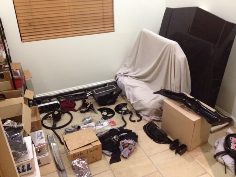

Havnt really got any good updates except the fact that the parts rooms are filing up again.... Ahhh how good is it living on your own!!!!!!!

Please chock those back wheels on the ramps!
Also you should be able to have stainless steel liners pressed into the calipers.
Edited by The Baron, 17 February 2012 - 03:24 PM.
#388 hanra
Posted 17 February 2012 - 10:44 PM
Its actually back on its rear wheels now. I hope those calipers can be saved.....

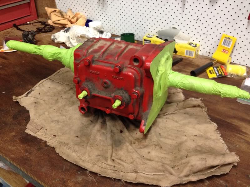

Some more stuff... blah blah blah...

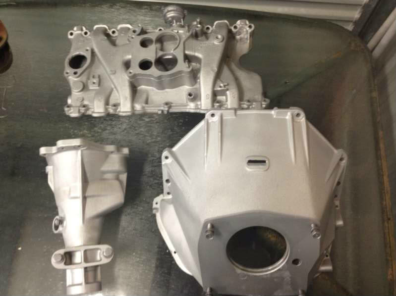

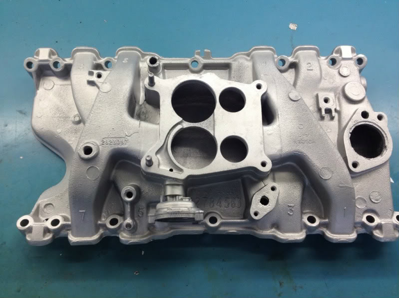

Manifold/bellhusing and g/box rear snout have been blasted. They were all red before and looked crap...

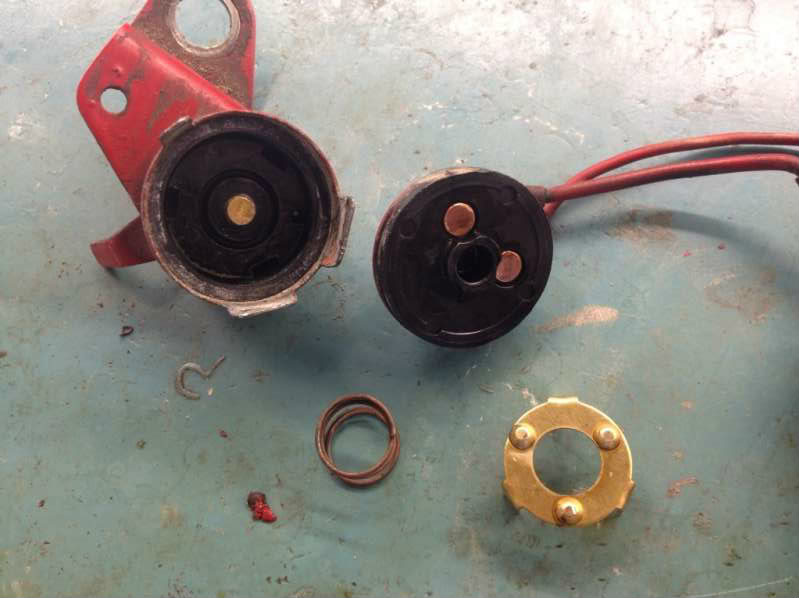

Gave my reverse switch a make over also. Its been re-painted black. I dont think this is the correct type for LH SLR 5000 however??

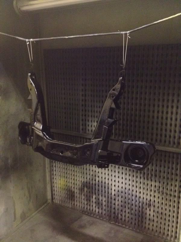

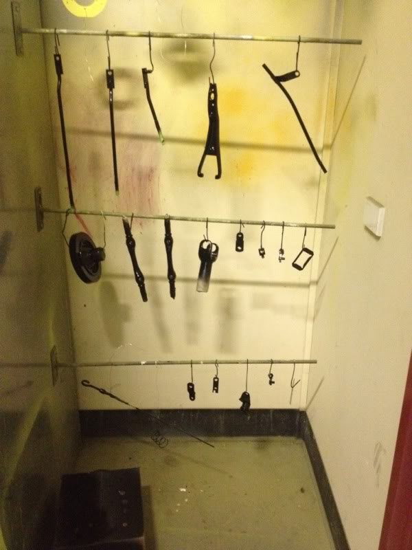

K-Frame is now black....

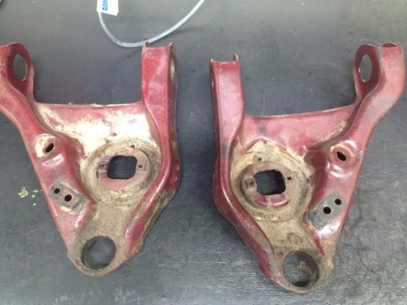

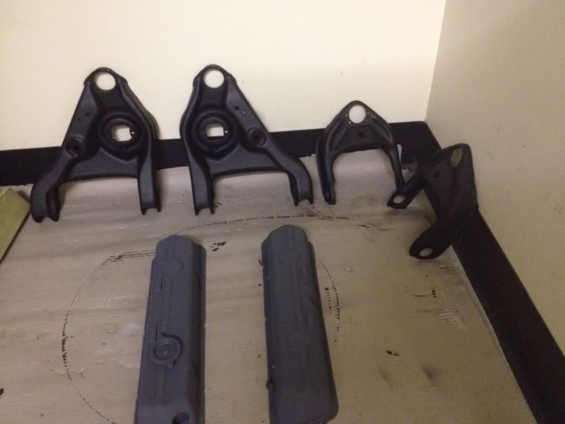

Have to press in all the suspension rubbers before I paint the upper/lower arms
More black bits...

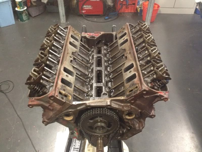

Stripped the motor down a little to get it ready for painting.

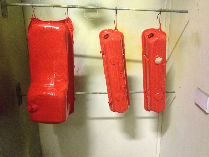

Sump/rocker covers HK Rocket Red

reverse switch looks ok to me brad
i had mine re-zinc coated but assembled it back to front
so reverse lights were on in neutral and all forward
gears
had to sacrifice one of the sidchrome 9/16,s to get the bastard out
of the tunnel so as not to drop the box
suggest you check your assembley and wiring before it goes in
in as it was a real pain in the ass to fix after

Ah yes. I was planning on setting up the shifter and linkages whilst it's all out of the car. Yeah I'll check the switch at the same time and confirm its closed circut when in reverse.

HK Rocket Red:

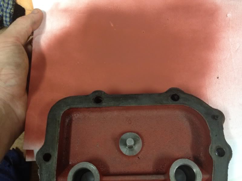

Gearbox to be done Red Oxide Primer:

Original Red Oxide versus the spray can Red Oxide.. I think its pretty close.

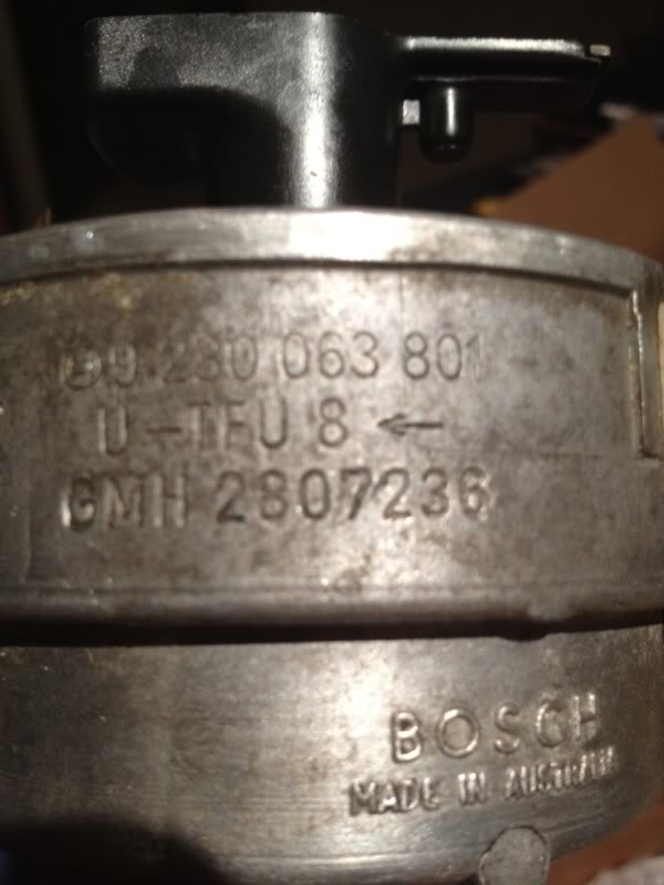

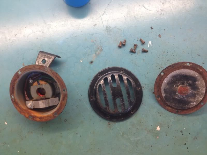

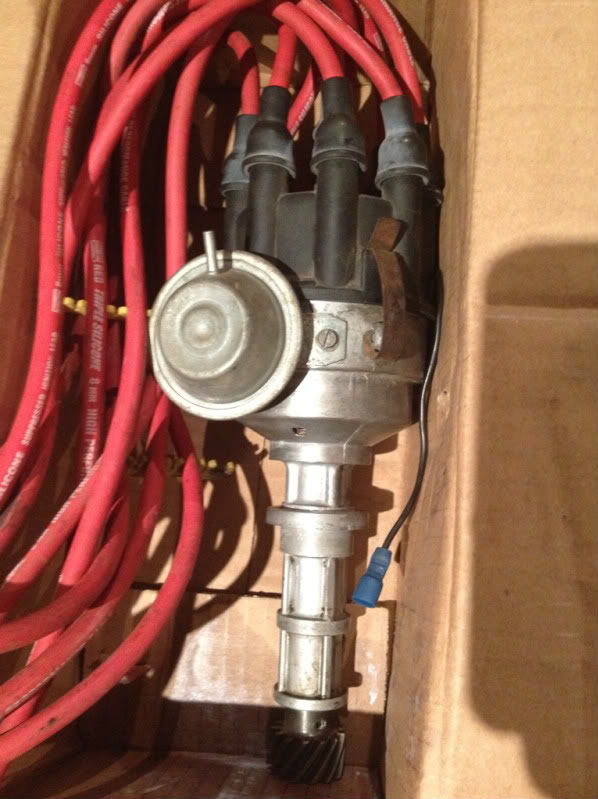

And thanks to my man Dattoman, Ive now got me self an SLR Horn!!!! Pretty effin stoked about that!!!
And I can get rid of my Mallory twin point and fit the correct dizzy!!! Once again thanks to Dattoman!!!
