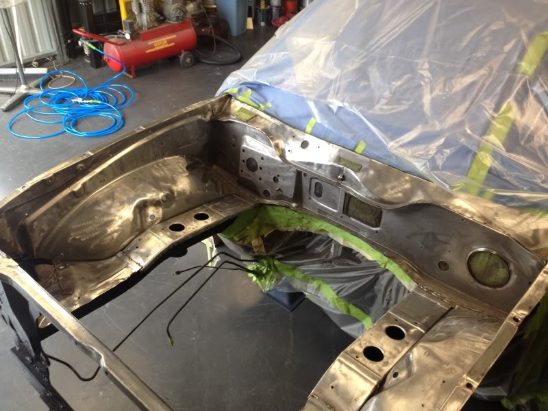

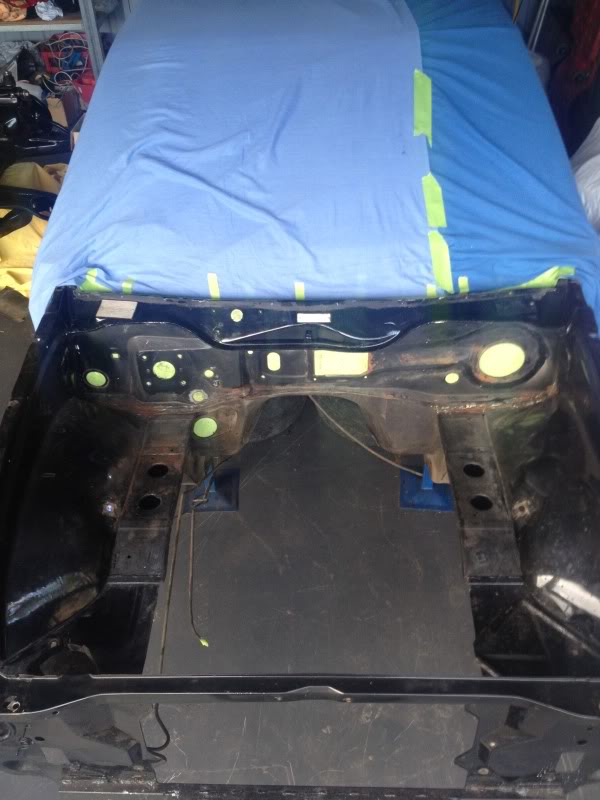

Thought I better add the engine bay before pics to this thread.....

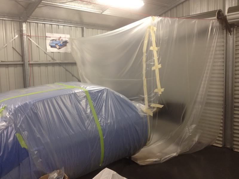

Posted 12 April 2012 - 09:59 PM

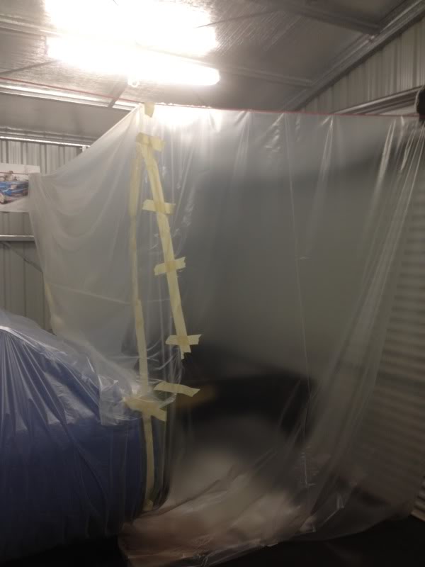

Ready to make a mess...

#457 hanra
Posted 25 April 2012 - 05:15 PM

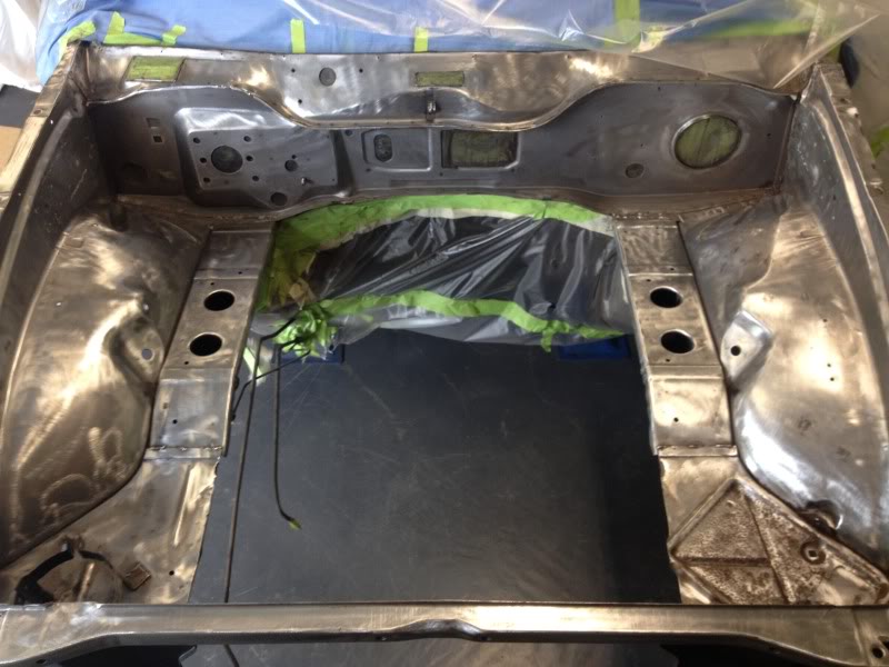

Pretty much getting over dealing with this engine bay. Panel work is just not my thing. I'm almost close to just throwing a cover over the car and walking away from it for a few months....

It looks pretty good to me - how did you go with the sandblaster?
Did it work as hoped and are you still finding crap everywhere, or did you revert to the wire wheel?
Regardless, I think your efforts looks great - well done.

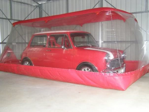

Anton, the bubble is a Carcoon, its the best thing Ive ever bought for that car... Stick it in there, hide it away in the shed, out of sight out of mind!!! Goes in clean, comes out clean. There are 2 fans/filters that run 24/7 that inflate it and filter clean dry air through. There is a zip that runs around the bottom of it all. Ive actually got a pulley system attached to the roof of the shed that lifts it all off the car. There is a new model Carcoon available that is actually free standing. If that was out when I bought mine, Id go for that one!!!! Does a good job of keeping the dogs slobber, spiders, ants, cockys and gekos off it.

Had no problems with the bay, I just dont like panel work... Its all gone well though, all the paints come off, Ive taken any old bog off, all the surface rust is gone. No nasty surprises underneath. The sand blaster gave me the shits cause the coarse grit I used the 2nd time round kept of blocking it up. So yeah I just went back to using a stripper wheel, sandpaper and what ever else I could find like my nana's false teeth!!!!
Going to skim a few spots with bog (bonnet hinge repair patches) then go over the metal with deoxidne, then once thats off prepsol and hit it with White Kight SLS etch primer. I guess Ill need some type of spray putty to cove some of the pitted areas of metal?

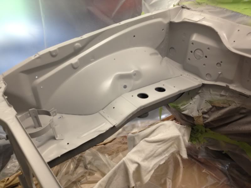

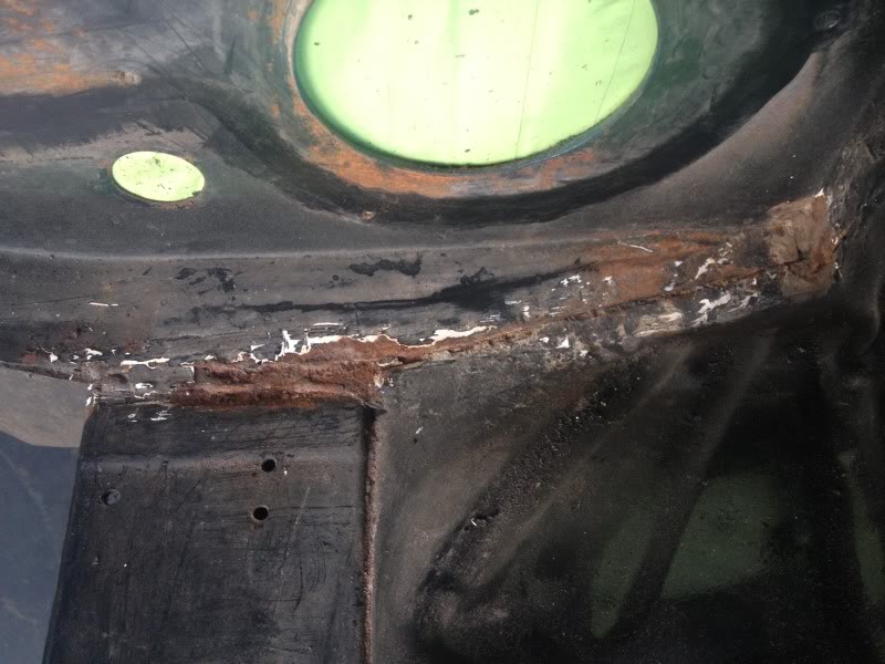

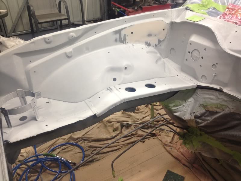

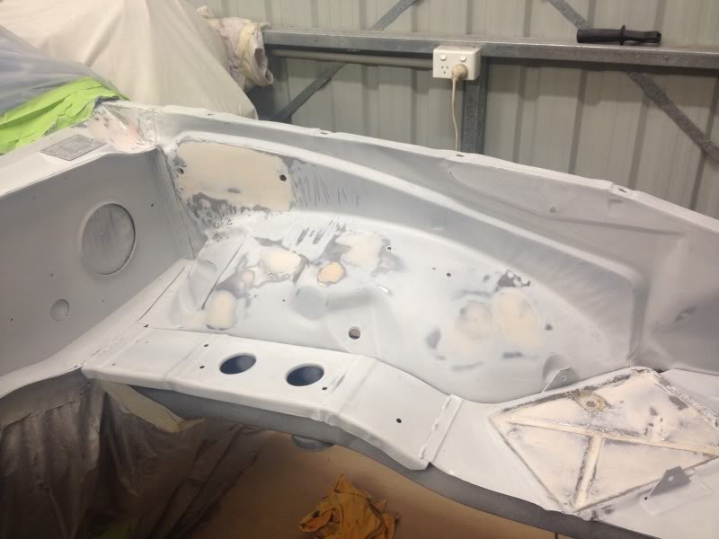

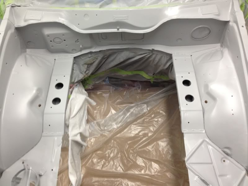

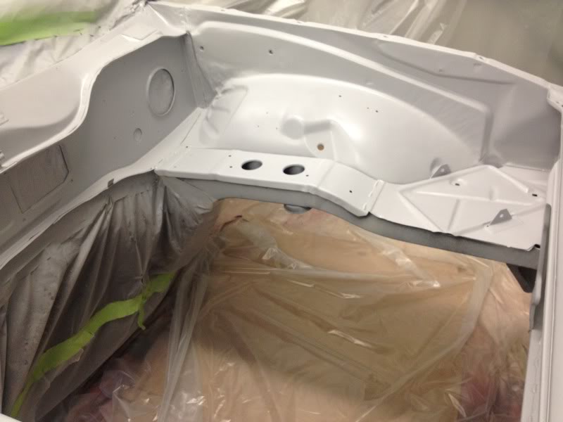

Anyways, had to skim a bit of bog around in the engine bay to cover up the welds from rust repairs from behind the bonnet hinges. Also a little skimmed over the passenger side guard. Funny, looks like its had a few dents pulled from there? Like maybe its had a little hit on that side? But only just minor? I thought maybe a wheel fell off or something? Balljoint failure?
Its got SLS etch primer down on the bare metal then I removed that back to bare in places where the filler needed to be applied.
Decided to leave the plates on

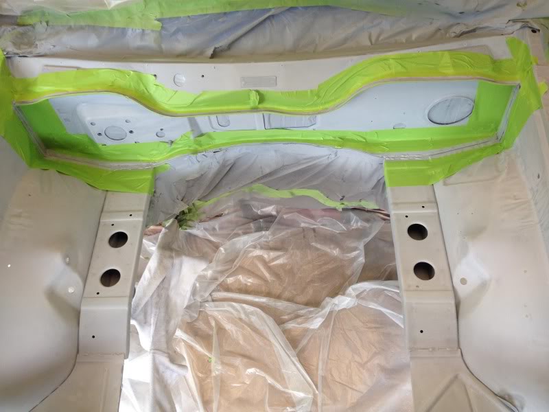

That was rubbed back then I hit the entire lot with a high fill primer. Been using all PPG products.

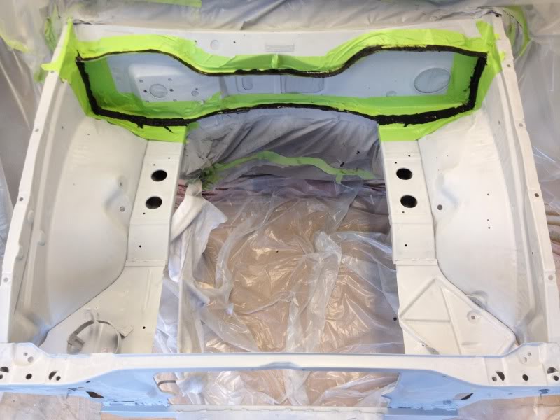

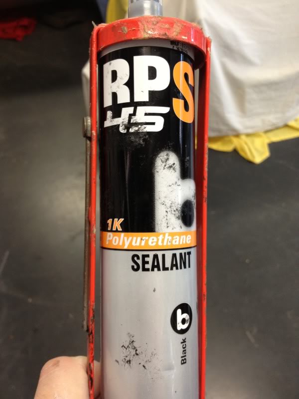

And now Ive started on the seam sealer. This stuff would quite honestly be the WORST product I have ever had to use. Extremely difficult to work with, I was starting to thing that perhaps I had a faulty product???
Im hoping that I may get some colour on tomorrow. See how I go.

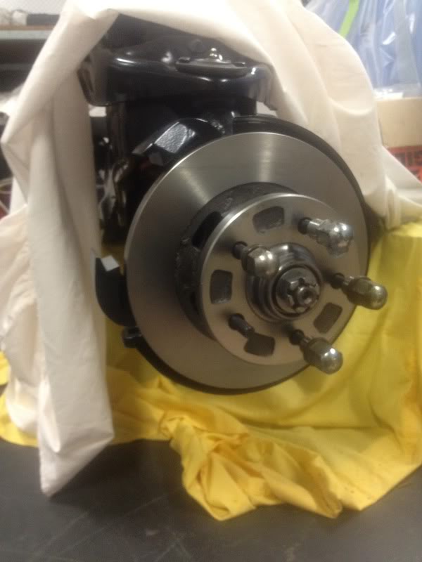

Oh, and fitted some low performance brake rotors to.

Mmmmm seam sealer.... I love just flicking it on with my finger.... probably the way they did in the factory :D Very messy stuff yea!
Nice progress. Nice smooth, yet original engine bay lines. Keep it up mate.
#473 hanra
Posted 06 May 2012 - 09:33 PM
That stuff was NO WHERE near what I thought it was going to be like... I was thinking a viscosity of perhaps windsreen sealant..??? I could barely get any out of the tube with my caulking gun... it was so thick and just extremely difficult to work with... Used a wet rag to try and spread it. Ive never come across anything like it... pain in the bum.

Posted 06 May 2012 - 10:12 PM
Is there a reason why you couldn't or shouldn't just use Sikaflex for this kind of job?
