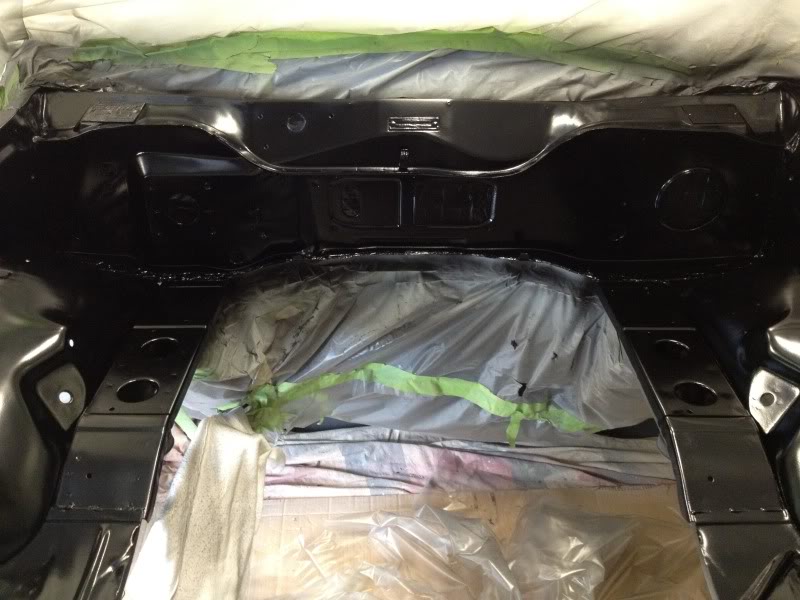

#486 _Bomber Watson_
Posted 08 May 2012 - 09:20 PM
Its a custom satin mix. They guys at the paint shop said they couldnt get 2 pac any flatter without the paint turning to shit? Something about something? Im not sure, I dont like paint.....! Its flatter then the satin that Ive been using on other parts of the suspension and what not.
Thats half true.
Yes you can only add so much flattening base to a 2k. Adding flattening base to a gloss 2k wont get you quiet as dull as a satin, adding flattening base to a satin will get you a bit shinyer than a matt, etc, what they failed to tell you (probably cause it wasnt on the shelf) is that most paint companies make a matt black.....
That said i hate matt black engine bays, it looks good how it is.
Edited by Bomber Watson, 08 May 2012 - 09:21 PM.
#487 hanra
Posted 08 May 2012 - 09:24 PM
Is GMH Satin Black really a Matt black????? Or is it flatter because it was an acrylic? They probably did have Matt Black in there but I went in specifically asking for GMH Satin Black. So went down the Satin road straight away I guess.

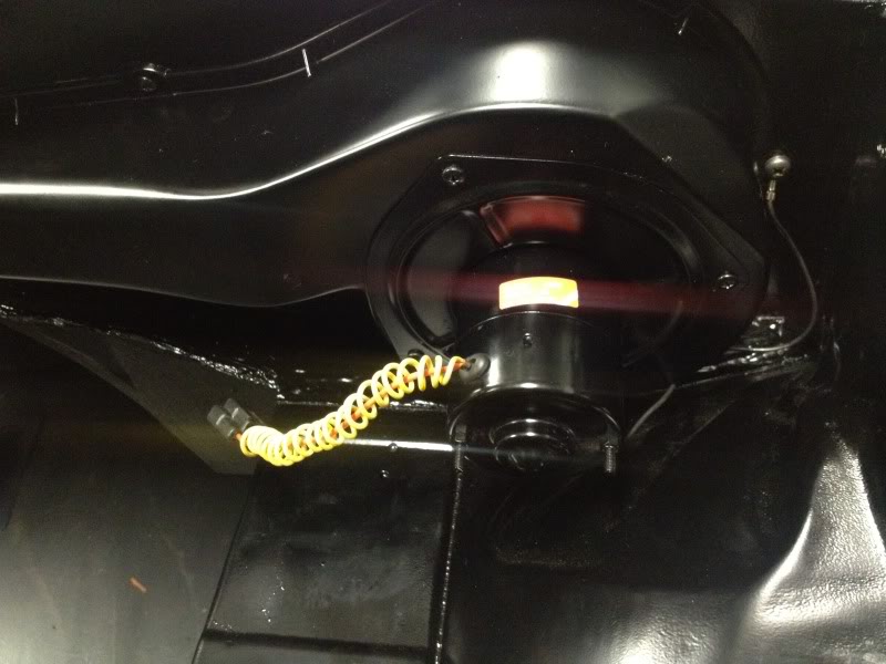

#488 hanra
Posted 10 May 2012 - 09:33 PM

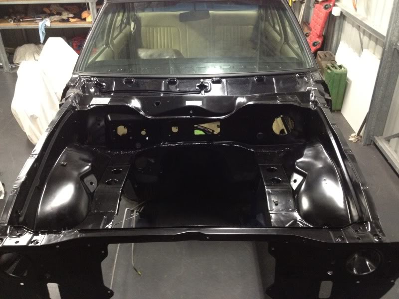

#489 _Bomber Watson_
Posted 10 May 2012 - 09:42 PM
GMH Satin black would be a satin black i assume mate....I only mentioned Matts because you were bitching it wasnt dull enough :P
From what i have gathered GMH black varied a lot, they used to tip the left over color from the bodies at the end of the day in the big vat of black........
#490 _mick74lh_
Posted 10 May 2012 - 10:20 PM

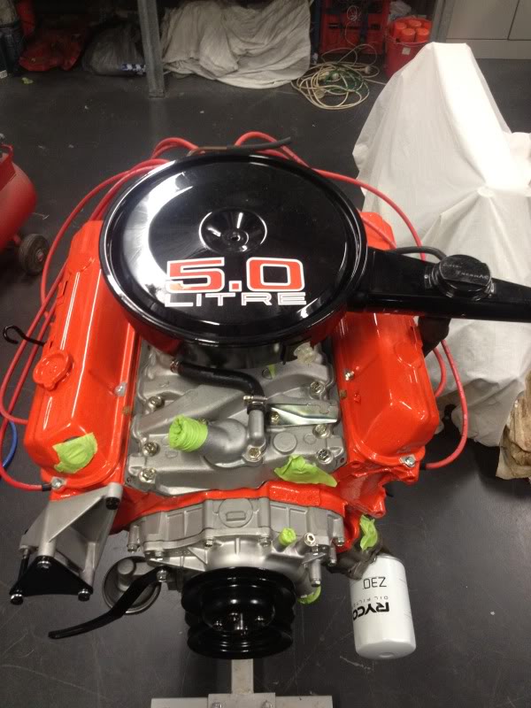

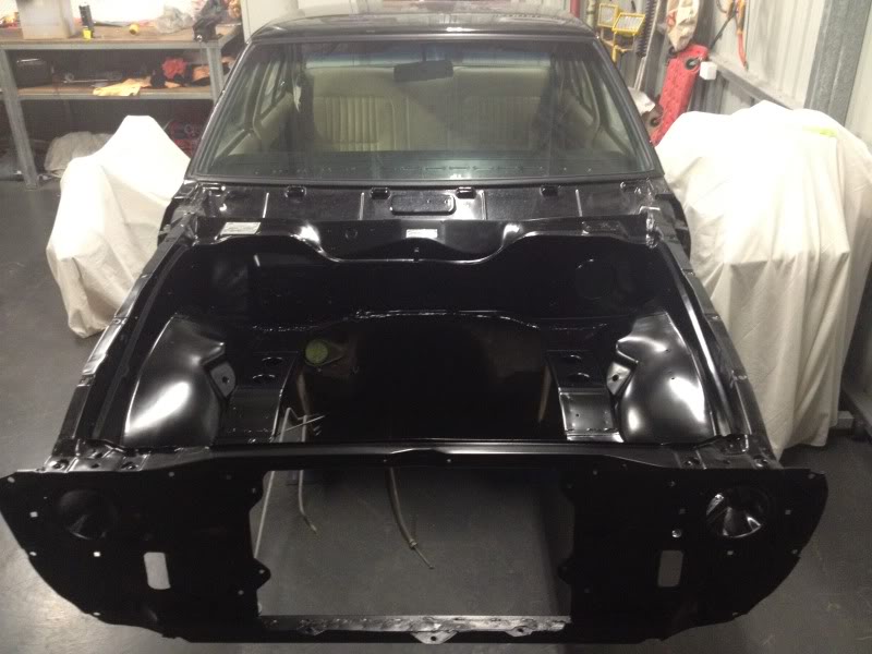

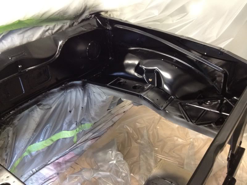

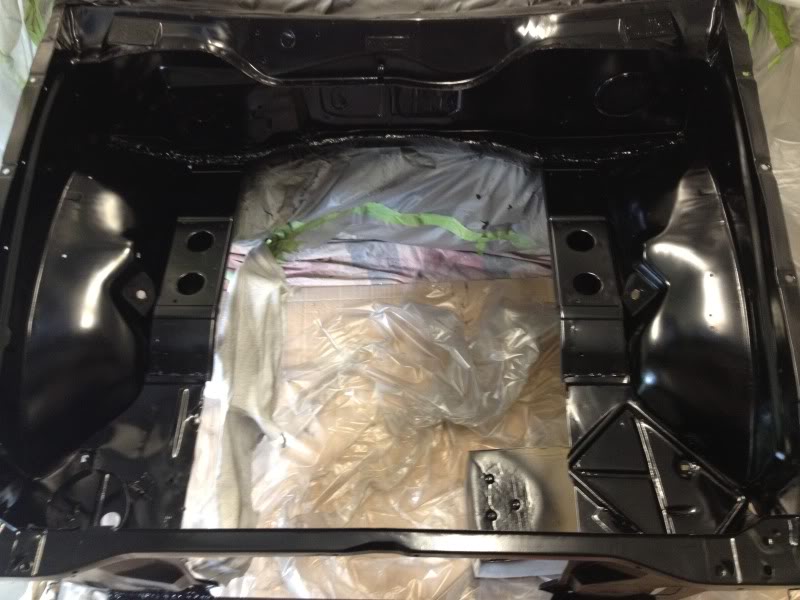

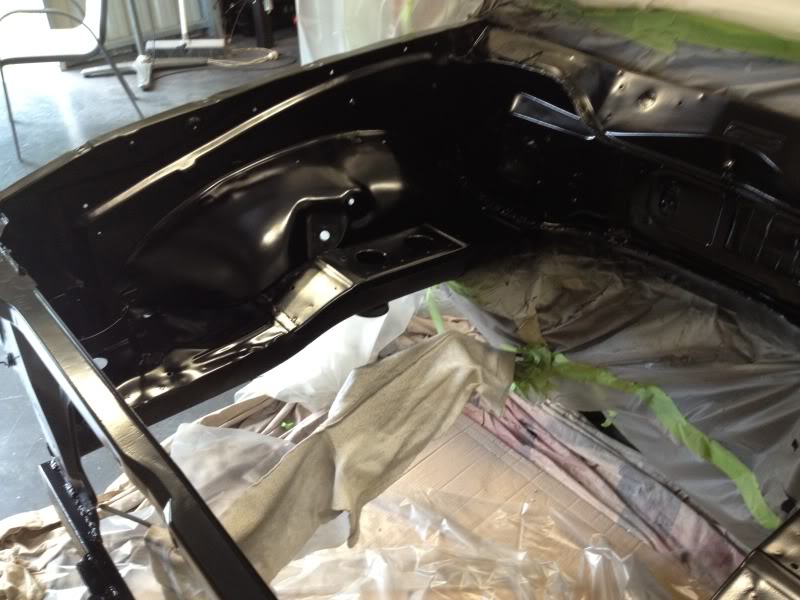

Engine bay and engine look spot on! I love the paint finish. It shouldn't be too hard to keep looking clean.
#491 _AD_75_
_AD_75_
Posted 10 May 2012 - 10:30 PM
Nice work brad, might appear a little more glossy due to the 2pac finish but still a good result.
#492 hanra
Posted 10 May 2012 - 11:03 PM
Cheers guys. Yeah the fact its sitting directly under twin fluros probably dosnt help... Ohhhhh now the mammoth task of putting everything back together...

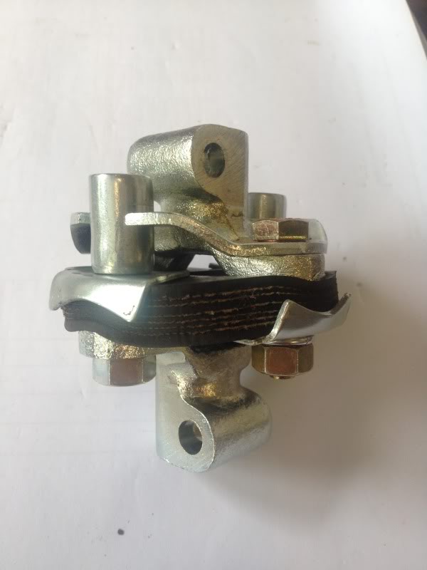

Got my steering coupling back together with a dattoman supplied rubber section. Not sure if ive over tightened things though? I've loctited all the nuts on.

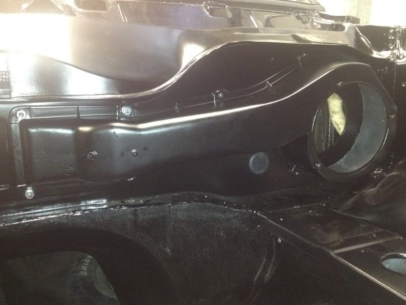

Nothing really major to show at this point... been doing stuff, but its just dumb small stuff like fitting all the pedals, fitted the heater box assy and blower motor. Might look at fitting the wiring loom back in soon, once thats in, I can pretty much put the dash back together.

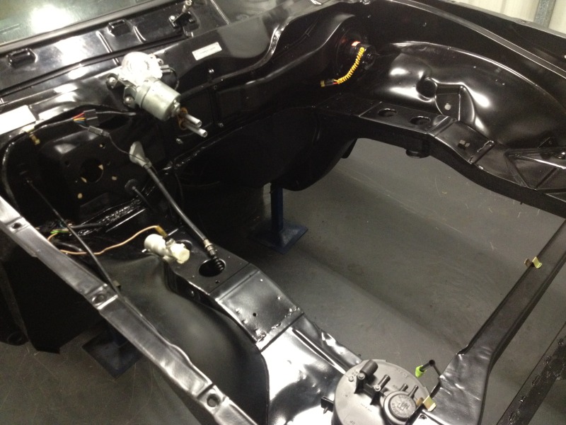

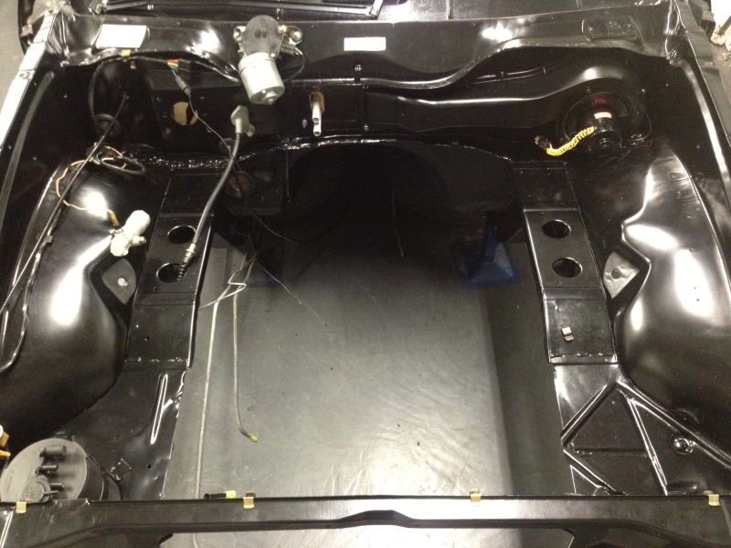

#500 hanra
Posted 01 June 2012 - 12:44 PM
Slowly slowly putting bits back in the bay. Wiring harness is all fitted also.
Once I figure out what Im going to do to fix my cut lower dash, then Ill fit this stock radio back in.
