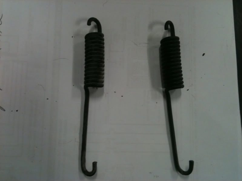

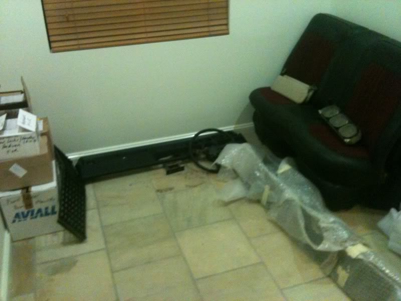

Finally getting all the pieces bagged, labeled and organized. Slowly Slowly figuring out what is what....
Except these springs???? What are these for??? I thought maybe front door hinge springs, as they are missing?

look like brake drum springs, hard to tell depending on size

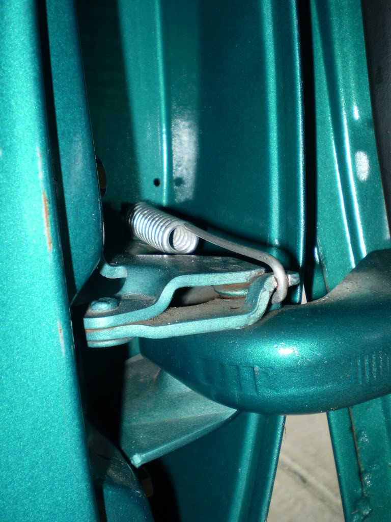

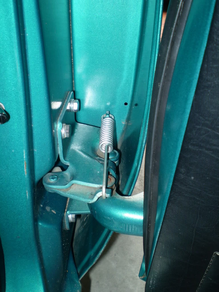

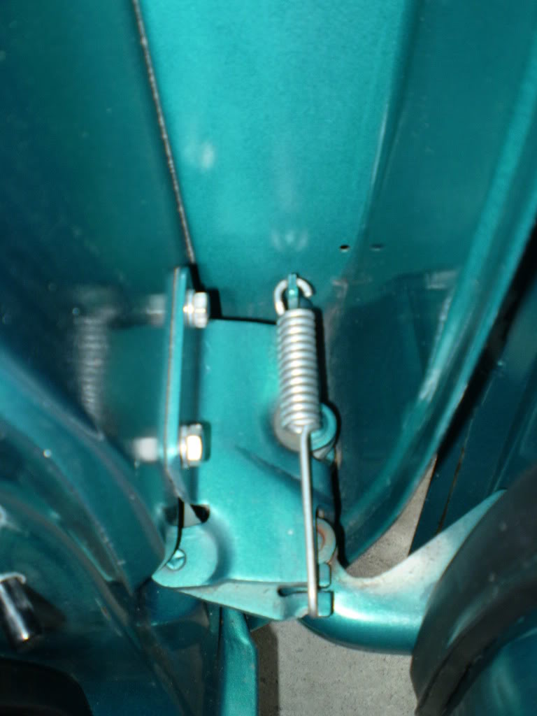

I think you'd be right in that they're for the front door hinges. Here's a blurry pic of them installed.

I just fitted all new drum brake parts to my mates HZ tonight and they look like the springs at the very bottom... But like Black LH said, depends on size... if there bigger then yea door hinge

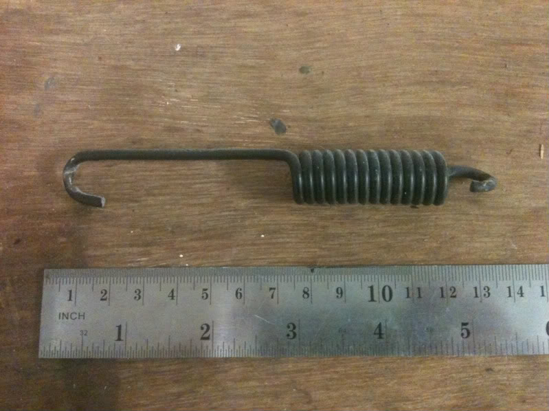

Ill get another picture with a ruler in the shot for a better scale pic. There are no springs on the front door hinges currently, so thats what made me think it could be them. Certainly looks like the above picture.
If it is the spring for the hinge... how the bloody hell do you get this on with the door in place??? Or should they have been fitted prior to hanging the door??
Thanks for the comments guys.

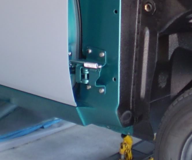

These are some pics of the hinge, viewed with the door open from behind and above. If those springs are for the hinges then this is how they'll fit. The length of the spring at rest is about 137mm end to end. I think you can fit them with the door fitted to the car but not sure as the last time I did them was on Brad79UC's when I was re-bushing the hinges and had them off the car.
With the door held fully open you should be able to sit the front part of the spring over the notch in the front edge of the hinge assembly and pull the other end back hard with some multigrips or strong pliers or vice grips or something and slot that end onto the corresponding notch. Good luck. Don't f#%k the paint. Then again they might be for the brake drum.

Brilliant work mate. Thats an awesome help!!!! Thank you very much. Here is another pic of the spring.

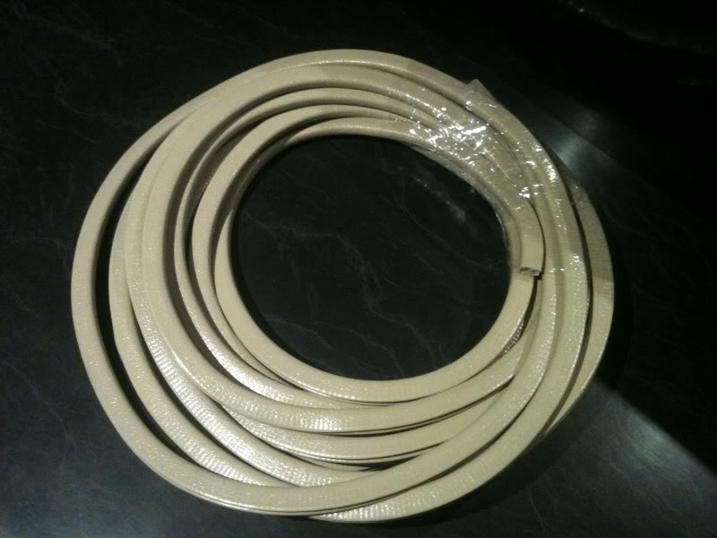

Got some Chamois Pinch weld.

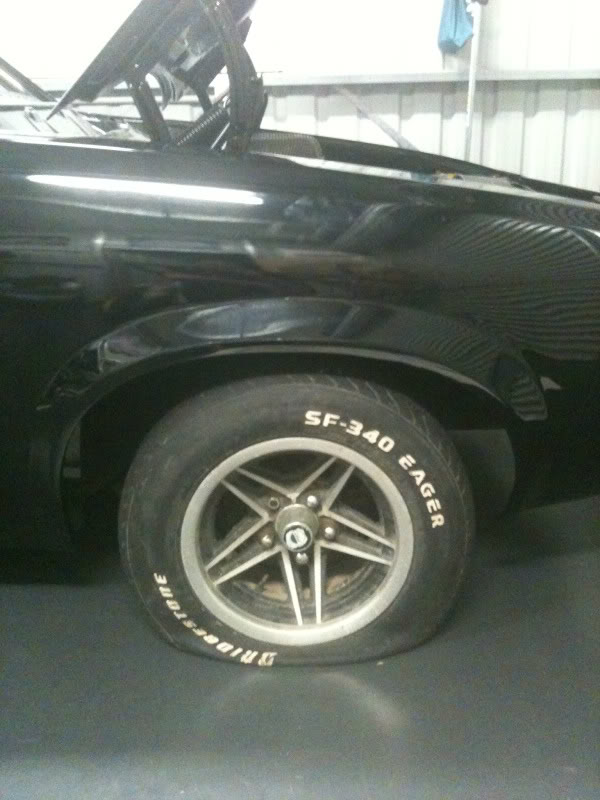

What are the name of these rims? There only baby 13's....
#37 rodomo
Posted 27 May 2011 - 10:49 PM
Challengers.............second best wheel on the planet...........

#38 _blownlcgtr_
_blownlcgtr_
Posted 27 May 2011 - 11:06 PM
rebel wheels?

Yeah I don't reckon they look exactly like challengers hey.
#40 hanra
Posted 28 May 2011 - 08:00 AM
Rebels or a Cheviot copy of the Rebel me thinks.

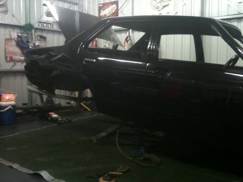

Some stuff so far:

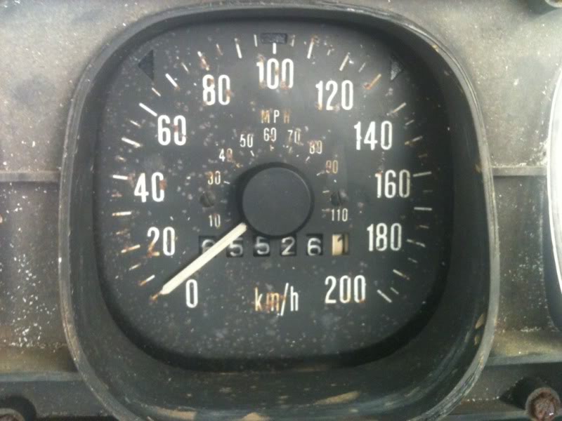

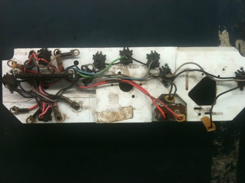

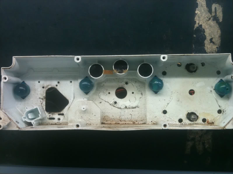

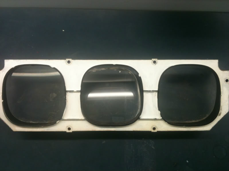

Refurbin the SL/R instrument housing/dials, awaiting on new instrument panel decals.
I know.... Illegal... Blah...
Awaiting on new lens's.

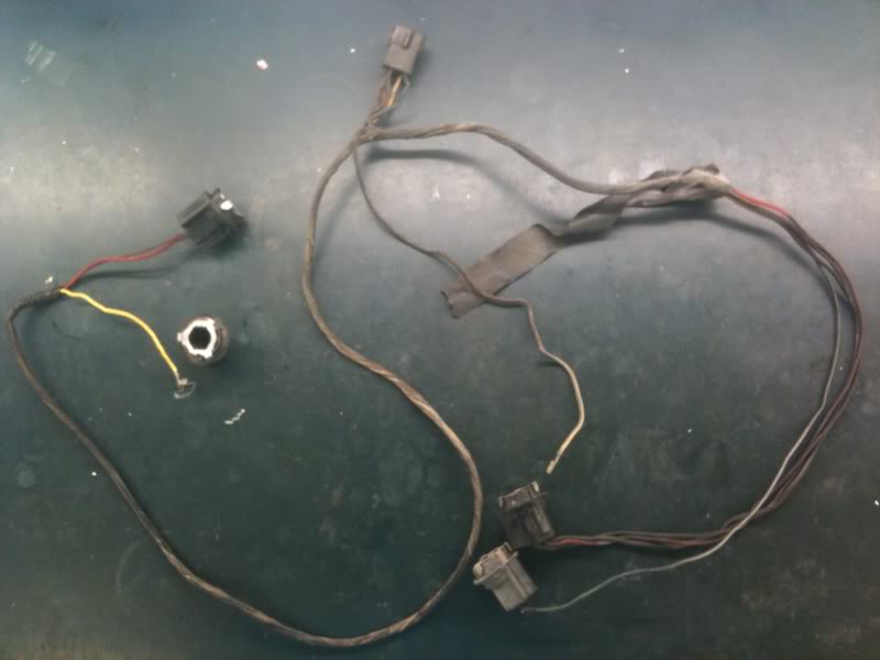

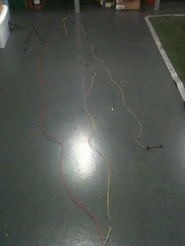

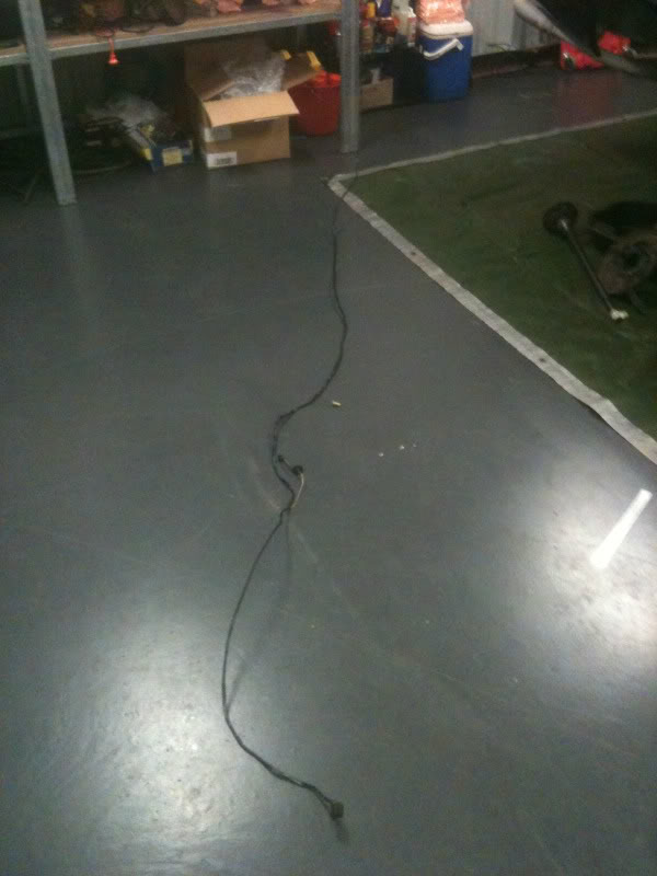

Ive since stripped all this down, removed all the wiring sockets from the plastic connectors and give them a thorough clean down and covered with anti-corrosive spray ACF-50.
Boot harness also got pulled apart, same deal all connectors cleaned up and re-wrapped the loom.
This is the rear harness stripped, connectors cleaned up and then re-wrapped.

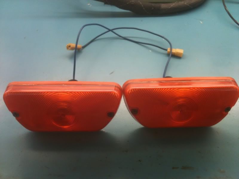

Indicators cleaned up, connectors/terminals cleaned up also

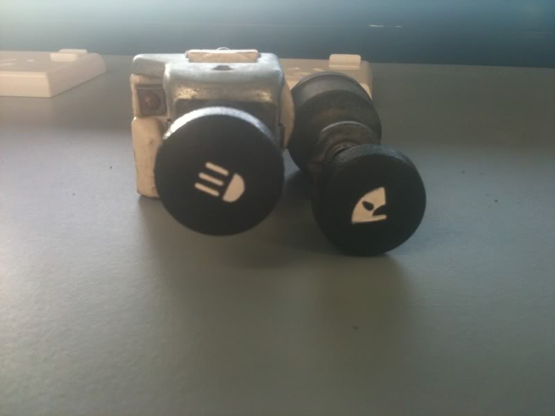

Light switch/wiper switch overhauled

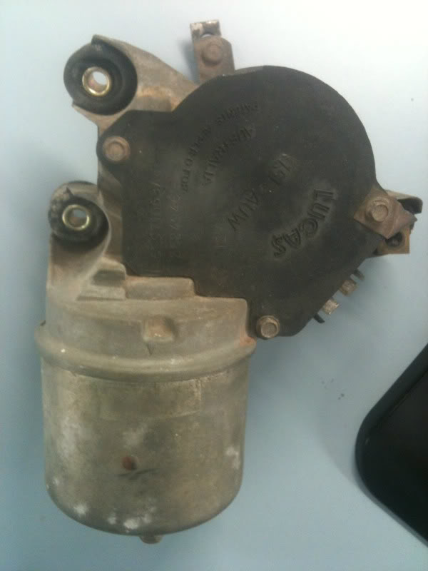

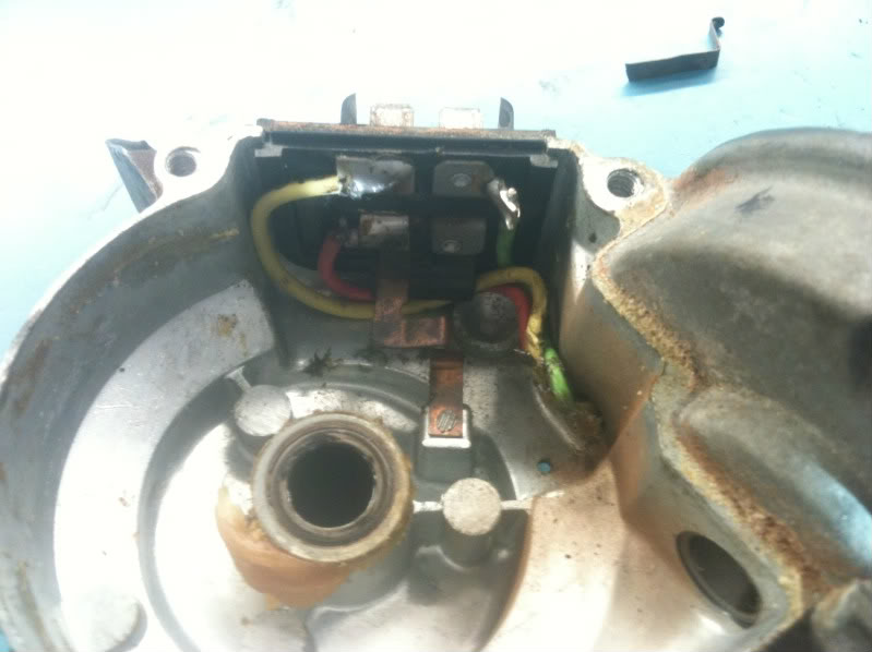

Lucas wiper motor getting overhauled
Found the park contact broken
Ill get that fixed up tomorrow, save buying another crappy 2nd hand motor.

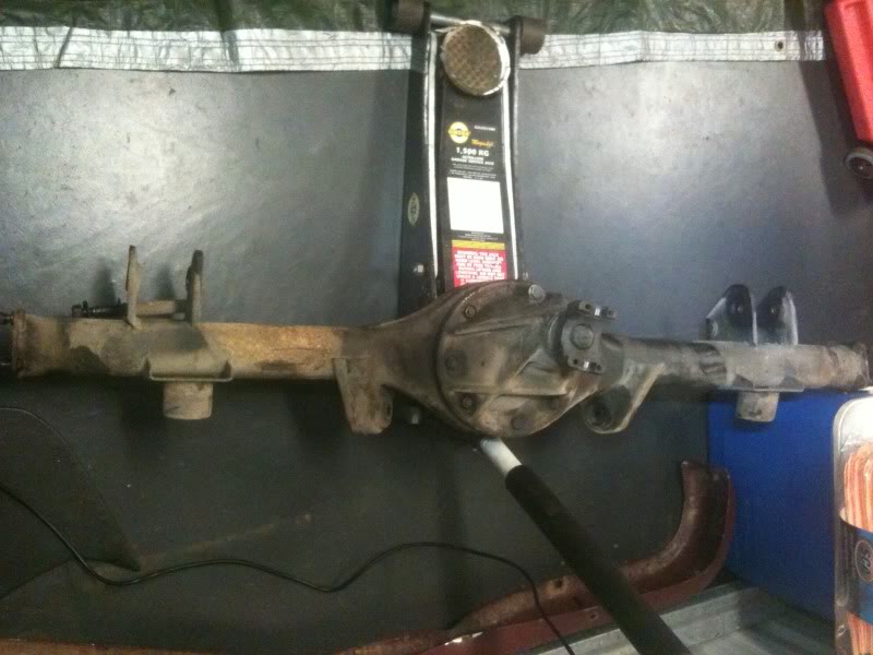

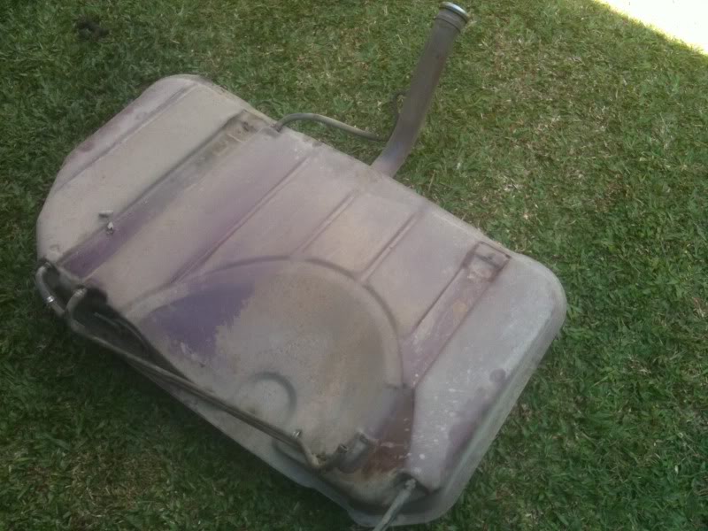

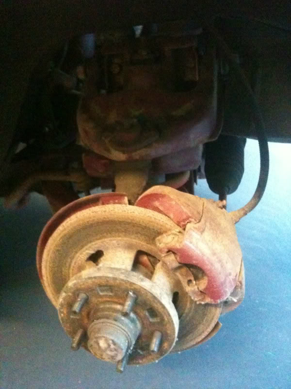

Tank out, notice its powder coated....

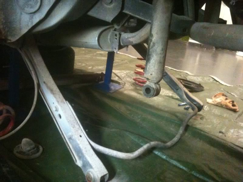

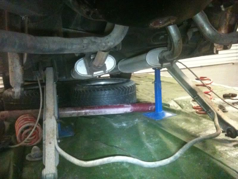

Rear end out
Note powder coated tail shaft...
Has 3.55 stamped on the snout of the diff near the yoke
Coarse spline
Front ends been powder coated also....
As it sits now..
