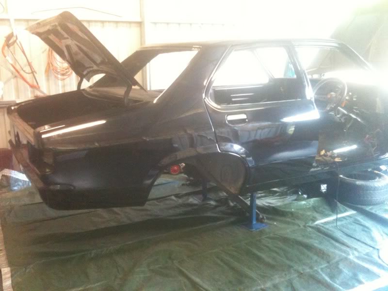

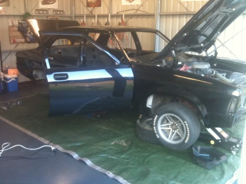

From the info Ive gathered, the guy I bought the car off owned it for 4yrs and had it re-painted approx 2 years ago, he purchased it off a guy that owned it for 22 years and apparently the car was "as is" when he purchased it. So thats 26 years out of 36 accounted for..... So at some stage between being brand spanking and 10 year old, this car was stripped and re-built into some sort of 80's show car...?
I purchased the car as a rolling painted shell. Ive now gotta do the mechanicals, interior and everything else and get it back together....!

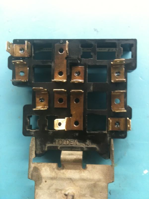

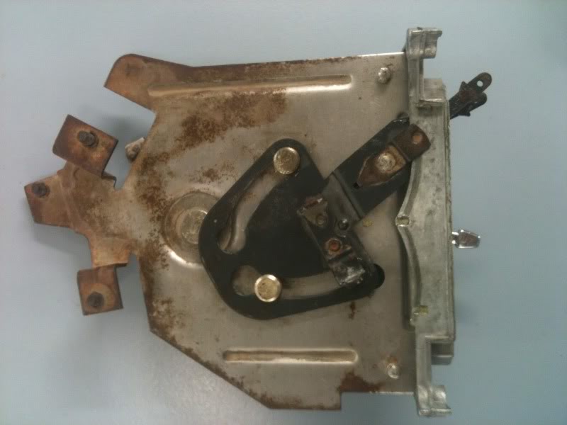

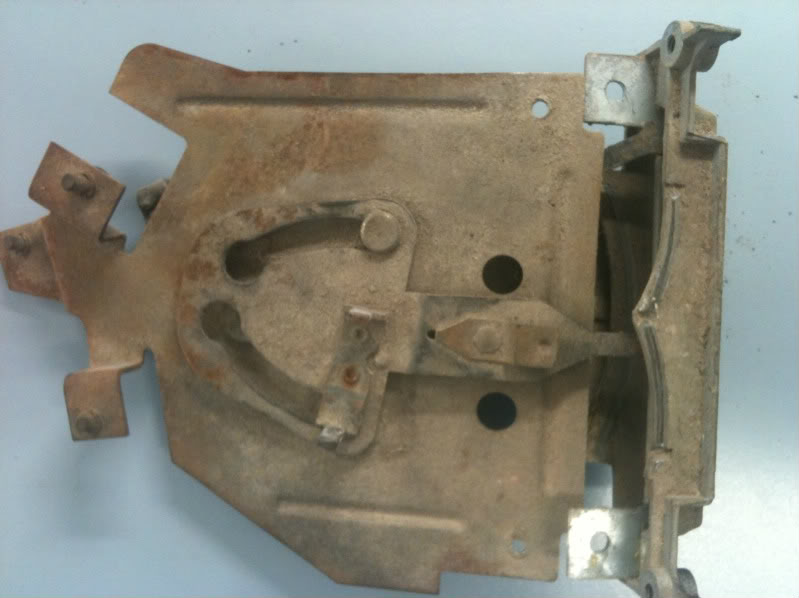

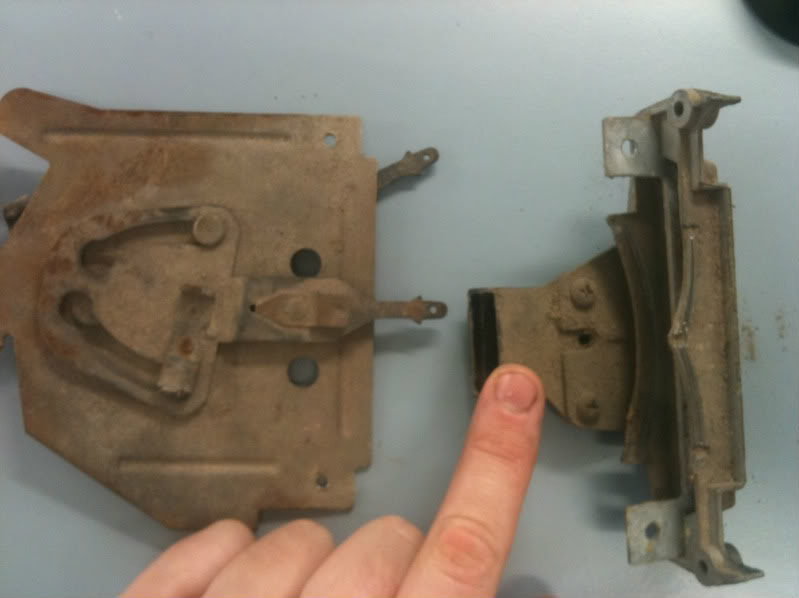

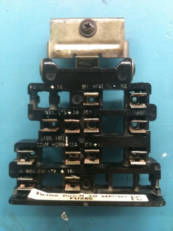

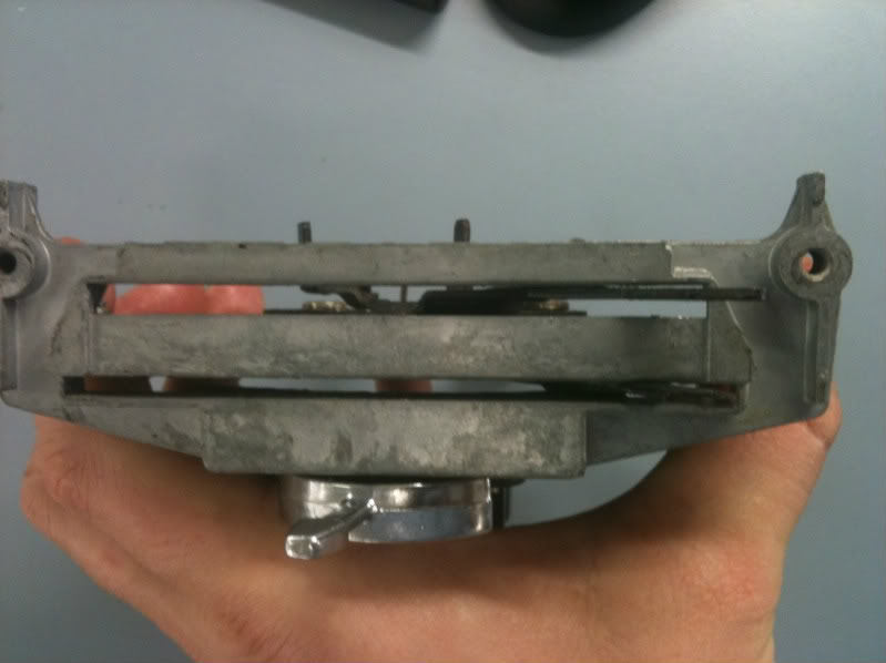

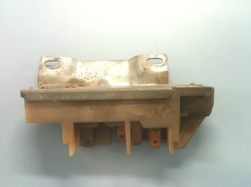

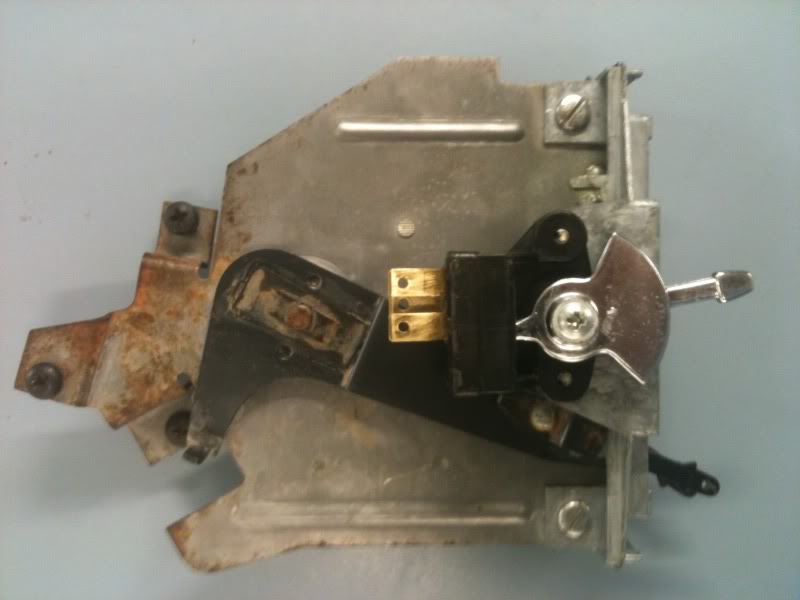

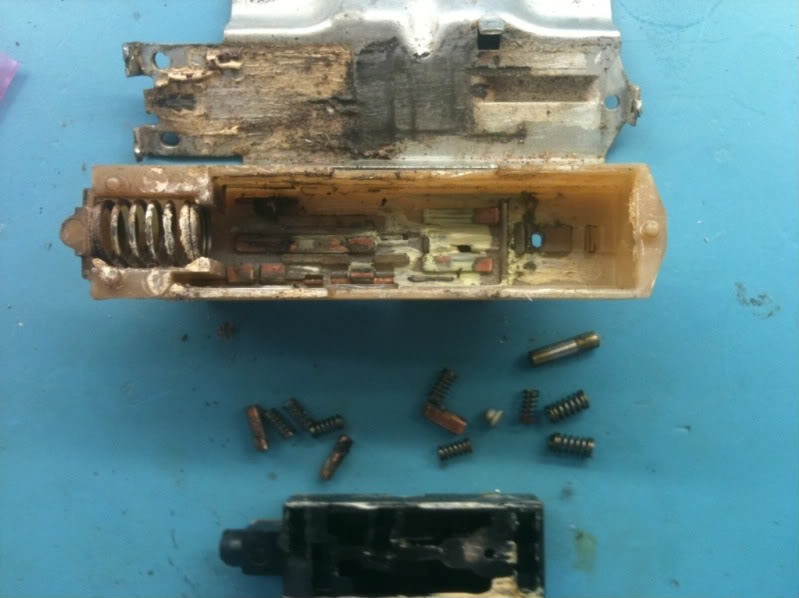

Nothing major to update, just stripped my heater lever assy, all the grease had gone hard, so cleaned it all up and re-lubed, also fan switch came apart when I unplugged it so was a good chance to clean it out and clean up contacts. I also removed all the contacts from the fuse panel and cleaned them all up. The one thing I hate is electrics not working on old cars. Everything is going to work sweet on this thing.

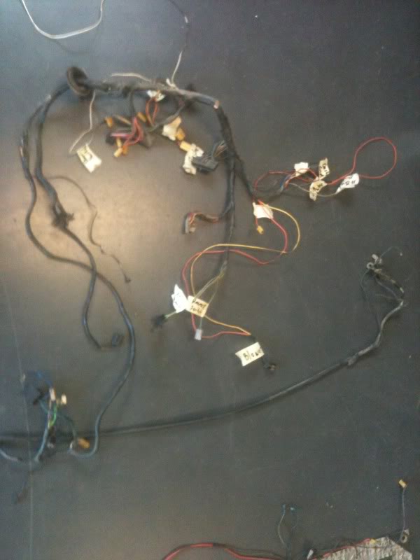

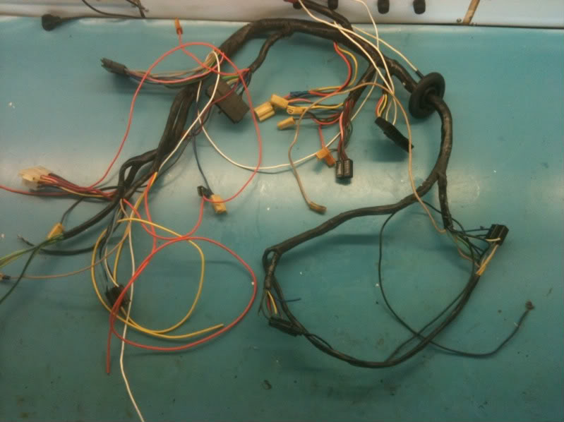

Got the rest of the harness out, will unwrap it, clean it up, remove all the connectors from the plugs and remove any signs of corrosion and clean them up also.

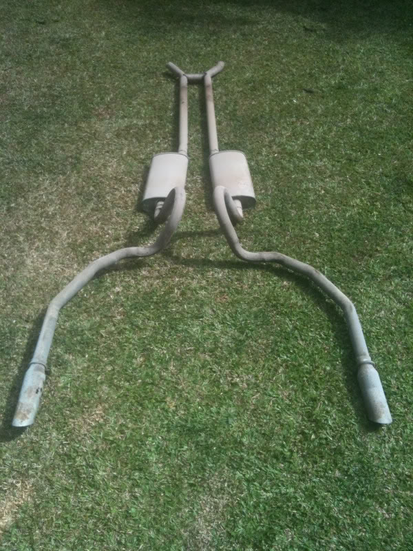

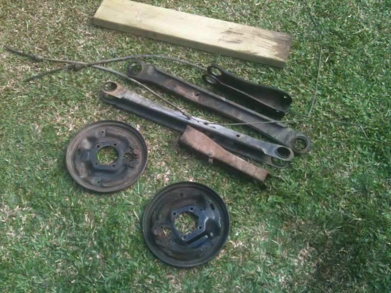

Had to chop the exhaust out as it was all welded in. Perry Mufflers, do they still exist?
Ill sandblast the suspension and 2 pac it all black.

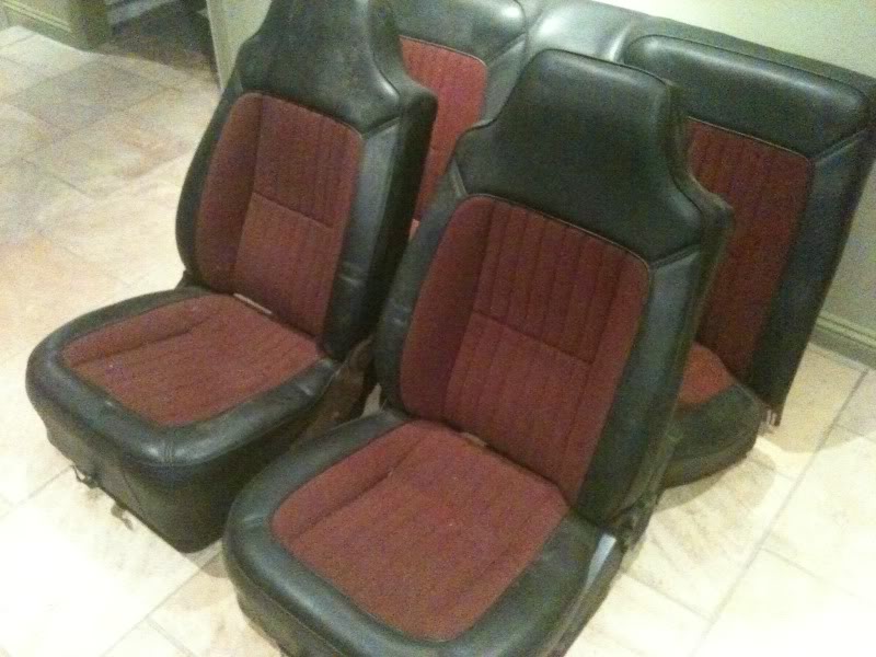

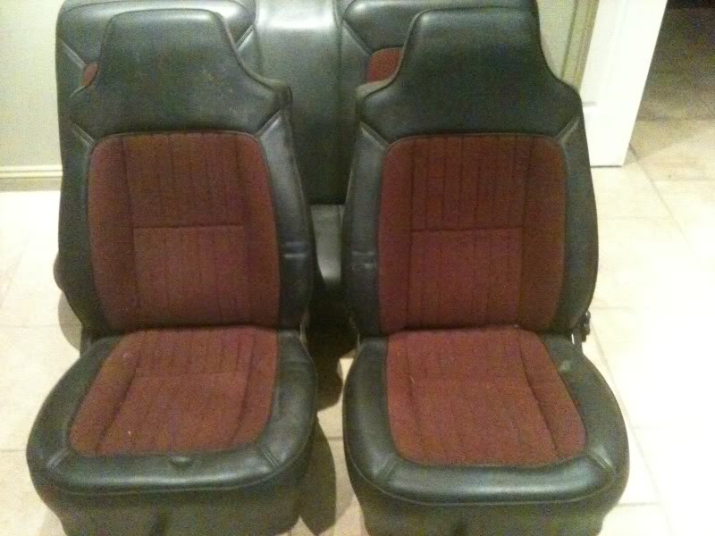

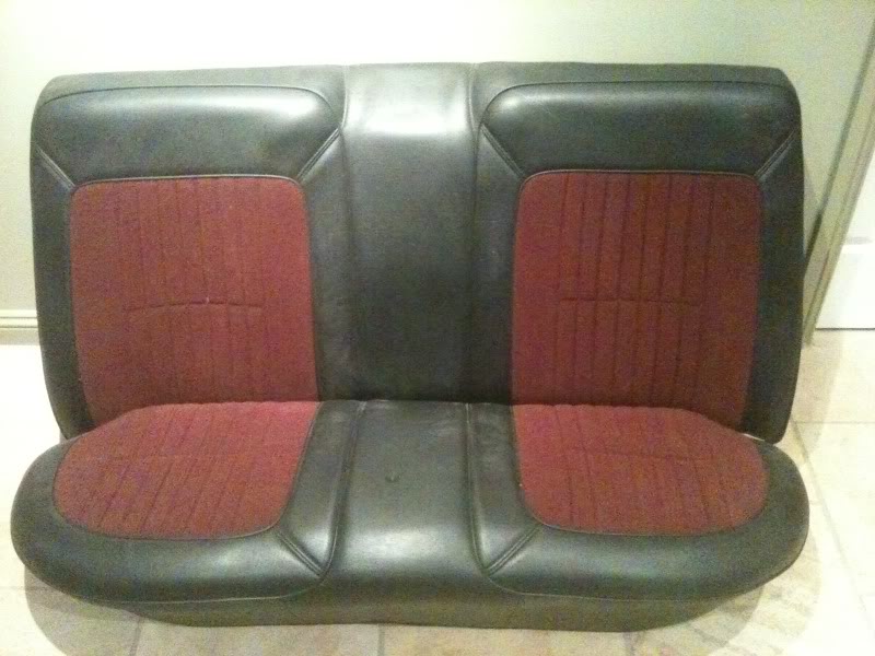

Ive just dropped my seats off at the upholsterers up here. Turns out he is an uncle of a good mate of mine. So fingers crossed all turns out well. He is an old bloke and been in the game a long time.
Next time I see them they wont look like this.....

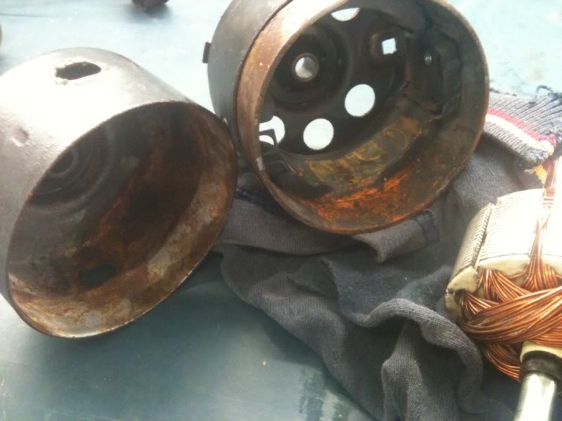

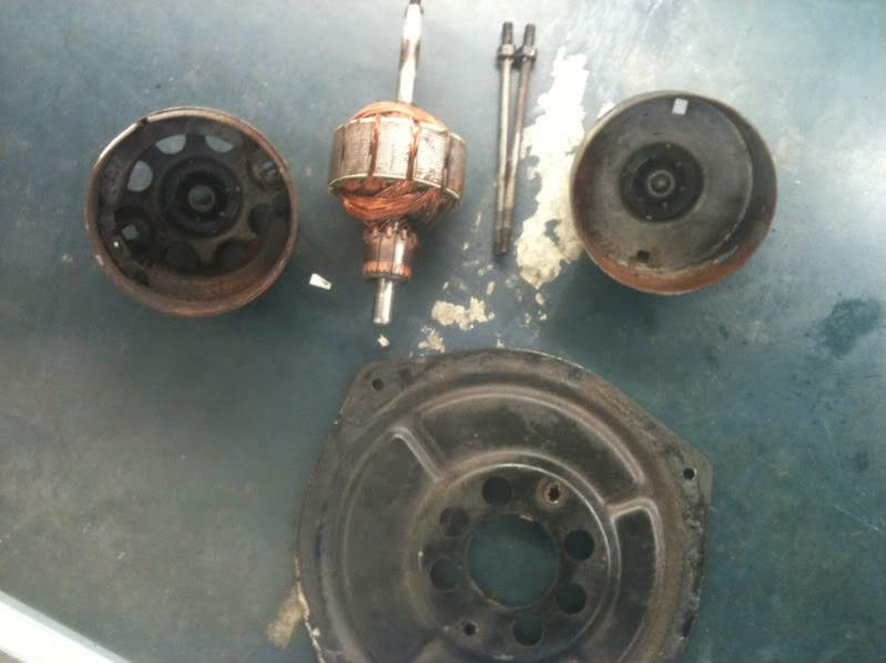

Got the blower motor cracked open. Cleaned up the comm and brushes. Will blast it and give it a coat of jam.

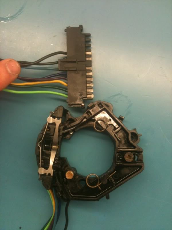

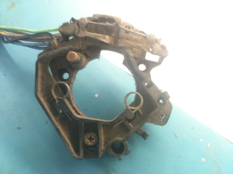

Also dismantled the indactor switch assy and cleaned up all the contacts and plasctics.
The wiring harness is coming along, getting all the black over spray off all the wires and removing and cleaning all the connectors from the plugs.

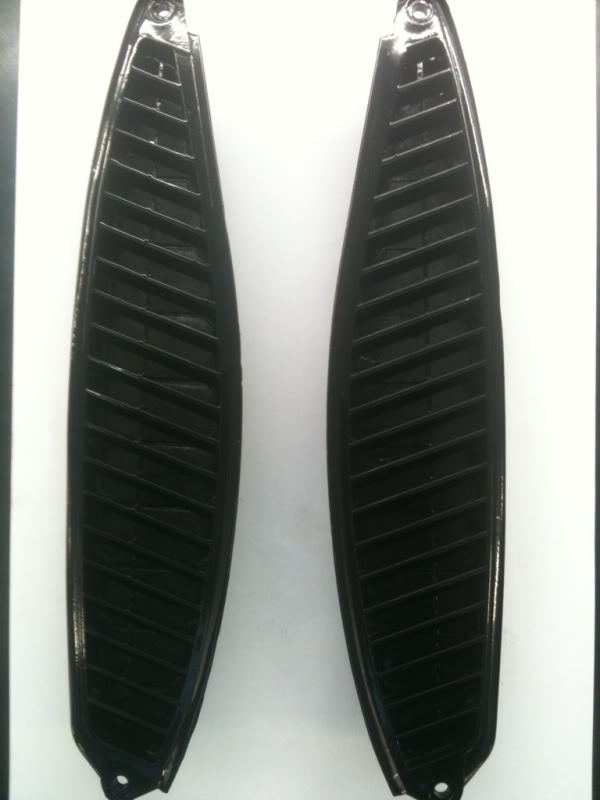

Also got some good body vent valves. Gave them a coat of jam also!!

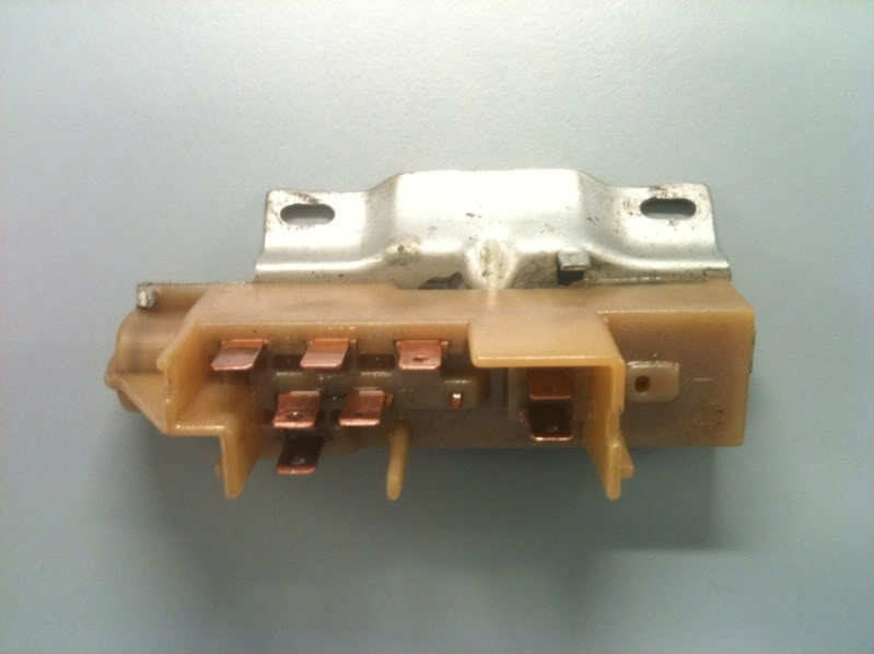

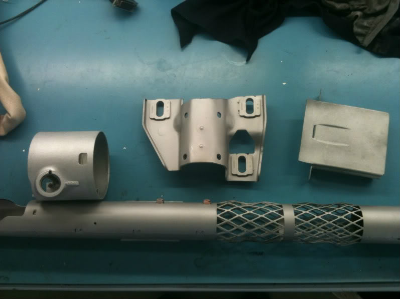

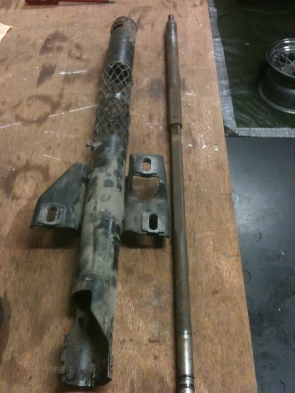

Got the Ignition switch apart and gave it a well deserved clean up inside and out.
And got the steering colum out also, will give this all a blast and a cost of jam.
