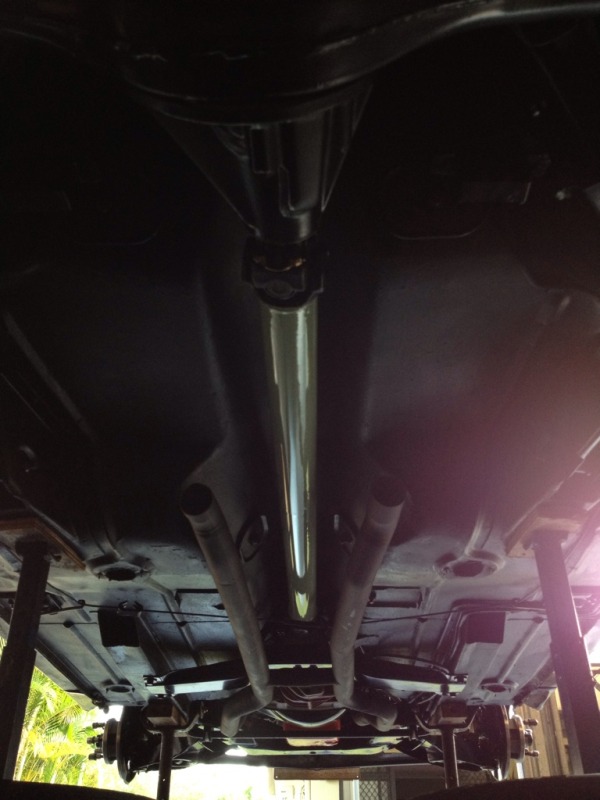

Posted 14 October 2012 - 11:18 AM

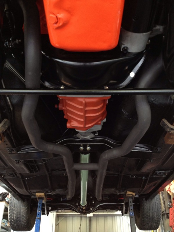

Got the stock engine pipes fitted and added the balance pipe in. Need to get the inlet/outlets of the mufflers flared open just slightly so I can fit them onto the pipes.

#807 hanra
Posted 14 October 2012 - 04:25 PM
Well the RHS pipe was a NOS Berklee brand, so it fitted up fine. The LHS pipe was from Autoline on WA. I had to weld in the balance pipe however. But that was no big deal.
But yeah nah, dropped the sway bar out of the way and the engine pipes just fitted in perfectly. I was pretty happy with the fitment otherwise!!!
Hopefully the mufflers and tailpipes fit up ok.....
I'm heading to Brisbane on Thurs till Sun to get bliiiiind so probably won't get much work done. But once the mufflers are on I think it's ready to fire up and go for a drive.

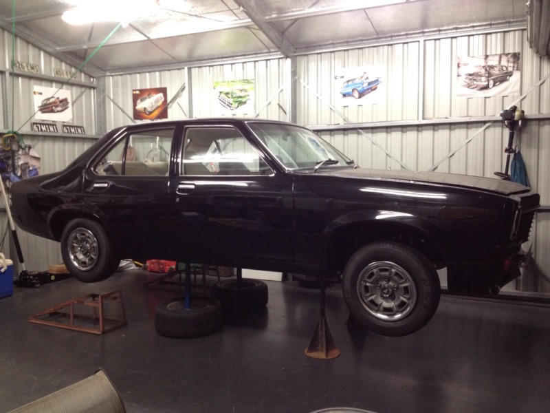

#808 hanra
Posted 14 October 2012 - 05:40 PM
I might have to drop the diff out to get the tailpipes on... Not sure if I've got enough height. The next shed is getting a bloody hoist!!!!!!!!!
Still awaiting on my wheel nuts from Year One in the USA, been 3 weeks now.... Once I have them I can put my stock wheels on.

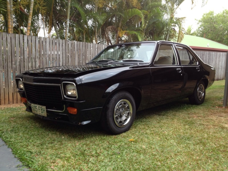

Wheel nuts fit on perfectly.
6in wide rims would have been nice.

Looks nice mate but I like the Rebels more. I reckon it'd be worth keeping the Rebels so you can alternate every now and then. But nice work its so close now.
I was going to go hotwires but thought it best to go stock. I'll end up selling the rebels. Not sure what they are worth these days? 13 by 6 or 7 not sure what they are!!!!

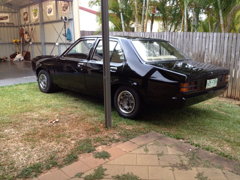

#820 hanra
Posted 27 October 2012 - 08:35 PM

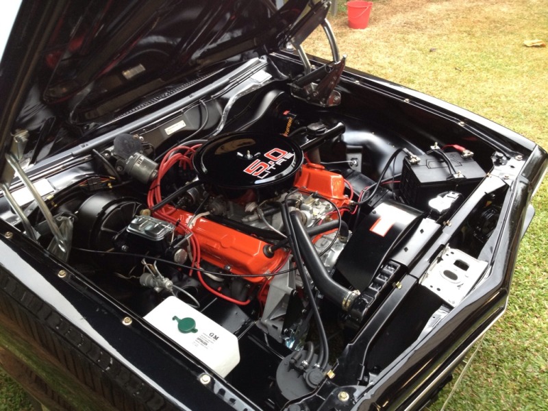

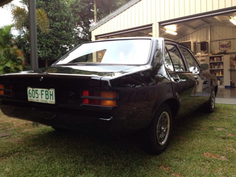

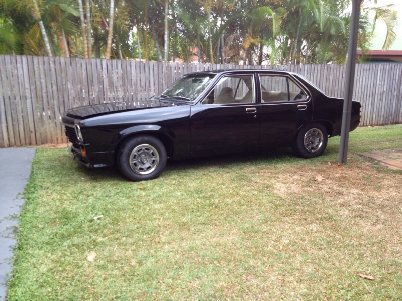

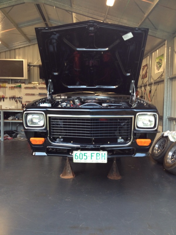

OK... so the day finally came to hit the key. I primed all the fuel lines, fuel pump and float bowl with fuel. Wound over a couple of times and then it sprang into life!!!
Got the cooling system bled ok, confirmed no oil/water leaks. I had originally statically set the timing with points fitted in the dizzy and used my DMM to set it up. Then I fitted the Pertronix. The timing is set at 6 deg BTDC with the vac advance line disconnected off the dizzy. Could it or should it be more? Idles about 750rpm.
Had to fit little dump pipes off the mufflers as there is no way the tailpipes will fit, they are bent incorrectly so it will need to go to an exhaust shop to get that corrected. Once again.... pay money to a company and they cant do what has been asked.
I noticed the other day when I gave the car a bit of a push up and down on the rear, that there is a decent thumping sound. I kinda need a 2nd person to help identify it, but it dam well sounds like its the shocks making the noise. All the shocks are brand new BOGE brand, AnywaysI pulled both rear shocks out, they have rubbers above and below its upper mount. The lower mount is solid.
It kind of seems to me that the shock internally is at its full extension, and when you push down on the car and it rebounds back upwards, it bottoms out internally on the upward movement???
Could this be possible?

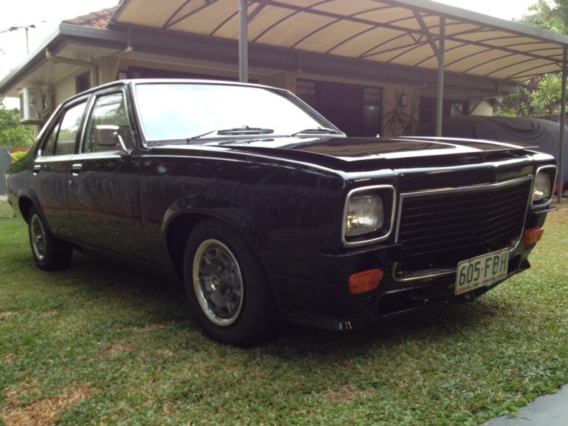

Went for a little blocky up the street and back, and then gave it a much needed bath. Still have to fit the rear spoiler but want to get the entire car professionally polished prior to this and then Ill fit the SL/R 5000 decals and rear spoiler.
Still need to get bumper bars, Id like to try the brand new ones but there are none available.... Also awaiting on my door trims to get made which is in the process. I was also advised by RSP that the new replacement LH bonnet cables are now available!!! Got one getting sent on Monday!!!!
