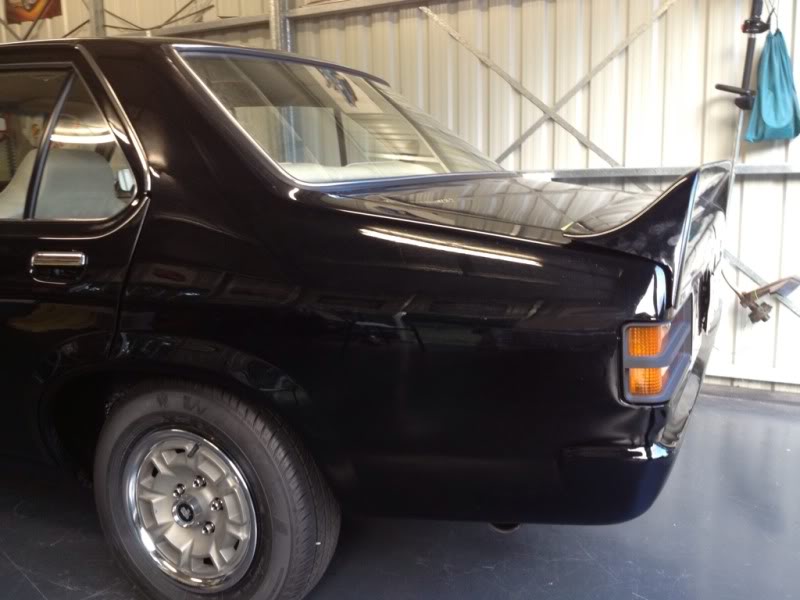

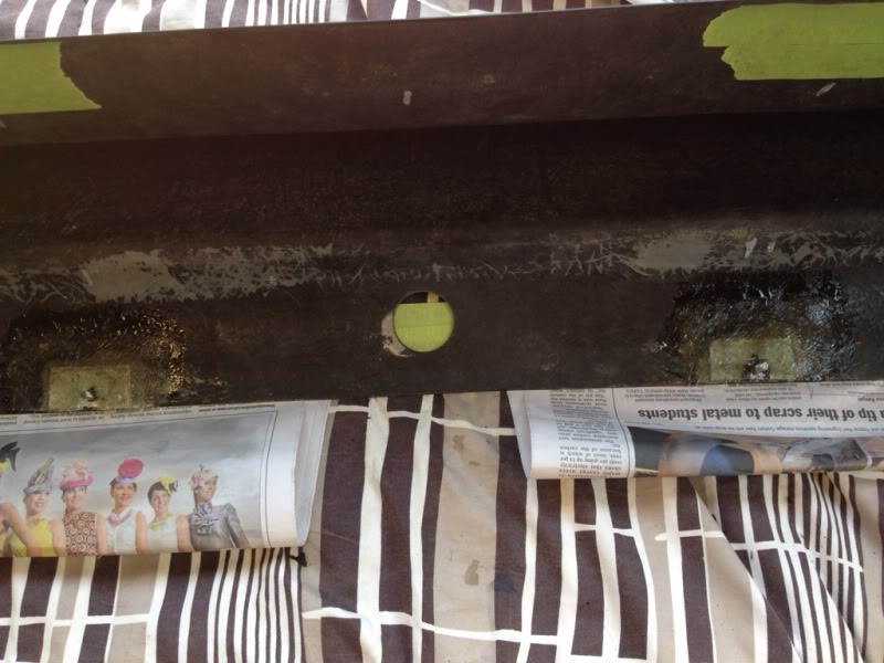

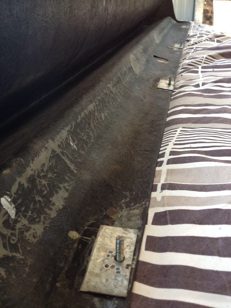

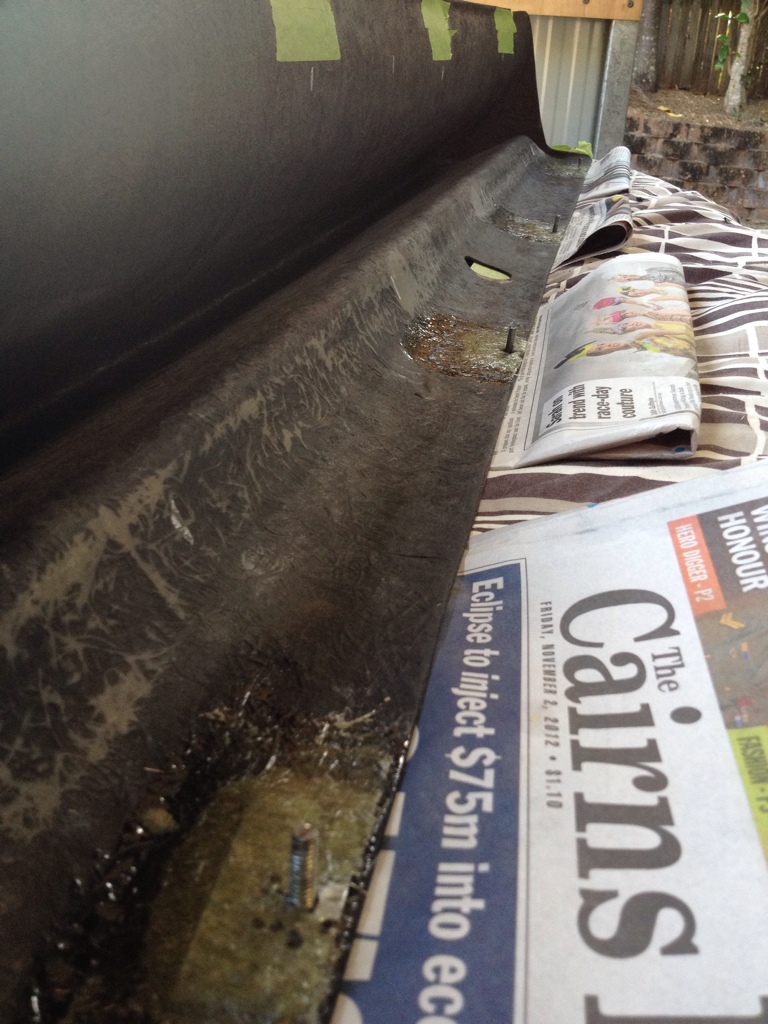

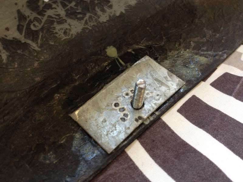

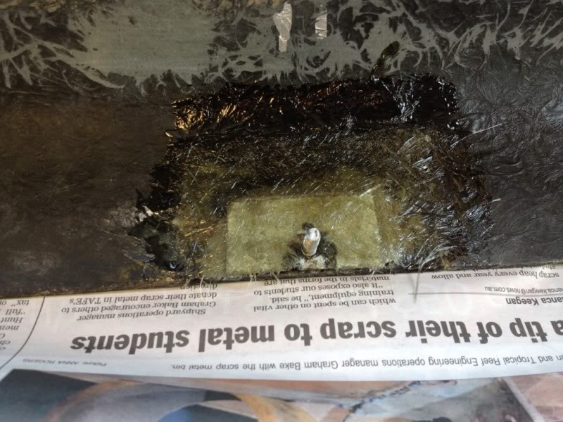

Made a start on fitting the boot spoiler. The boot lid is original and has the 6 original holes still present. However its also had another 8 holes put in at some stage for an aftermarket bobtail.
The spoiler that came with the car is fibreglass and appears to have been gooped on with sikaflex at some stage.... As it has no mounting points...
So anyways, Im trying my best to make do with a bad situation (bootlid full of holes and a bobtail with no mounting points...)
Ive made up some plates, ground down the heads of some bolts and tack welded them on.
Im using the extra 8 holes for mounting as it will mount the bobtail better then just the 6 original ones.
I put contact glue on to the plates and bobtail, fitted it up and got the rear plates stuck on in the right spot.
Then went over them with 3 sheets of fibreglass. So far so good, along the rear section. Ive made a start on the top side and will glass them tomorrow. Followed the same procedure on the top side.
Dummy fit up with only rear mounting points.

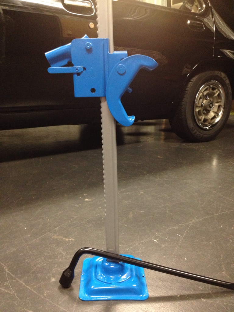

Also got sorted on the jack situation

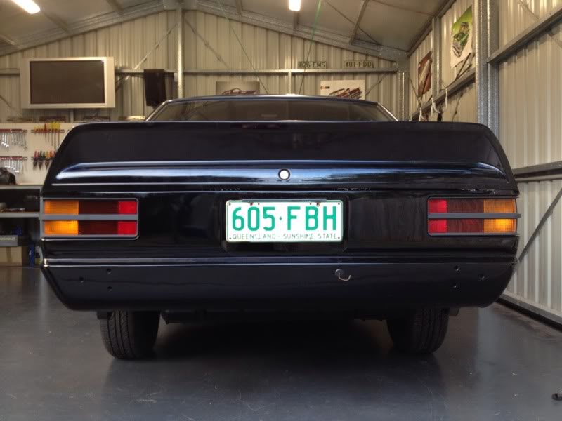

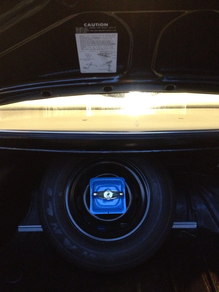

Can now mount my spare tyre correctly. Cool.

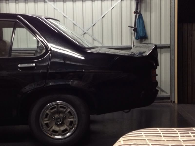

Boot spoiler is getting there. Needs some relieving underneath.
#849 _LH8VD69_
_LH8VD69_
Posted 12 November 2012 - 04:36 AM
It's hard to believe they actually used those jacks ! Lol
Btw loving the car Brad. Damn fine !
#850 hanra
Posted 12 November 2012 - 10:10 AM
Hahahahaha, yeah In know... Bit dodgy... This one works, but I doubt Ill ever use it!
