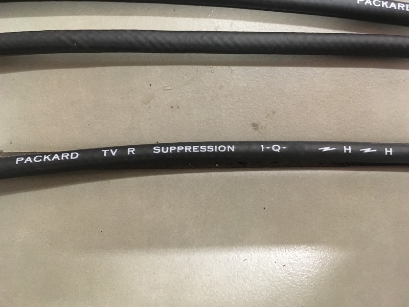

I found date coded GM leads, but I don't think that Holden ones would have Packard written on them (Unless that was the company who manufactured them?).
Attached File  P5190007.JPG   101.51K   9 downloads

#1228 hanra
Posted 20 May 2017 - 01:13 PM
Oh wow! That's awesome!! Will be interesting to see why the difference?
I think these leads are the same same as yours. That was the latest date code they supplied. 1-Q-74. Good for an L34 but mine is 10/75. So I just went for non-date coded.
I honestly thought this would not be printed on the lead??? 1-Q- I thought it would be blank.
Oh well.

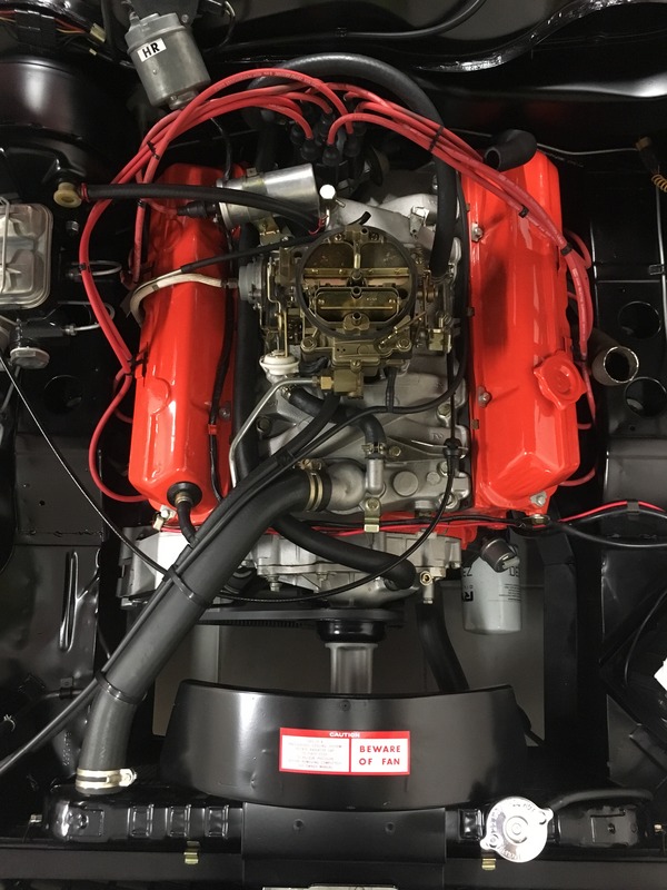

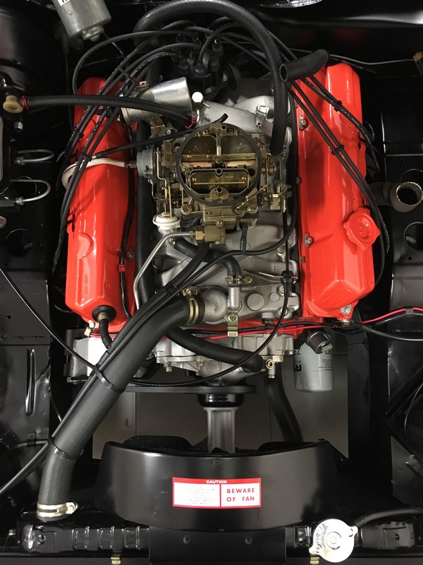

#1230 hanra
Posted 20 May 2017 - 04:43 PM
Leads all fitted up. All fit well, No 2 at the front could have benefited from an extra inch of length.
The diagram they supply shows the firing order rotating anti-clockwise rather than clockwise around the dizzy cap. And as such the dizzy cannot be positioned where they expect it. The vac advance would foul. This could be why No 2 is a fraction short.

Hi Brad, that looks really really good with the black leads now on it. If you have a look at the lead closely after the 1-q- you can actually see it's had the writing removed from the surface. But it still looks great now, a single outlet water pump and you'd be set. I love how original you've tried to get the car. Gary.
