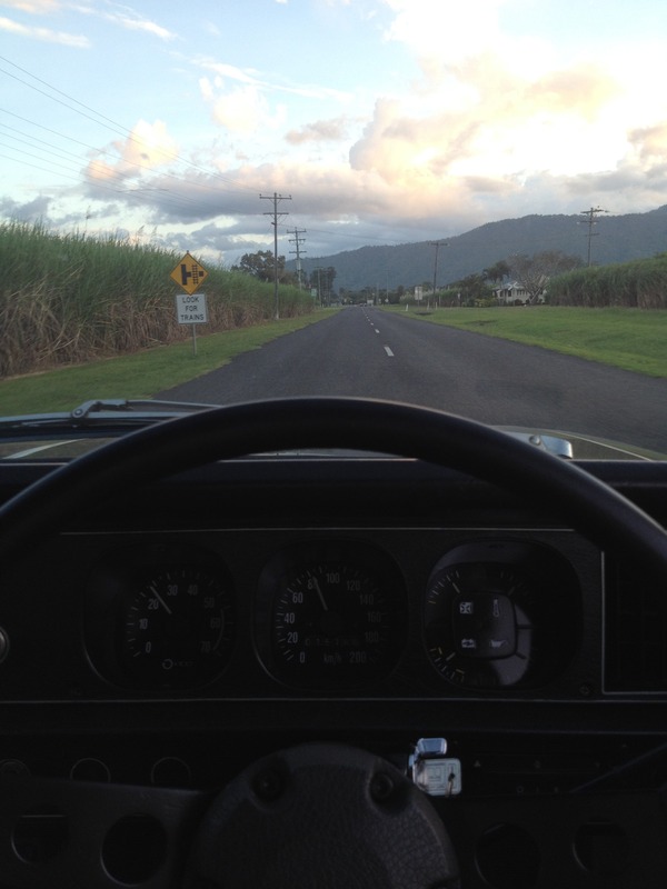

Jesus Brad you need to take it for a run for 20 min at least.
My cars sit in the garage for no longer than a month and I wash them at least monthly too.
Sorry, I lie. 29th May this year I took it down the road to the servo as the fuel had evaporated.
978B6227-243D-480B-A175-D7D2981FCB01_zps

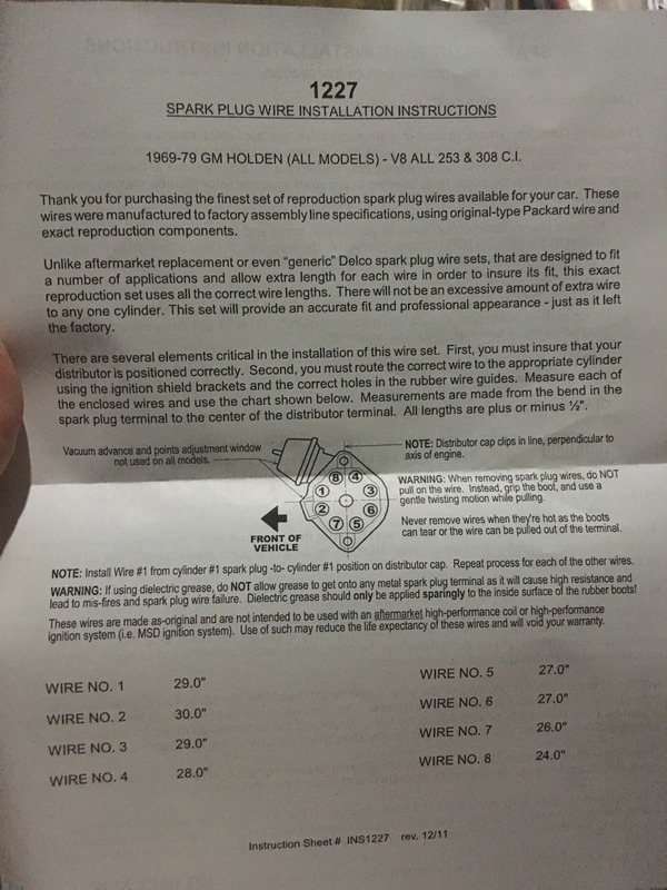

Been feeling guilty about not having the correct ignition leads and plus it's just another item that people pick on it as being incorrect.... So I ordered a set of these from the US. Can't get date coded stuff for anything after the last qtr of 1973 for some reason?
I think it's pretty much just the dual outlet water pump now that incorrect? Can you think of anything else?

Hi Brad, you could strip & Tig a water pump to convert to single outlet. Did the v8 leads have the red ends or the black originally? ? Gary.

and red / pink ends on black leads

Yeah I really should have investigated lopping off that extra outlet on the pump before I fitted it. Bugger.
I know I've seen other pics somewhere from back in the day showing red/pink ends. This is all I could dig up though.
8BB7AF07-7D89-42CC-A578-EB5A04C0F595_zps
You can see a lighter shade here.
8B397BD6-D5D4-4672-A743-488241A5FABD_zps

Yep the ends of the leads seem to be red in them photos, good to know. Gary.

Brad, please post a pic up when you have the spark leads on.
How did you come across Lectric Limited?

Good work Brad they are the same as the set l got from them last year- they are very authentic looking and work well.
I also got some spring ring battery leads at the same time- not made for Holdens with only "spring ring" on them and had
to extend the secondary cables but look better than aftermarket leads in my opinion.
