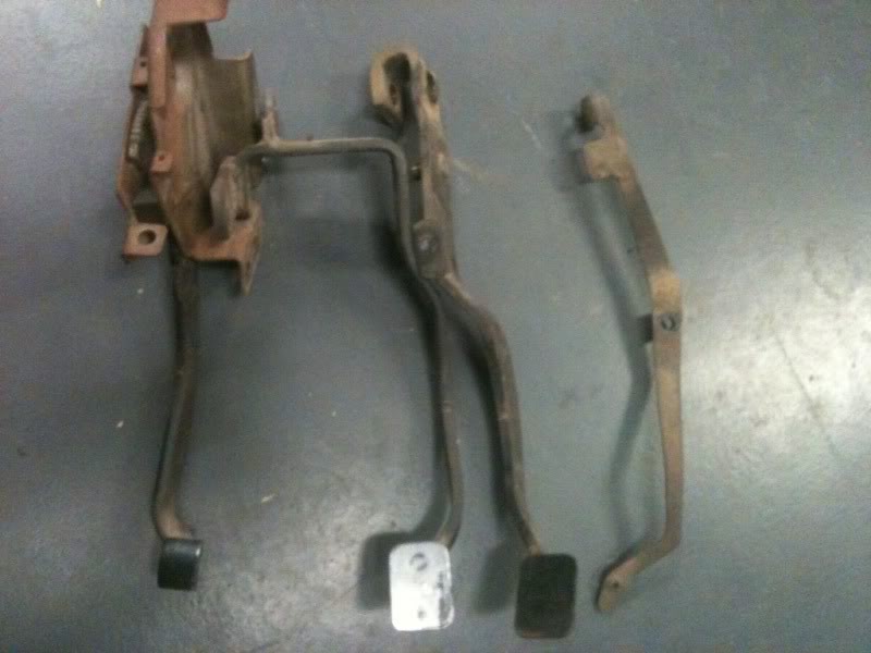

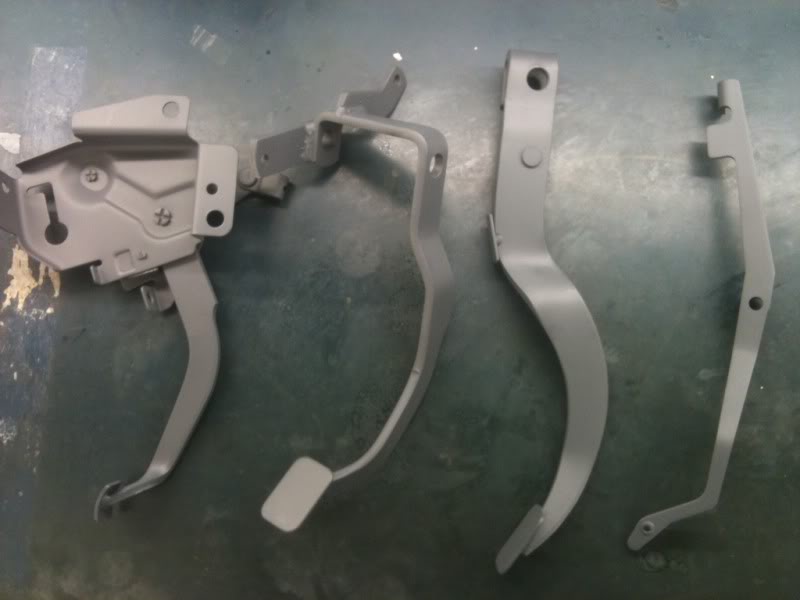

Does anyone know if the people in the design team at GMH responsible for the pedal box design are still alive??? Id like to have a chat with them...

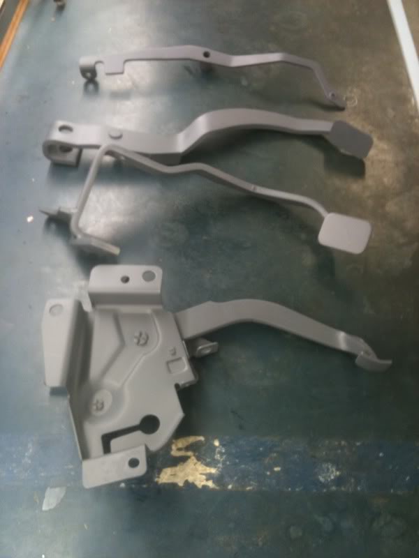

Ill get these cleaned up, blasted n primed tomorrow.

#155 hanra
Posted 23 August 2011 - 10:07 PM
Got all the pedals cleaned up, blasted and primed.

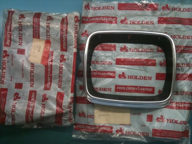

Also got these babys!!! NOS LH Headlight Rims in perrrrrfect condition!!! Saweeeet!!!

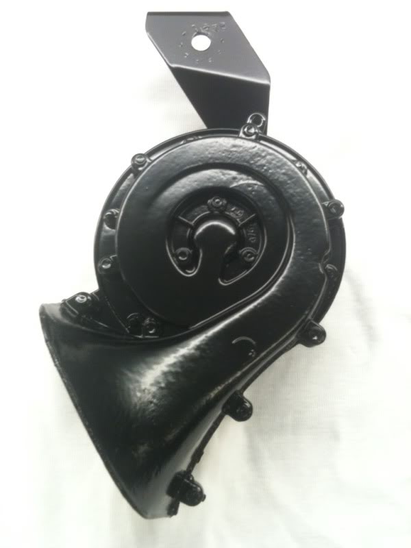

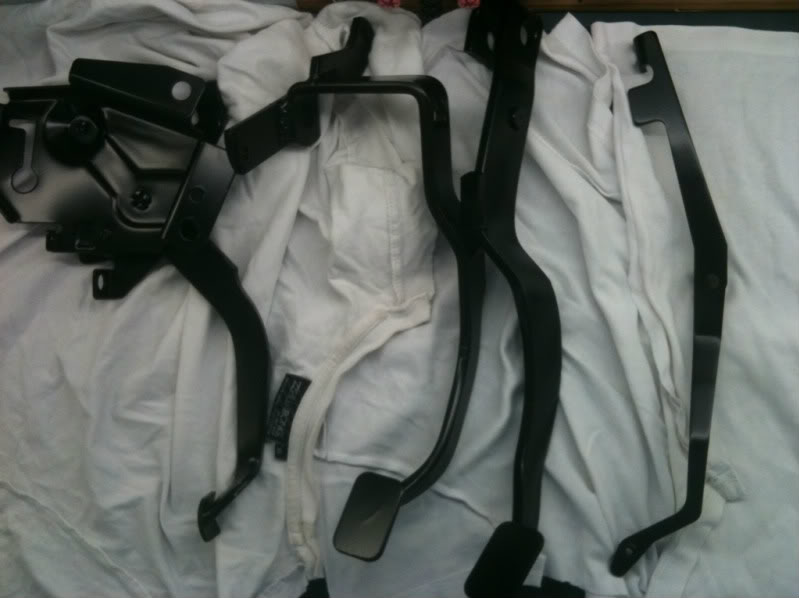

Pedals are now black!
Along with the horn. I think SLR's are meant to have a High note and Low note horn? This has LN inside the bell? Low Note? Anyone got a HN they dont want??

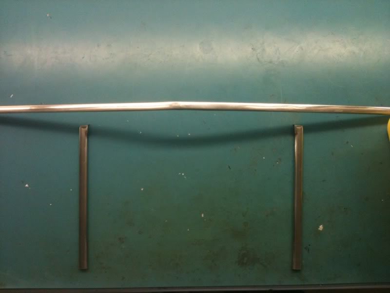

Also tidying up the chrome surround for the grille. Cleaning up a few very minor dints.

Are these alloy or stainless? and did they "flick" off easily without damaging the grill?
#161 hanra
Posted 06 September 2011 - 12:10 PM
They appear to be stainless. They were a very tight fit but eventually came off without damage.

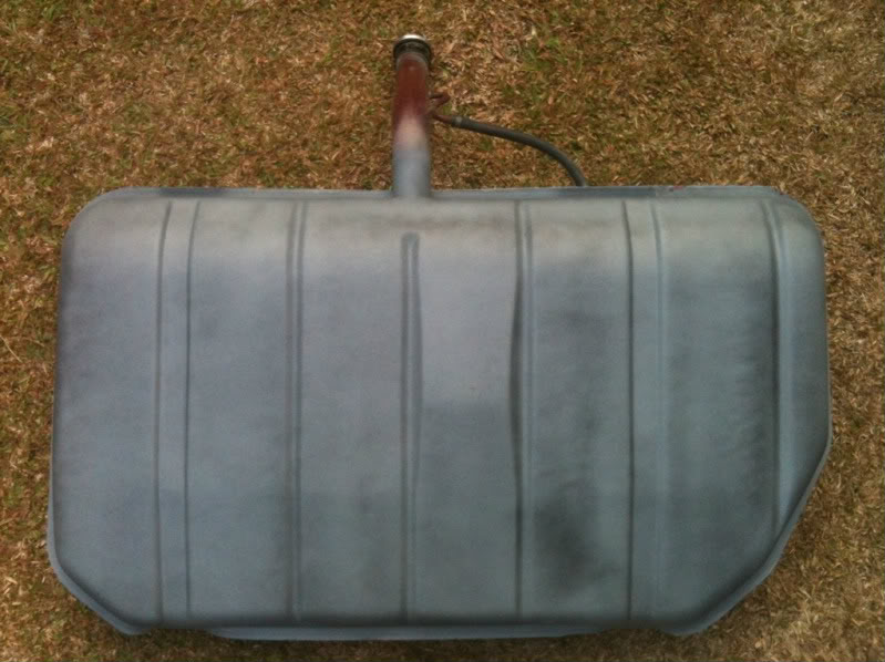

Posted 20 September 2011 - 11:33 AM

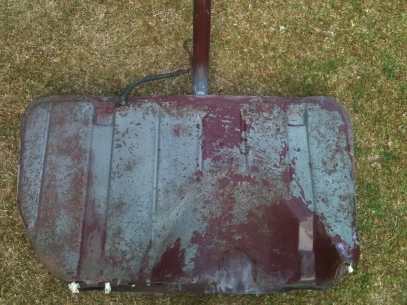

Trying to strip the powder coat off this tank is such a mission.....
Repaired side:
Edited by hanra, 20 September 2011 - 11:36 AM.

looks like your onto it hanra, i used wire wheel on my 100mm grinder to do the tank on my tonner it worked a treat. is that what you have used?
#172 hanra
Posted 20 September 2011 - 06:55 PM
Initially I used paint stripper on the powder coat and wrapped it in glad wrap, then hit it with the gerni, then went over it with this big stripping pad on the orbital sander... Dunno what it's called but it hooks in! Time consuming... Powder coat is hard wearing stuff!!!
