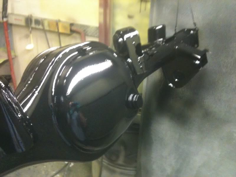

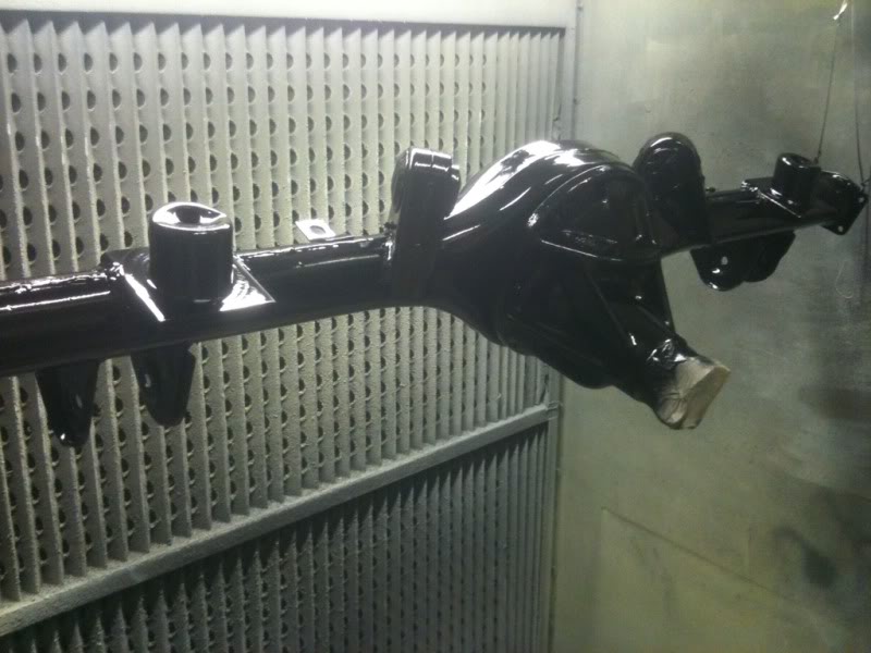

#206 hanra
Posted 02 October 2011 - 10:01 AM
Gettin some colour on the diff this morn. Will start on the trailing arms soon.

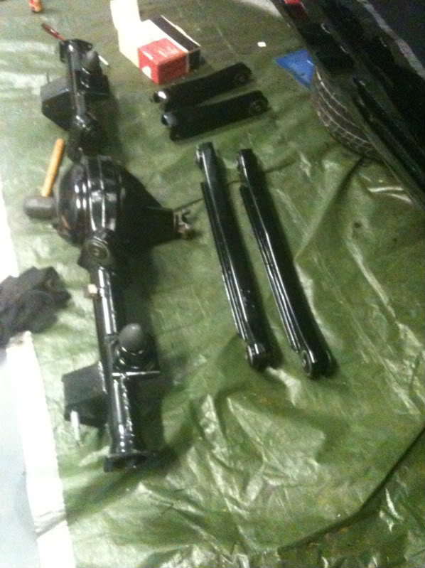

#210 hanra
Posted 05 October 2011 - 08:04 AM
Getting ready to find its way back to its new home:

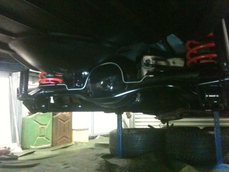

#213 hanra

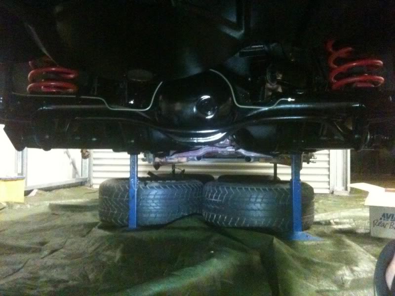

Posted 06 October 2011 - 11:14 PM
Got the rear end in all good. I'll have to get some new gaskets for the axle retainer to brake backing plate before I fit the axles n what not.

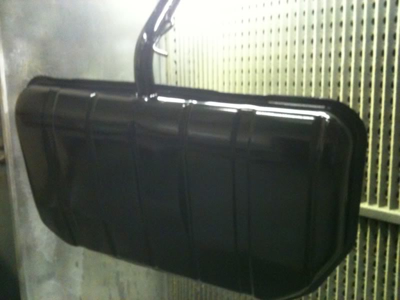

Posted 09 October 2011 - 05:05 PM
Got the fuel tank all painted up. Try n get that fitted this week. Then it can go back on it's wheels.

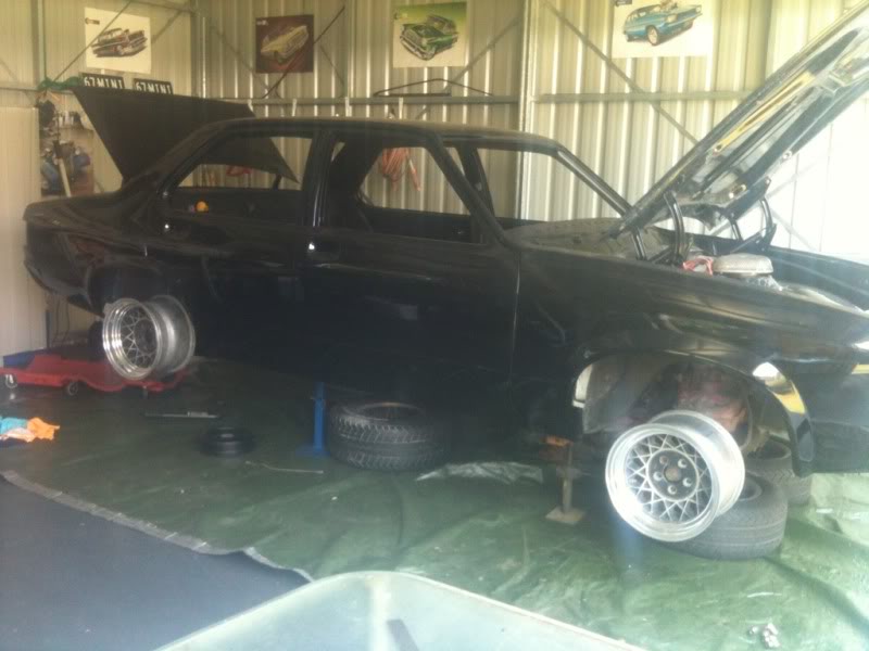

Its going to be a tight fit once you get the tyeres on ole mate ! Lovin the black paint. Im sure the pics dont do it justice as mine dont either :)
#219 hanra
Posted 10 October 2011 - 07:46 AM
The 14 by 8s wont fit on the front. But fingers crossed I can squeeze a tyre under the rears.. Ill have to find some 14 by 7s for the front.

The 8's should fit on the rear. I know they wouldn't go on the front because that's what I have but with flares. 14x7's should be ok on the front I'd say

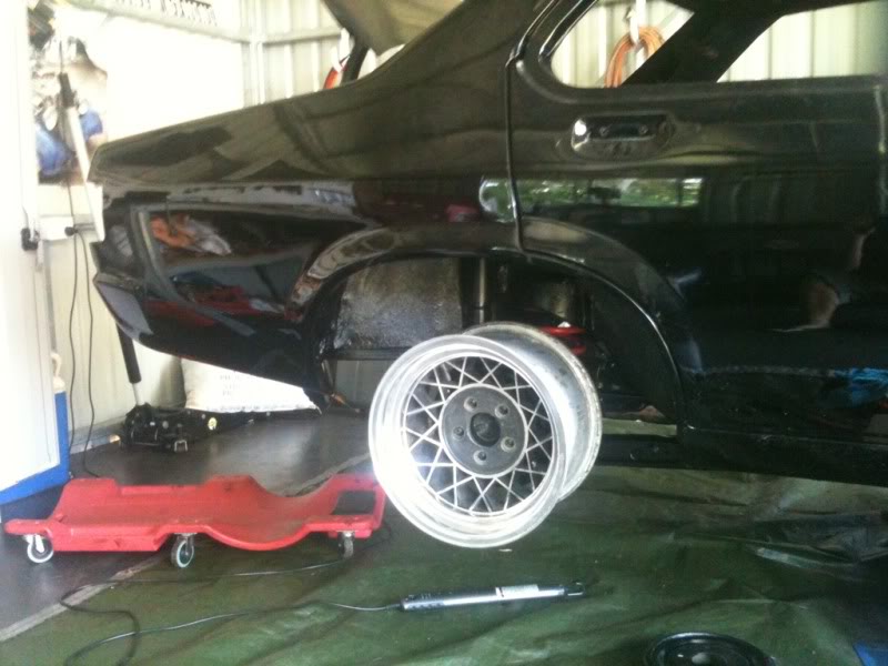

#223 _hatch76_
_hatch76_
Posted 10 October 2011 - 04:46 PM

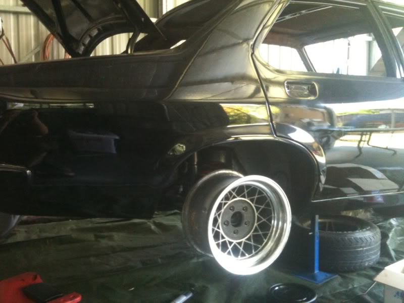

I use to have 14x8 dragways under my hatch with 245/50. I couldn't go much bigger because of the shockers.
#224 _mick74lh_
Posted 10 October 2011 - 05:11 PM
You could fit a 225 or 235 14 on the 8 inch wide rims and, depending on offset, clear everything. I've got 245s under the bum of mine and can't lower the rear because it will scrub the outer guard lips. So the plan is to get something a bit narrower soon and lower the back.
#225 hanra
Posted 10 October 2011 - 05:17 PM
I've got Pedders Low Springs in currently and the guards have been rolled. I don't intend on carrying 5 people in the car so should be all good then!!
