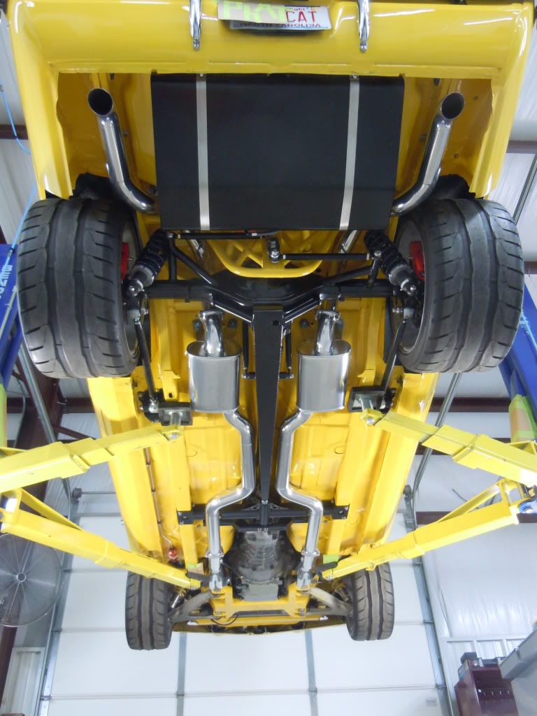

Also imo its definitely best to run pivot rod ends on your torque arm set-up rather than a poly bush.
Camaro-Torque-Arm-F-Body-Torque-Arm-Fire
If you were going with a torque arm setup like that, how do you decide what length to make it, optimum vs what you can package in a Torana, or ?
#245 _LXSS350_
_LXSS350_
Posted 05 August 2013 - 04:05 PM
You don't do any changes to suspension without doing your homework. Its so easy to create heartache if you don't know what you are doing. As Matt says above, the three link is the best layout for a live axle torrie but packaging it is the big party trick. That becomes even more an issue when your mother (CAMS) says you cant enter the cabin (what a bitch rules can be).
The torque arm is a way of getting around this and keeping mother happy, but its mounting and the layout for the geometry still needs to be optimised within the available room and restrictions. Its not something for guesswork or a 5min job.
As you know torque arms/watts links have been used to solve similar issues on Mustangs and F-Bodies that are suffered by torrie owners.
