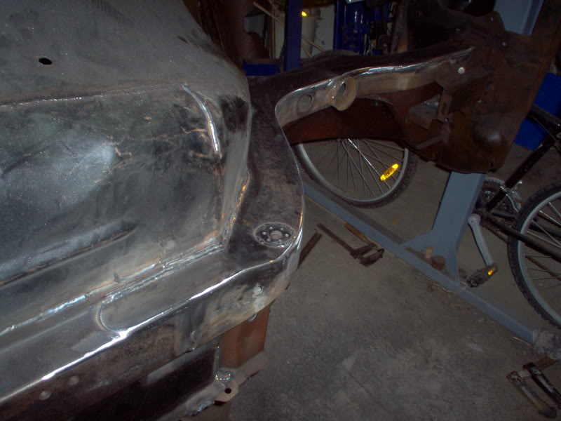

Thanks for the input Vick. If I had a rim to put a tyre on that would help LOL. I ended up going with a diff width of 1495 after talking to the diff bloke.
Mount the tyre to the rim and measure the tyre sidewall to sidewall. You may wish to throw that into the equation.
As I want to get the roll cage done (rules changed as posted before) I have mounted the Sub-Frame to get and idea of how it will work in with the roll cage. I tried out the alloy bushes I had made up, happy with the result. Fitting the Sub-Frame is a prick of a job!! Any way I got it done and now I can start working on the cage.

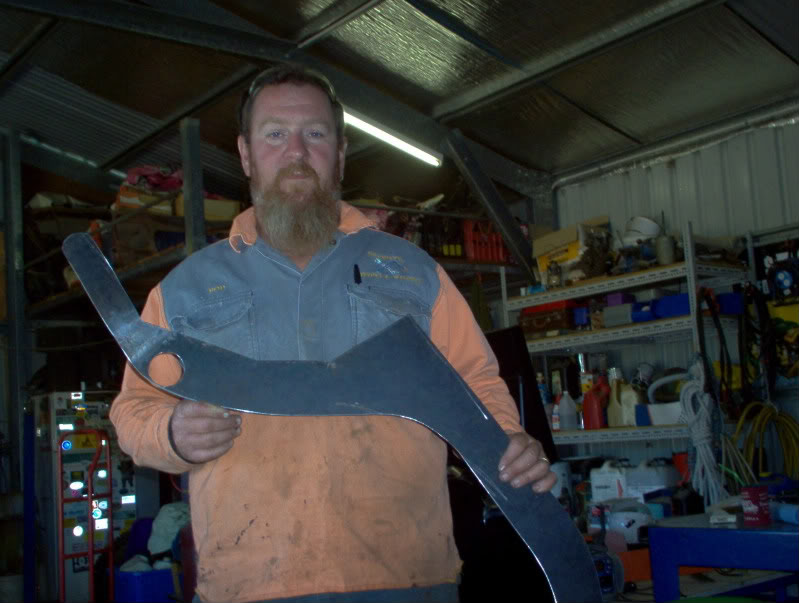

Just started to fabricate the front bars to the sub-frame bolts. Just the initial set up at the moment, will trim and tidy up and get it ready.
Give you an indication of what I want to do anyway.

Both sides mocked up. I will also be putting a bar in from the cage mount up to this bar just behind the firewall.

If you're wondering what tool I have been using to notch the tube, this is it. Made by JD2, it is an awesome bit of kit.
Attached File  05.JPG   151.78K   10 downloads
