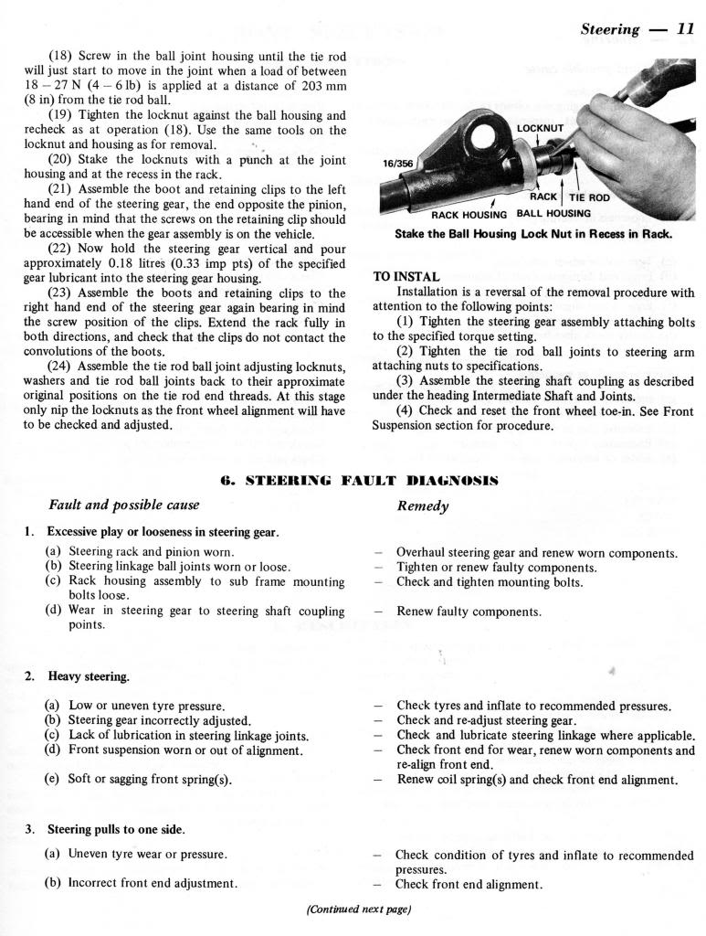

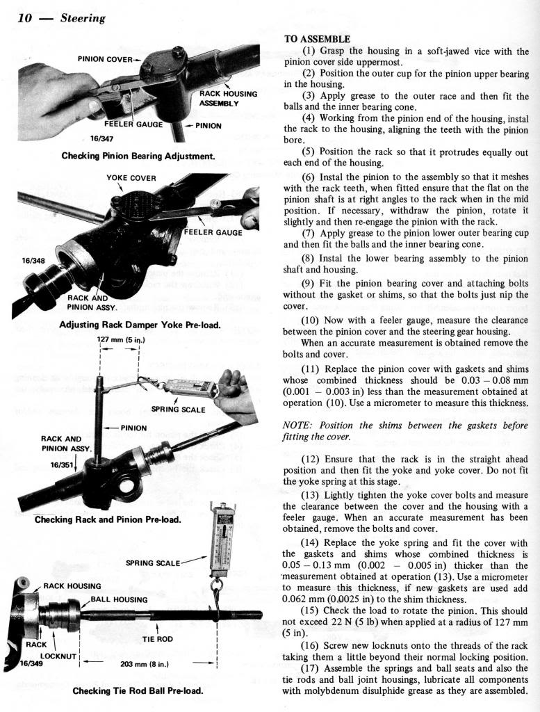

Putting the steering rack back together,
How tight should I do the tie rod ball housing up??

#666 ls2lxhatch
Posted 06 May 2014 - 01:24 AM
Two pages from the Gregory's LH-LX manual.
https://cache.gmh-to...eringrack01.jpg
https://cache.gmh-to...eringrack02.jpg
Hi Andy, I have been using that same book for information. I should have explained it a bit more as I did know of that method with the pull test on the tie rod. I was just wondering if anyone had employed another method of checking the pre load.
#670 76lxhatch
Posted 06 May 2014 - 02:50 PM
The contact adhesive won't hold it long term on its own.
It should do, that's all that holds the headlining and that's under tension
That's really the only way, counting turns or something like that won't give consistent results. Can get them pretty good by feel if you don't have a spring gauge (they are cheap enough though), still better than guessing.
