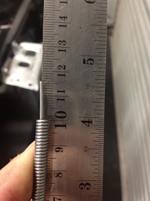

The overall length of the inner cable from knob end to wire end is 182.5mm.

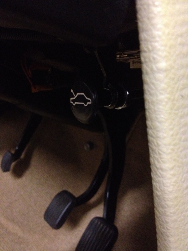

What the heck, I dug it out anyways, ha ha...
I replaced it with an aftermarket billet handled one, so had the original one packed away. I can only imagine this is the original one ?
Pic of the cable length is with the knob pushed all the way in of course...
Posted ImagePosted Image

THANK YOU JEFF. I reckon that length would be ideal. Mine is also pushed all the way in but only has 15mm poking out.
Hopefully someone at Rare Spares can chime in and double check a cable they have in stock.

The little car picture with the bonnet up is different on the new one too...not sure if that is an LH to LX thing, or just a repo versus original thing ?
Notice on mine the drawing is an outline made up of twin white lines, where yours' is a solid while line outline..
And no problem on the pics/measurements !
Perhaps the outer part of your's is over length ? You could slide the inner part out a few inches and slice off some of the outer, which would let the inner poke through the right amount ?
Of course that might make the outer sleeve too short, hmmmmm....guess I should go back out in the shed and measure the outer sleeve part of mine too, lol

The one I have is 72" long from the end of the outer sleeve (on the bonnet latch end) to the other end flange (end of the threads, that the knob hits against basically)
The length of it looked stock all along at least, and worked perfectly..had been that way for some time now of course. (I just went with a billet one mounted differently since I mounted my OBDII port under the dash where the original knob went basically)

From red mark to red mark, is 72" :D

Unfortunately your suspicions are correct. The outer cable is fine as Jeff
has measured at 72'' but the inner is at least 1/2 inch too short. It JUST gets
to the latch but dos'nt go through the hole. I'm going to PM Les about this
as well as the radiator hose clamps that are too big.
