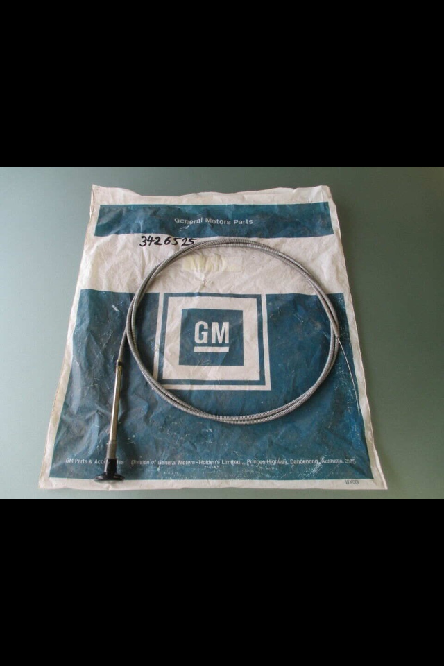

Posted 17 August 2012 - 07:58 AM
Ive confirmed my outer cable is also approx 72 inches as per Jeffs. Well its 182ish cm.
#52 308 Sunbird
308 Sunbird
  • 976 posts
  • Name:Stuart
  • Joined: 20-November 10
Posted 17 August 2012 - 09:24 AM
Yep outer is fine, inner needs to be an inch longer. :furious:

#54 hanra
Posted 17 August 2012 - 10:07 AM
Yeah or 2inches and then it can be safely trimmed to the correct length. I really honestly hope I dont have to wait months for this to be fixed up...

#56 hanra
Posted 17 August 2012 - 07:06 PM
Les is away on holidays however David responded to me and has advised there have been inconsistencies with these cables and have now been withdrawn from sale.... Dosnt really help me right now.... I just hope they can get them sorted out sooner rather then later. I mean it just means not cutting the end so short during manufacture.... Surely that cant be to drastic to change????

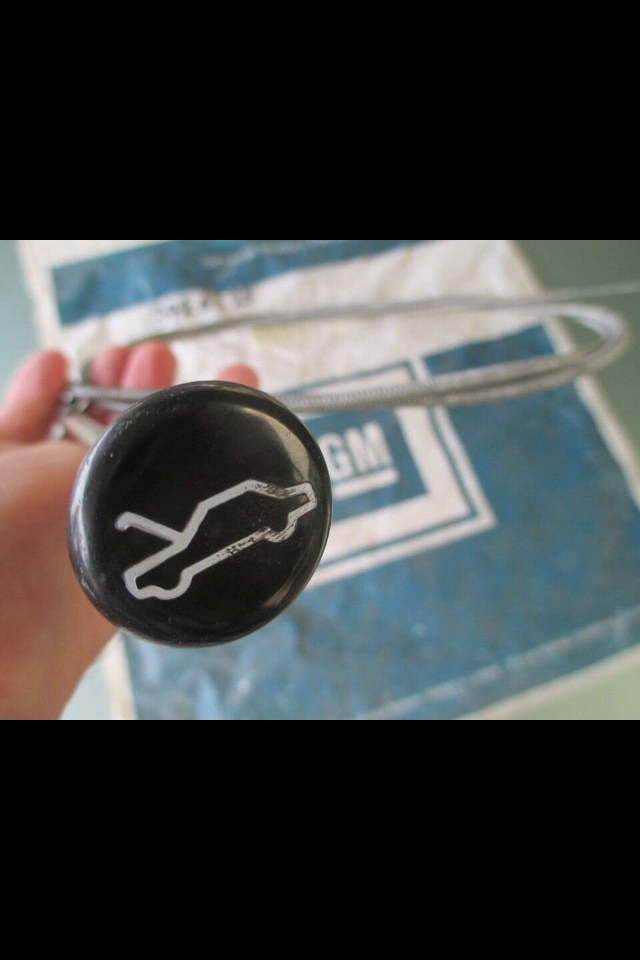

#58 _LS1 Hatch_
_LS1 Hatch_
Posted 18 August 2012 - 01:46 AM
What about the incorrect way the little car drawing was done ? Might as well reproduce it correctly if they are going to go to the effort. (aside from the cable length issue of course)
That is assuming of course I should say, mine is the correct way ?
#59 _CHEVED_
_CHEVED_
Posted 18 August 2012 - 06:59 AM
My thoughts exactly it's not that hard to copy.
#60 hanra
Posted 29 August 2012 - 10:12 AM
At this stage its looking like approx 3-4 weeks to see an advanced shipment of the new bonnet cables.
#61 _LS1 Hatch_
_LS1 Hatch_
Posted 29 August 2012 - 10:14 AM
Was there any mention of the diagram on it too, out of curiosity ?
#62 hanra
Posted 29 August 2012 - 10:17 AM
No. I dare say they will just be a couple of inches longer. I would imagine RSP would need a 100% original cable on hand to be able to copy from.
#63 _LS1 Hatch_
_LS1 Hatch_
Posted 29 August 2012 - 10:26 AM
Makes sense...just be good to get one long enough to work for the moment at least it sounds like ! (but if they are remaking it in the future, might be something to check into...maybe compare a few original ones, incase mine is unique that is )

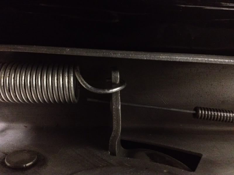

#65 hanra
Posted 01 November 2012 - 10:20 AM
Jeffs cable below:
Ive just received an updated version of the bonnet cable.....!
Just measured the amount poking out the end, its 50mm!!!!!
Ill know tonight if it fits ok.
Edited by hanra, 01 November 2012 - 10:21 AM.
#66 hanra
Posted 01 November 2012 - 09:28 PM
Looks promising. Have to get me the bonnet cable attaching hardware now. I think its meant to be included with the bonnet cable kit? Ill get onto RSP tomorrow and chase it up. I reckon its going to work!!!! Nice.
