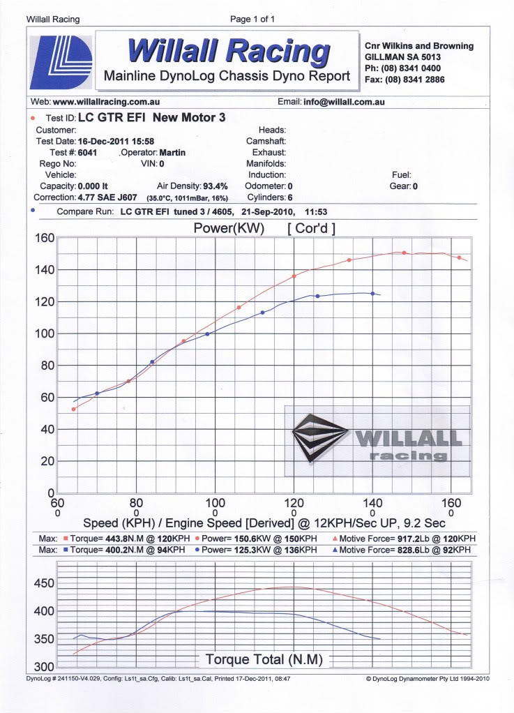

Where am I gonna get the extra grunt from? (dyno tuning ain't cheap) 150kw@wheels = 200 rwhp which is up around 250hp @motor (exactly what I was aiming at from the get go)
Tho I'm all ears if you got any more suggestion (as long as it doesn't involve making another manifold...lol)
No more manifolds? C'mon Adam, where's your sense of adventure?
What does the top end feel like now? I'd be really interested in the 1/4 mile speeds (even if they were, um, unofficial..). Reason being the original dyno figures proved to be pretty optimistic and I was wondering whether old mate has recalibrated it or whether these numbers are a bit happy as well. At any rate there's always more to be found, it's just a matter of looking for clues and the dyno chart will be a good place to start.
But I guess this is probably the last thing on your mind at the moment - enjoy the honeymoon!
