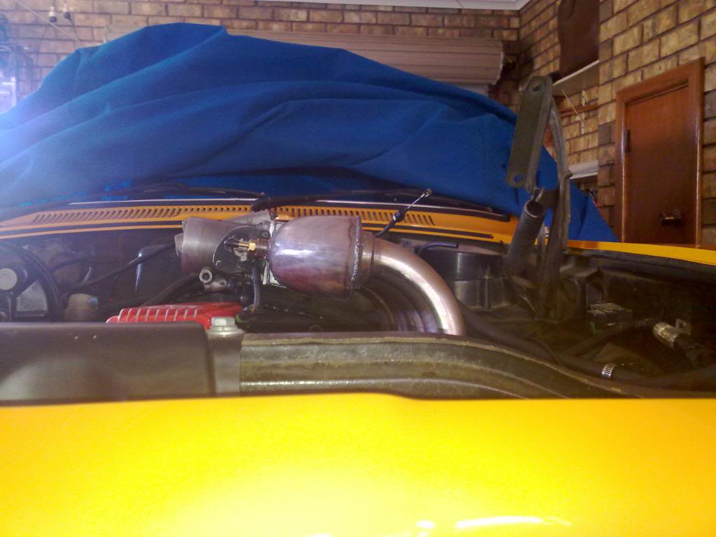

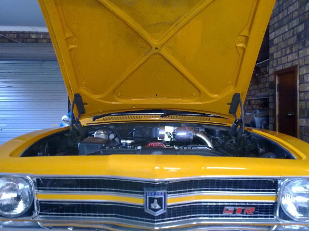

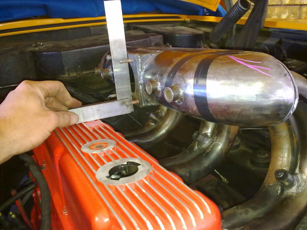

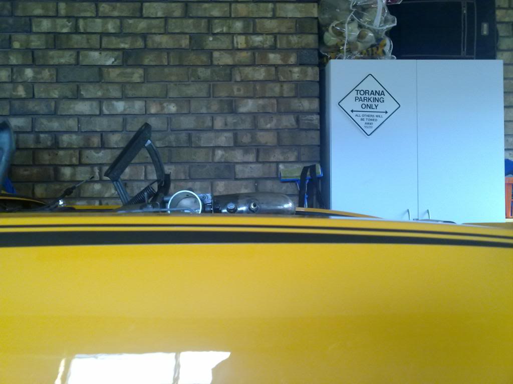

Ok so by now I should be out giving this thing hell....but..... slight clearance issue.
Due to the extra crap attatched to the standard throttle body (that I don't need) it hits the inner frame of the bonnet.
Seeing as there is no particular due date in mind for the car to be running again I'm not gonna rush in and just make it fit.
soooo... I plan on making my own throttle body, cutting the plennum and squaring it up so that it sits horizontal hence giving me the bonnet clearance that is required.

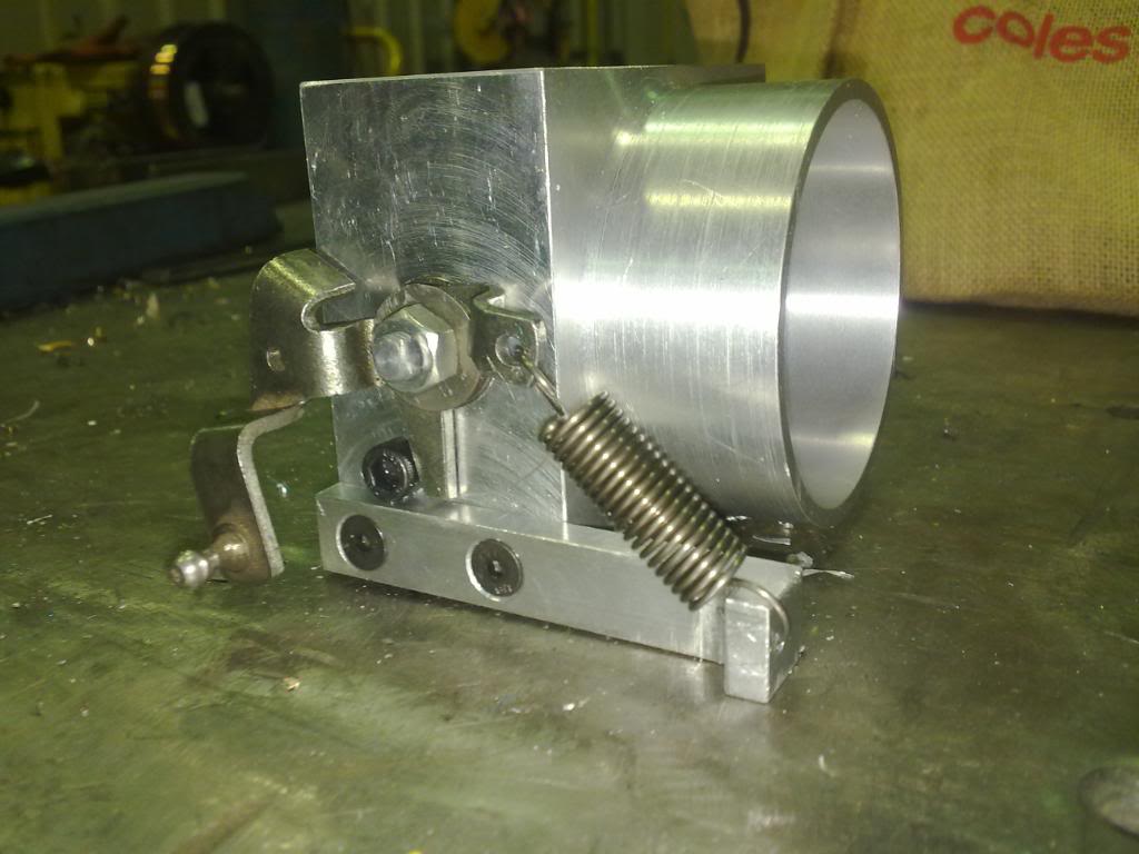

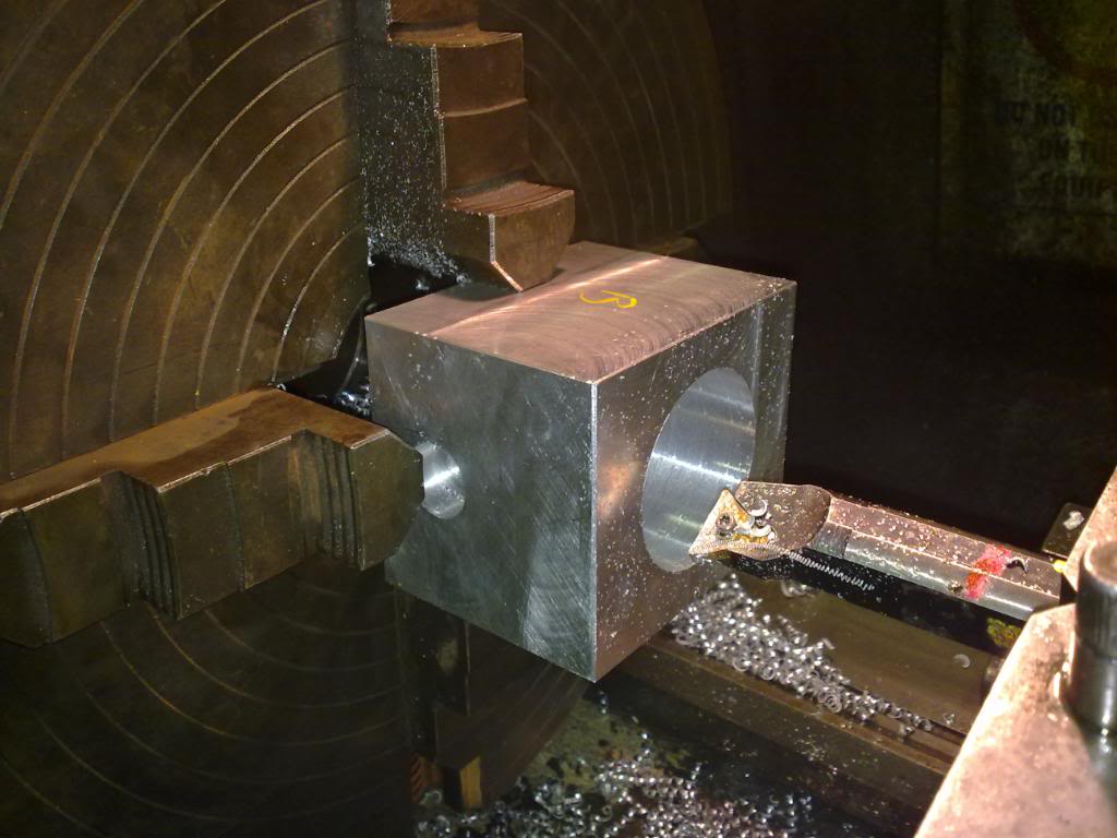

Here is my progress on the new throttle body.

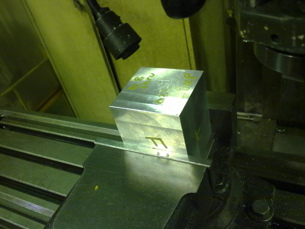

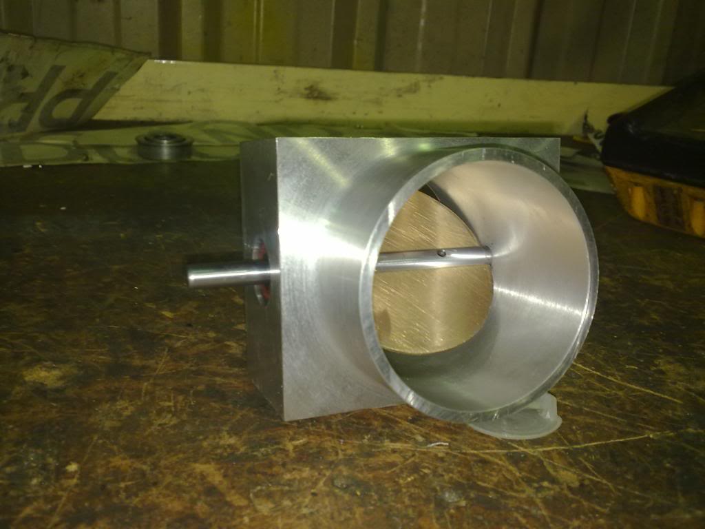

Started with a squared up block of ally
and drilled and bored where the throttle shaft will go. This one is going to be ball bearing shaft.
Then dialed it up in a 4 jaw chuck to turn the outer diam and bore out the inner.
Assembled and currently retro fitting the old TPS and working out how my throttle cable is going to be sprung and actuated.

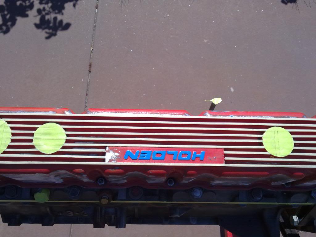

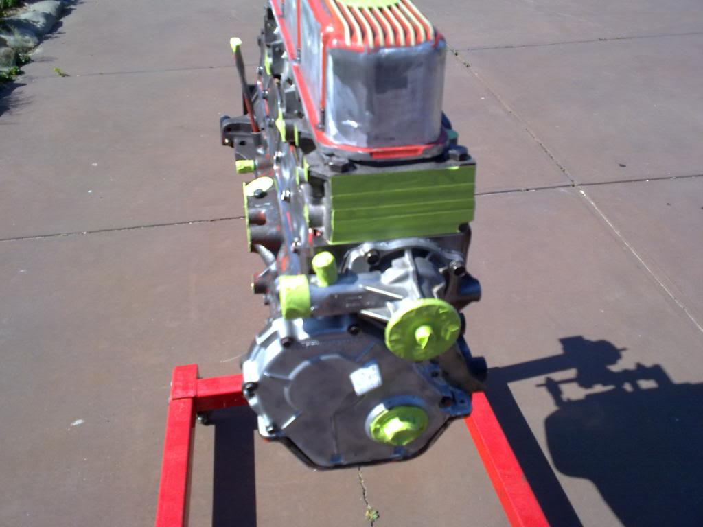

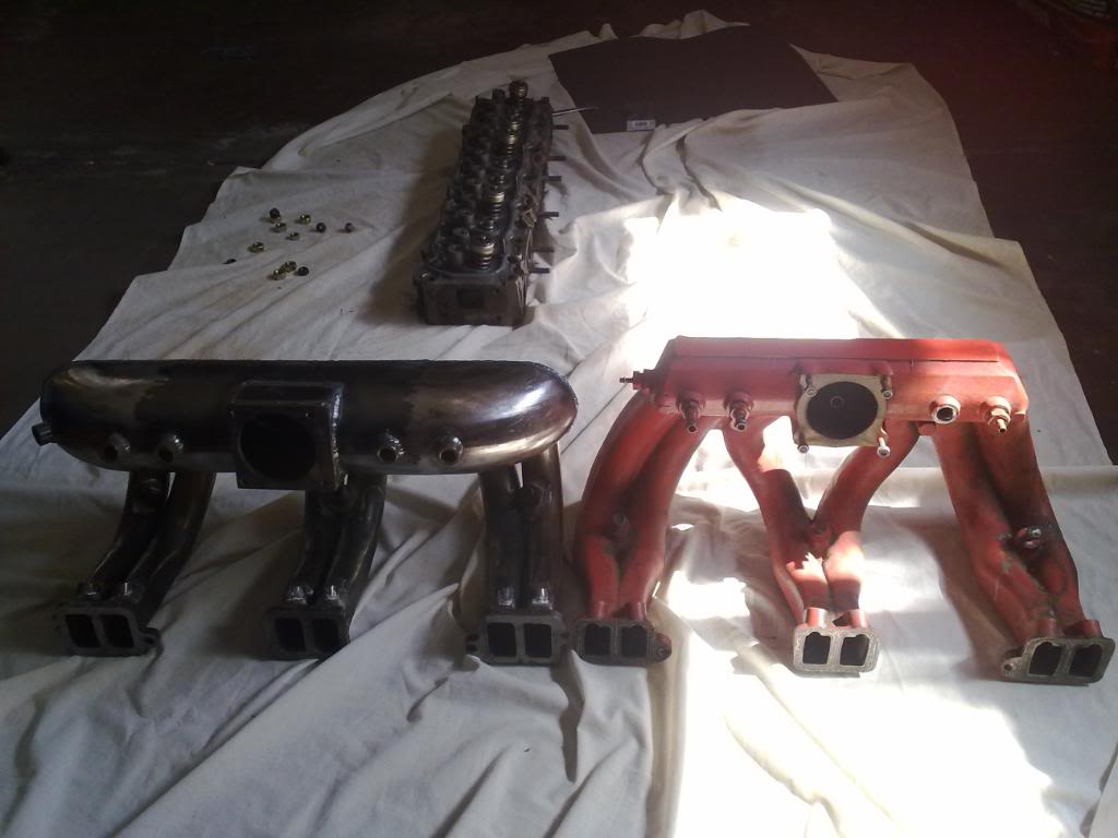

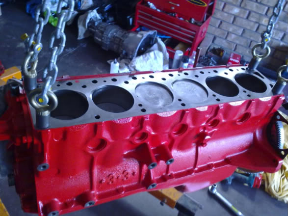

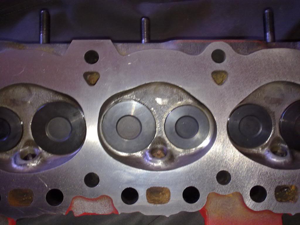

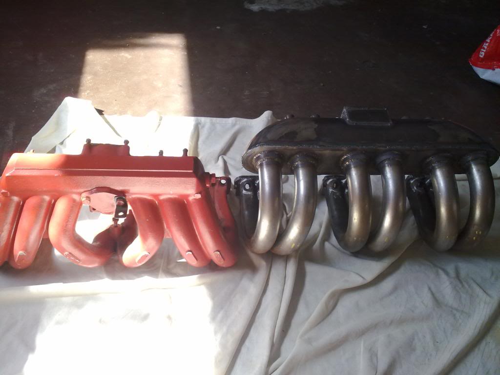

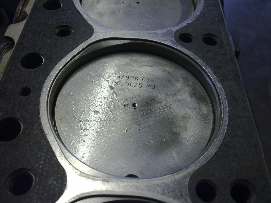

I'll throw is some pic's of the block and head as this is supposed to be a build thread not a mill and lathe thread
VK Manifold
My Manifold :banghead:
#53 _Inj gtr202_
_Inj gtr202_

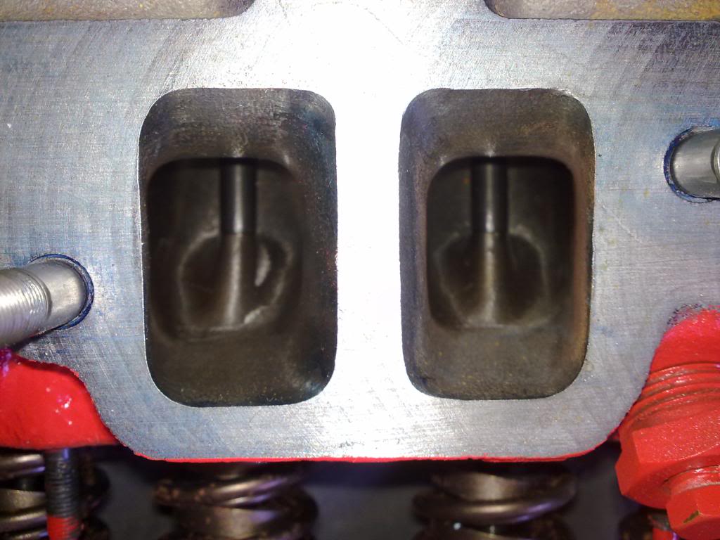

Posted 28 October 2011 - 02:27 PM
Head
Block
B4 paint

wow man thats crazy cool, never seen anyone make their own throttle body! What sort of idle control are you going to use? EF Falcon 6cyl throttle bodies have a electronic idle stepper motor which may suit?
Is your throttle plate a perfect circle? or more of a oval.... of the few throttle bodies ive played with the plates are abit of a oval as are the bores I think... and I always wondered why? do you know if it matters or why some are slightly oval?
#55 _Bomber Watson_
Posted 28 October 2011 - 08:24 PM
So when it closes it seals properly.
#56 _Viper_
_Viper_
Posted 28 October 2011 - 08:28 PM
So if the OD of the plate was the exact same as the ID as the TB it wouldn't seal? or is it cos it would just jam up?
I guess because its being rotated in the bore and not pushed in from the end it wouldnt work.
#57 _Bomber Watson_
Posted 28 October 2011 - 08:32 PM
I think that if you didnt have your idle screw out far enough it would return either past center or jam up.
Pretty well every throttle plate i have seen whether in a TB or a carby has been oval, im just assuming this is why.

Yes the throttle blades are slightly oval.
From memory I made the blade 0.05- 0.1mm bigger than the tb bore (which is round). Then filed by hand the sides and worked my round to that it seats nicely when shut. It does'nt shut perfectly vertical, for that to happen you would have to shape the ends to a knife edge or make them undersize.
My mate has an SR20 TB and I'm pinching a few pieces off that, any other suggestions as to what would make a good spring return or idle control I'm all ears.

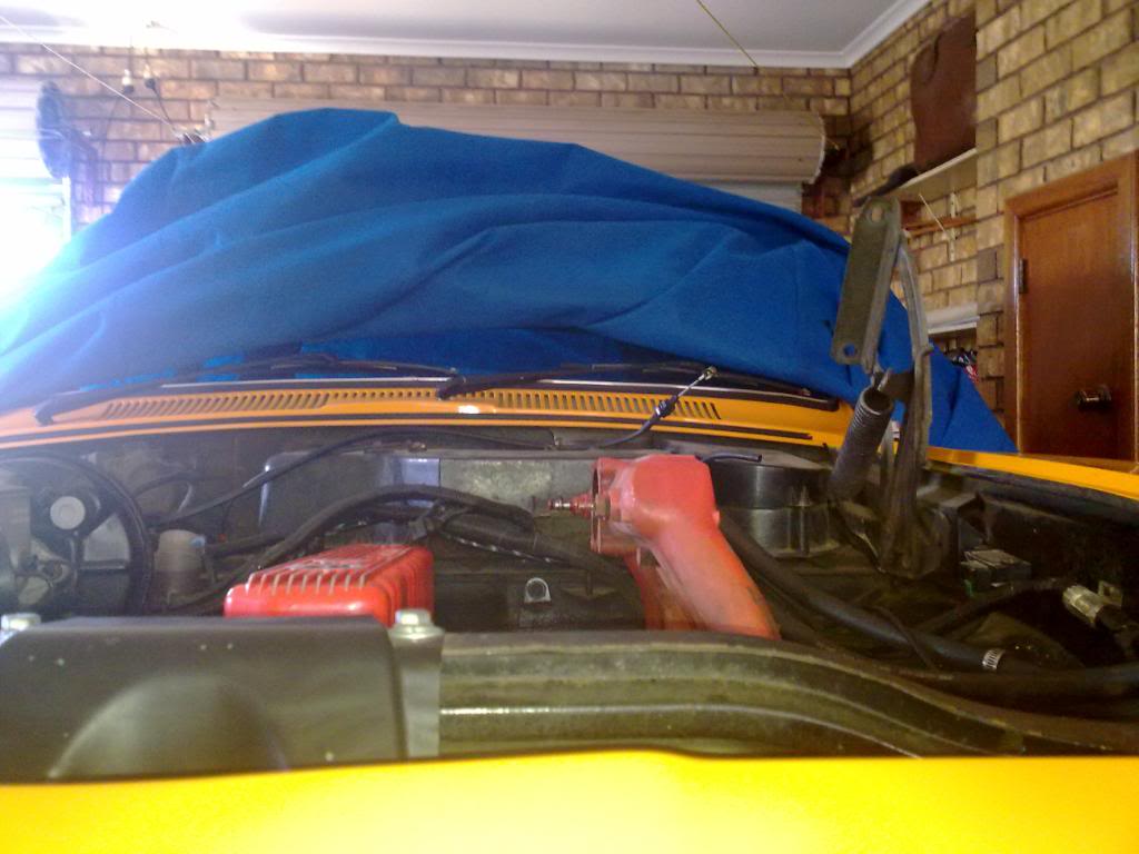

hi man good looking job on the manifold, but what are you going to do about bonnet clearance??? Looks like your manifold will protrude through the bonnet????
#62 _Inj gtr202_
_Inj gtr202_
Posted 01 November 2011 - 09:54 AM
Looks worse than it is. With no trottle body attached the bonnet will shut, the very front just touches. So I'm going to give it about a 10mm hair cut as I'm squaring it all up to clear the throttle body.

How much clearance will there be with engine movement?

Solid mounts (or atleast nolathane tuff mounts) might be the way to go then! Youd hate to have it lift on a big rev and ding the bonnet.

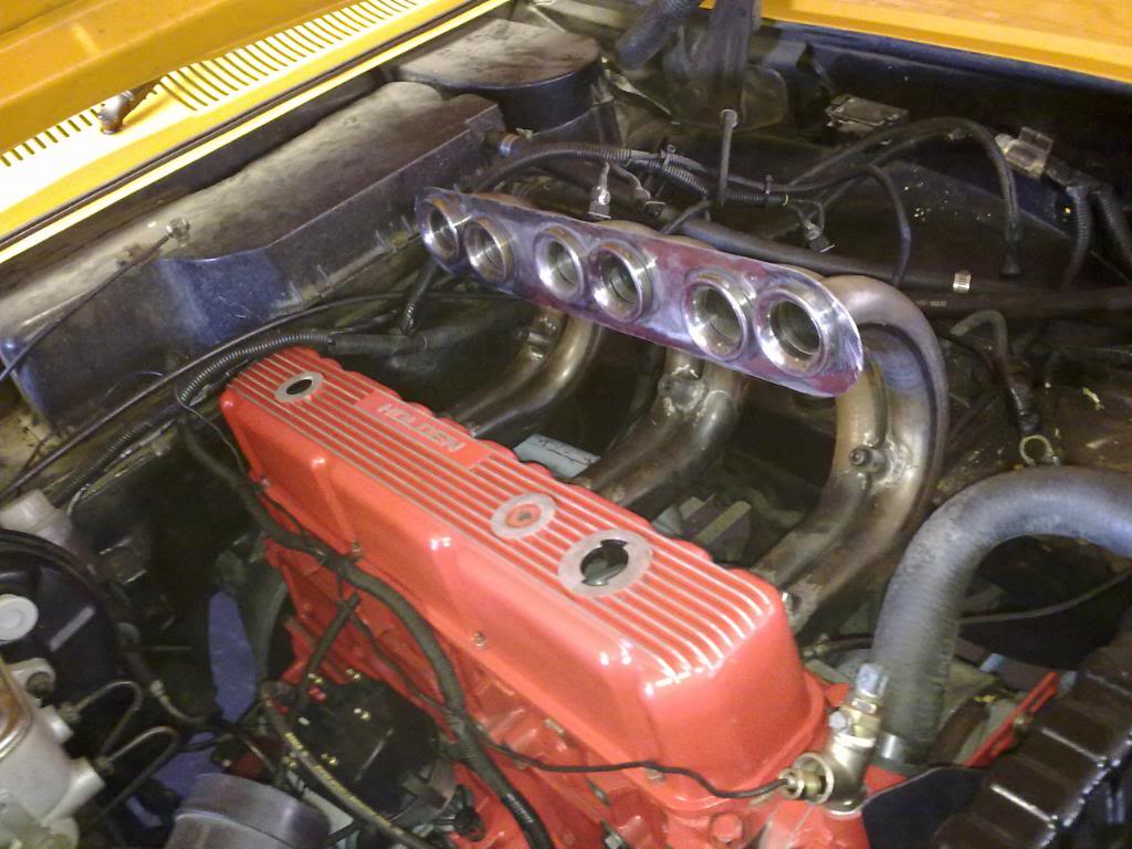

Posted 07 November 2011 - 03:04 PM

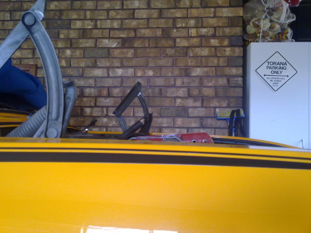

As far as bonnet clearance is concerned am I right in assuming that because of the engines rotation it will always flex towards the passenger side? ie. looking at the front of the car its going to try twist clockwise?. Assuming the pivot point of rotation is between the engine mounts everything on the passenger side will actually be twisting downwards.
anyways..
got the throttle sorted. I ended up using the stuff off the original, but with a heavier return spring. (still yet to attach the idle screw)
Edited by Inj gtr202, 07 November 2011 - 03:05 PM.
#69 _Inj gtr202_
_Inj gtr202_
Posted 07 November 2011 - 03:11 PM
Cut the Plenum off again
Squared it up
Tac welded it this time to check
Never been so happy to hear the bonnet click shut :party:

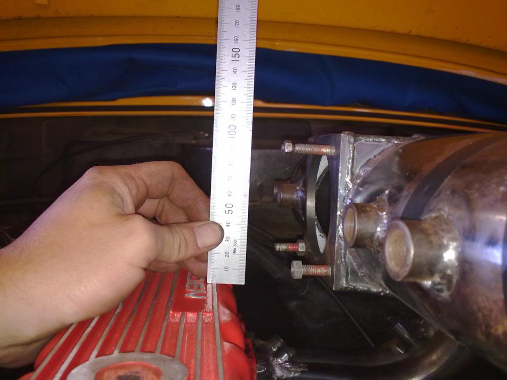

Best way to check the clearance is to get some soft clay or plasa sand ( steel the kids) and put it on top of the manifold at the highest point and close the bonnet. This will give you an exact read on how much clearance you have.

Yeah I did the trick with the putty stuff, I have about 5 mm clearance.
