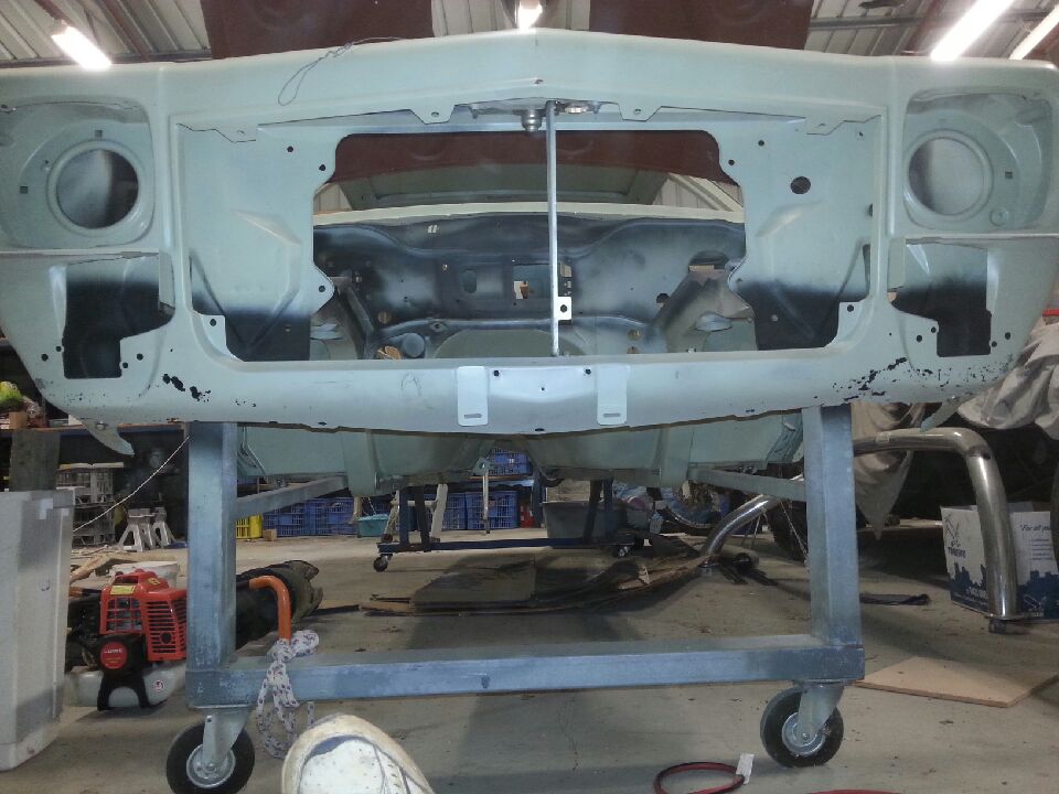

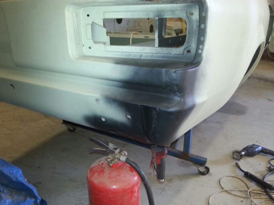

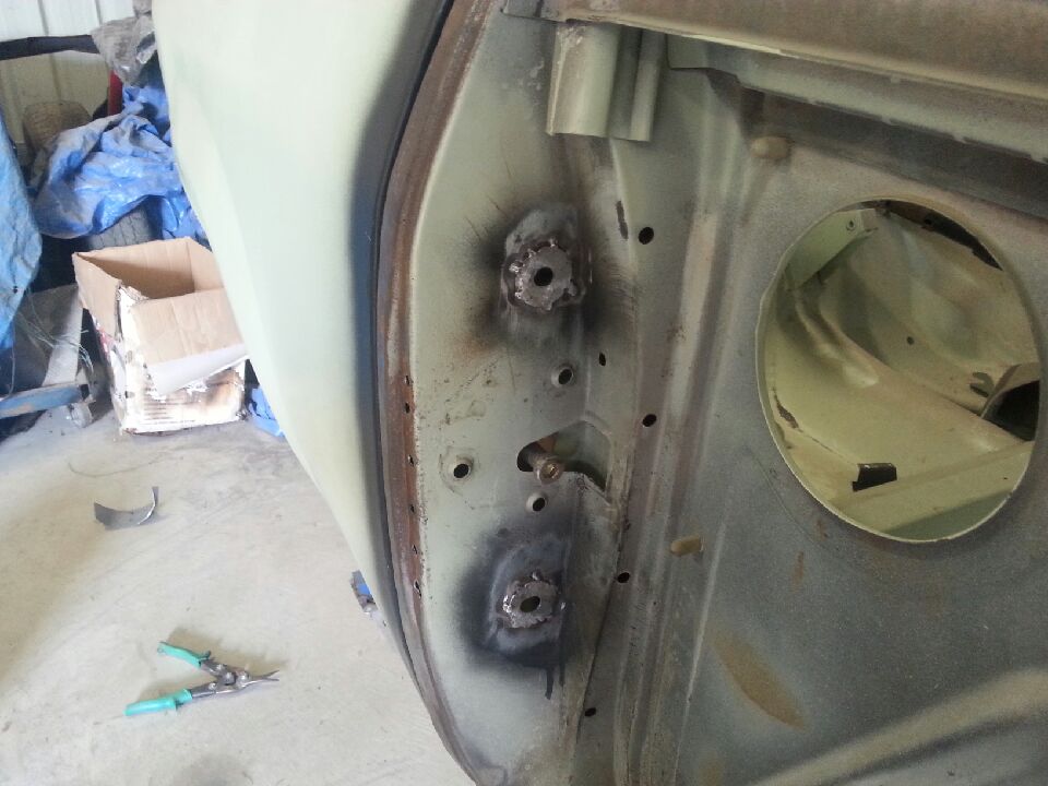

20161203_173711_zpsw2y9ij2l.jpeg 20161022_170452_zpsx6o0rdxp.jpg 20161203_174634_zpsgdmihakp.jpeg 20161203_174540_zpsflaxtnzq.jpeg 20161203_174540_zpsflaxtnzq.jpeg 20161203_173940_zpsdobitdq1.jpeg 20161203_174804_zpskyy3m1ae.jpeg

backwards this was meant to be after the second pic in last post

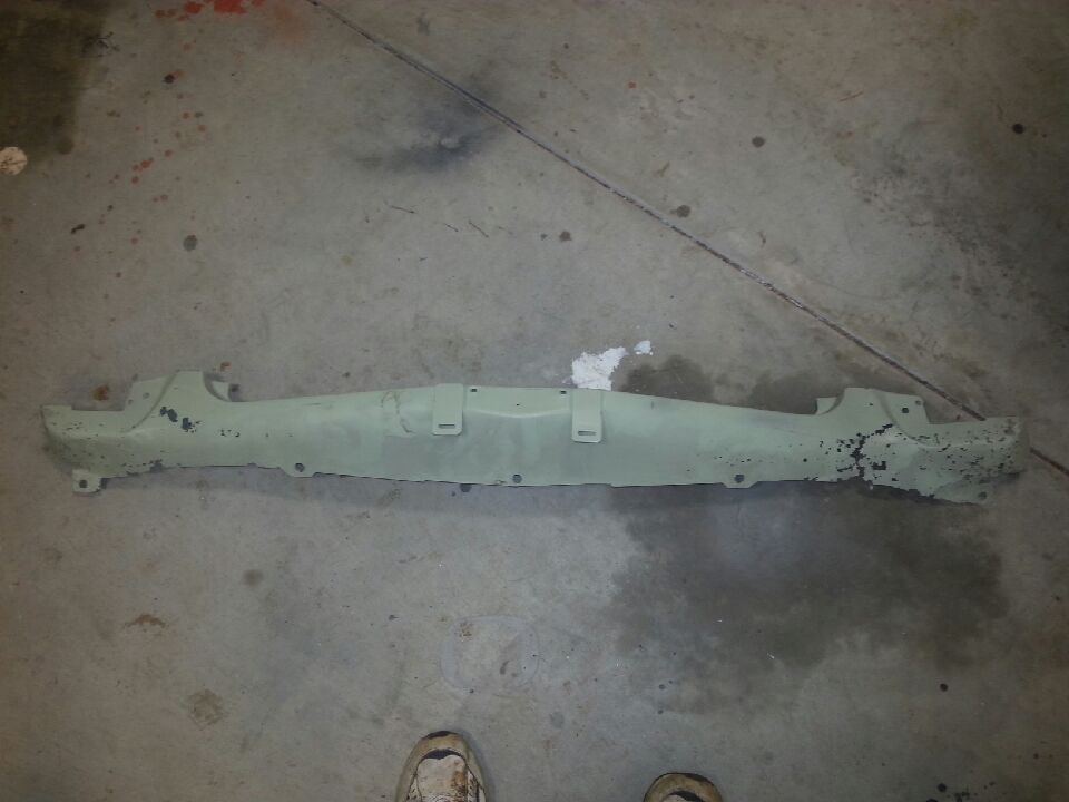

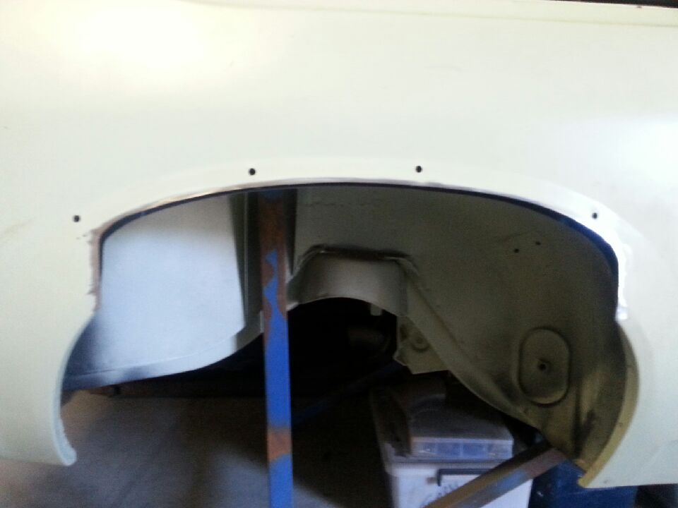

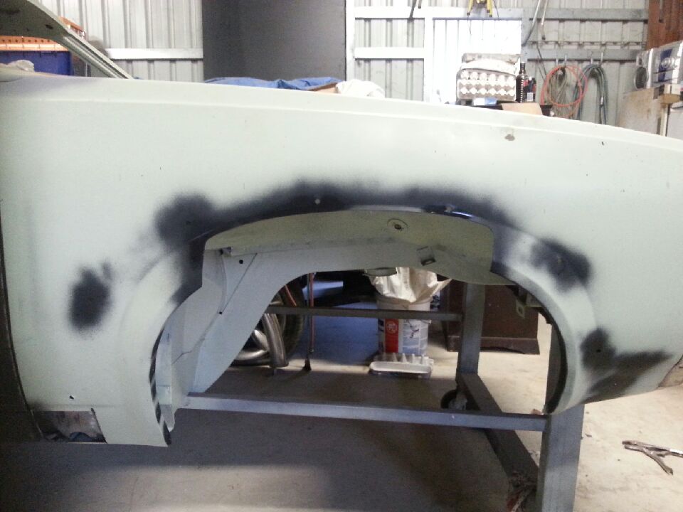

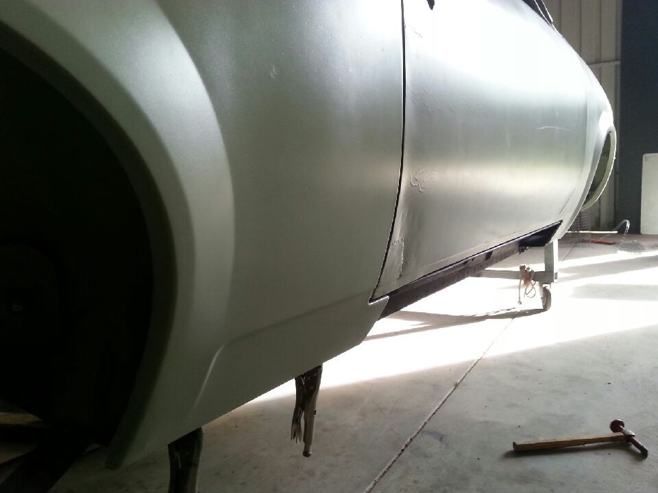

if you look close here you can see what was to be repaired
Edited by jonesy, 24 January 2017 - 01:01 AM.

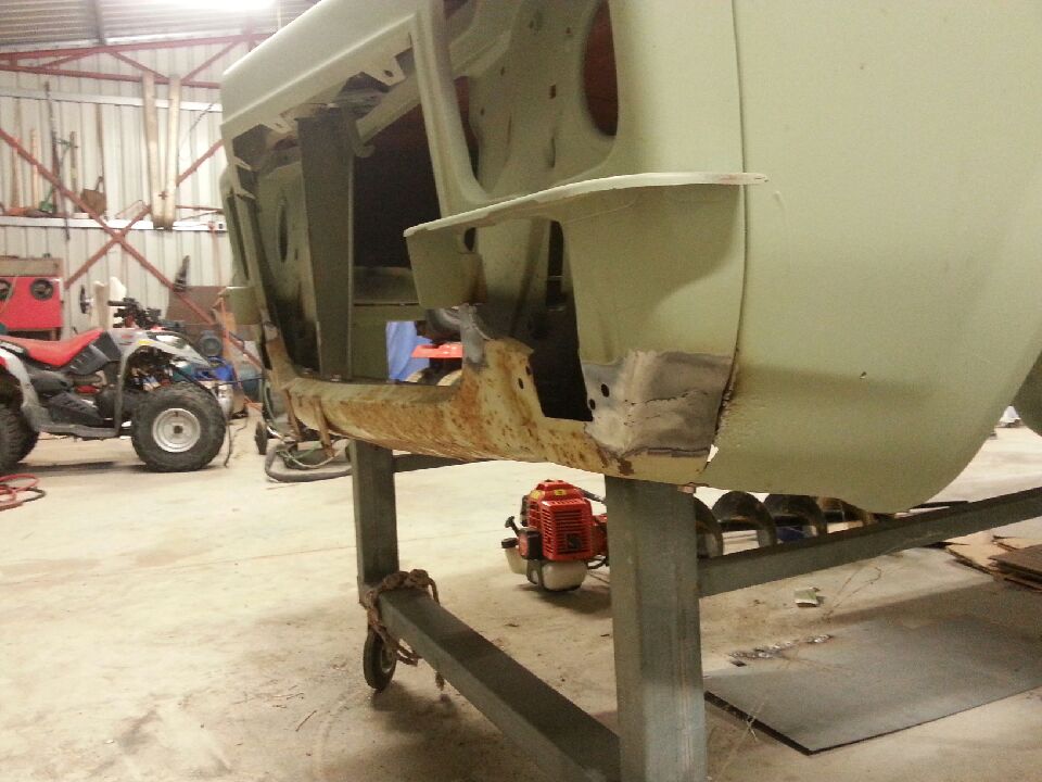

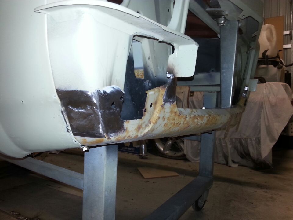

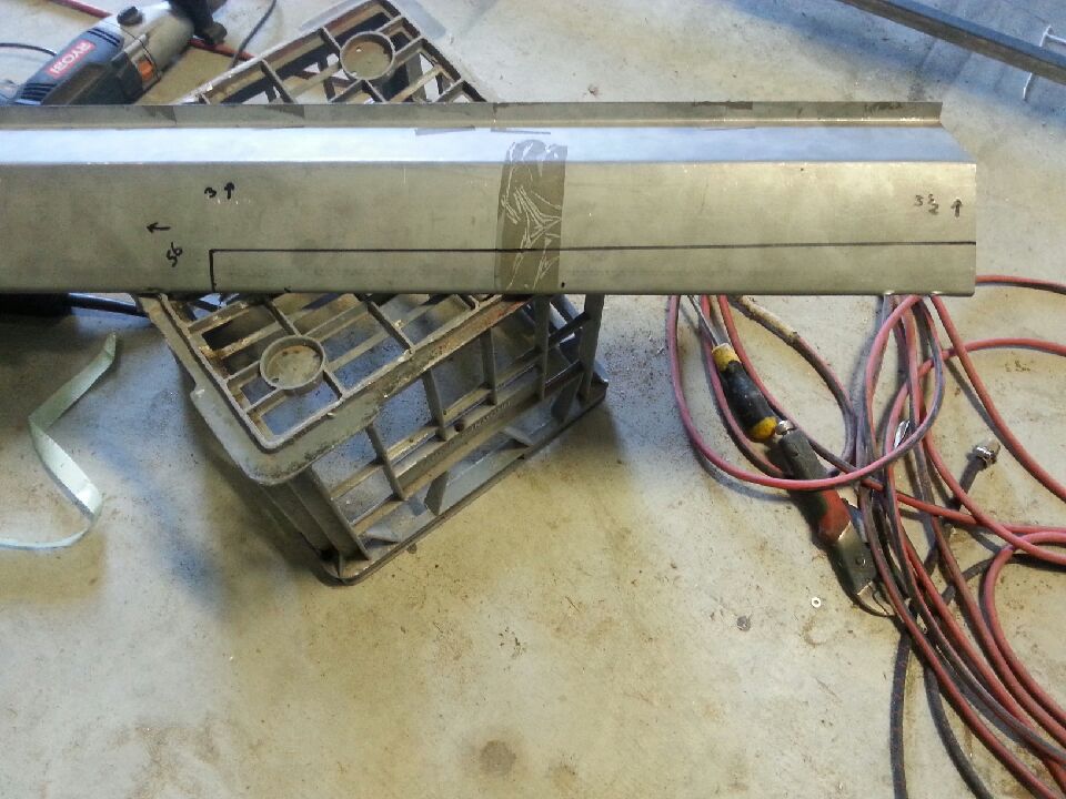

 this was a little while back but forgot to upload, interim work while waiting on my ass in gear getting a sill panel

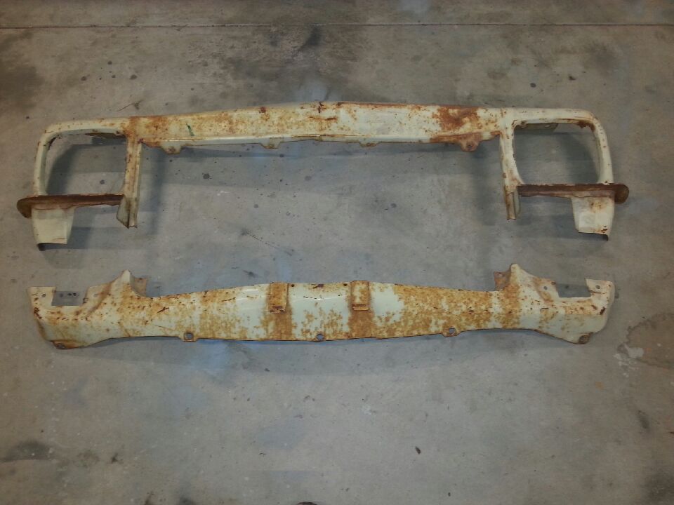

and thats still in that condition the apron is in now we will come back to that later

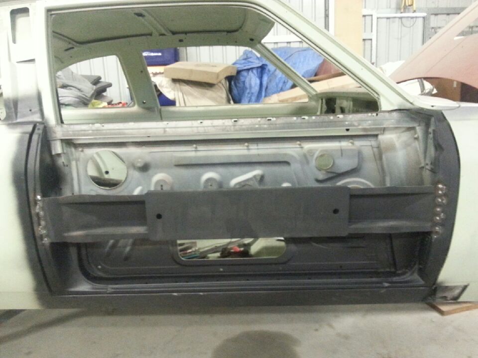

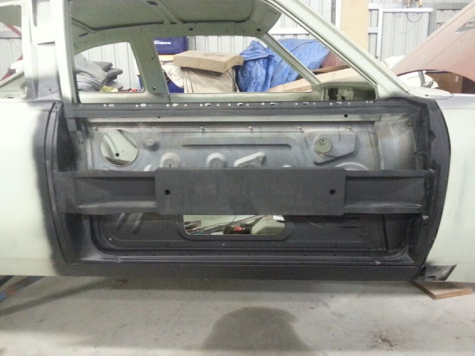

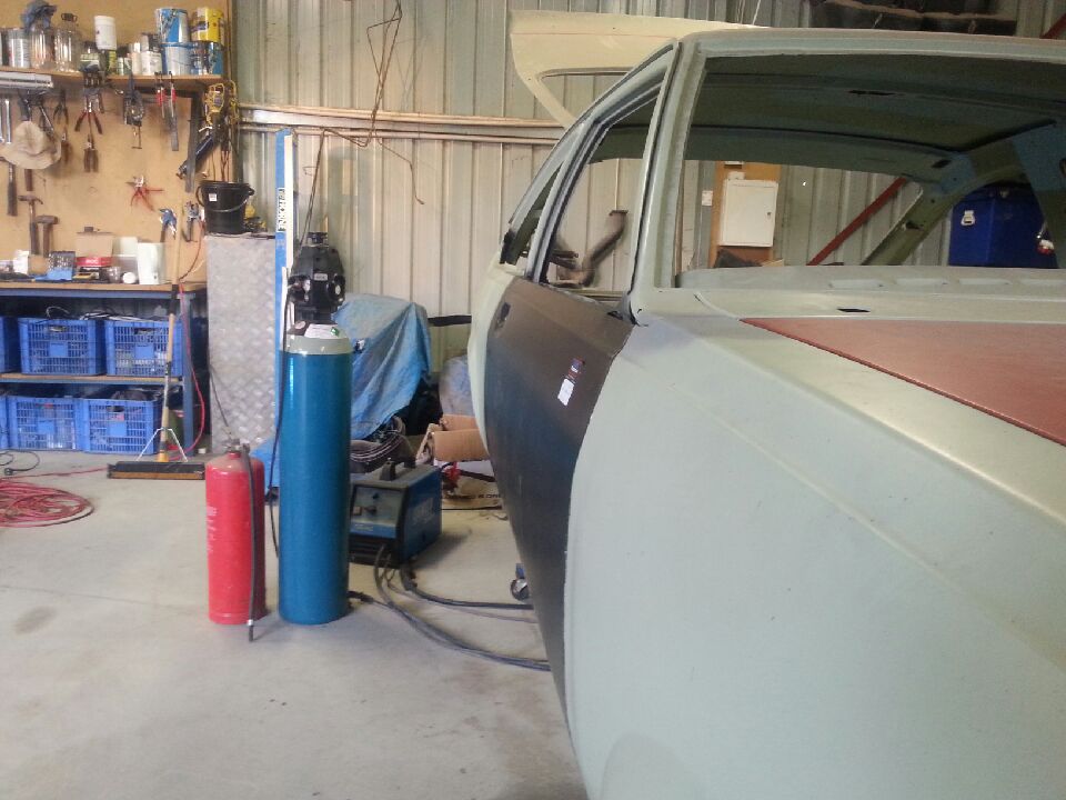

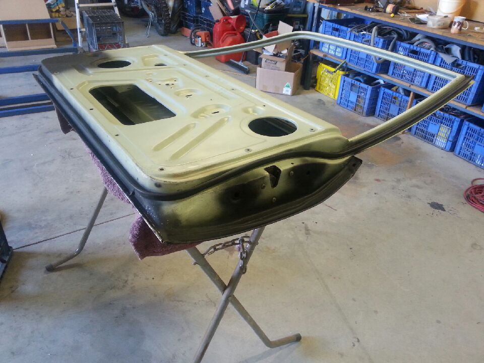

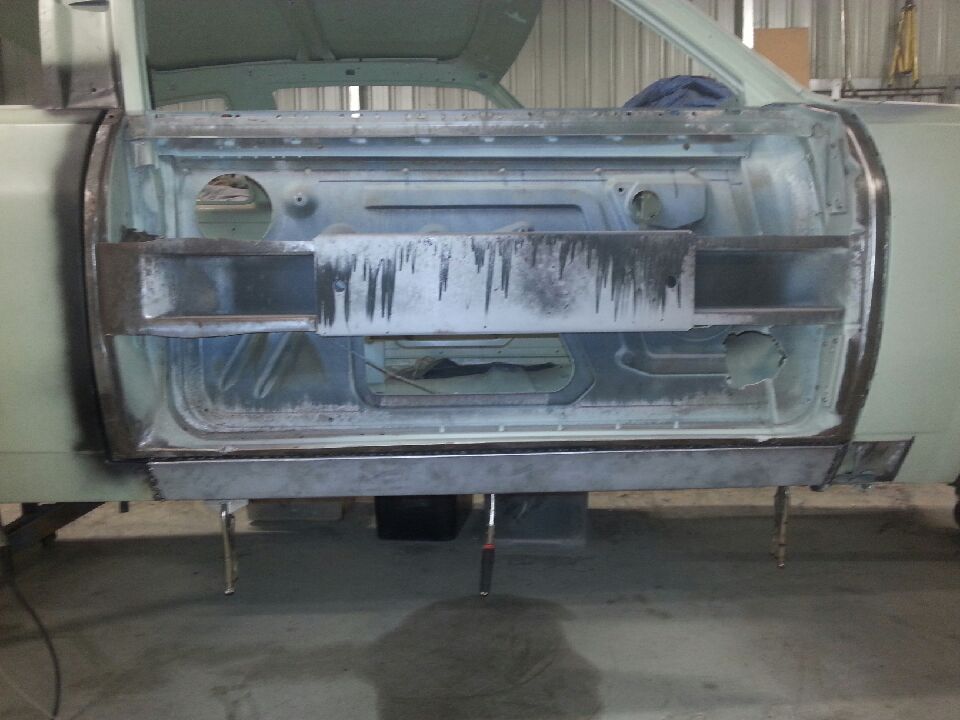

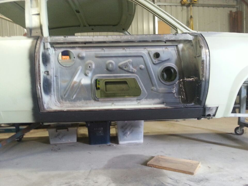

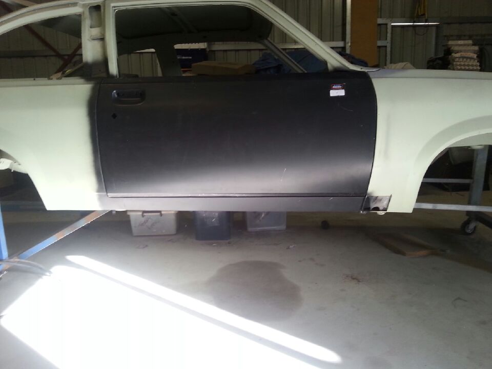

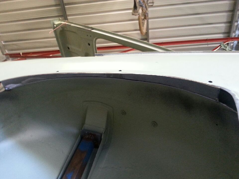

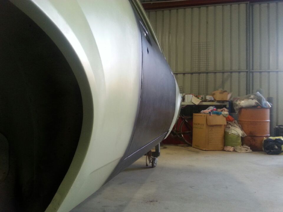

current project is the re-skinning of the drivers door
skin removed
and we are all up to date

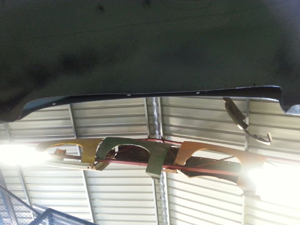

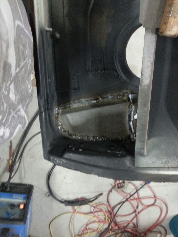

Posted 02 April 2017 - 10:53 AM

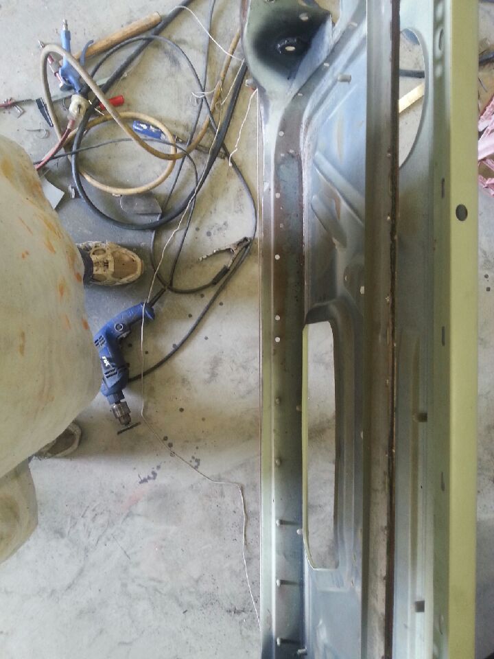

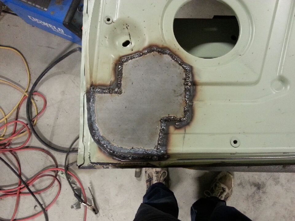

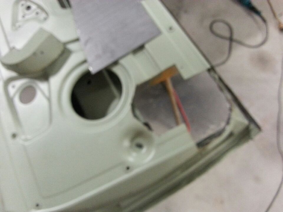

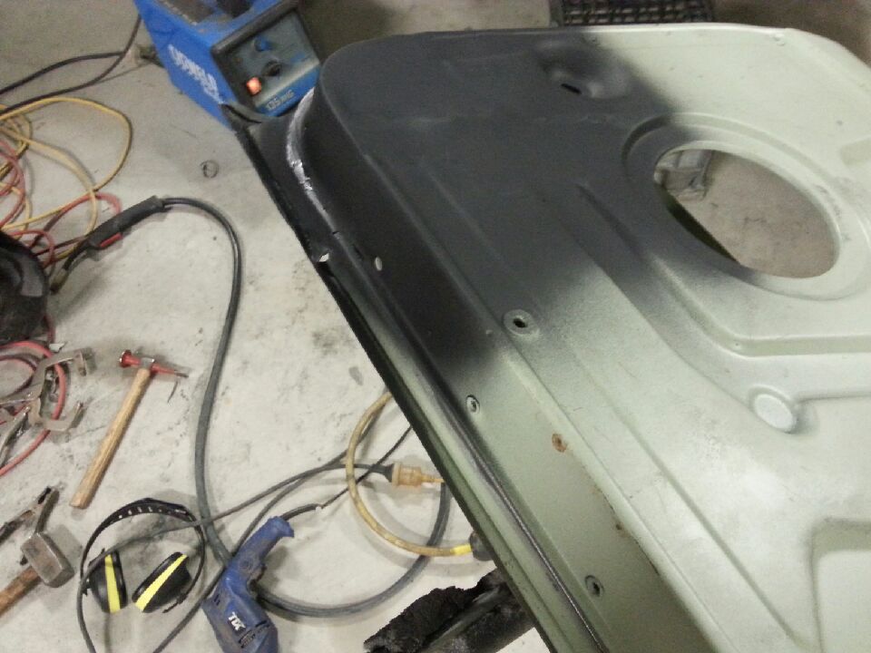

time to get pic heavy again...mass upload
please note the awesomely drilled and punched out speaker hole on the above pic
(some people are complete butchers!)

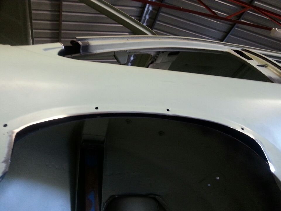

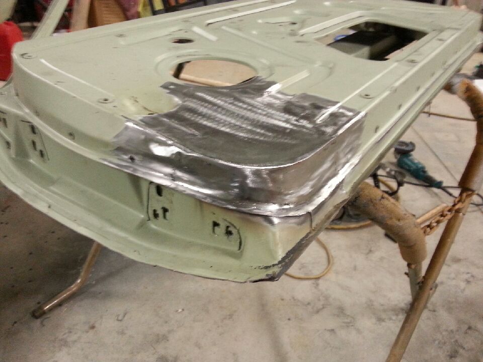

Posted 02 April 2017 - 10:57 AM

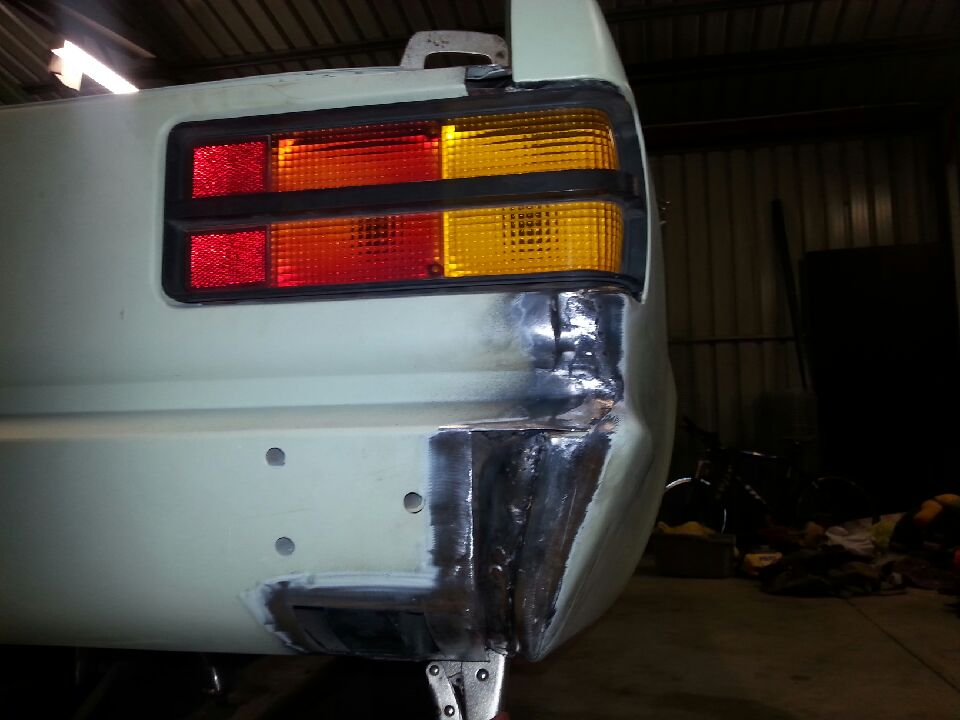

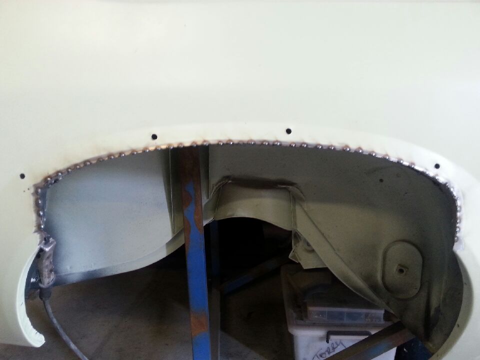

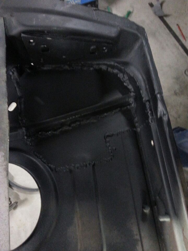

there was also rust pin holes on the outter and ruff on the inner of the bottom corner and in internal bracing so job was done as a full section

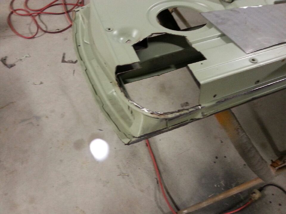

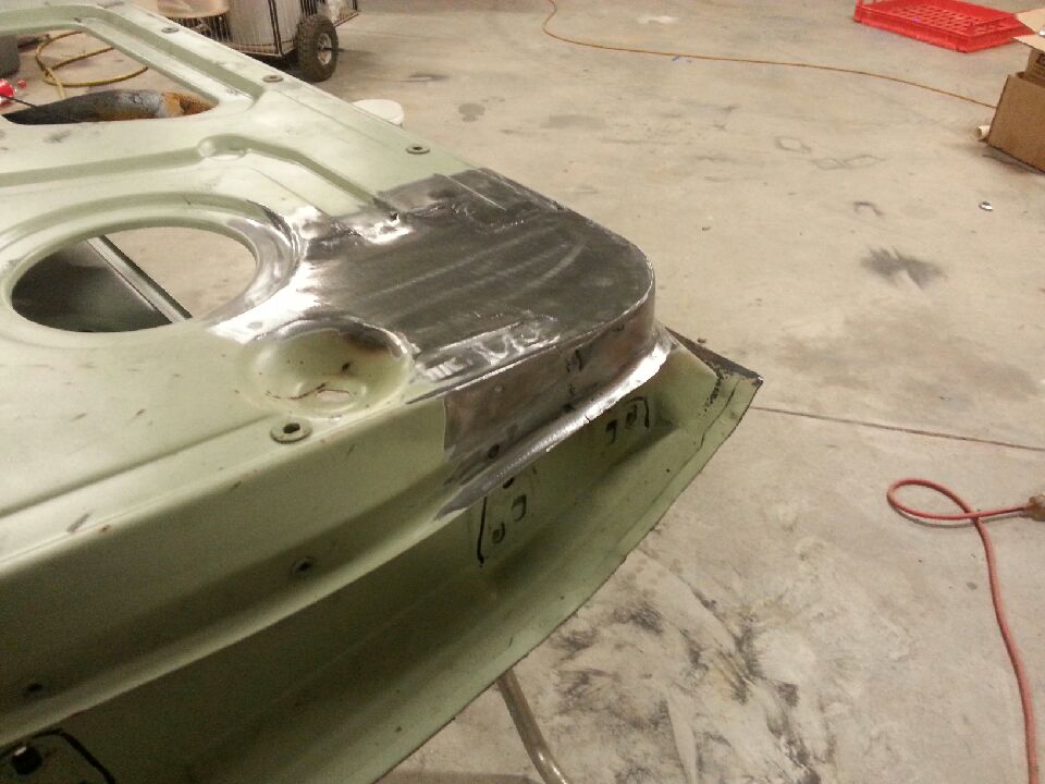

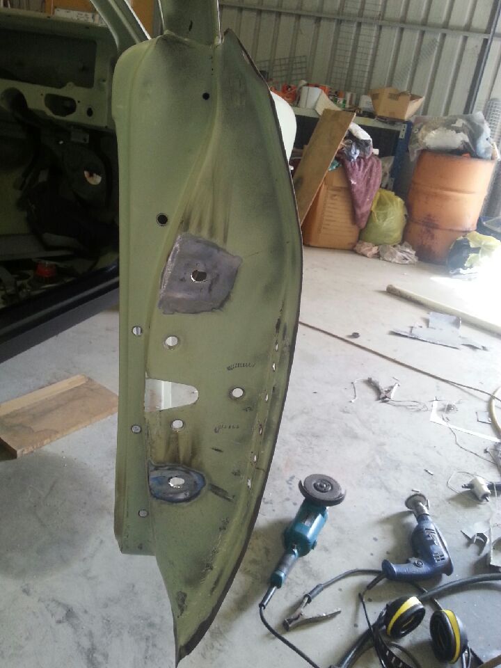

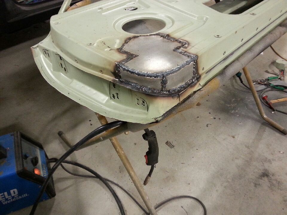

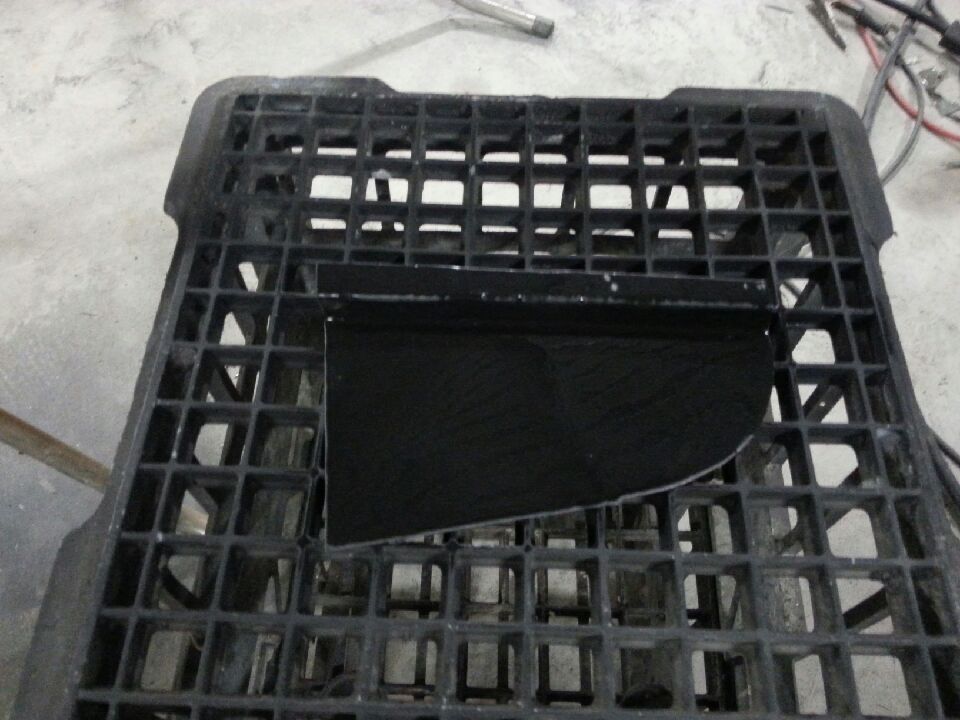

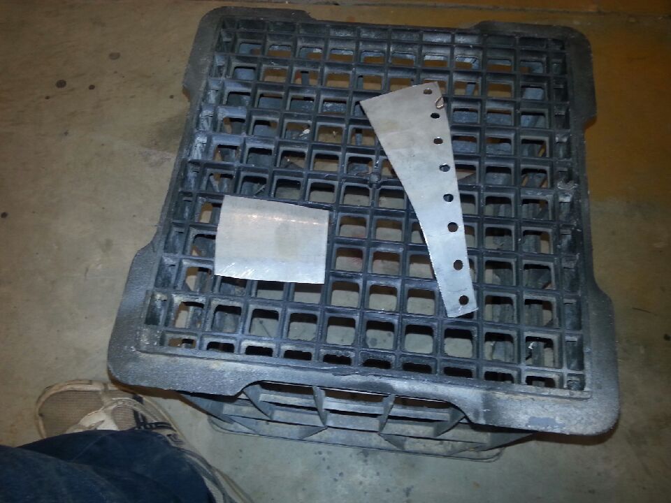

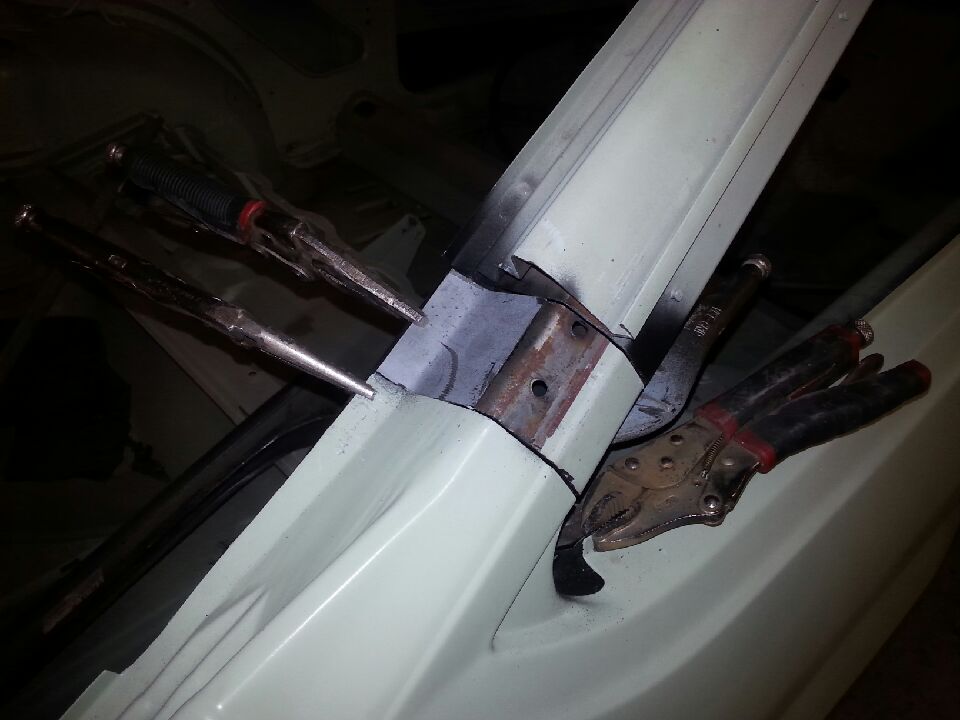

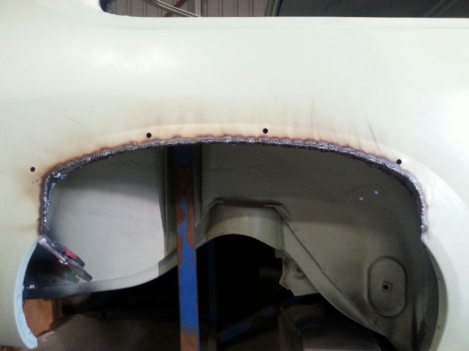

couple of little stress cracks that need some love
and this is how mick strengthened  them from the inside
couple of spare washers
door was a little banana looking

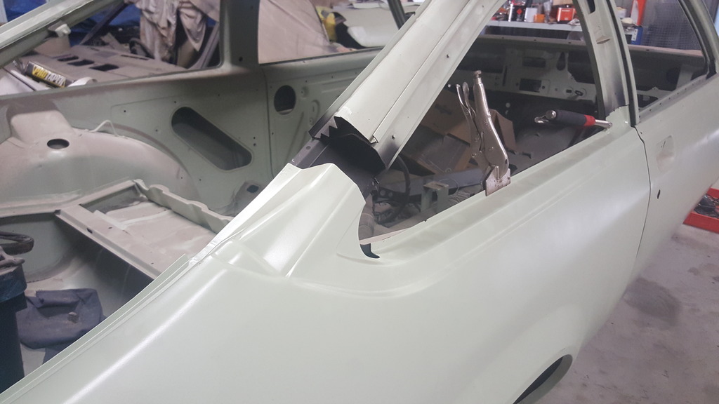

not surprising from what it looked like before
and even before the flash new quarter

Posted 02 April 2017 - 11:38 AM
bit of a straighten up and flick with primer
then time for the internal bracing to have a tickle up and weld back in
Edited by jonesy, 02 April 2017 - 11:41 AM.

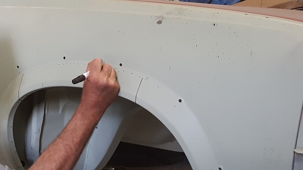

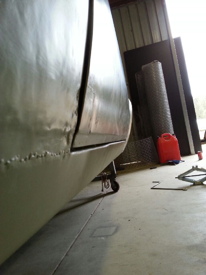

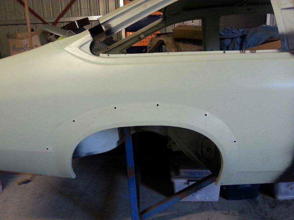

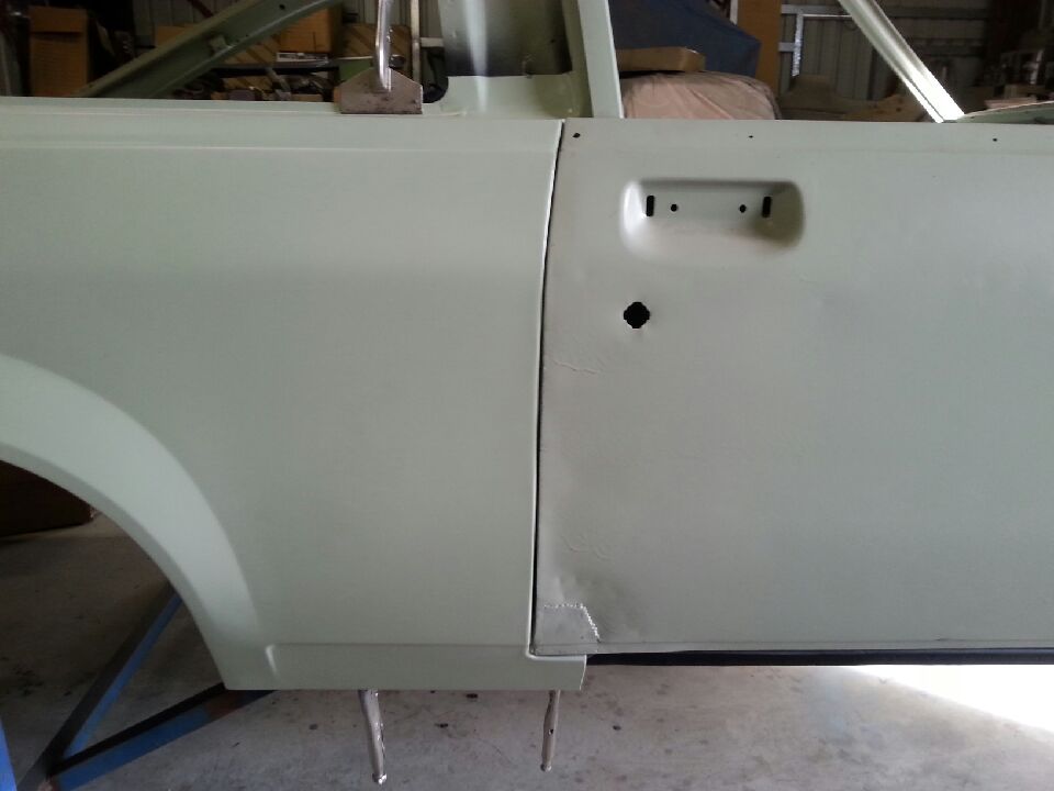

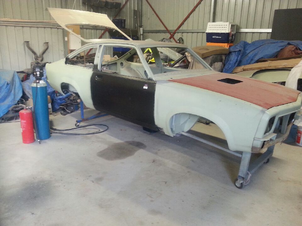

now for that skin i was talking about earlier
mick had to do a fair bit of f^*^king around to get all the lines to look great but he got there...so fresh rubber and this is what he come up with

Looking good. Getting into some tricky areas there.
Those slotted holes on the doors crack like that heaps. I have to fix mine too.
How is the radius on the top edge of the door?
Those look a lot better fit than the one I got.

skin was from rare parts fitted well little bit of adjustment/trim up were the back window framing met the skin but to be expected everywhere else after some persuasion looks great

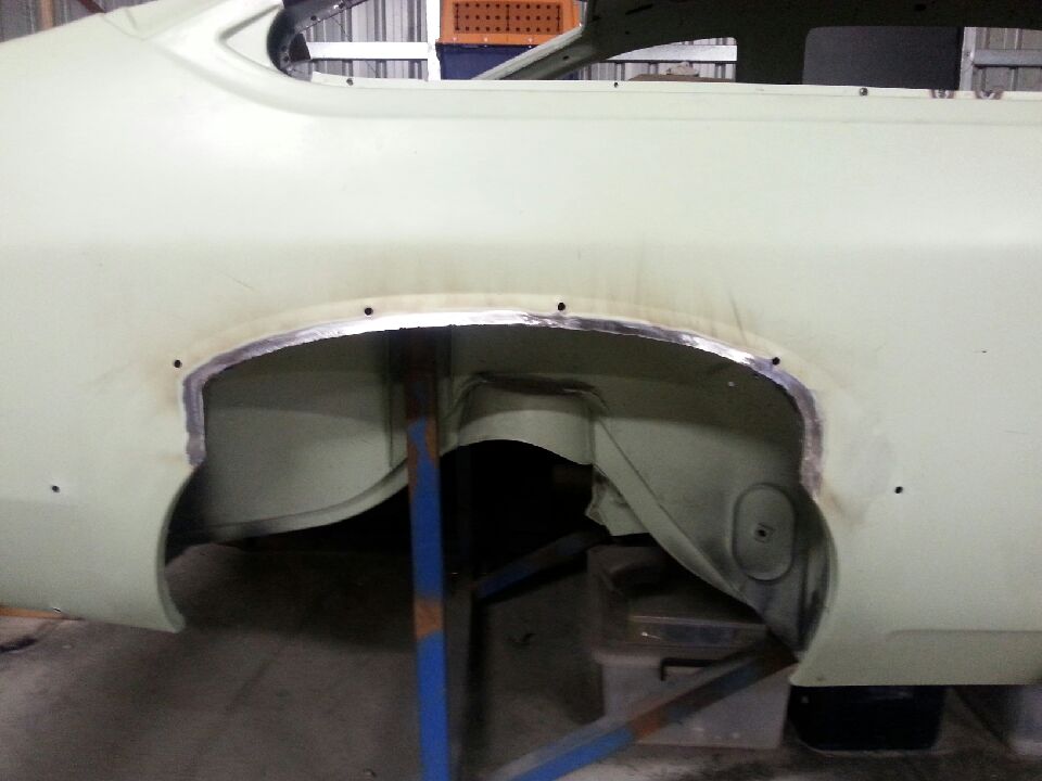

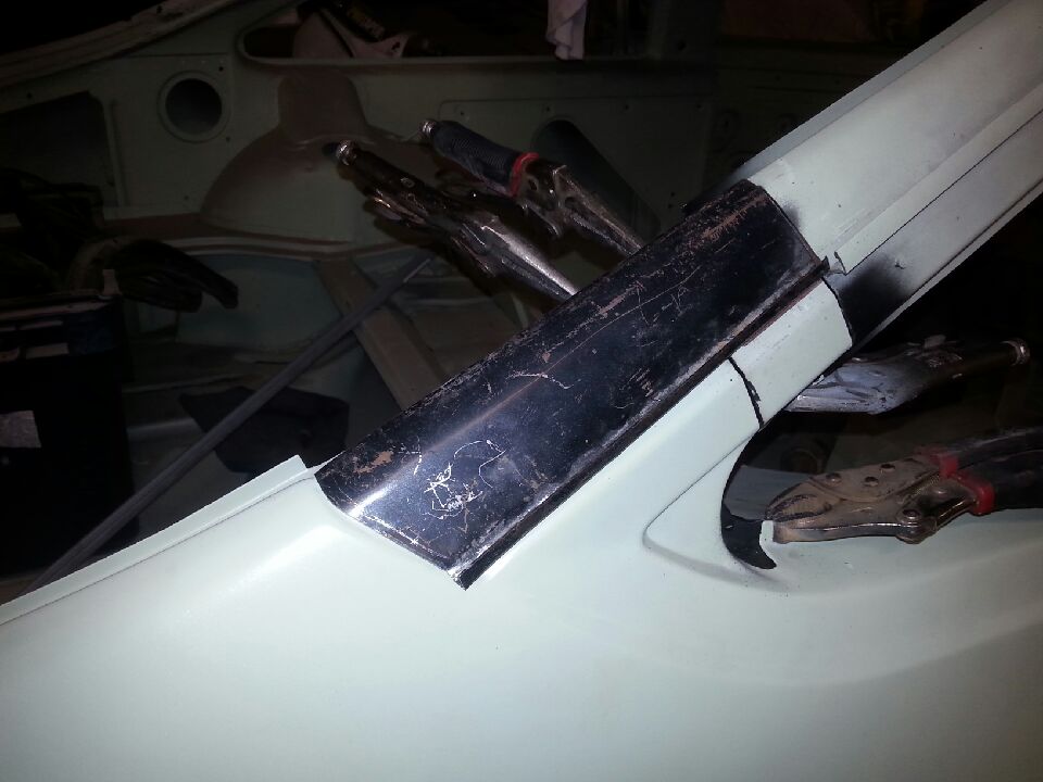

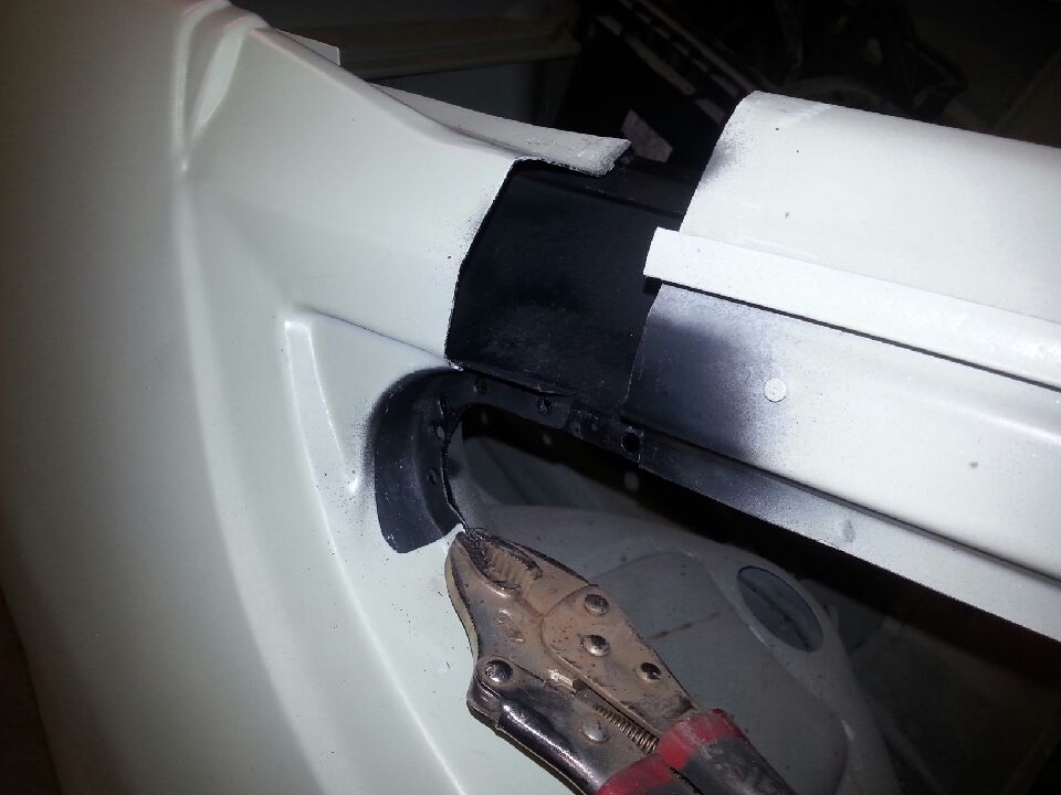

Posted 07 May 2017 - 03:43 PM

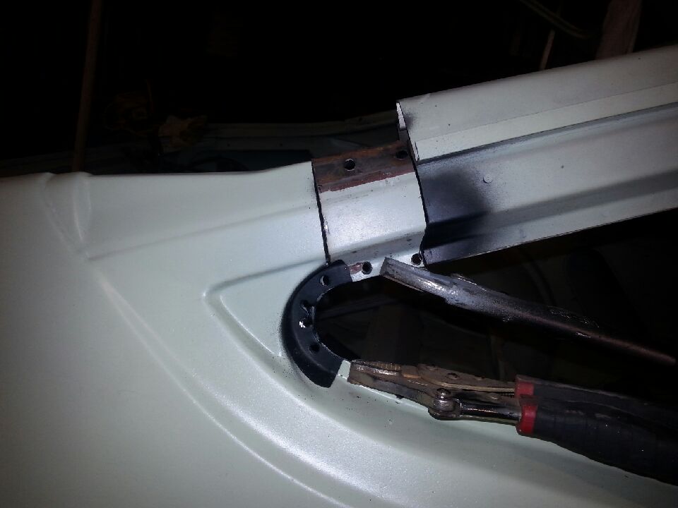

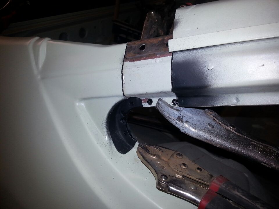

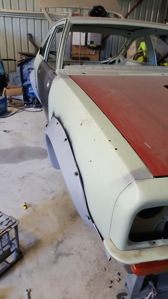

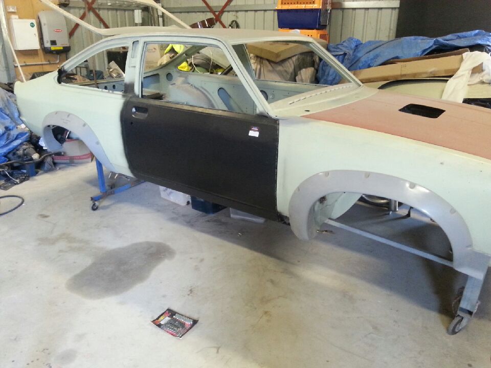

update time,
just about updated christos thread instead of my own hahhaha

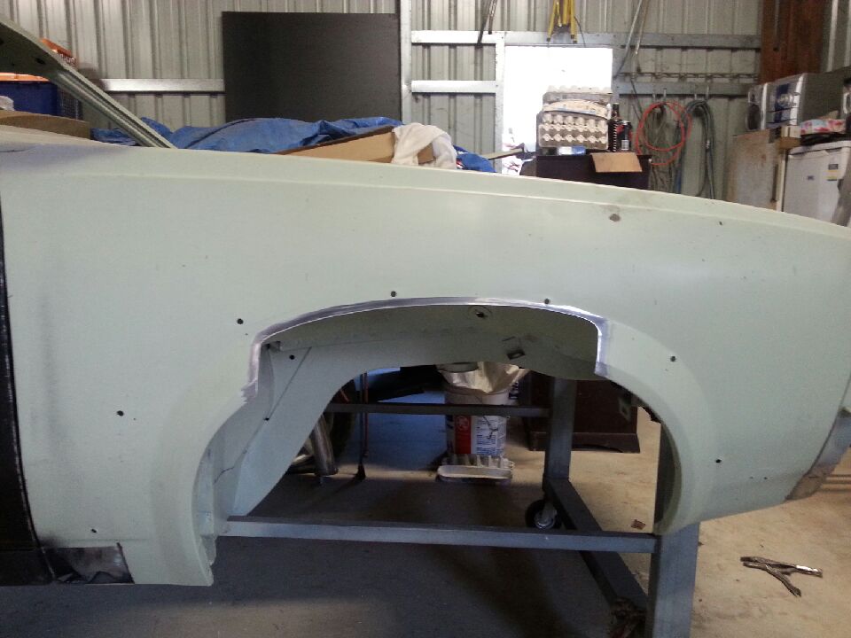

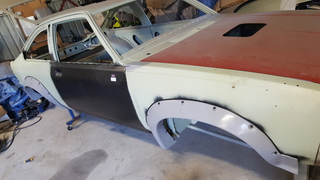

flares mock fitting with vise grip action

Posted 07 May 2017 - 03:54 PM
not quite finished yet as you can see still some more tidying to be done but was the end of a full day and the red cans called
