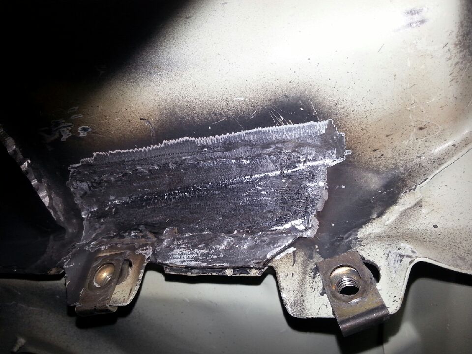

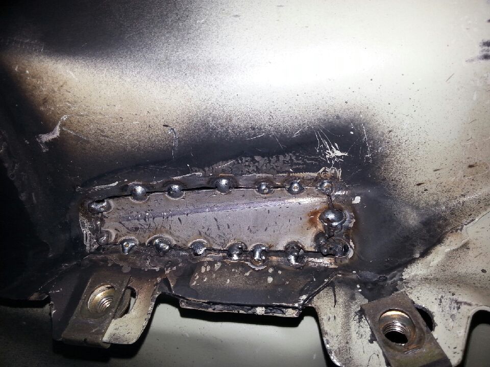

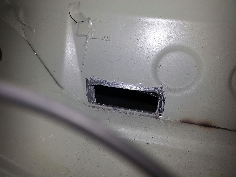

this is where we were at
#178 jonesy
jonesy
  • 637 posts
  • Car:hatch
  • Joined: 16-August 10
Posted 04 June 2017 - 04:07 AM

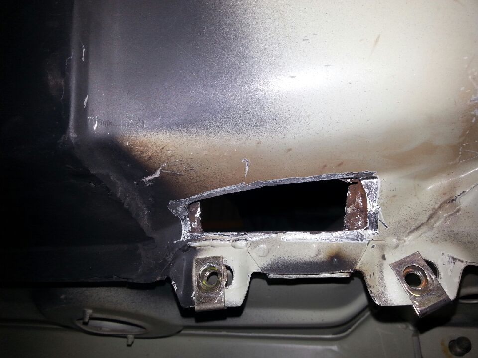

to the front guard and inside front driver footwell
sorry lads dont have a pic of it all primed up but it did happen
Edited by jonesy, 04 June 2017 - 04:15 AM.

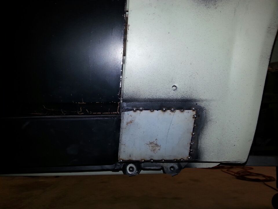

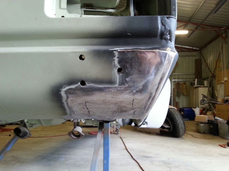

#180 jonesy
jonesy
  • 637 posts
  • Car:hatch
Posted 04 June 2017 - 04:16 AM

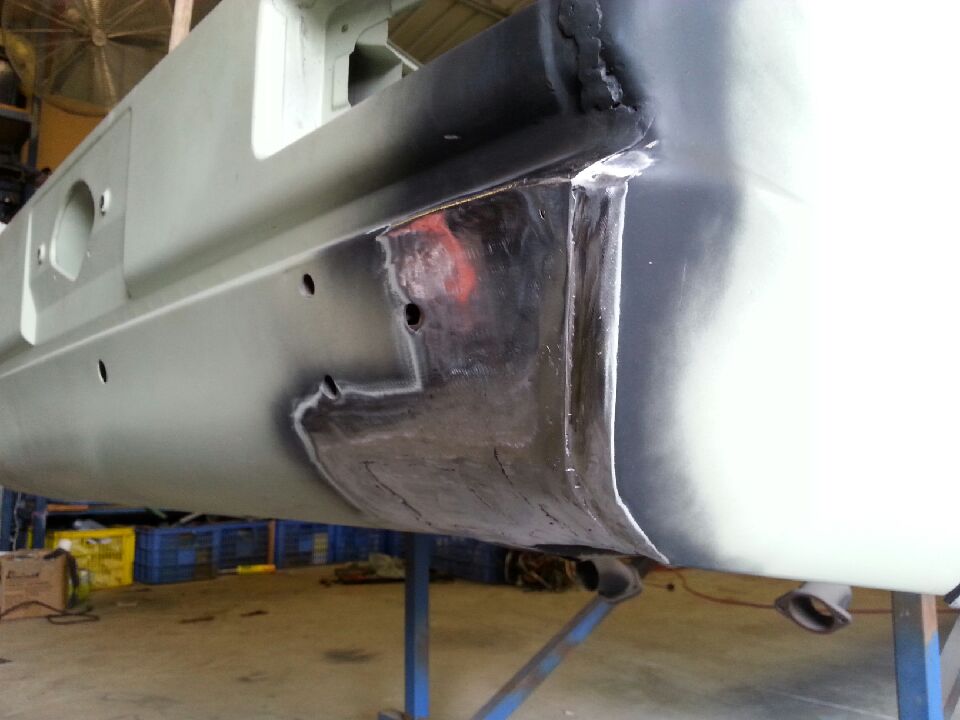

time consuming stuff..thanks mick.......up to date

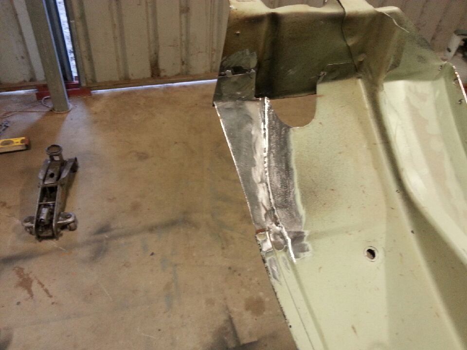

hours and hours of work for a good friend of mine
very pic heavy which is the way i like it, thanks for checking it all out guys hope you enjoy

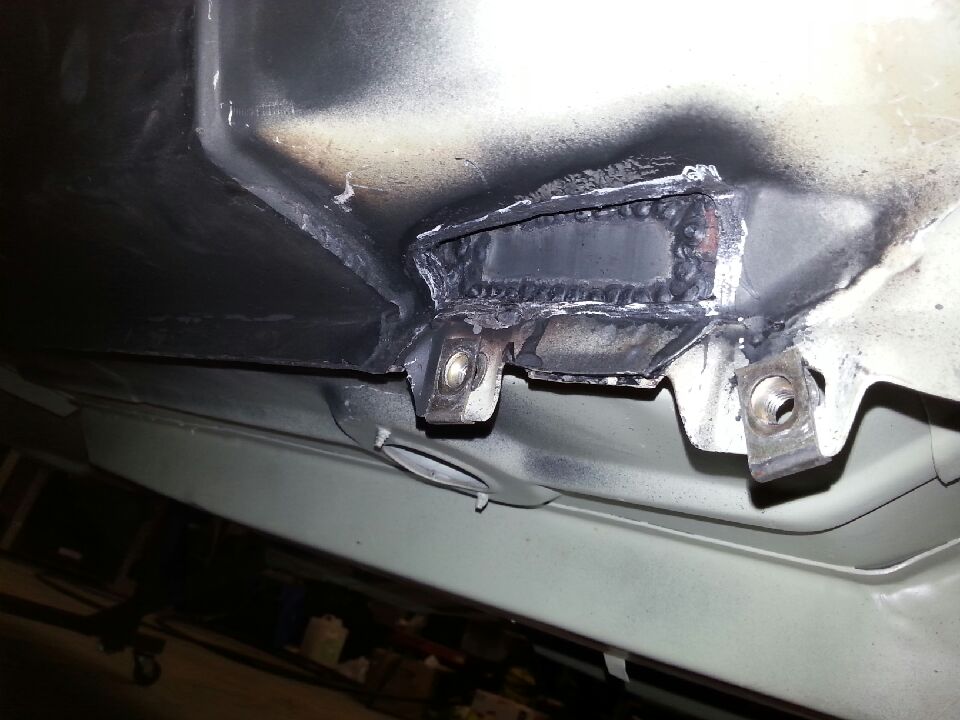

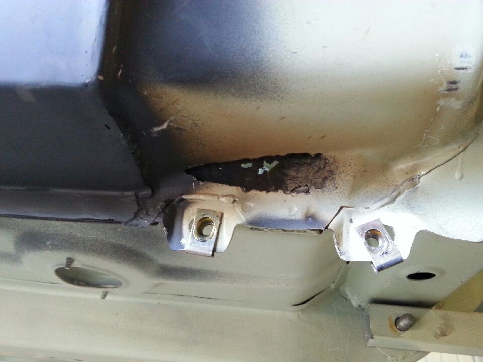

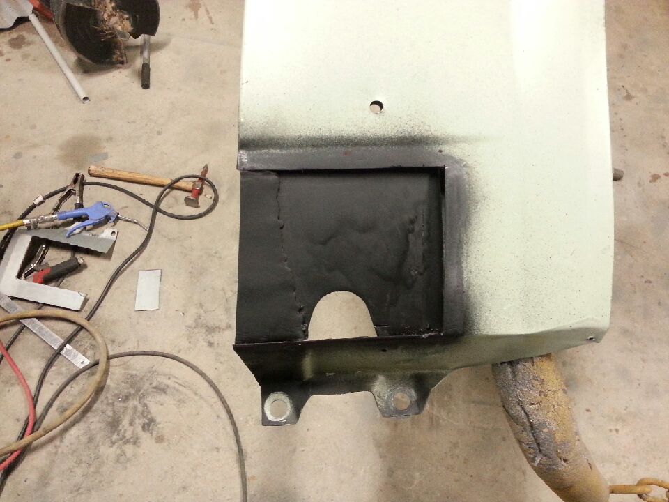

#197 derrin71
derrin71
  • 494 posts
  • Name:Derrin
  • Location:Emerald Qld
  • Joined: 29-November 09
Posted 20 November 2017 - 06:07 PM
It's only when you pull the c pillar apart to you realise why they rust. Ridiculous design.
#198 Bigfella237
Bigfella237
    Socially Distant
  • 4,396 posts
  • Name:Andrew
  • Joined: 31-October 14
Posted 20 November 2017 - 08:06 PM
I think that's why the seam was left open like that, to let the condensation drain out of the C-pillars?
Seems like a bit of an afterthought if you ask me, I think the janitor might have slipped that part into the blueprints while the design team was at lunch!

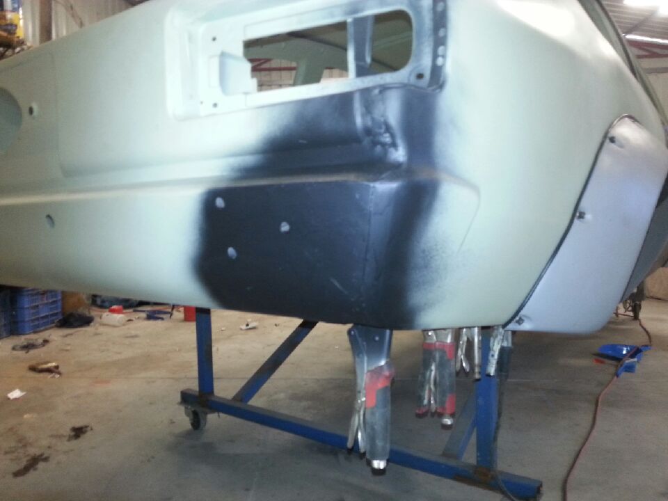

#199 jonesy
jonesy
  • 637 posts
  • Car:hatch
Posted 21 November 2017 - 02:33 AM
yes very poor design , we pulled at least a handful of rusty cornflakes from in there.
im sure that when it rains heavy the water would fill the gap between the outer-side of the hatch seal in the gap at the top and run down to the area entering through the hatch hinge recess
i may be wrong though
