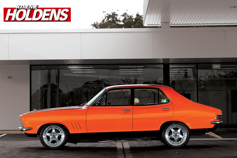

Just wondering what solutions anyone else has come up with the fix the issue of the diff being off centre in the wheel arch.
Im planning to drop my LJ a bit more in the rear and as a consequence, the diff is moving rearwards.
I want to centre it up and get that sorted before I lower it anymore. See the picture for reference

I can't help but I have to say your car looks mint Chris.
Also, I think my mind has been made up as to whether flutes look good on a 4 door or not, YES, yes they do.
Are you moving the diff forward because of scrubbing or just to make it look a bit nicer??

Bit of looks and to reduce the chance of scrubbing.
