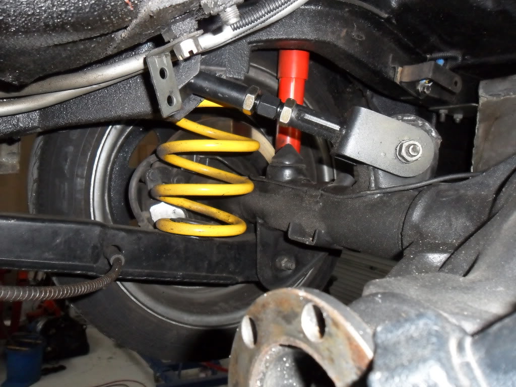

Not that im aware of,only the tops ones that
Ray Mcdonald does.

I got a set similar to that on the hatch and was hoping you can get the same for the little ones
