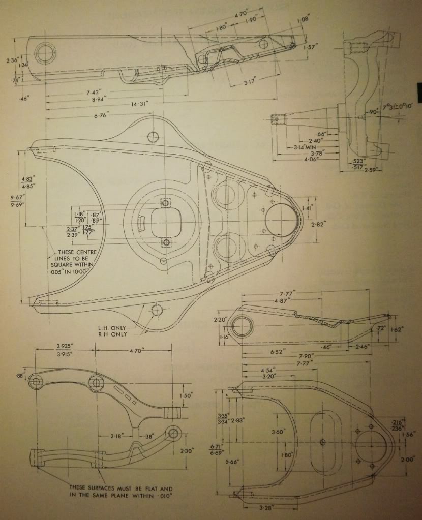

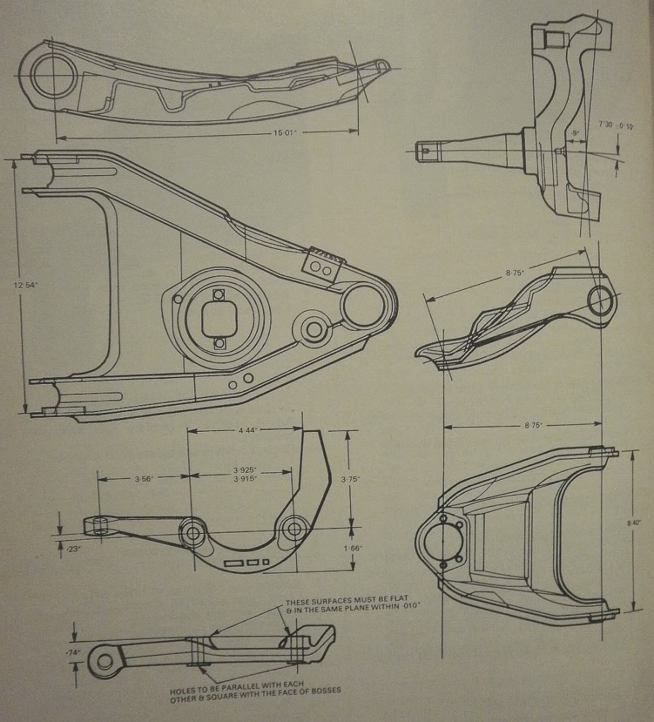

After viewing the following image, it appears the HR stub axle has an included angle of 7.5 degrees (7 degrees 30').
Does anybody else have diagrams similar to this for LH-LJ, LH-UC, HK-HG or HQ-WB? They would be very handy for comparisons sake.
#39 _HQ SS_
_HQ SS_
Posted 05 January 2012 - 08:36 PM
Here are HK and HQ
HK 7 degrees 31"
HQ 7 degrees 30"
So the same basic included angle but HR disc stubs had the bearing center line 1 inch down,
so fitting HK-HQ-WB stubs lowers your HR 1 inch,
Cheers Paul.

#41 _CHOPPER_
_CHOPPER_
Posted 05 January 2012 - 09:12 PM
Brilliant! I just need those pages for the two Torana flavours and I'll be as happy as a pig in shit. It was mainly the dimensions of the control and steering arms I was after, but the stub axle info is a bonus.

#48 S pack
Posted 05 January 2012 - 10:24 PM
LC 6cyl Torana
Edit: Can anyone else read the dimensions? I might have to do a zoom scan or something.
